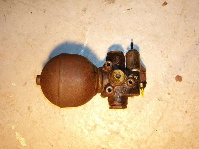

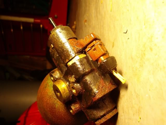

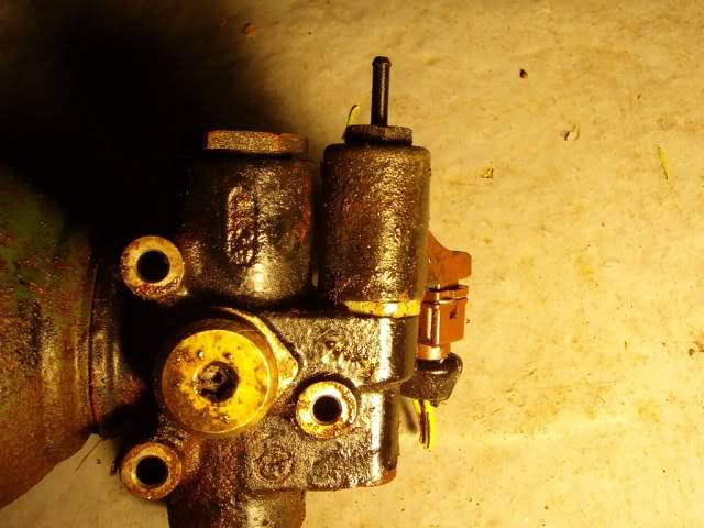

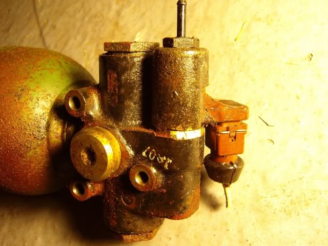

What car did that block come off of Dom? If it's from a MK1 Xantia or XM then it won't fit a MK2 Xantia as the blocks are very different with regard to suspension cylinder pipe flare sizes and more majorly, there will be only one 3.5mm pipe on a MK2 whereas on a MK1 there are two. They are not interchangable.
Easiest way to tell at a glance if it is from a MK2 is to see if there is a bleed nipple on the body. I can't see one in the pictures and I think I can see two 3.5mm pipe holes so I reckon you have a MK1 version there.
No worries as the electrovales are the same. Gently try to remove the valve by using a socket on the top 16mm hex on the end of a long bar and easing GENTLY. If you are lucky, the whole valve will unscrew and come out of the sphere block. Note that the coil (the bit with the electrical connector on it) will rotate freely to allow the valve to be fully unscrewed from the block.
If you are unlucky, the top part will unscrew independantly of the body. No worries, just keep gently unscrewing until the top comes right out. Then carefully lift off the col and retrieve the innards of the valve from the alloy body, noting the order of the springs , shuttle and slug.
Then, use a 24mm deep socket to remove the body. Take care as it is SOFT alloy. You may need to grind and shape the socket to fully fit the 24mm hex as a standard 24mm socket may be too thick to fully sit snugly down on the hex.
Good luck...
Never judge a sphere on looks. That one looks like it's been at the bottom of the sea for a thousand years but may be absolutely fine. Only a pressure test can confirm it's condition...
Good luck...

I think he said it was from an XM, there are definately two fairly large holes for what looks like hydraulic lines, one at the top next to the electrovalve and one at the bottom opposite the top one, on this picture:

It's easier if you do remove the sphere to do the job Dom as it improves access no end. Remove the spare wheel carrier as well. Also, as that sphere block is from an XM, it will not be compatible so you won't get away by changing the whole sphere block over. As I say, the big pipe flares are different and you will find there is one too many 3.5mm hydraulic pipe holes on the XM block!
The LHM condition should be assessed as you don't really want dirty and worn-out LHM running into a new ram.
The easiest way is to extract a small sample from the reservoir and have a good look at it. It should be bright green and crystal clear. If it's yellow, brown or opaque then it's old and must be changed. I'd also check the condition of the LHM filters inside the reservoir and clean those carefully.
Then, if the LHM did look dirty, run on Hydraflush for at least 1,000 miles to clean everthing up before refilling with fresh LHM.
