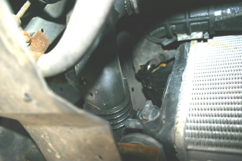

DHallworth wrote:Well after months of scratching my chin I think I've finally found out why this Xantia HDi was smoking and it was purely by chance...
When I took the front end off the car I noticed that there was a black oily spot on the bottom of the intercooler. I didn't even need the compressor to detect the leak, covering one end with my hand and blowing in it was enough to hear the air escaping from it.
Ordered a new one and fitted it, started the car and it was running nicer, when revving it the smoke seems to have cleared and the thick diesely smell from it has gone. Sounds much more like the other HDi that we've had, just got to get the front back on the car now and then take it for a run.
Never even considered that there were problems with the intercooler as it's never been *noticeably* down on power or performance.
David.
David/ Jim, Would this be the offending pipe you were describing?

The top one is one of them. It's a bit leaky where it joins the intercooler. Possibly a loose Jubilee clip but more likely the pipe is split right at the end under the Jubilee clip band. Wherever those pipes leak they'll give it away by showing copious amounts of oil. The oil comes from the crankcase breather system and is not a leak in itself - just condensed oil vapour. Hence why it's horrible, black and sticky...
The pipe underneath, which is really oily, is the air intake pipe and not a problem.
