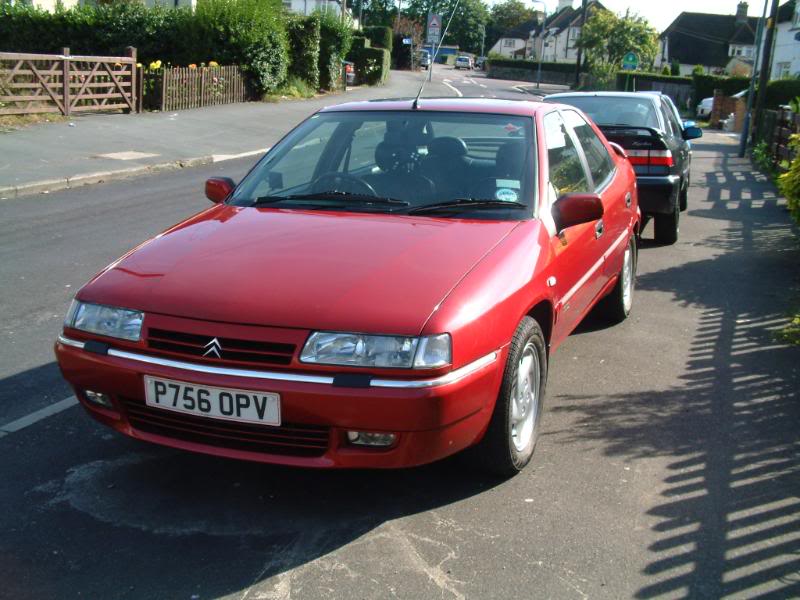

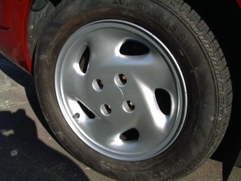

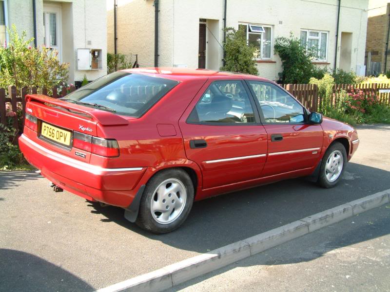

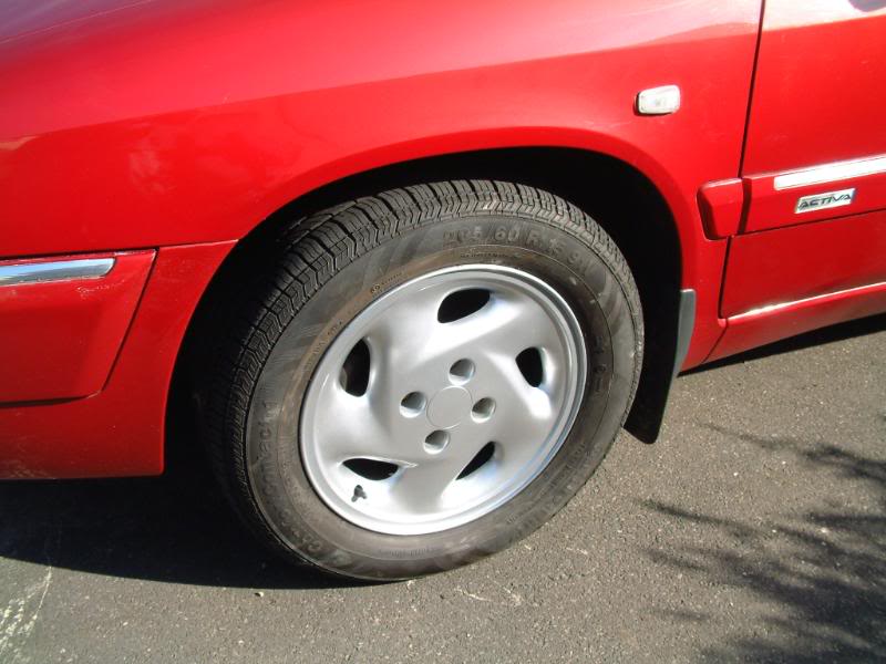

A quick hint of whats been happening today to Jim's Activa...

A picture is worth a thousand words they say but those above only tell a fraction of the story. All you see in the pictures are shiny wheels. The work that Gareth put into them was something else entirely :D
He started by removing a pair of wheels from the car, deflating them and "breaking" the tyre beads from the rim. There followed the preparation involving much sanding, mostly with his little DA sander but a surprising amount by hand on the fine details, cleaning and priming.
Three of the wheels were not too bad and Gareth prepared them with relative ease. the fourth had a bit of corrosion and Gareth spent ages on it, finally ending the prep. with a coat of high-build primer.
The sliver base coat was prepared and sprayed after using special tyre shields and a valve shield. Whilst Gareth prepared the base-coat he showed me how he would mix the red my Activa is painted in. It comprises at least six separate pigments, some coppery, a brown one and several reds, one a really bright scarlet!
The wheels were flatted down and sprayed with their base-coat. Gareth used cellulose on mine whereas he'd normally use a water-based paint. After three coats of this, he seemed satisfied and put the wheels aside to dry. At this stage they looked magnificent but there was more to come. A batch of two-pack lacquer was mixed and several coats sprayed on. This was the icing on the cake and this lacquer, as it dried, imparted the deepest, most lusterous shine I've ever seen, straight from the spray gun. These wheels really do look seriously shiny and smooth :D
The above was repeated on the remaining two wheels. Five hours all told!
Gareth is a craftsman and perfectionist when it comes to paint. There is no other way to tell it. He is. To watch him do the work is sheer poetry in motion. It is always a joy and pleasure to watch a maestro at work.
In a lull, whilst the last wheels were drying, Gareth showed me how he does fine paintwork refinishing. He did a quarter of my bonnet and one wing. From these areas he removed all the "swirls" and buffed it up to a perfectly smooth mirror finish. It is incredible what can be achieved :D
Thanks for all your hard work today Gareth. I'm delighted with the result :D :D
If you want wheels refurbished, the choice of person to do them is a real no-brainer!

No problem Jim, its a small way of saying thanks for the huge amount of time and help you have given me on both my cars. That OSR wheel was a bit of a bugger, and its still not perfect, but with the good weather conditions that laquer went on nice and smooth with very little orange peel. It should keep them going for a couple of years, french car wheels are really terrible for corroding and i was lucky i caught mine before they got too bad. Next step is sorting out your bumpers corners, once thats done the 3M treatment over the whole car and you should have pretty much the mintiest Activa left on the road!
BTW, the reason for cellulose basecoat being used was for a couple of reasons. Its a very good replacement for the original colour used on that age of car, quite a fine pigment compared to my later Activa which has a more coarse look to it, secondly as it was for a friends car i wasnt using work materials 8) It's been a while since i've used a solvent basecoat and TBH water based is so much better now i've got used to it, no issues with reactions caused by incompatable paints, only 1 1/2 coats needed compared to 2-3 for solvent and its also much better for the enviroment and my lungs! The finish is better too, with the pigment settling out far more evenly than old school cellulose. Used correctly you can still get a good result, but definatly a sign of good progress.

Those minty wheels have drawn rather a lot of admiring looks already Gareth :D
