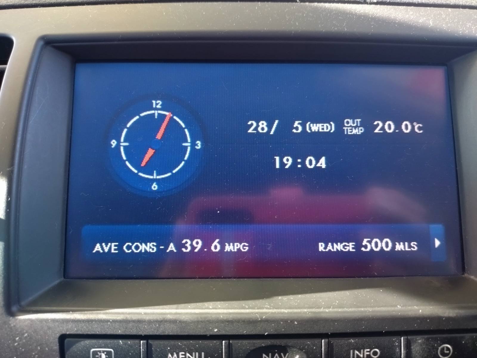

I went out last night and filled the car then I remembered to read the MPG over the whole journey before resetting the trip. Hence this picture displays the correct mpg after the trip and, considering we were three up with luggage and the a/c running most of the time, I'm happy with that from a 21 year old 2.5l car!!

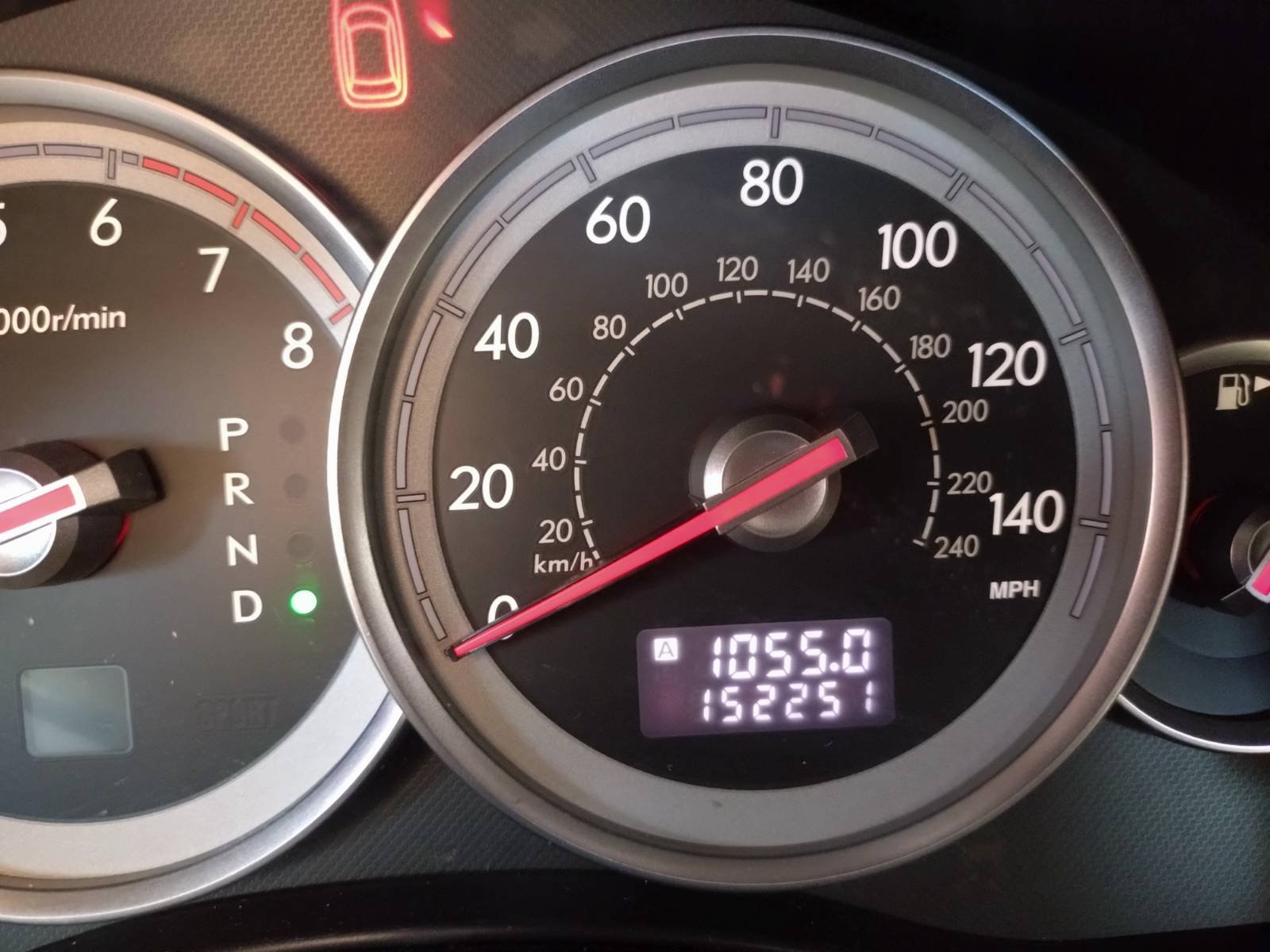

I noted the palindromic total mileage so I will post that picture in the number noticers thread too!!

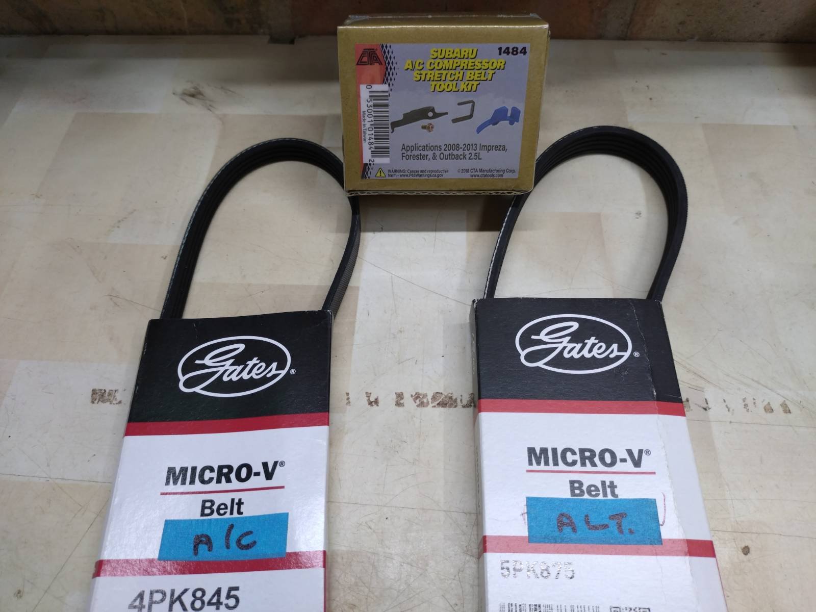

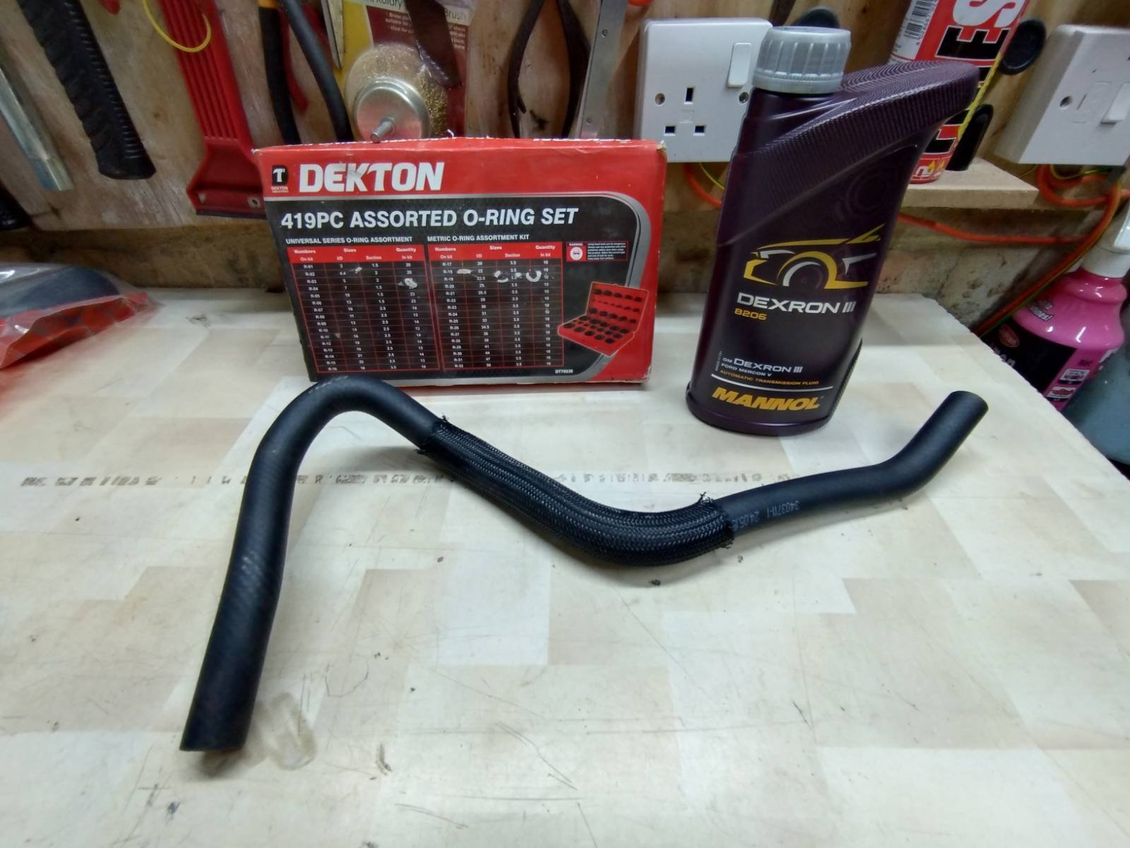

So what is the other job? I hear you asking! Well basically the power steering pump is making the commonly known squeal when cold and occasuionally when under heavy stress, 3 point turns etc. On this engine it is a symptom of the suction hose leaking due to hardening over many heat cycles so I have ordered a new hose and O ring, which also is known to fail after 80k or so, for installation at the same time as the radiator check! Watch this space

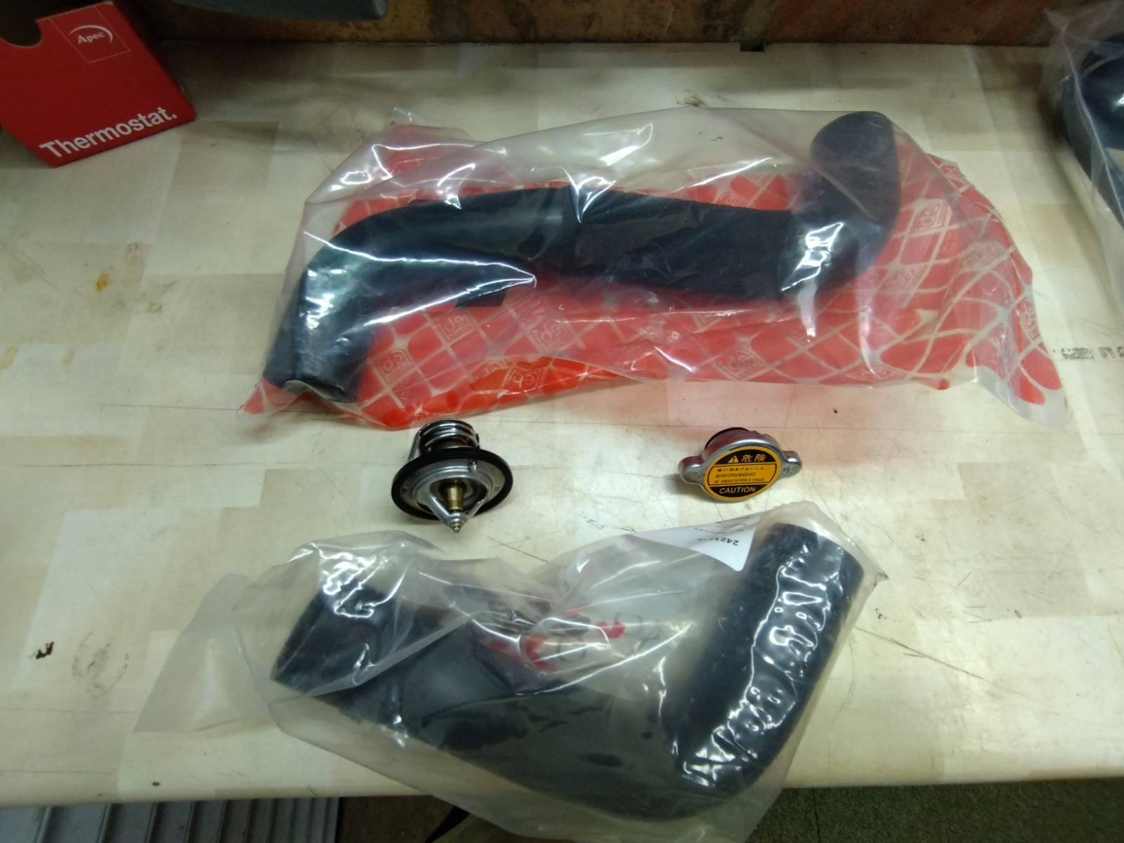

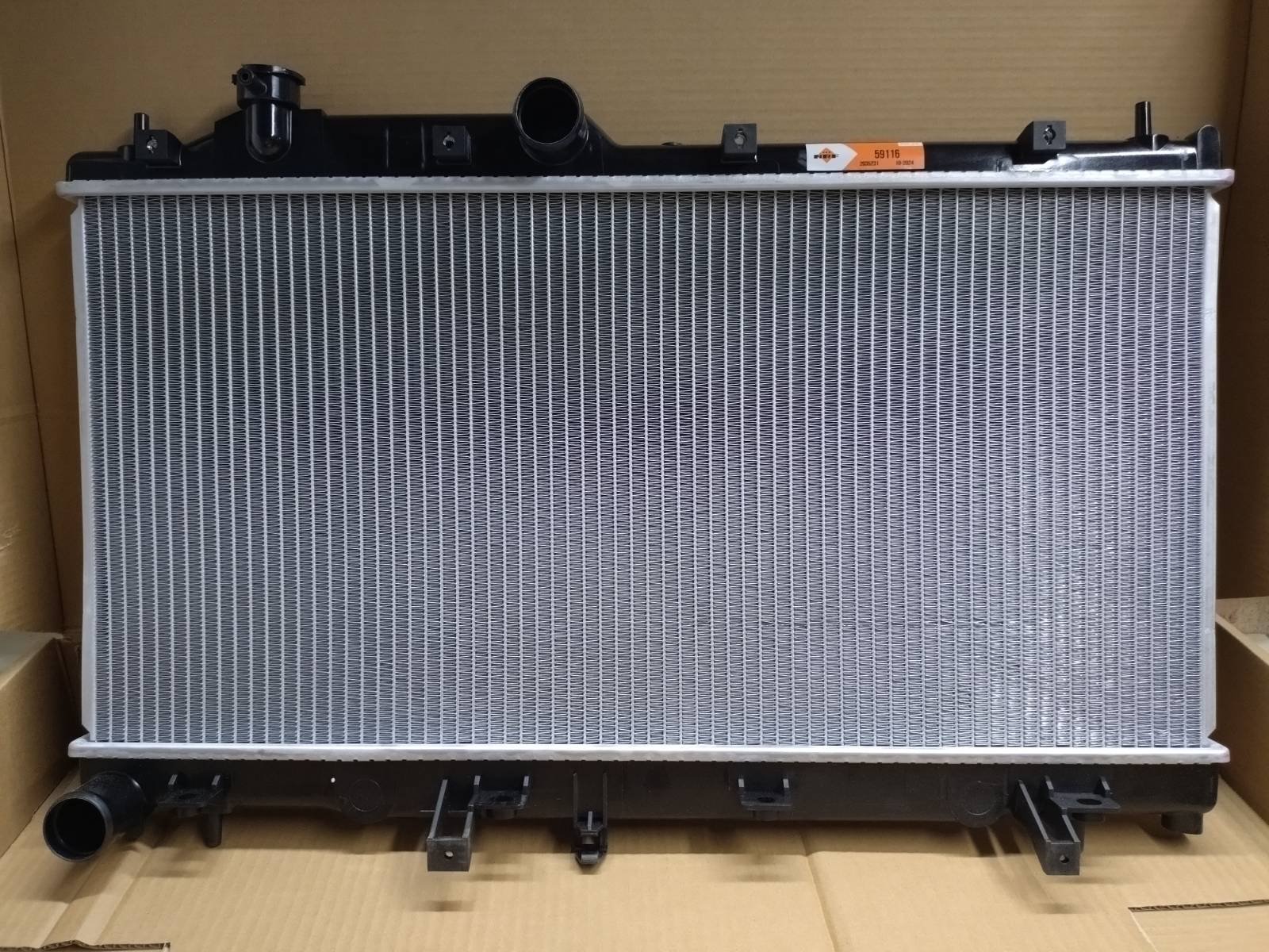

Since the last post I had a further investigatory look at the steam in the engine bay. It is coming from the top of the radiator where the header meets the matrix so I decided to go for a complete replacement to bring another part of the car up to as new condition. I also discovered that the power steering suction hose has gone very hard so I have accumulated the parts to sort that. This is the collection so far:
I'm just waiting for the replacement hose clip set and I'll be ready for a days spannering in the week!!
I'm doing all these jobs together simply because with the radiator and fans out of the way the belts and steering hose are much easier to get at, hence the all in one go approach!!

A delivery just appeared on the doorstep
Watch this space for future developments

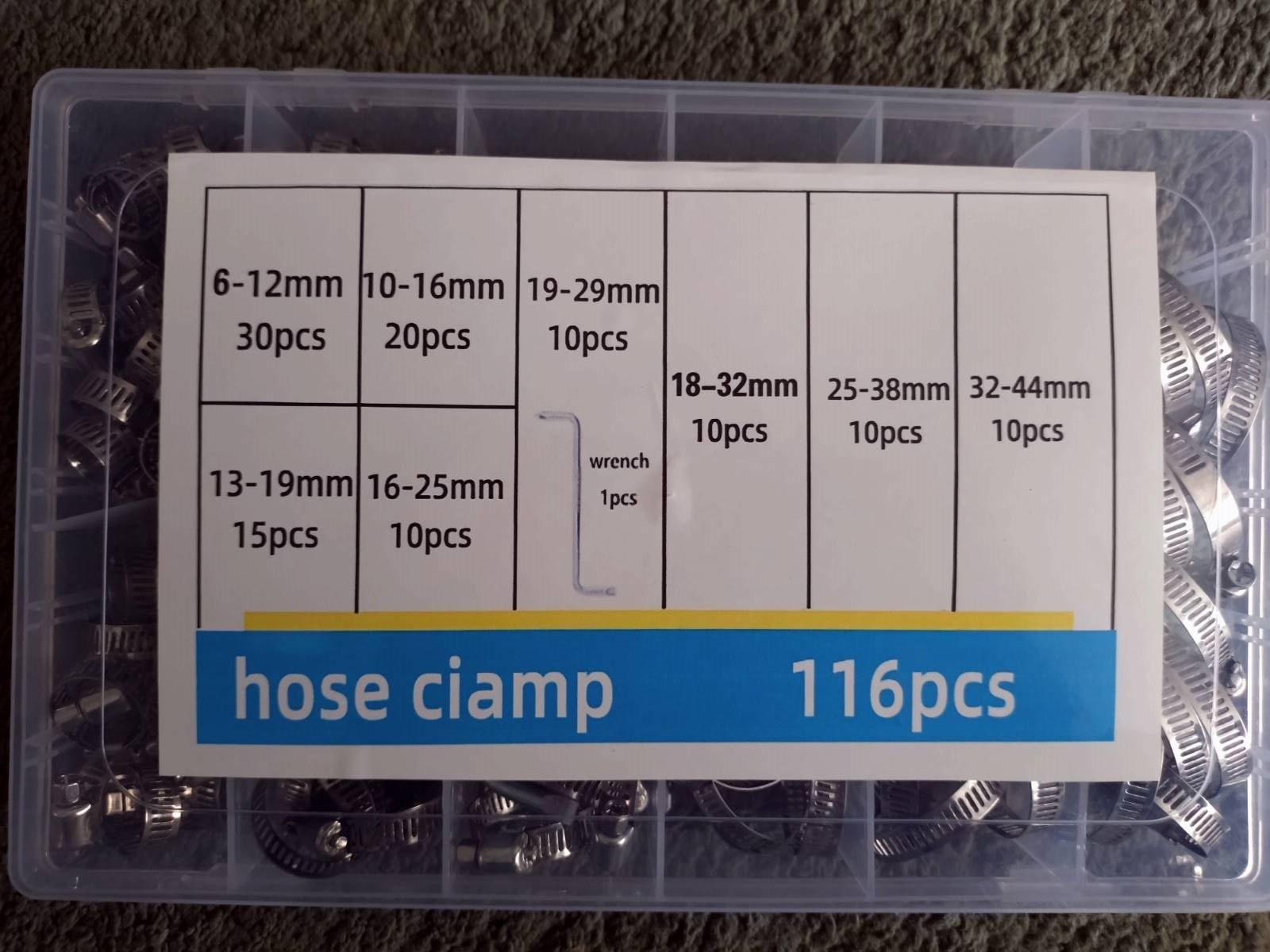

Interested to hear your experiences with that type of hose clamp (the jubilee with the rack/teeth the screw's worm engages with being the type that is punched all through) - I had some of those previously in a selection box - possibly from Aldi - they were complete garbage! The remaining metal between the punches slots all too easily bending away from the worm and so very much limiting it's ability to be tightened up properly.
Hope your set are better!!
- Posts: 21076
- x 8089
Re: DIY Car Maintenance with function over finesse!!
I posted that picture up before opening the box, I can't say I'm impressed at all, I can see them only being of use to hold pipes in place where no pressure is involved so I won't be using them on the cooling system. I have proper clips for that anyway, it was for the power steering suction hose that I ordered them and even there I may double up or even reuse the originals. Not one of my better buys from Amazon!!MattBLancs wrote: 06 Jun 2025, 19:08 Agree on the "other jobs whilst I am there" approach, I'd do the same.
Hope your set are better!!![]()
