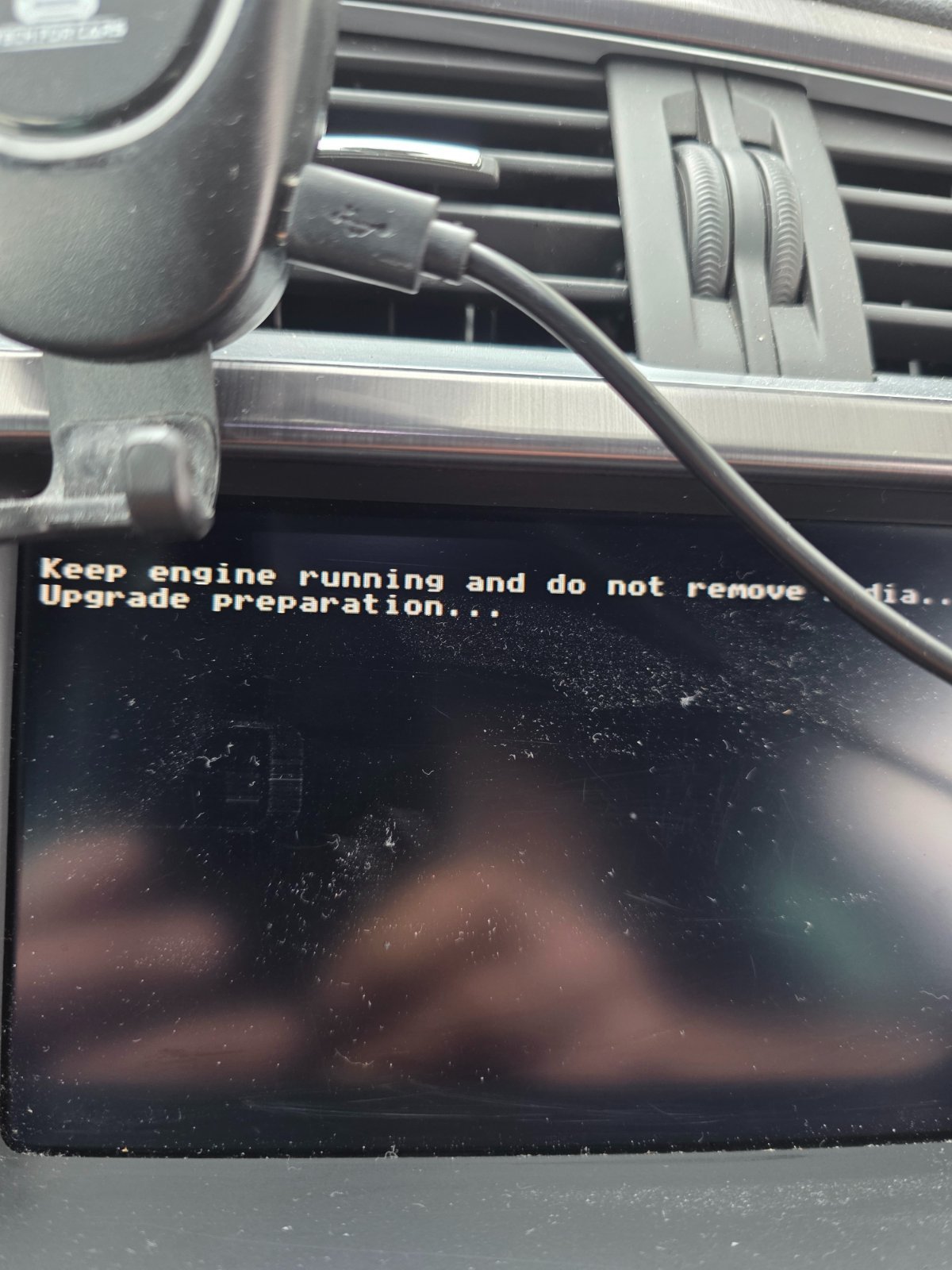

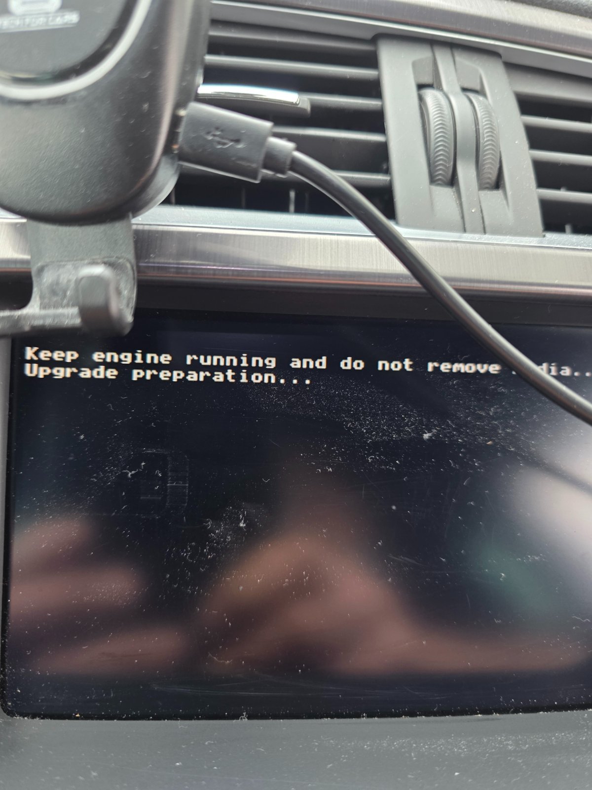

- The first attempt failed after 5 min, but the 2nd attempt looked very promising with updates of the process on the screen! It showed that it was partitioning the SD card and installing all kind of software.
- It restarted and came with graphics mode showing please wait, but also an annoying period beep
- The another restart and 'please wait'
- After ~30 minutes I became fed up and switched off the contact, and restarted the car. Fortunately, everything appeared normal!
- The first map installation froze after a couple of minutes. I switched off the contact, waited for everything going to sleep and tried again. Then it succeeded.
- Navigation on the console screen worked. Although there was no navigation info and 'radio off' notice on instrument panel.

Starts updating, crc check. Etc
Stuck on Upgrade preperation, sita there a white, ejects the cd and goes black
How long could this take

Problem with that MicroSd card !Pwiberg wrote: 27 Jun 2025, 13:29 Starts updating, crc check. Etc
Change it and try again!
