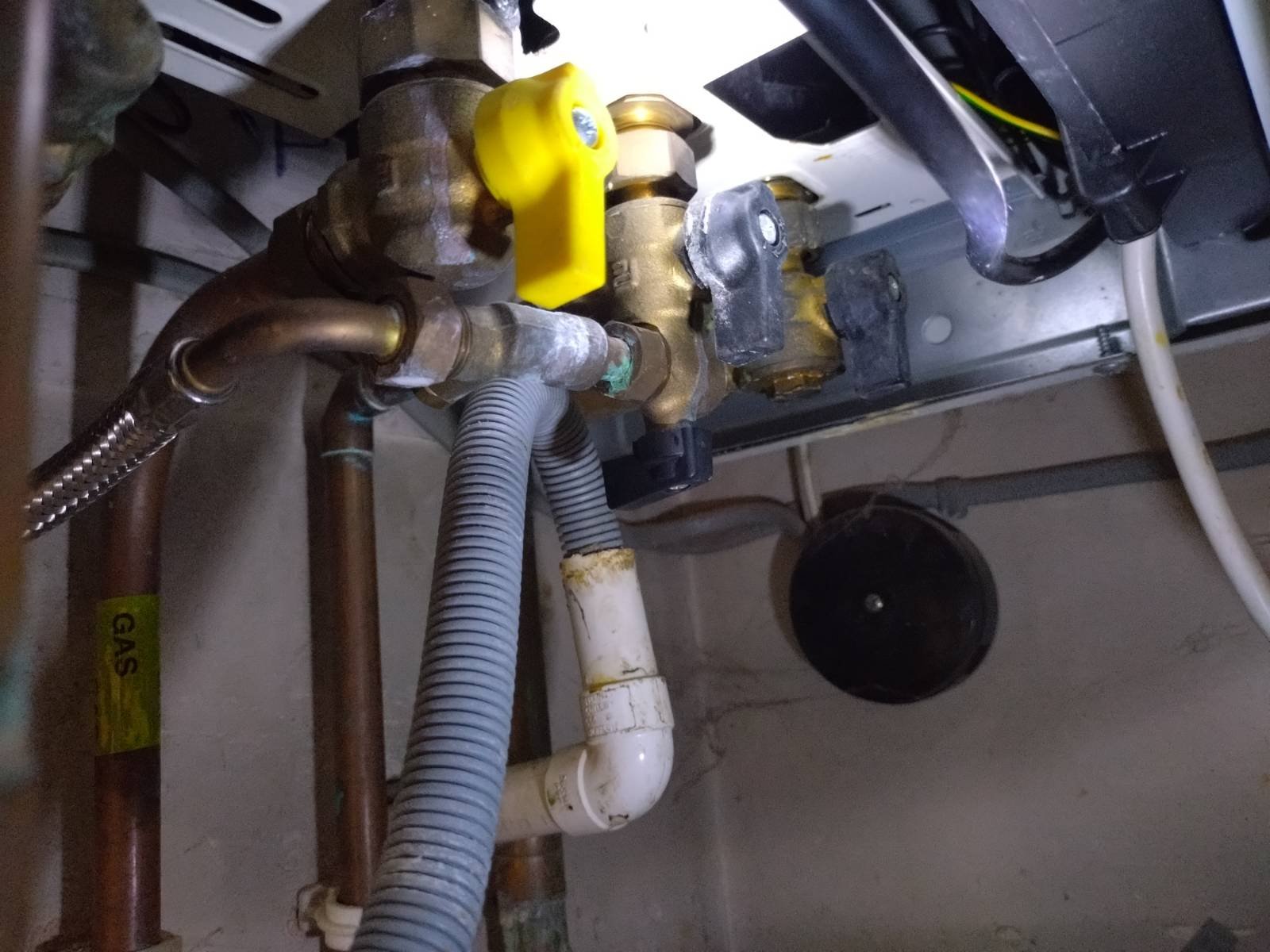

As I was coming downstairs this morning SWMBO called me into the kitchen saying "There's no hot water". I looked at the boiler and saw it was showing an SP1 error, no ignition. I reset it and turned on the hot tap, same problem!! I looked at the hob which was happily boiling her eggs so gas ok. After a number of further resets, re-pressure cycles and 3 pin resets it was still the same. At that point I looked under the boiler to check the gas tap and discovered the yellow knob which you can see in the picture below pointing at me in the 9 O'clock position, or in other words turned off!! I duly returned it to the 6 O'clock as in the picture and all was well.
MTMO
MTMO
So that just left me wondering how it had got turned off. SWMBO had a hot bath last night after I had gone to bed and then she went straight to bed. This morning she got up early to put the bed linen wash on, which involves getting the necessary detergent, softeners etc from the bottom half of the boiler cupboard below the shelf. Then she made the tea and brought me up a cup in bed. Thus I went downstairs some twenty minutes after the tea was made to be greeted by her call. Draw your own conclusions but I decided the best course of action was to prevent it happening again :

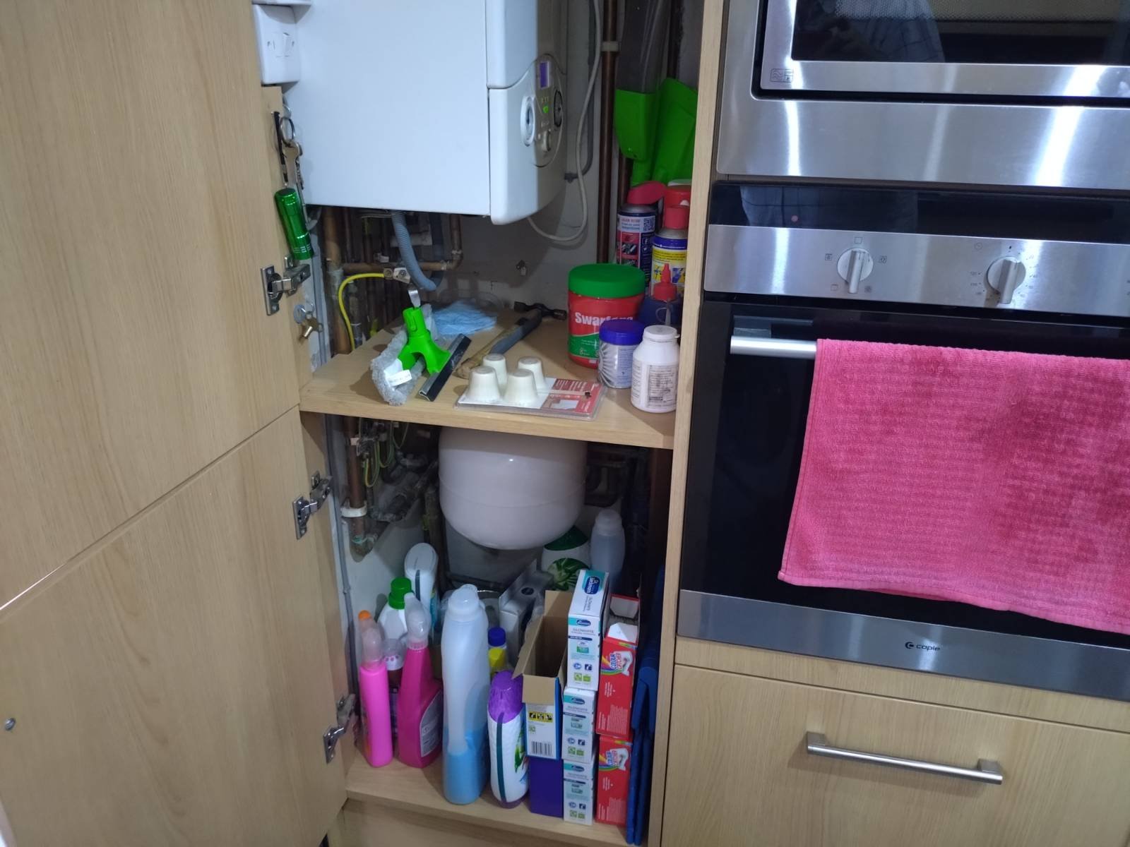

MTMO - As it had been

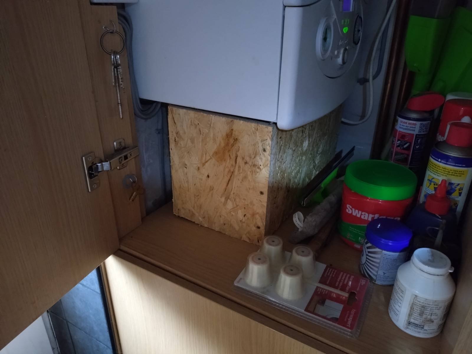

MTMO - after my addition
I made and fitted the shield to ensure accidental operation of the under boiler taps is no longer possible!! :-D

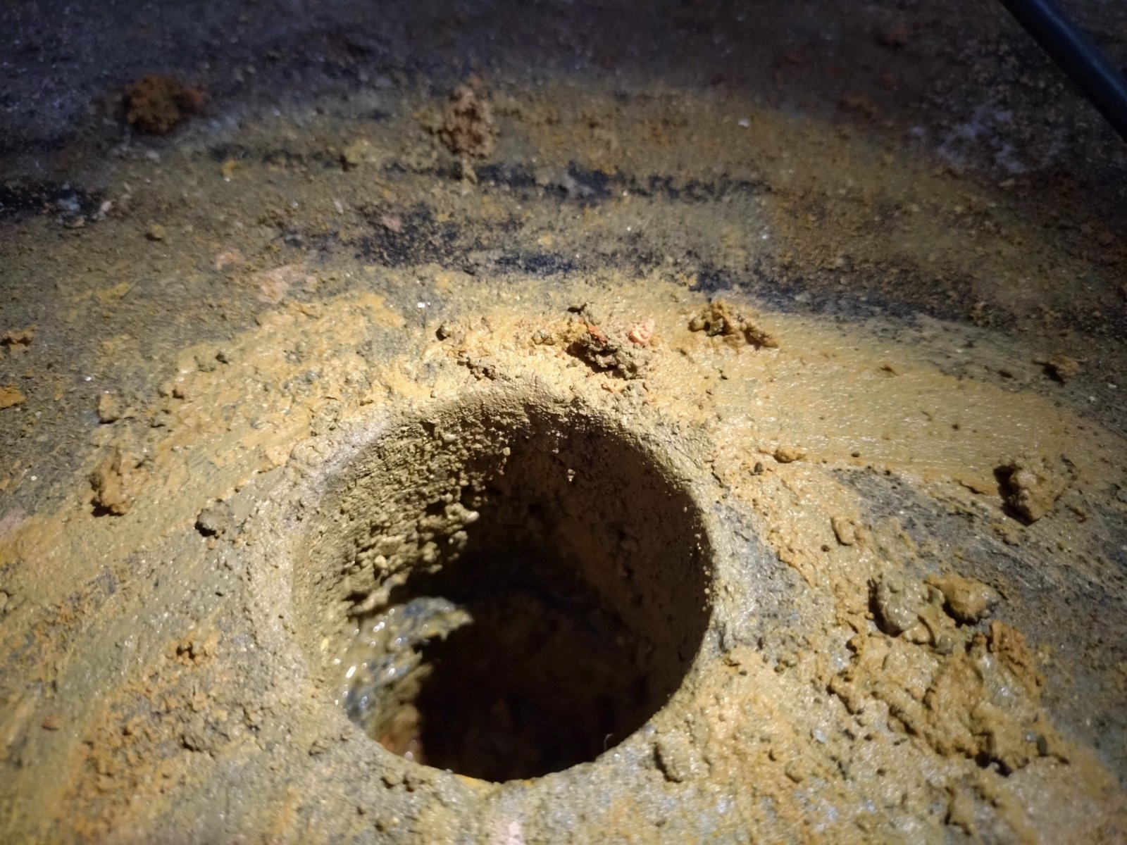

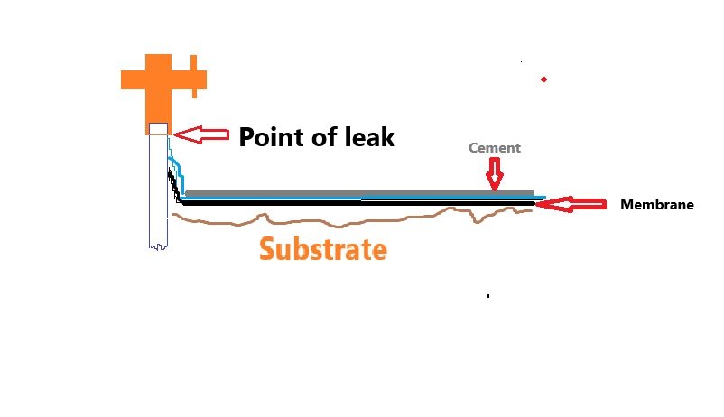

You remember the problem in Elstree:
mickthemaverick wrote: 29 Sep 2024, 19:56 Yes I did that and it seems dry below the dampcourse. I fear that because the membrane had been brought up around the water main the leak sprayed water onto the upper membrane surface which then seeped down across the membrane under the floor. Thus the only way to view it is between the concrete and the membrane and hence the need for a 'borehole' through the floor but not the membrane. Easier said than done of course but I'm not allowed to try!! :-D
Well I finally got agreement to drilling a borehole and was able to confirm the water is laying on top of the damp course under the screed. You can see the glistening water drops on the edge of the membrane :
The borehole
The borehole

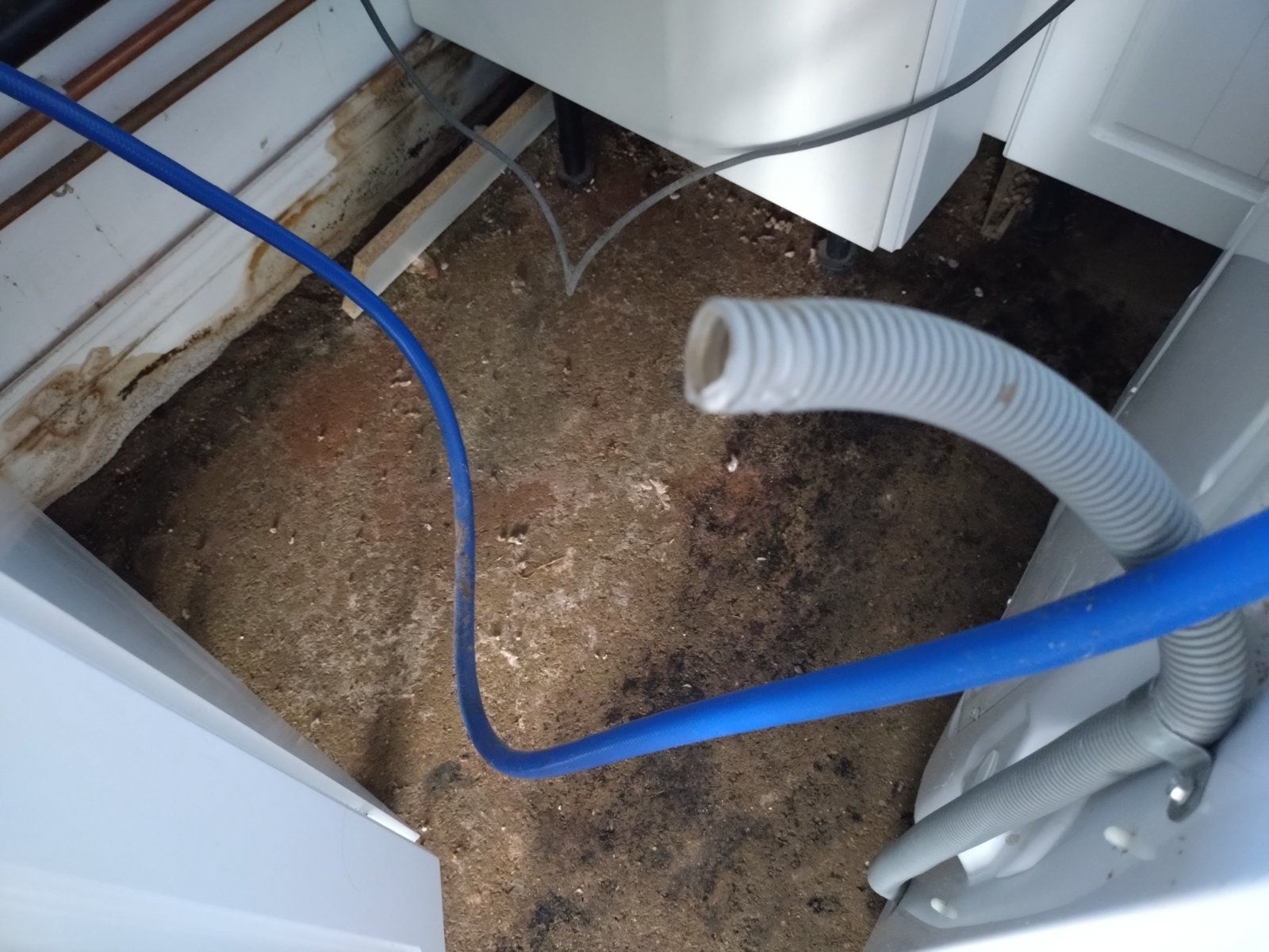

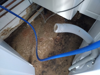

However I also discovered a second major source of flooding:
A broken washing machine drain hose
My own theory is that the hose may have been chaffed causing limited squirting and then fractured by the machine's vibrations as it broke at the point where the hose was fed through the back of the unit. A new hose is required and maybe then the floor will get properly dried at last!! :)

I'm surprised you drilled a core hole to find that out, a 30mm percussion bit would of told you that. Plus you went through the membrane and used water to drill the screed. I'm not surprised you found water you pumped it down there.
Posts: 21220
x 8124
Not with you there Ryan, how? :)

Even more bemused!! Used no water at all. Drilled through memrane to check insulation was dry, which it was so no problem from ground water. The water in the hole driibbled in from above the membrane after we withdrew the bit. The hole is 32mm, a percussion bit may have caused cracking in the screed around the hole so we opted for low speed hole cutter.
