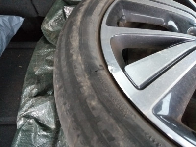

Seems I have forgotten how to drive, and I clipped the kerb going down the hill out of our town in the C4, and burst the NSR tyre. Oops. At least it has a spare, but I made a right meal of getting it out, I was fighting with it under the car to release the winch cable, seems if you keep winding there is more cable that will allow you to do it behind the car..... :roll: So, off to find a new pair of rear tyres now. It's not so bad, as they were quite well worn anyway, and I would probably have replaced with all seasons before the winter.

RichardW wrote: 13 Jul 2020, 08:29 Seems I have forgotten how to drive, and I clipped the kerb going down the hill out of our town in the C4, and burst the NSR tyre. Oops.
I think it happens to us all when we get to a certain age... :lol: I went for over 20 years driving without the slightest bump or mishap whatsoever, then in the last few years I've reversed (gently fortunately) into a barrier pole at Asda, (small dent in the rear right quarter on the Xantia) clipped the curb turning into our street a couple of times, curbing the rims slightly (both cars - to be fair it does stick out on an angle and is hard to avoid if there is a car coming the other way out of the side road) driven over a traffic island in the dark and rain, (Ion) driven directly over my lowered down parking bollard near work (resulting in a puncture in the rear left tyre - also Ion) etc...and that's only the mishaps I can remember off the top of my head. :lol:
At some point I think we just have to give up coveting our clean driving records and admit we're fallible no matter how hard we try. :lol:
Well worn ? Where's the tread ? :rofl2:

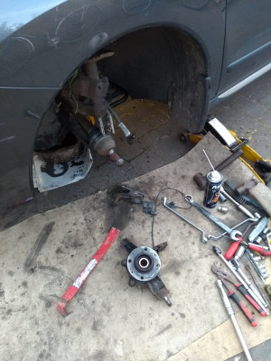

Finally got around to starting on the wheel bearing on the 3008. Only been putting it off for about 9 months.... :rofl2:
Hub is off, I will tackle the bearing in the next couple of days. Was a challenge to get the hub out - the driveshaft was a bit sticky in the hub, you can see in the pic it's a bit rusty - every time I tried to push the shaft out, the damn bottom ball joint jumped back in, and every time I re-split it, the shaft was stuck again!! In the end, I jammed the splitter in the ball joint to stop it closing it up whilst I got the shaft moving and then I got it disengaged enough to get it out without losing any gear oil.

RichardW wrote: 27 Sep 2020, 21:47 Was a challenge to get the hub out - the driveshaft was a bit sticky in the hub, you can see in the pic it's a bit rusty - every time I tried to push the shaft out, the damn bottom ball joint jumped back in, and every time I re-split it, the shaft was stuck again!! In the end, I jammed the splitter in the ball joint to stop it closing it up whilst I got the shaft moving and then I got it disengaged enough to get it out without losing any gear oil.
I know your pain so well :twisted: I seem to recall it was especially common on 205s...
Now to press out the old bearings... I trust you have a meaty hydraulic press for that....

New bearing fitted - today is a Bank Holiday in the Glasgow area, so I was off. We were going to go out, but it was miserable and rainy (and is not beautifully clear typical!) so I cracked on with the bearing. No press here, Jim - I've got one of those threaded pullers, they do work, but you get a work out in the process, no need for a cycle ride today! You can't get enough torque to break it loose, but they let go if you wind the tension on, and then support the hub and belt the end of the puller with a suitable hammer. This one was tiiiiight though! Just driving out the hub required a big hammer, and then a lot of persuasion before the bearing started moving. In the process however, I noticed that I had split the cover on the bottom ball joint. I pondered just fitting a new cover, but it has done 80k, it's on the NS, fitting a new one involves removing the hub, I don't need the car at present, and a new one is only £12 made it a no brainer to change it. In fact I had considered getting one in last week, as I have often found them to be have play when removed on this set up. Struggling initially to get the socket on (these need a deep 41mm socket) I wondered if I had wrecked the socket when I used in combination with an old cut off ball joint to remove the one on Simon's Xantia, but then realised it was the end of the thread that was fouling on the socket. A few moments with Mr A grinder, and it was no longer in the way :lol: Wouldn't shift to start with, but a short discussion with Mr B Lamp and it relented :mrgreen: New one on the way, so I can finish reassembly when it comes.
No more squealing from the C4 today!

Ah silence...😃 All back together, now quiet, ABS still in order. Dislodged the shaft a bit and about an egg cup full of oil dribbled out, not going to worry about that, fingers crossed the seal doesn't leak now. Still got to change the oil and refit the under tray, tomorrow maybe, as it's tipping down here today!
