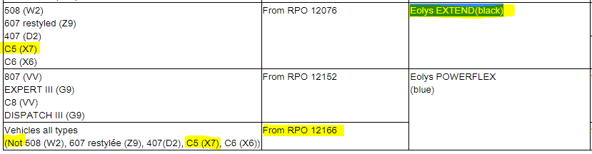

Sorry for asking, but this "right choise of" Eolys is making me crazy.
My car is a Cirtoen C5 (X7) 2.0 BlueHdi 2016.
VIN VF7**************[VIN obfuscated, can be read by forum staff]
RPO 14254
The connector is green.
The dealer gave me 3l Walker 80620 (Powerflex) and told me thats the right Eolys to use.
But I am not sure.. Is it not INFINEUM F7995 or EOLYS EXTEND (Walker 80618) I should use???
RPO 14254
- x 6945
Re: Eolys?
That's not correct. For the C5 X7 with your build date you need Eolys EXTEND. There is a specific note that Powerflex is not to be used for the C5 X7.

Oh, thanks for the quick reply.
I have jacked up the car and was almost starting to fill the tank today, but something told me this was the wrong fluid..
I got this Eolys from a well known Citroen workshop here, so I had no doubt he war right yesterday.. but the green connector made me rethink.
Well, seems that the EXTEND have a better price too =). Any differences on different brands? I see Walker is used frequently up here.
