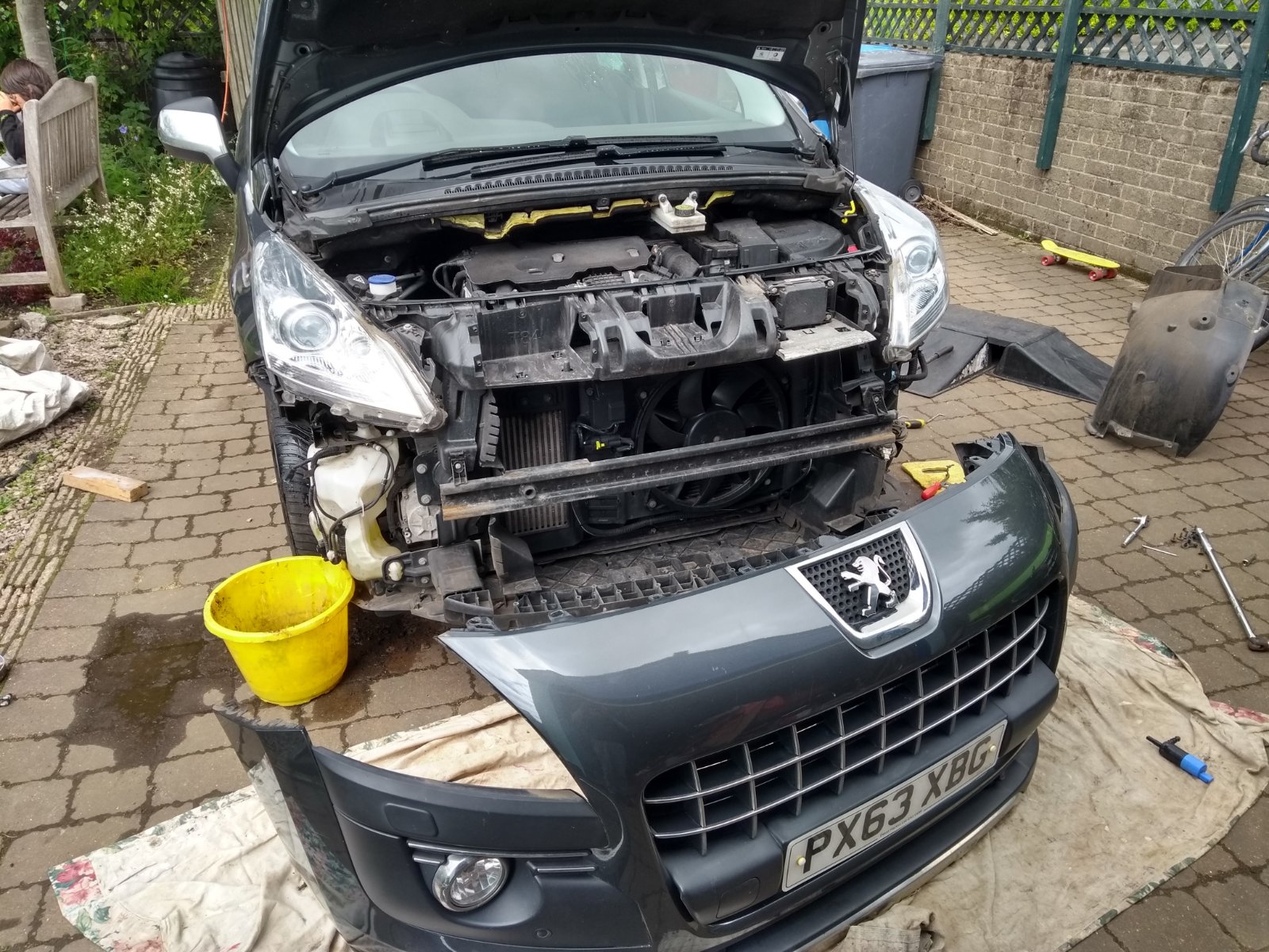

Got the front off the 3008 to have a look at the headlamp washer pump. Wasn't too bad in the end, once I found and released the clips along the top. Got most of the bolts out without too much drama, so it should go back on. Got volts on the terminals, so pretty sure the pump is U/S. I thought this was expensive, till I saw the price being bandied about for a replacement vac pump for Simon's Ion
! Thought I was onto a winner as I found some that were <£20, but on closer inspection they were very similar but had different connector on the top. Eventually found a genuine for £40 so not too bad - seems there aren't any aftermarket versions of this pump.
Still need to replace the wheel bearing, I might strip the hub off whilst it's in the drive and get one ordered up.

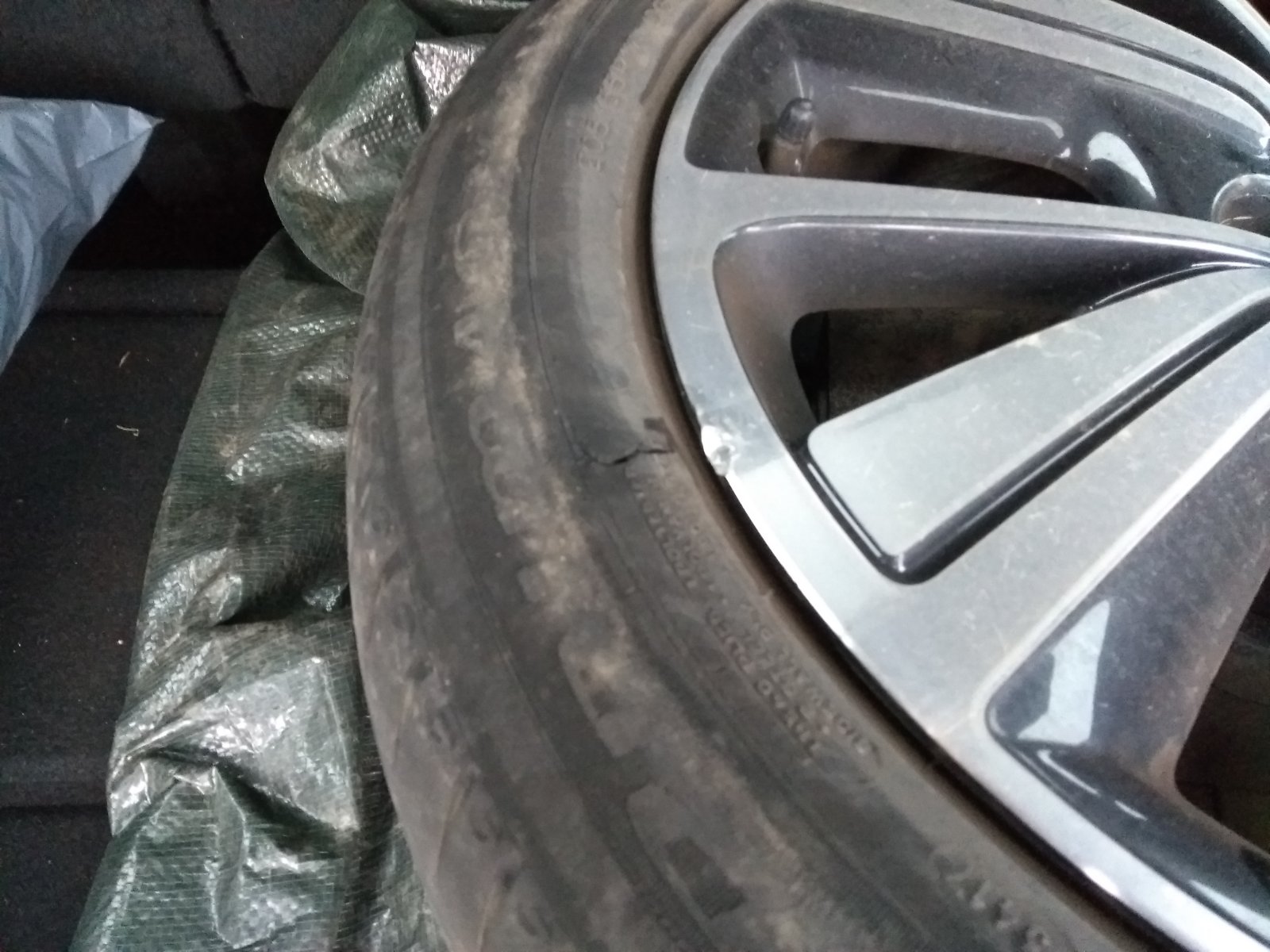

Seems I have forgotten how to drive, and I clipped the kerb going down the hill out of our town in the C4, and burst the NSR tyre. Oops. At least it has a spare, but I made a right meal of getting it out, I was fighting with it under the car to release the winch cable, seems if you keep winding there is more cable that will allow you to do it behind the car.....
So, off to find a new pair of rear tyres now. It's not so bad, as they were quite well worn anyway, and I would probably have replaced with all seasons before the winter.

Oh, and the much vaunted TPS 'safety' system failed to tell us we had a puncture
although it did get upset immediately we put the spare on!!

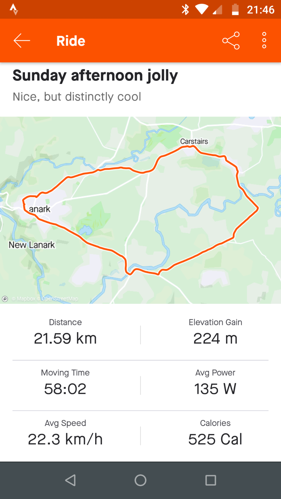

A short ride out with Dillon - he's not yet 12, but he's not that far off being faster than me - he can pedal really fast, so can get away from me on short climbs - but he can't hold it yet, and my 'superior'
weight means I am still faster down hill. It won't be long though
Later in the afternoon

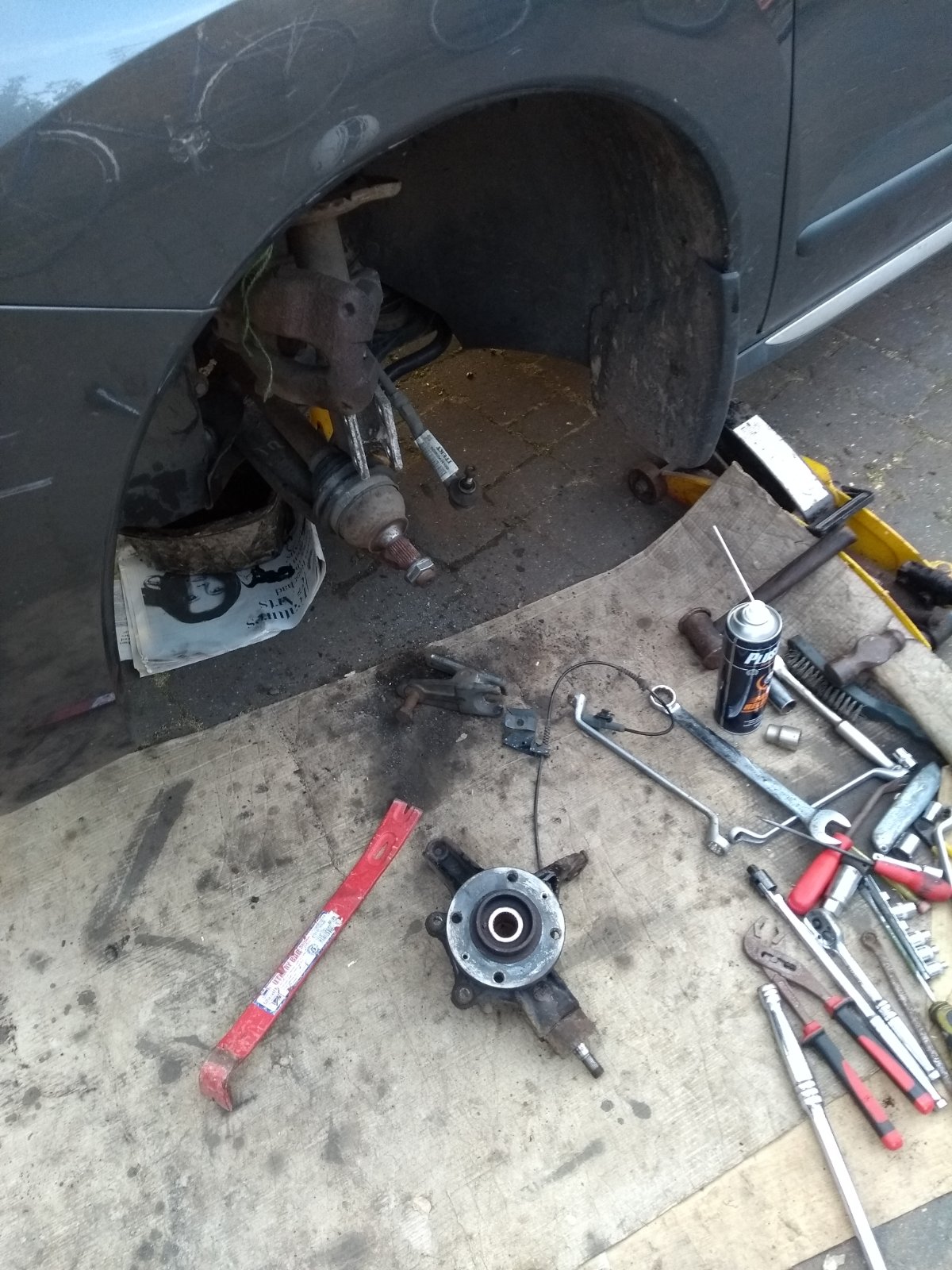

Finally got around to starting on the wheel bearing on the 3008. Only been putting it off for about 9 months....
Hub is off, I will tackle the bearing in the next couple of days. Was a challenge to get the hub out - the driveshaft was a bit sticky in the hub, you can see in the pic it's a bit rusty - every time I tried to push the shaft out, the damn bottom ball joint jumped back in, and every time I re-split it, the shaft was stuck again!! In the end, I jammed the splitter in the ball joint to stop it closing it up whilst I got the shaft moving and then I got it disengaged enough to get it out without losing any gear oil.

I know your pain so wellRichardW wrote: 27 Sep 2020, 21:47 Was a challenge to get the hub out - the driveshaft was a bit sticky in the hub, you can see in the pic it's a bit rusty - every time I tried to push the shaft out, the damn bottom ball joint jumped back in, and every time I re-split it, the shaft was stuck again!! In the end, I jammed the splitter in the ball joint to stop it closing it up whilst I got the shaft moving and then I got it disengaged enough to get it out without losing any gear oil.
Now to press out the old bearings... I trust you have a meaty hydraulic press for that....

New bearing fitted - today is a Bank Holiday in the Glasgow area, so I was off. We were going to go out, but it was miserable and rainy (and is not beautifully clear typical!) so I cracked on with the bearing. No press here, Jim - I've got one of those threaded pullers, they do work, but you get a work out in the process, no need for a cycle ride today! You can't get enough torque to break it loose, but they let go if you wind the tension on, and then support the hub and belt the end of the puller with a suitable hammer. This one was tiiiiight though! Just driving out the hub required a big hammer, and then a lot of persuasion before the bearing started moving. In the process however, I noticed that I had split the cover on the bottom ball joint. I pondered just fitting a new cover, but it has done 80k, it's on the NS, fitting a new one involves removing the hub, I don't need the car at present, and a new one is only £12 made it a no brainer to change it. In fact I had considered getting one in last week, as I have often found them to be have play when removed on this set up. Struggling initially to get the socket on (these need a deep 41mm socket) I wondered if I had wrecked the socket when I used in combination with an old cut off ball joint to remove the one on Simon's Xantia, but then realised it was the end of the thread that was fouling on the socket. A few moments with Mr A grinder, and it was no longer in the way
Wouldn't shift to start with, but a short discussion with Mr B Lamp and it relented
New one on the way, so I can finish reassembly when it comes.
