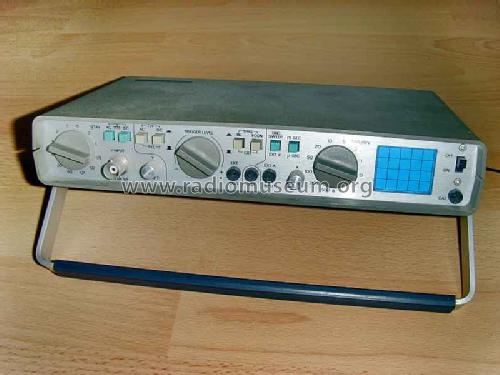

I still have one of these Jim, which I believe was a direct competitor to the Thander:
I don't remember exactly when I got it but it was probably the early 90's and it is still going strong. :)
Unfortunately the batteries are pretty knackered now due to lack of use leading to them sitting discharged for a long time.
They're 3x 2 volt cylinder shaped sealed lead acid batteries, (about the size of a D cell, but with spade connectors on one end) which as you can imagine don't like being left discharged! One day I will get some new batteries for it...
The three cylindrical cells are held in the rectangular box on the right hand side:
A rather nice little scope for 1976, dual trace chop or alternate, external triggering, auto mode, from memory it goes up to 15Mhz...
Simon

Hell Razor5543 wrote:Fingers crossed. [-o<
I managed to actually find the scope (!) and removed the batteries. They've sat for at least a few months since the last time I tried to use it.
Two of the three cells were 2.05 volts which is OK for sitting so long, the third was 1.85 volts which is suspiciously low. So either there is one bad cell (which would explain a lot) or the state of charge of that cell has got out of balance with the other two - quite possible when they are series connected and there is no balancing system like you'd see on a modern lithium ion series pack.
I put the charger on for about half an hour, and because the voltage was fairly low to start with it started off in its pulse charge rejuvenation mode. After that the two good cells were up to 2.20 volts and the "bad" cell had climbed to 2.00 volts. I also noticed that during each pulse the good cells were increasing by about 0.5v and the "bad" cell was increasing by only 0.2v. This is consistent with the good cells being nearly fully charged while the "bad" cell is still very discharged. (The voltage of a lead acid cell becomes more "flexible" when charge current is applied the closer to full charge it gets)
So at the moment I'm going to work on the assumption that the cell is actually ok but it's state of charge is way lower than the other two - so I have now stopped the charge and put an 8 ohm bleeder resistor across the two good cells for a while to bleed them down to the same charge as the other one to do a bit of manual cell balancing. Once their open circuit voltage is balanced I'll put them all back on charge again.
Fingers crossed. :)
