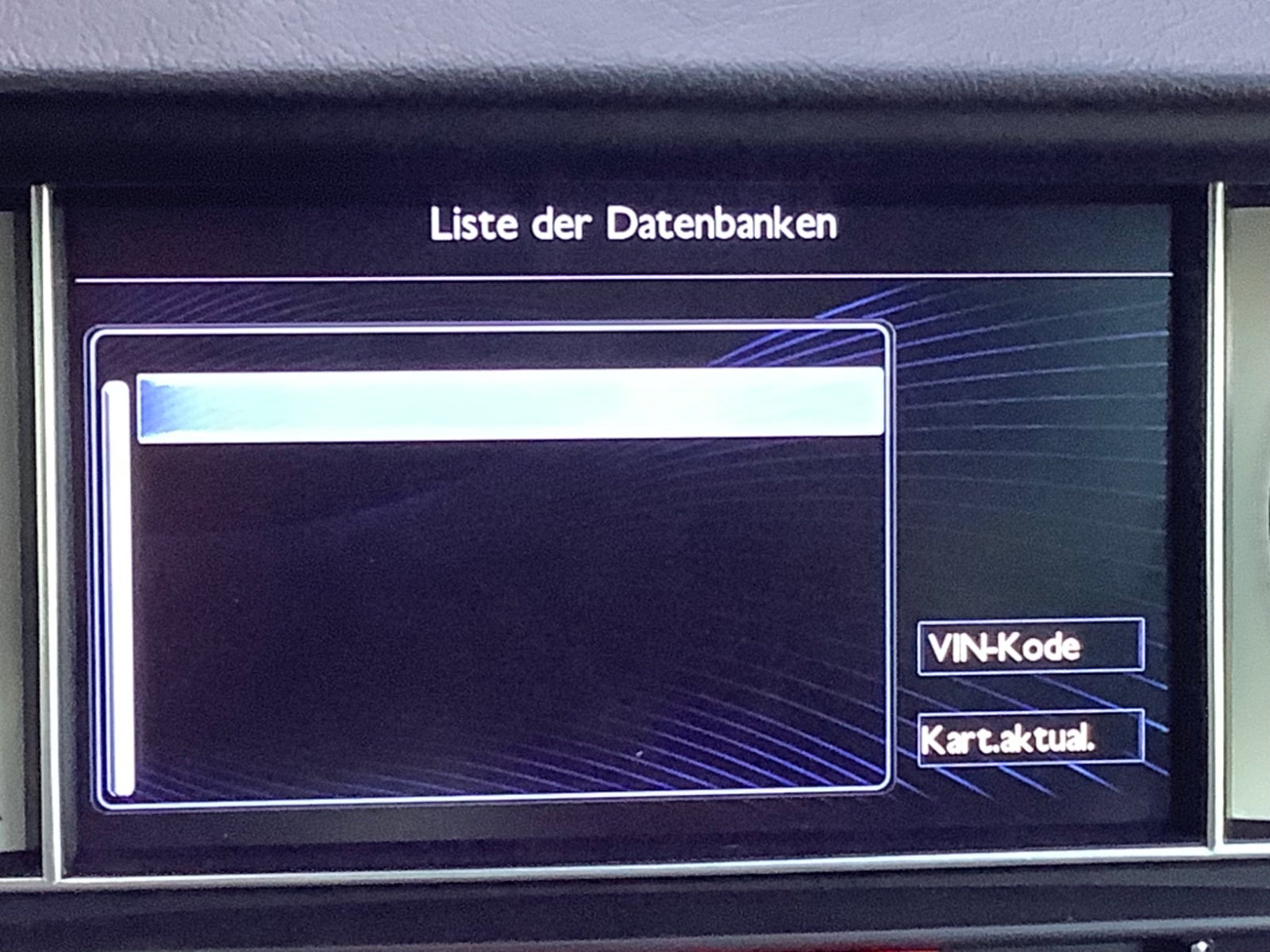

The maps one the old SD card aregone, since corrupt dueto the SD card falure. So I bought one from the website you proposed. Then copied to the USB stick following the installation instructions. However when attaching the USB stick to the RT6, the map installation opens with an empty list. After complaining, I was told that these maps are just upgrades and I have to perform a base map installation through a certified dealer. The picture attached shows the empty list presented by the RT6 when inserting the USB stick containing the purchused map data. No map can be selected! It seems that the RT6 is searching for maps already installed. After replacing the SD card, obviously none are present. Would be nice if someone could help me getting out of this loop hole.

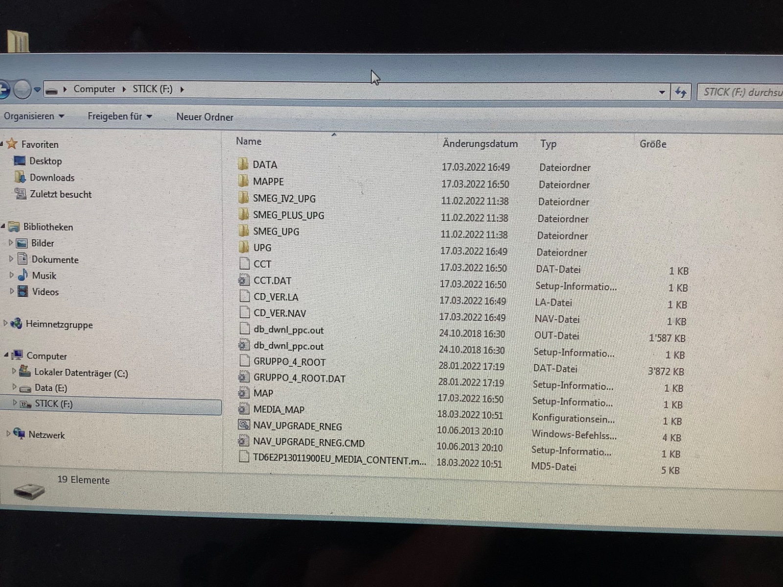

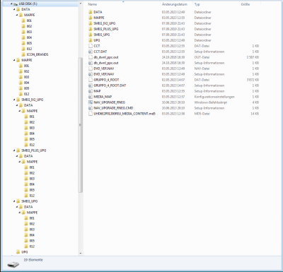

Here is the screenshot of the USB root directory.
Best regards
Best regards

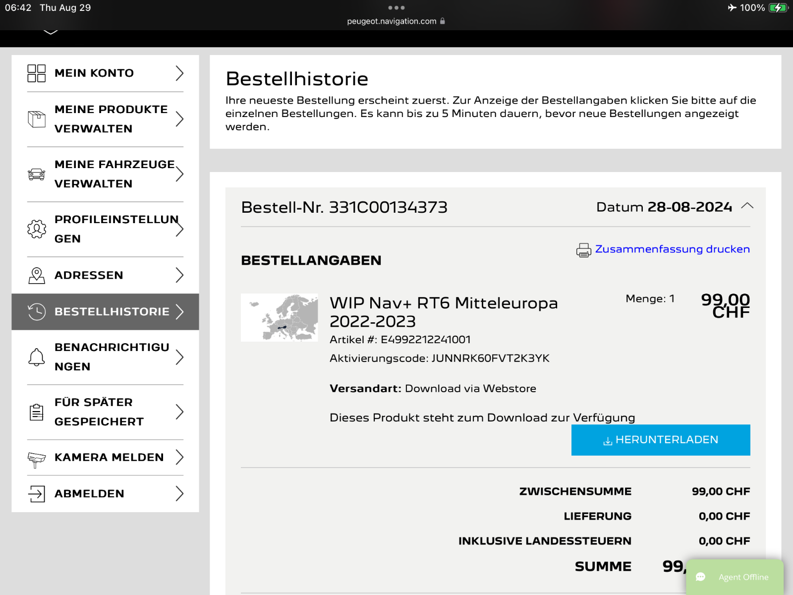

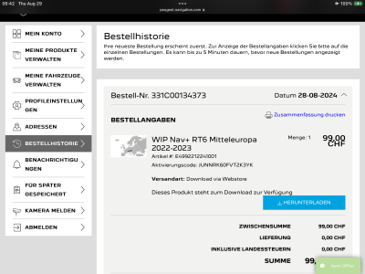

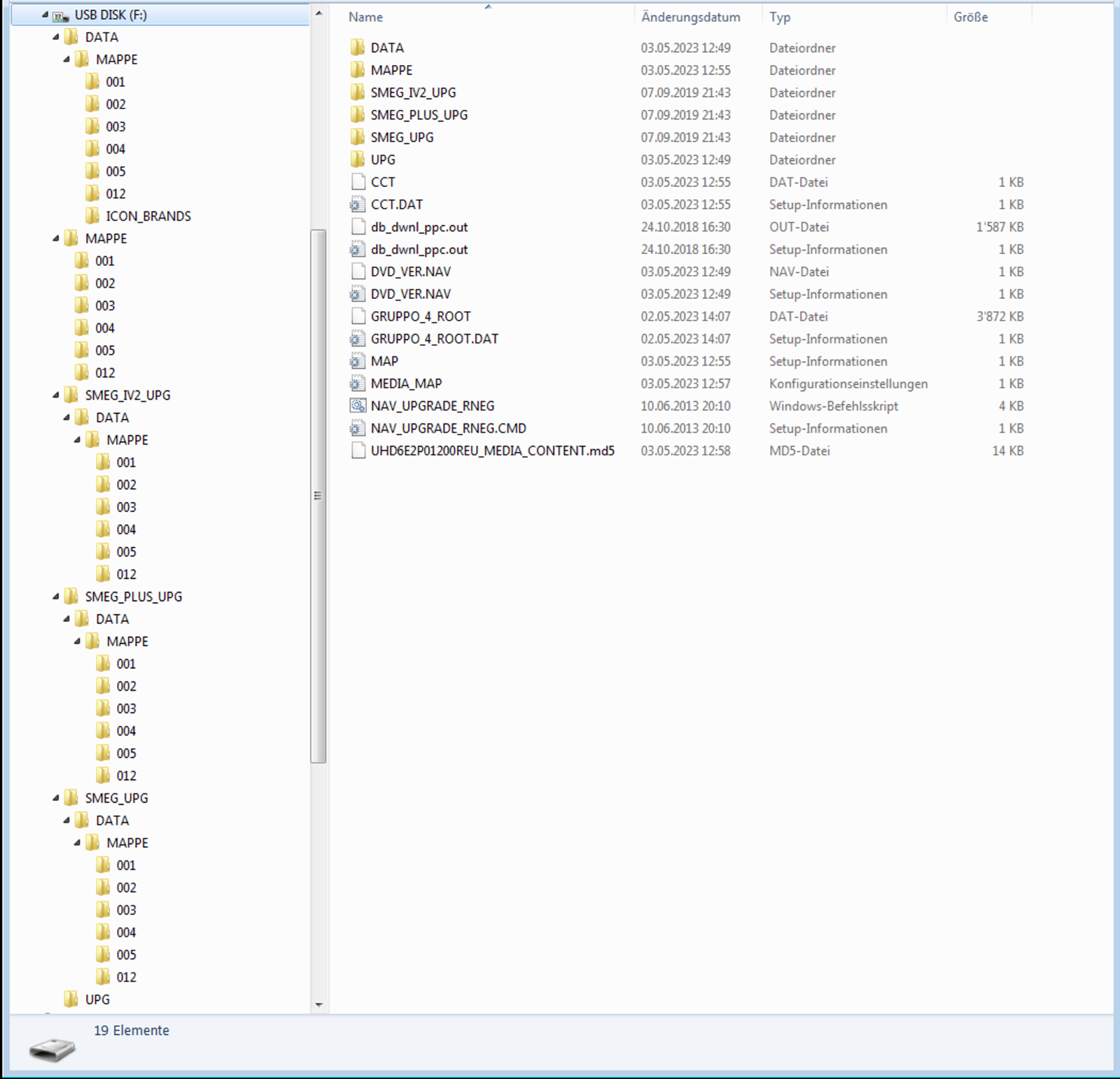

And here is a screenshot of the receipt of the map I have purchused from that website.
Hope that I manage to get beyond that empty database screen from the RT6 during installation.
Many thanks & regards

Also, you need to alter your view settings so that you can see hidden folders and file extensions.

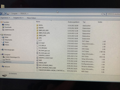

Please find attached a more detailed listing of the USB Stick content. Hidden files and folders are turned on.
I wonder how the menu screen of the RT6 looks like if they are installing maps on a system containing absolutely no maps i.e. after installing the firmware 2.86 on a new Sd card. Does anybody on this forum remember the screen dialog of the RT6 when connecting the USB stick containing the maps? Does it looks like the same as shown on the picture on the previous post?
Best regards

The file extensions are still not showing. For example CCT.DAT is really CCT.DAT.inf and CCT is CCT.DAT!
PM following soon.
PM following soon.

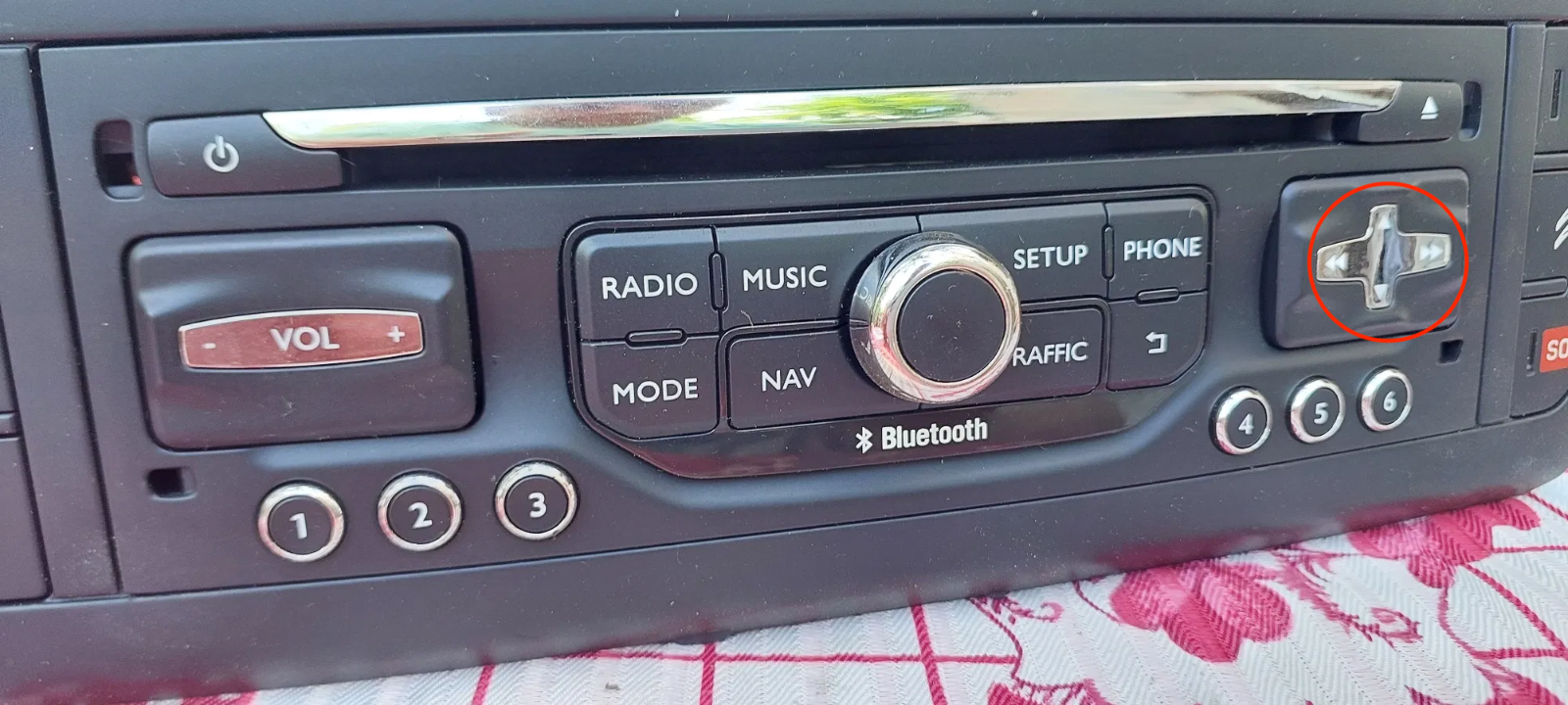

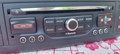

When the RT6 presents the empty list, all you have to do is to switch to "Kart. act." (German language for map actualisation). However, in order to do this, you do not have to use the jog/dial knob on the RT6! Instead, you have to use "cross shaped" button on the RT6 as highlighted on the attached picture. I did not came to this idea, since normally on the RT6 you navigate through the menus always with the jog/dial knob.
