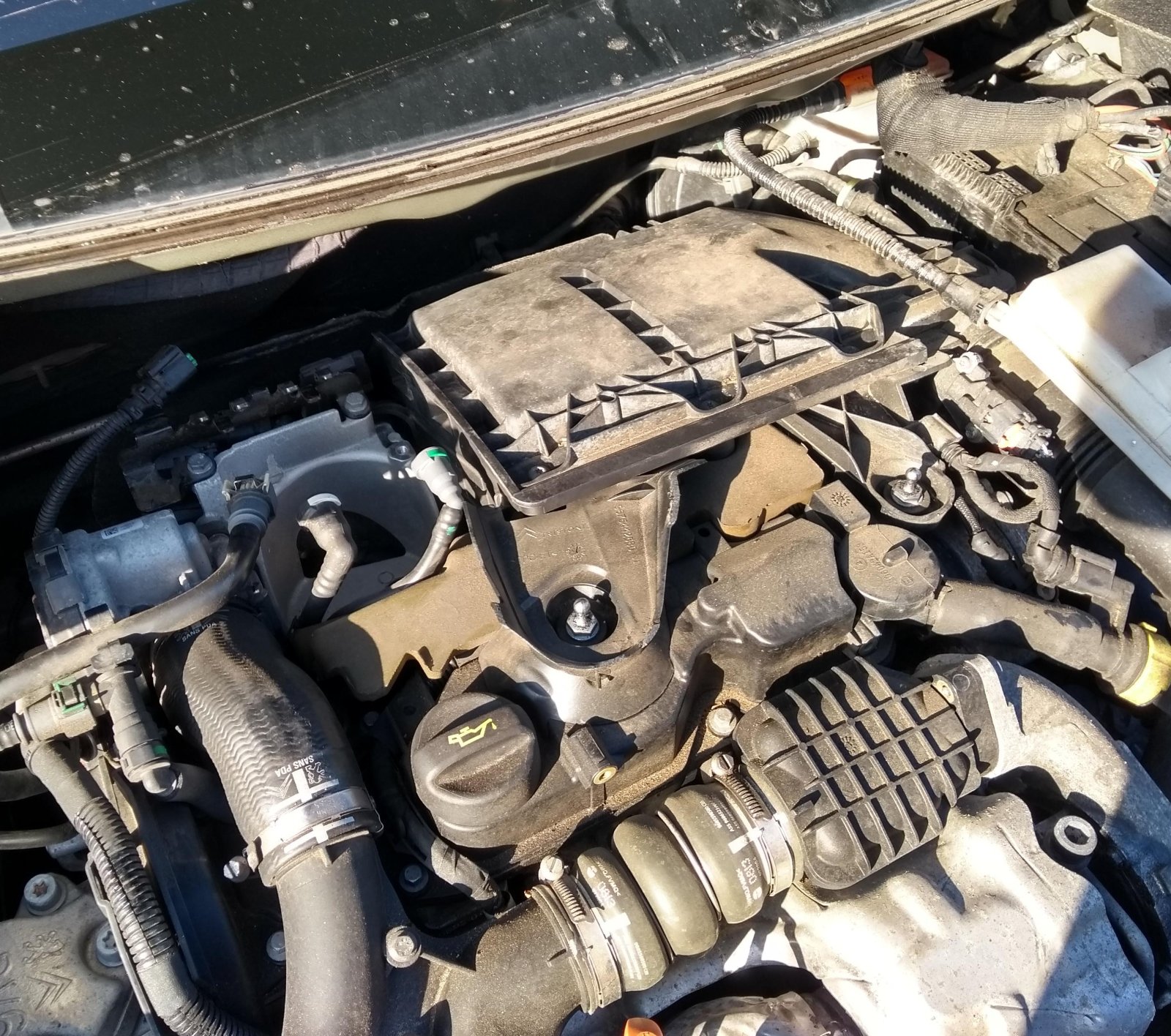

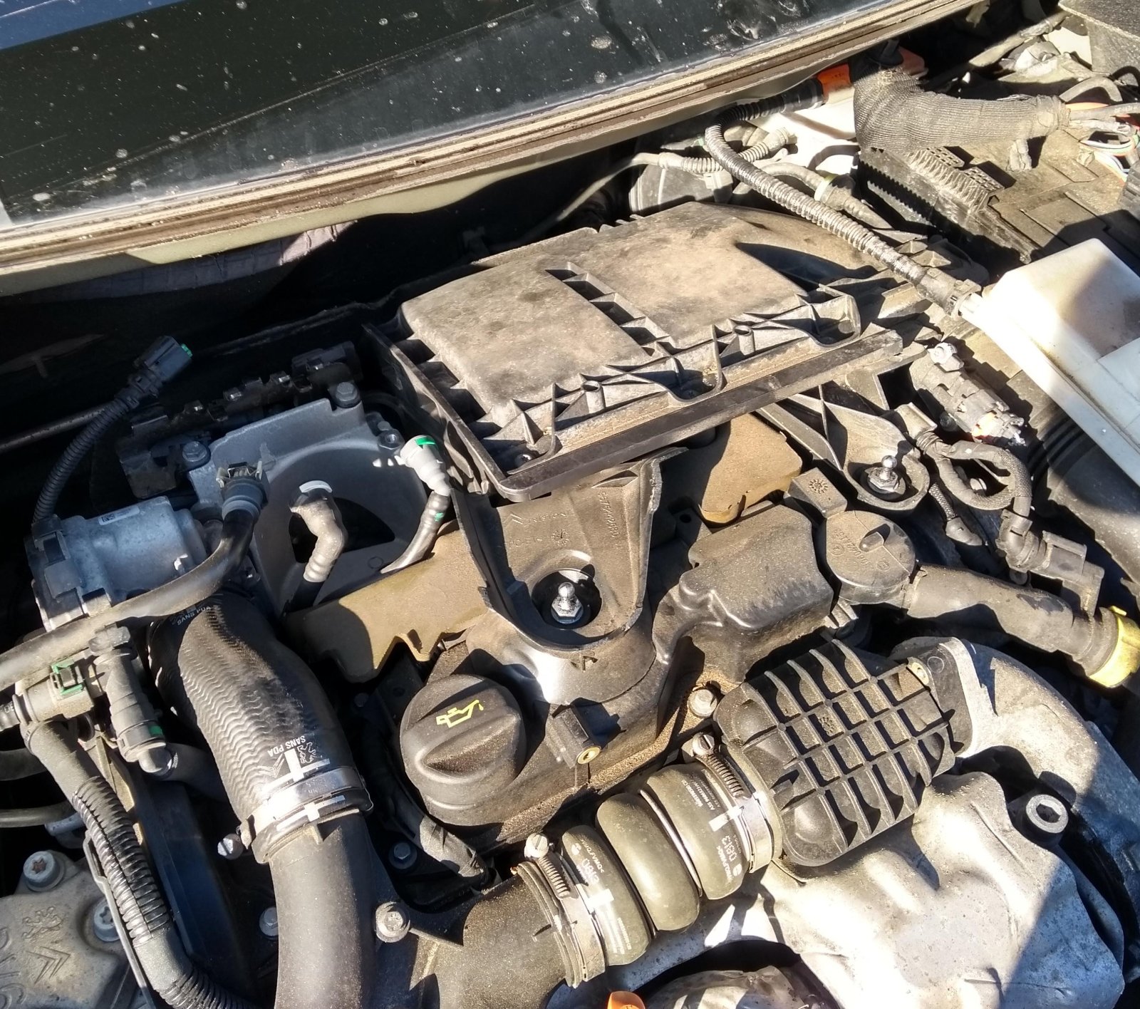

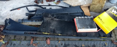

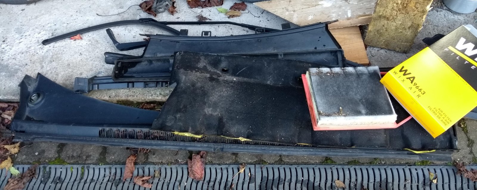

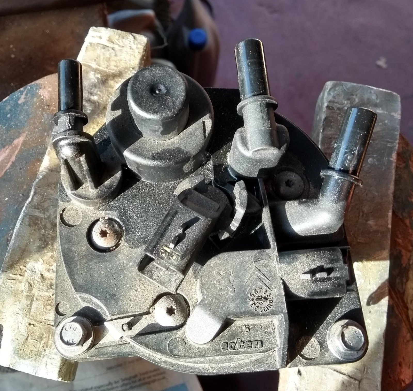

Set off to tackle the fuel filter today. If you remove all these bits
(Wipers, scuttle, end pieces, air intake duct, insulation)
Then you get a pretty good run at the top of the engine to change the air filter, and remove the fuel filter
However, in order to actually change the filter you need to undo these 3 T15 Torx screws on the top of the filter:
However, whoever did this last time, tightened them up like a gorilla, and they are not for shifting. My first effort just snapped the end of my Torx bit. Then I tried a bit more carefully, giving them a good tapping with the torque on, but couldn't move them, and the torx bit was just twisting the end off! A new lid is just over £100 from Pug - you can buy the bolts separately - but they are £7.85 EACH :shock: I did think about drilling them out, but I didn't have any suitable replacements. So, put it back together, and then maanged to snag a complete unit off Ebay for £43 - which is not that much more than I paid for just the filter bowl part. So put it back together for now, will need to get all the top off again another day.... :roll: Stuck a new battery on as well while I was there - managed to get a Yuasa 5000 off Amazon for £88, so that's pretty good. That was pretty straightforward, once I had figured out how to spring the clip to get the charge unit off the top of the battery cover. Hopefully it will be less reluctant to start on cold mornings now.

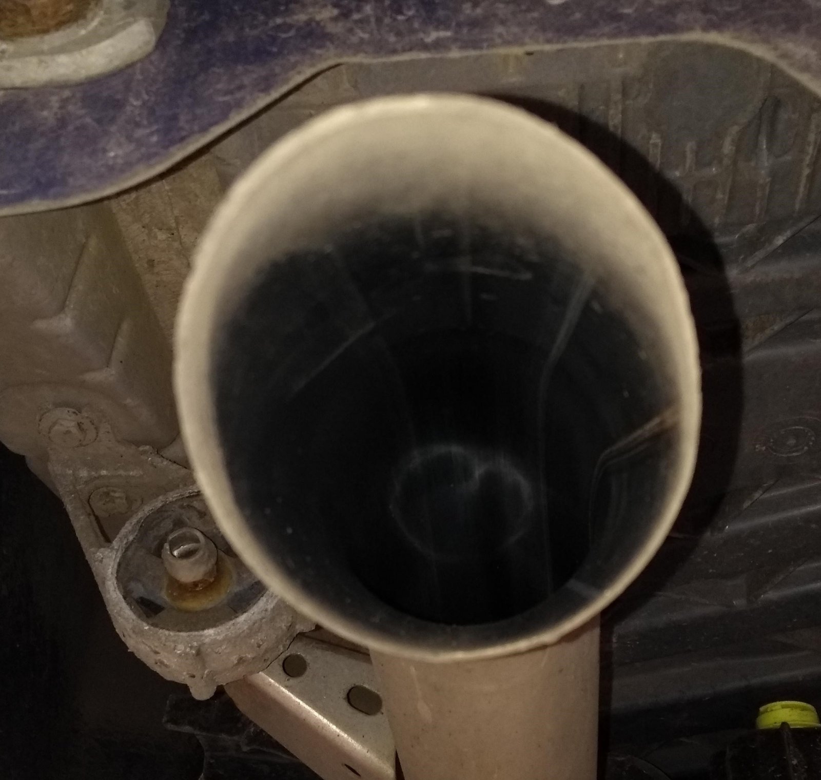

Cleared out the Picasso today as it is off to the body shop later in the week, and had a go at freeing the towball off - it's supposed to be removeable, but it was never easy to get off, and then after it had been on a couple of weeks (like about a year ago!) it wouldn't come off at all - thought I should try and free it before it gores to the body shop. The ball / swanneck is fitted into a socket in the bar, which is only held on with two through bolts, so it was easy enough to get the ball and socket off. With it in the vice, it was obvious how it was supposed to work - there is a pin up the centre of the swaneck which jams the neck in the socket. A quick tap with a hammer on the pin, and it came out. Gave it a generous greasing and it is easy enough to fit and remove now; a smear of grease called for each time it is fitted I think. Whilst I was there, random photo of the day...
20k miles, inside of the exhaust is still shiny - pretty clean these Euro 6 motors.

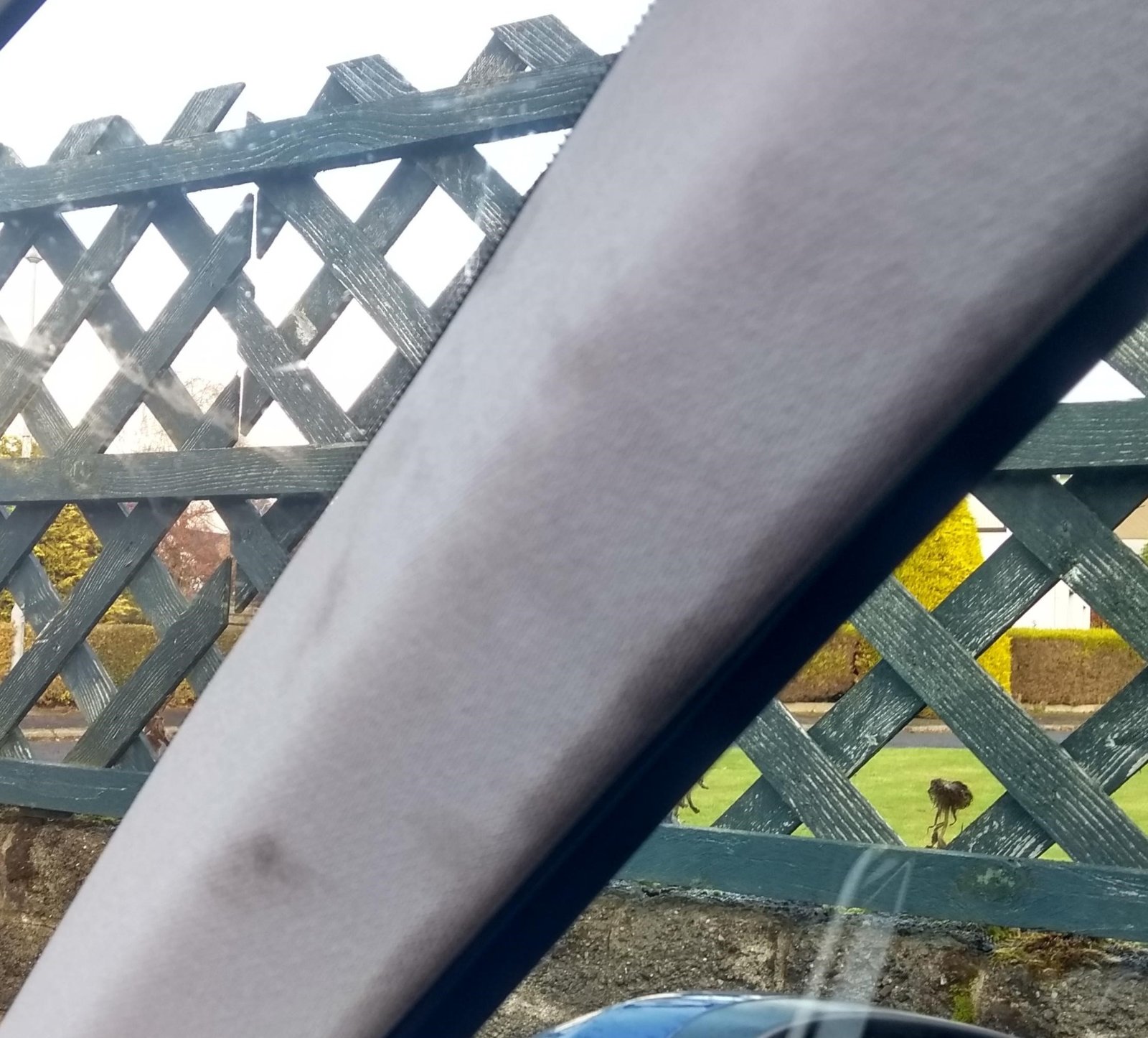

Picasso back from the the bodyshop all fixed up, but then it went off to get its 2 year service, but came back with this unwanted addition
A large oily hand print on the A pillar trim :roll: The trim is faced with headlining like material so it's not going to be easy / possible to clean - I looked up a replacement, £250 :shock: I've e-mailed the service manager, but he hasn't got back to me, so I'll need to keep pressing. Obviously I want a replacement, but I suspect they will try and clean it, given the replacement cost.

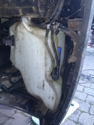

I have realised the headlamp washers have stopped working on the 3008....which will be an MOT problem as it has HID lamps. Couldn't find a fuse listed in the handbook, but the wiring diagram for the C4 Picasso / some Google activity suggest F4 (which the handbook references for DRL). Pulled it last night in the dark and it looks OK. Investigation under the OS wing required - hopefully it doesn't require the front bumper removing as that will be filled with rusted bolt pain no doubt!!

It is just as likely to be a failed/gummed-up pump.

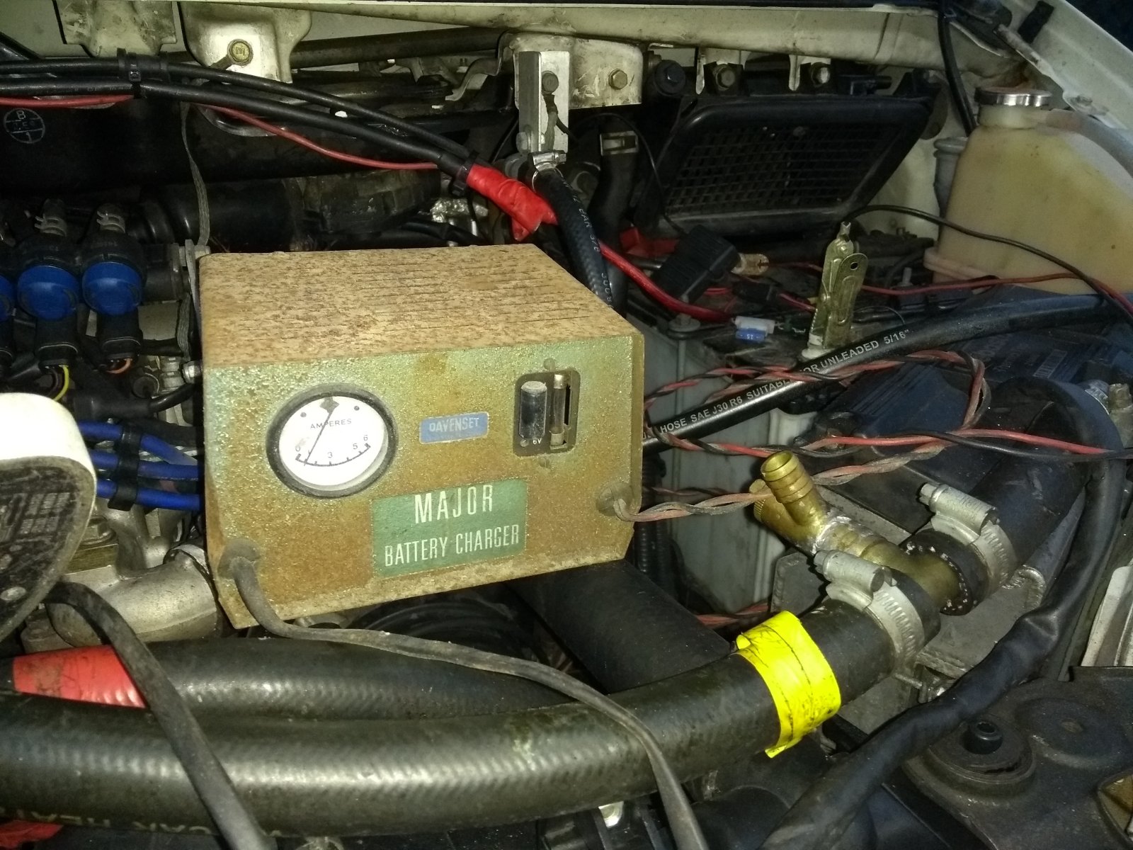

My mate was here at the weekend and the battery on his van was giving trouble. Dug out my antediluvian charger
:lol:
but to no avail - even after nearly 24h on charge still not enough juice to turn it over :roll: . Jumped it, and he drove home vowing not to stop the engine - new battery now on order.

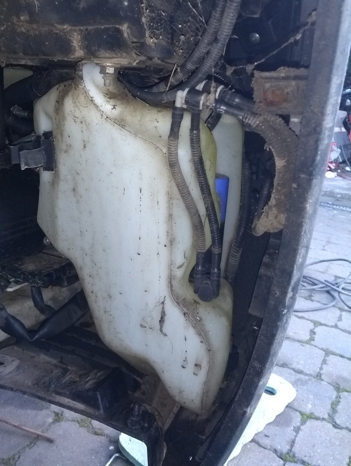

Looks like he washer pump is a bumper off job :roll: . Wrestled the wing liner out, and here it is (blue top)
I could probably lever it out, and then I might be able to get the cable off, but getting it back in looks nigh on impossible. I got the bolt out of the end of the wing, and the ones under the front edge are moving (well except the one that sheared off as soon as I touched it!) so getting the bumper off might not be that hard. Then again.... It can wait till the spring, or at least till I have a longer day, and hopefully a bit warmer!

Re: Confessions of a Citroholic
Grease marks on headliner-like surface . . . Try some bio clothes washing liquid in a little warm water, and a gentle nailbrush. Bio liquid shifts dirt/grease/grime (even oil-based paints from brushes) really well. Water needed with it to activate the enzymes.

I'm taking it up on Friday to see what they can do - but if it's not completely clean, then I will loudly be campaigning for a replacement!

They managed to remove the handprint easily, duuno what they've got in the Valeting bay, but it works. Kind of suggests that they do that sort of thing all the time, but catch it before the customer notices!
