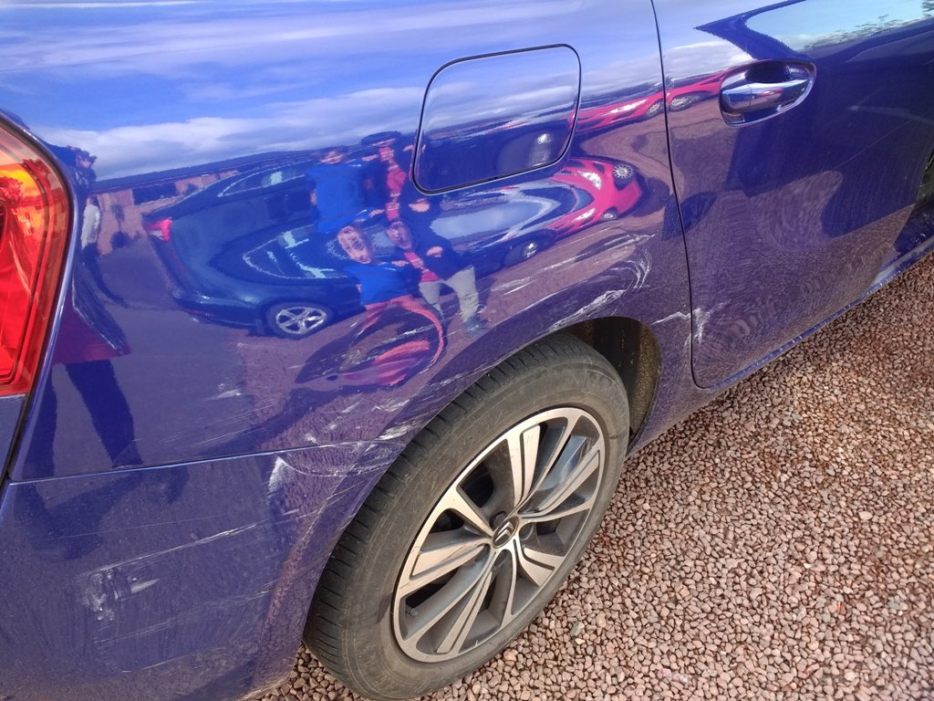

Appears to be a damage magnet this car....
Parked up at the time - fortunately the guilty party left their details, and has agreed to let their insurers handle it. It's not as bad as it looks, much of the whiteness is in fact muck, and the scratching is not that bad, but there are a couple of dents - no creases though so they should pop out. Might mean we can get the bumper re-painted, and pick up the scratches we put in the other side of it!

Oh dear.RichardW wrote: 01 Oct 2019, 07:26 Appears to be a damage magnet this car....
I feel your pain. My pristine at the time 8 year old Xantia 2.0i VSX back in New Zealand was parked in a school car park one day when I had gone there to do some work on their computers, it wasn't until I got home that night that I noticed that there was quite a big, broad dent and a long scratch just below the plastic strip on the drivers door that could have only happened when it was parked there, and was clearly caused by someone entering or leaving the adjacent park and scraping their way along the door as they angled their car...
I was not chuffed as I was only there in the first place on work business using my own car...

At least she had the decency to leave her name - their insurance co is handling it no problem - they rang almost immediately the claim was put in, local body shop will do it, and they will provide equivalent hire car for the duration. Just waiting on the body shop to arrange a date with us, I expect it will be a few weeks before they can get it in.
