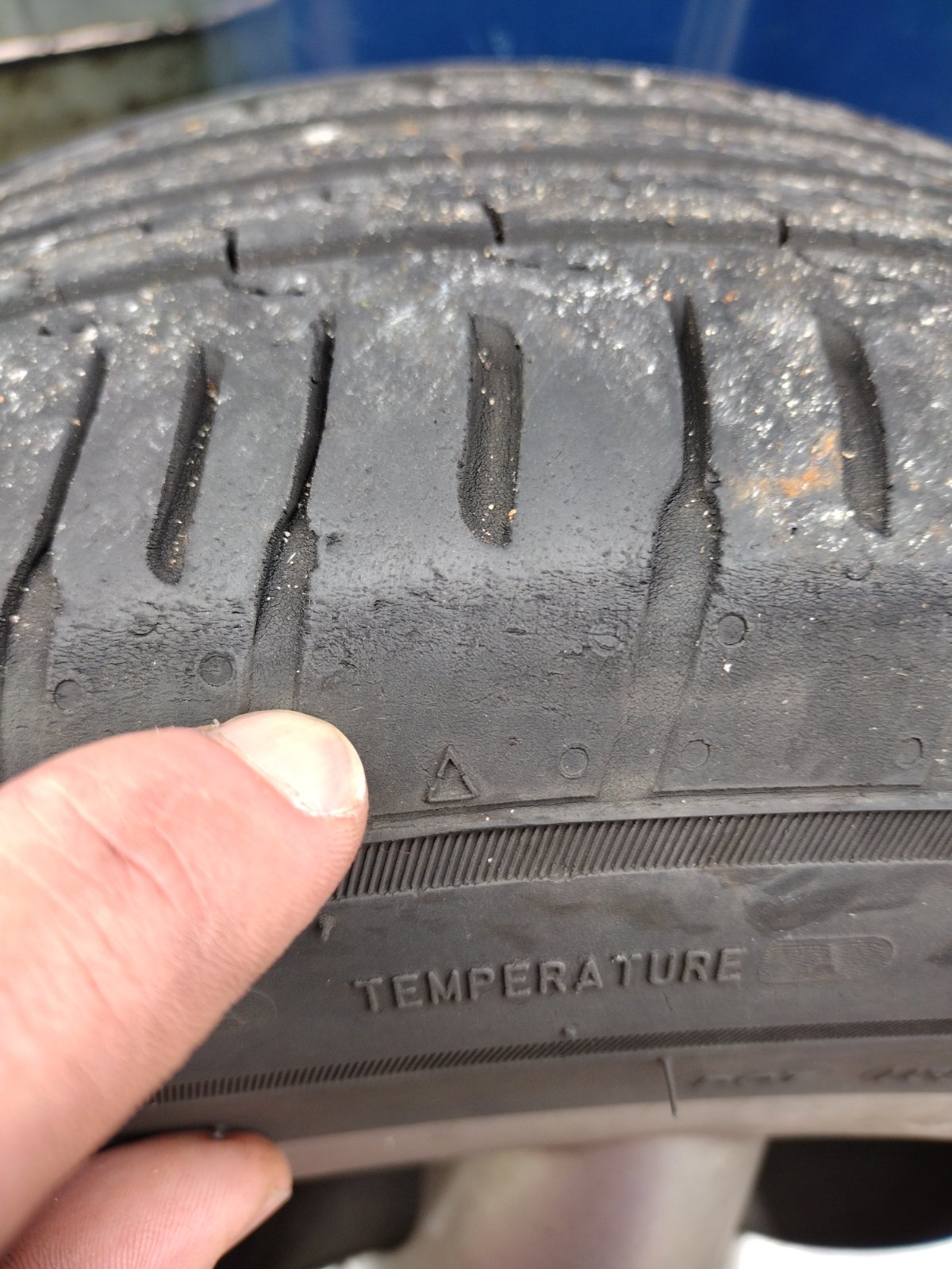

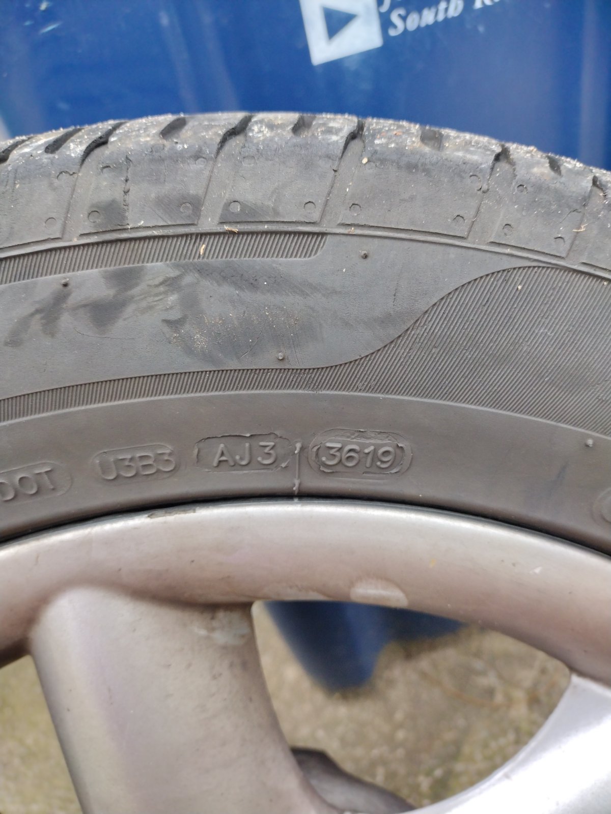

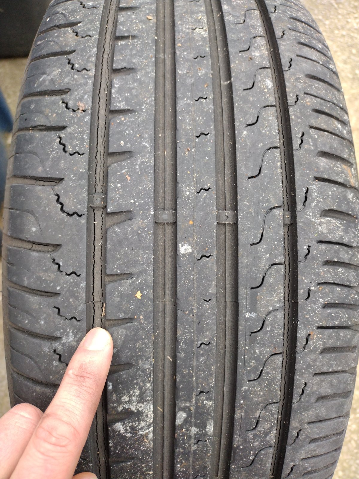

Last MOT had advisory for tyre cracking, what's the collective view on these? Tread depth ok, date code 3619 ie halfway through 2019. Avon ZV7

P.s. the squiggle to the left of my finger is part of the tread pattern obviously! Sidewalls look good to me

Change it - it may or may not fail but the consequences of a failure may be minimal or catastrophic but not worth the risk - life could be threatened!!

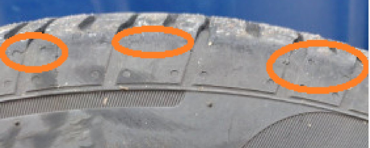

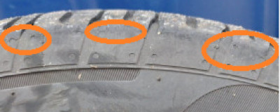

Blown up you can see minute cracks beginning just under the tread which could meet up with the inline cracks causing a delamination. Definitely change it!

Thought it'd be the expensive one of the two routes forward!mickthemaverick wrote: 26 Nov 2023, 11:52 Change it - it may or may not fail but the consequences of a failure may be minimal or catastrophic but not worth the risk - life could be threatened!!![]()
Think it's MOT failure territory? (booked in for the 5th, so time to sort tyres before then if not)
I'd hoped to get these to last a little longer (and give me breathing space to clean, sand and respray the wheels to get them looking their best, or less tatty anyway)

I'm not sure if the microcracks on the wheel edge are infact just scuffs from chucking it round corners (it's a fun car to nip about in, and, well, I do!!)

That will depend entirely on the tester, some may fail it as it was reported last time, others may report it again, but regardless of that I'd change it for your own safety!!MattBLancs wrote: 26 Nov 2023, 12:07

Yes chucking it about may well be the cause but that doesn't really matter, the fact is cracks only grow, they never reseal so the tread structure is weakened which is where the danger lies!! You should have seen the state of some of my rally car's tyres after a single road rally!!

Surprisingly the 2017 vintage "Autogrip Grip200" on the back have no cracking in the tread root and generally look in good health.
6 year old tyres I'm well aware are ready for a change in age grounds alone, so was a surprise to find the newest ones are perished and the cheap rubbish is ok.
Hmm, think I'm up for four tyres here!

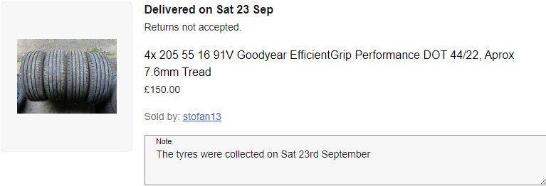

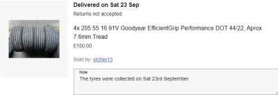

As I posted elsewhere I got a set of almost new Goodyear Efficient Grip Performance tyres for the Subaru in September and so far they have been excellent in both wet and dry conditions. The AWD feature of my car may help or hinder, I don't know, but I am very happy with the £150 I spent!!
