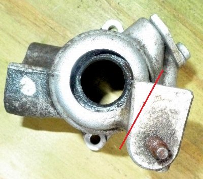

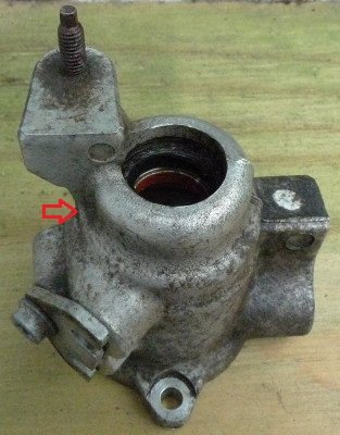

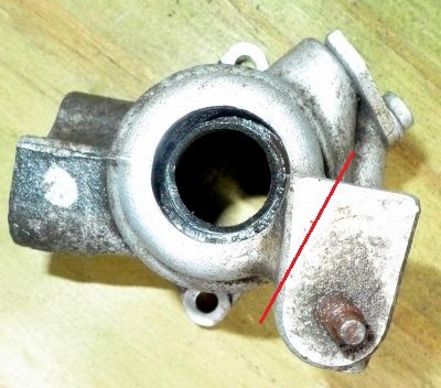

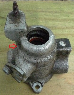

I shared those thoughts, Bobbins has kindly sent me the pinion housing and some power steering pipework to study, and the minute I een the pinion housing, I had exactly the same ideas as you.white exec wrote: 13 Jun 2018, 18:12 Slice off...
Round file away the thin rib...
Remains of the lump will help keep gaiter - and a clip - in place.
Just an idea.
Thanks for posting all the extra photos.
