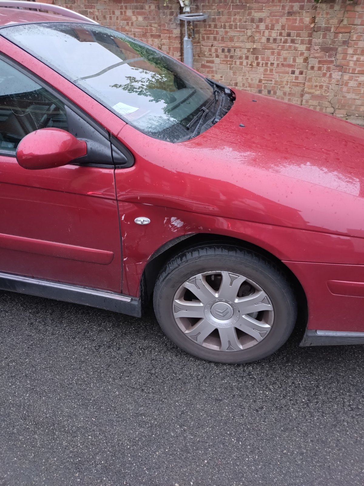

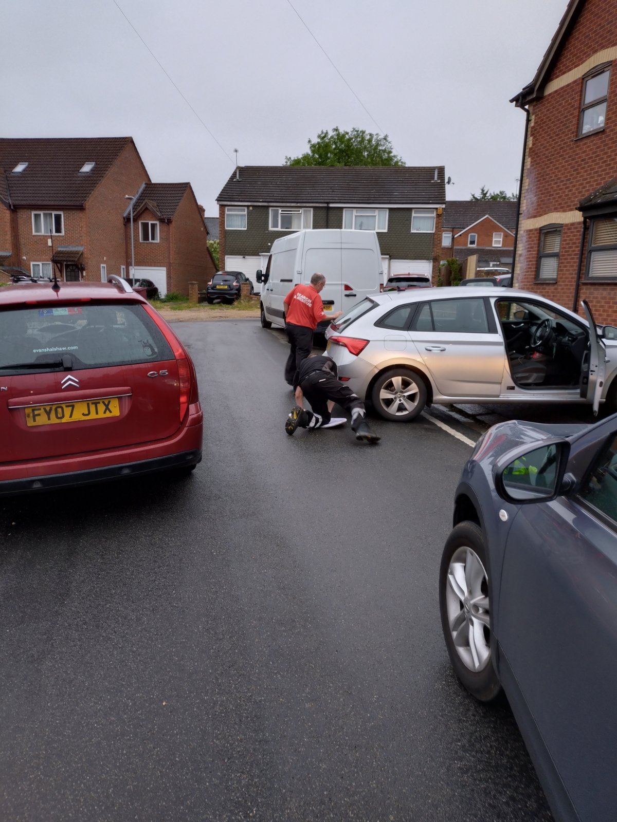

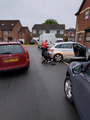

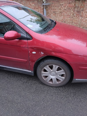

Somebody just reversed into my C5! I was driving up a residential road in Reading this evening when I spotted a Skoda reversing out to my right. I leaned on the horn, stopped, but they didn't. Not a heavy impact, but the front right wheel was involved, and there is now a 'thrumming' when she is driven. I have dash cam footage, but I need a lot more photos of my C5 (the insurance company want 360 of the car, and I need some closeups of the wheel and the witness marks).

I have heard from Avia (who are behind Quote Me Happy, who I am with), and they are wanting to go down the write-off route. I really want to keep her on the road if I can, as she is very comfortable and (unusually for an estate C5) has sports functionality on the suspension.
I have started talking to the mechanic who sorted the engine after the timing belt jumped a tooth. He said he can have a look at her soon. I am also trying to source the bodywork parts I need. Fortunately the wing bolts onto the car, so that makes things a lot easier.
