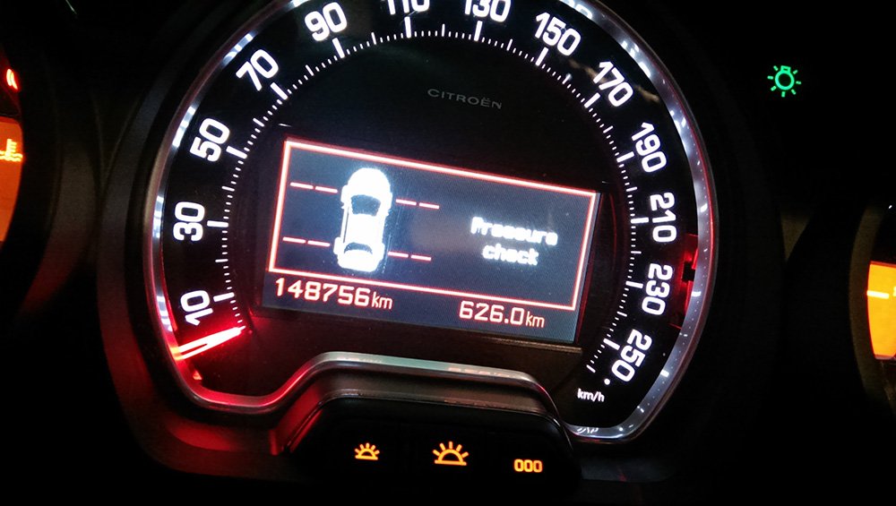

A bit of a surprise today while driving ...regarding the TPMS system, I'm still at the phase where the TPMS ECU is connected and programmed to the BSI (no antenna connected to it, yet, and no TPMS valves) .. during the drive today, out of nowhere, a SERVICE message appeared, informing me that the tyre pressure(s) aren't monitored, and then a separate message for each wheel ... after connecting the TPMS ECU to the car, I did some 1000kms (intentionally leaving the half-finished job to see what the car will think about that ...
) ... now, since the TPMS was properly configured, I could get the related page while pressing the CHECK button ... and I'd get the not monitored error, but nothing else ... now, I get the not monitored error and all 4 wheels as separate error messages afterwards ... I think the car is now ready for the next phase . the antenna, and getting the TPMS valves ...

I get that same error after 40-50km when driving with my winter tyres (without sensors) and TPMS activated. It is pretty annoying to drive in the dark with this because the service light stays in the dash....
Btw. how complicated it would be to add sensors to winter tyres?

The TPMS system allows for 8 sensors (or 9 - spare, not sure exactly) to be registered to the car at a time ... the sensors can be added (haven't tested it for myself) to the car without the 433 MHz activator/exciter ... you just need to input the sensor's ID (printed on the sensor) and add it to a slot ... the car should do the rest in time (it takes a while for the sensors to activate themselves during the drive), and then the positions get stored as well (I don't know how this should actually work, but I'll try it for myself once I get the antenna connectors and a TPMS valve - I actually obtained one temporarily for testing purposes) ...
I'm wondering, by which Citroen logic, my half competed TPMS decided NOW is the time to start working properly ... what took it so long ...

I had TPMS unactivated during winter, and when I activated it after changing to summer tyres, it took only couple of kilometers after it worked properly.
