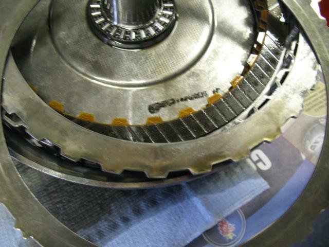

After a relatively quiet day yesterday, it was down to business today. Whilst we were reasonably confident the torque converter had failed, it was vital to open up the gearbox and have a check. After a fight with a couple of corroded bolts, those nearest the front of the 'box in direct lime of salt sprays, the 'box came apart.

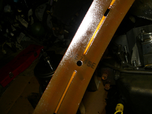

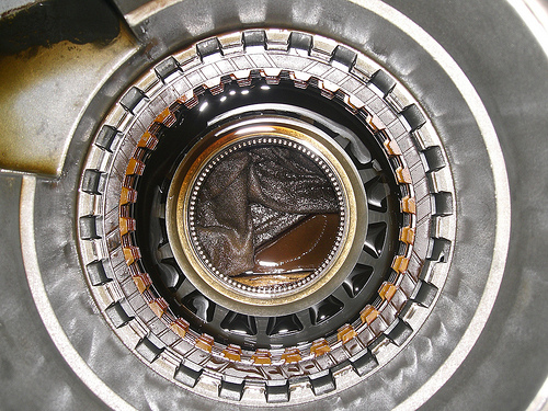

The good news is that the clutches are absolutely fine after 140,000 miles and on the original oil :D Here's a B Clutch (the one that works hard) lining:

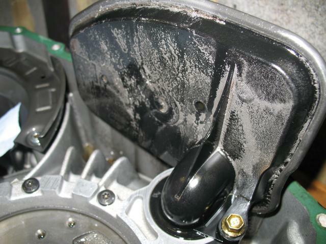

The F Brake, which can wear, is also fine. However, looking at the top of the oil filter, the picture is not quite so rosy. The grey stuff is fine metallic powder :(
The bottom of the 'box contains more of this deposit and a couple of lumps of unidentified metal.

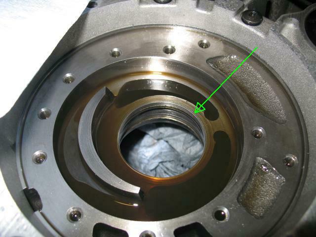

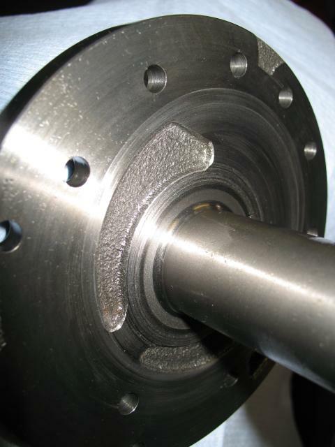

next up for inspection was the oil pump and it was found to be rather worn.

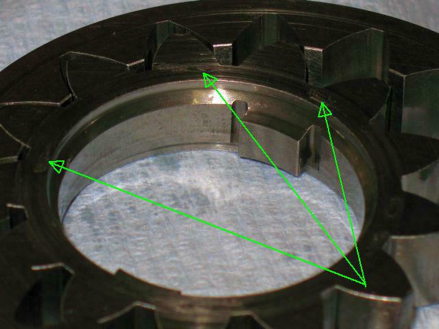

Here's a few shots of it's components showing the scoring. The oil pump gears show signs of fretting and "picking up"
Note the scoring at the green arrowhead and also the condition of 140,000 mile old oil. Not bad at all!
Here's a shot of the pump gears:
Note the damage at the heads of the green arrows.
So what happened? The best we can think is the stator sprag or lockup clutch in the TC began to break up and shed some metal. This found its way into the TC tail bearing and then into the oil pump. The debris visible on the oil filter may be remnants of this or bits of the TC tail bearing. Whatever and wherever it came from, it has wrecked the oil pump and this must be replaced. What we do know is that none of it originated in the gearbox proper :)

The condition of the clutches dont surprise me though, have a look at this with a nats wisker under 90k under its belt

Interesting how well the clutches have been preserved, and wow is that oil dirty!
Change at 10 years does seem a particularly arbitrary statement, but it lends weight to my suspicion that 'sealed for life' is a marketing ploy as opposed to genuine recommendation from the gearbox designers.
