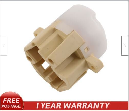

Alternatively Neil. why not just replace your dodgy switch with a direct replacement and save all the wiring alterations?
https://www.ebay.co.uk/itm/404015335430 ... %3A2047675

mickthemaverick wrote: 29 Nov 2022, 17:59 Alternatively Neil. why not just replace your dodgy switch with a direct replacement and save all the wiring alterations?
mode=view]Image[/url]
Thanks Mick. I think the problem is with the ignition barrel and the key Mick. I did replace the switch like that one, with a main dealer part. The key at the "start" position is imprecise, and doesn't spring back to the "On" position, often produces a "false start" requiring a rewind and try again for a successful start.
I think the push button start will avoid this, without going down an expensive route of ignition barrel replacement with keys needing "coding" to the car.

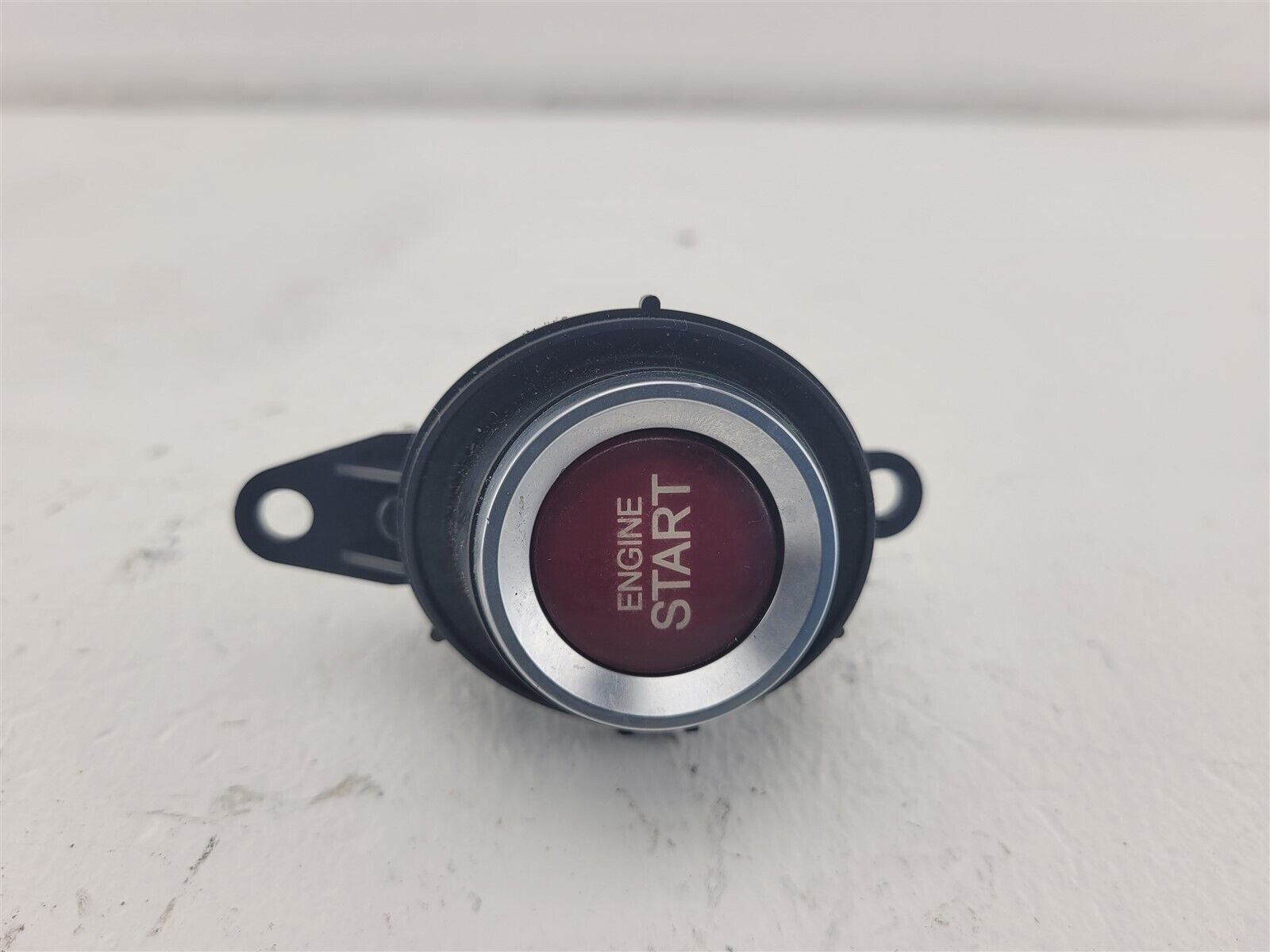

Definitely not James!! That is a latching button!! :-D

If you check the options you will see that the Start Engine is a momentary button.

mickthemaverick wrote: 29 Nov 2022, 18:26

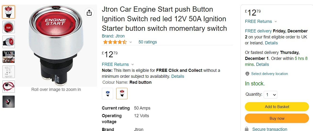

And any starter button needs to be good for at least 20A for high reliability... Those don't quote how much current they can handle and looking at them, I'd say not much...
A switch with an inadequate current rating (or even a marginally adequate current rating) is risky as it's possible its contacts could weld together with disastrous results.. It would, in effect, turn it into a latching button!...
Posts: 55138
x 8418
Re: Bargain Basement Motoring
You could use a low current starter button via a relay and then all the heavy lifting will be done by the relay and not the switch itself - that would make yours good for the task James :D

Hell Razor5543 wrote: 29 Nov 2022, 18:34 If you check the options you will see that the Start Engine is a momentary button.
That would presuppose some intelligence on my part!! :-D

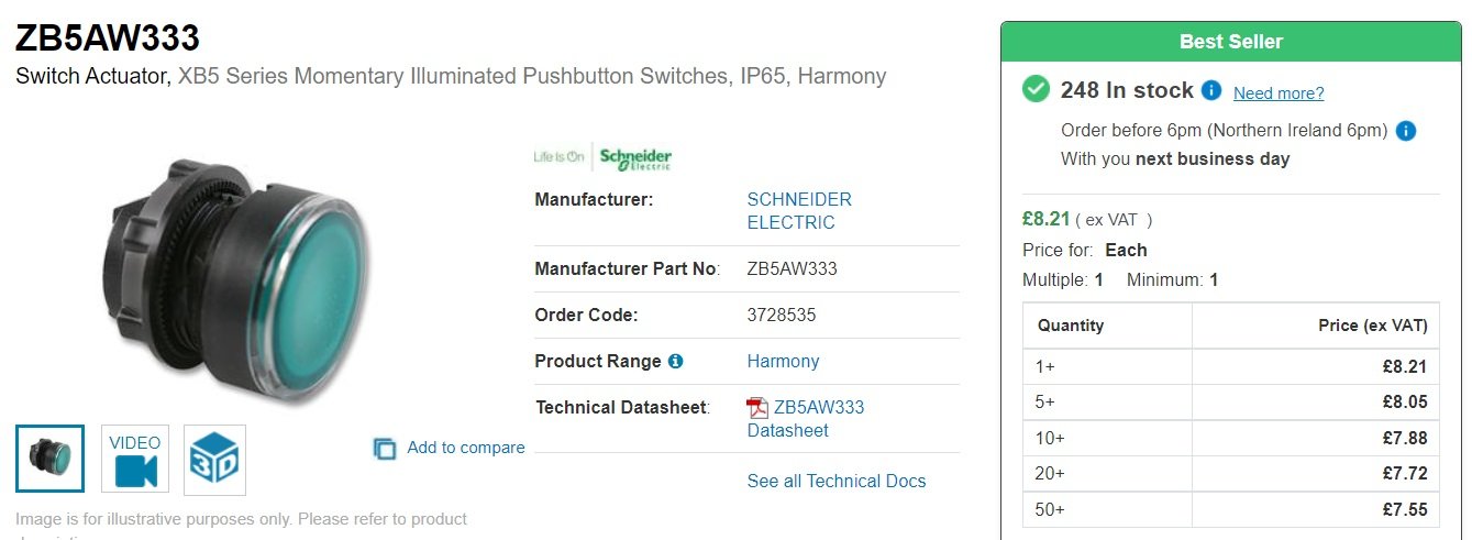

Thanks James. It's the sort of thing James but I don't like the Skull and Crossbones! Ships from China, which as I discover is where they all come from. Probably better getting one from somewhere that at least has stock in the UK with a bit of shorter delivery.
I sort of think I will plump for the most popular ones, from UK Stock, granted emanating from China.
I'm sure there are some in the catalogue Steve linked to which would be appropriate, and on the shelf from good old Farnells in Leeds from solid sounding Schnieder Electrics

myglaren wrote: 29 Nov 2022, 17:46 Image
Ebay, a tenner.
Thanks Steve, good solid Japanese OEM stuff ships from Scotland! a contender.
and this is probably still the front runner

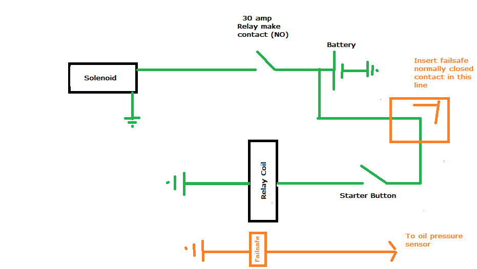

This is the simplest starter circuit you can use. The solenoid will only ever be energised while you hold the button in. Any failsafe Normally Closed contacts can be added into the relay operation line which will break this circuit when the failsafe relay, operated maybe from oil pressure sensor as Jim suggested, operates. Just a starting point!! :-D

If you go through the drop-down list you will see that the start (momentary) has the words "Engine Start".
