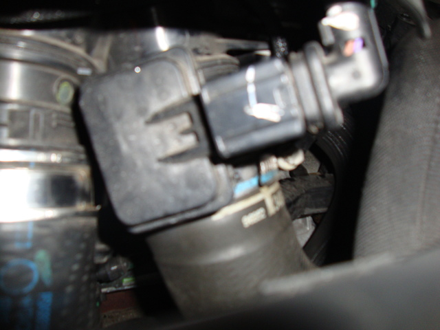

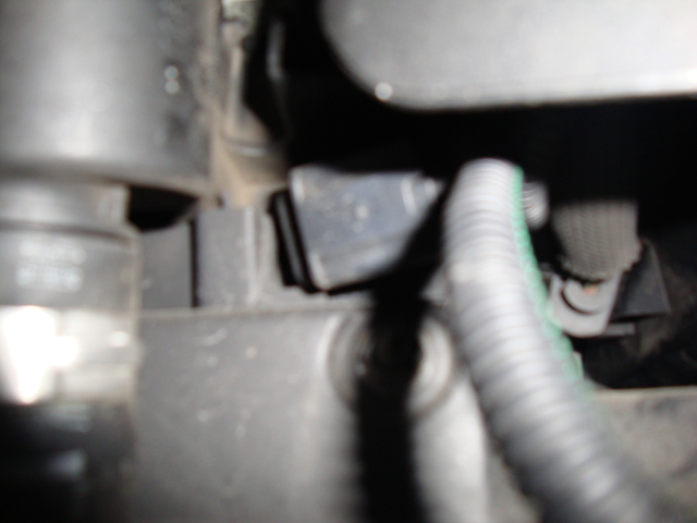

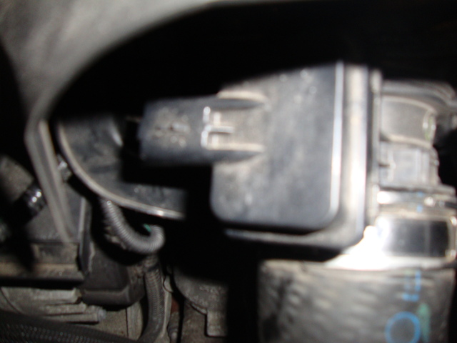

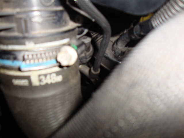

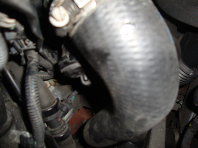

Re: C5 X7 ambient lighting (and some other bits and pieces)
Of course...Any chance of a photo of the situation on your car?
The one on the right has the wiring connected:
And the vacuum pipe connected:
The one on the left has no wiring connected:
Because the wiring plug is hiding over here:
And there is nothing connected to the vacuum thingy:
Hmmmm, the plot thickens.
(apologies for the photo quality but it's dark and cold out there)
