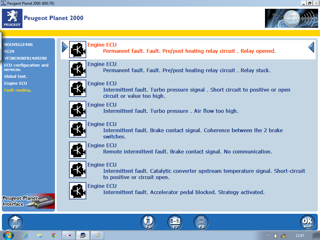

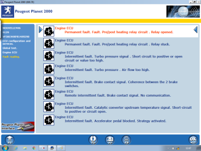

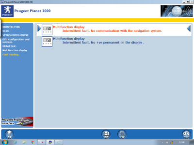

Fault codes read, print screened and cleared, short drive at dinner time and not returned as yet. Loads of them on various topics! Something to do with turbo boost seemed most likely (linked to remapped car and foot down hard is my theory)
Will get them on here at some point but need to transfer from the diagnostic laptop to phone (Bluetooth is most convenient route) so will take a while.

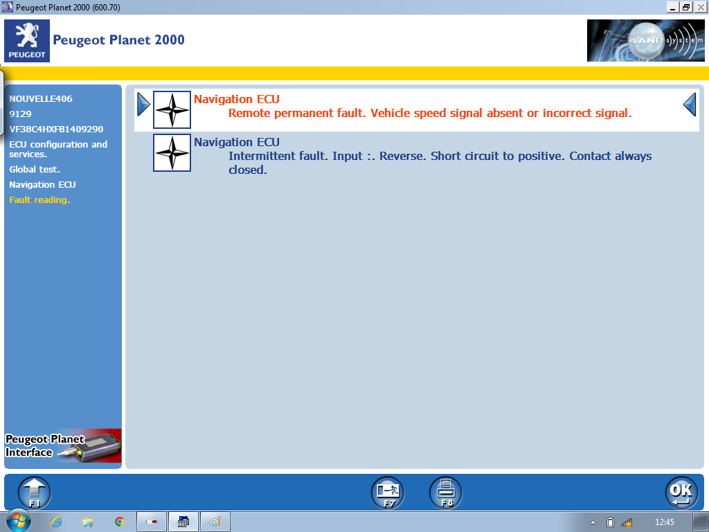

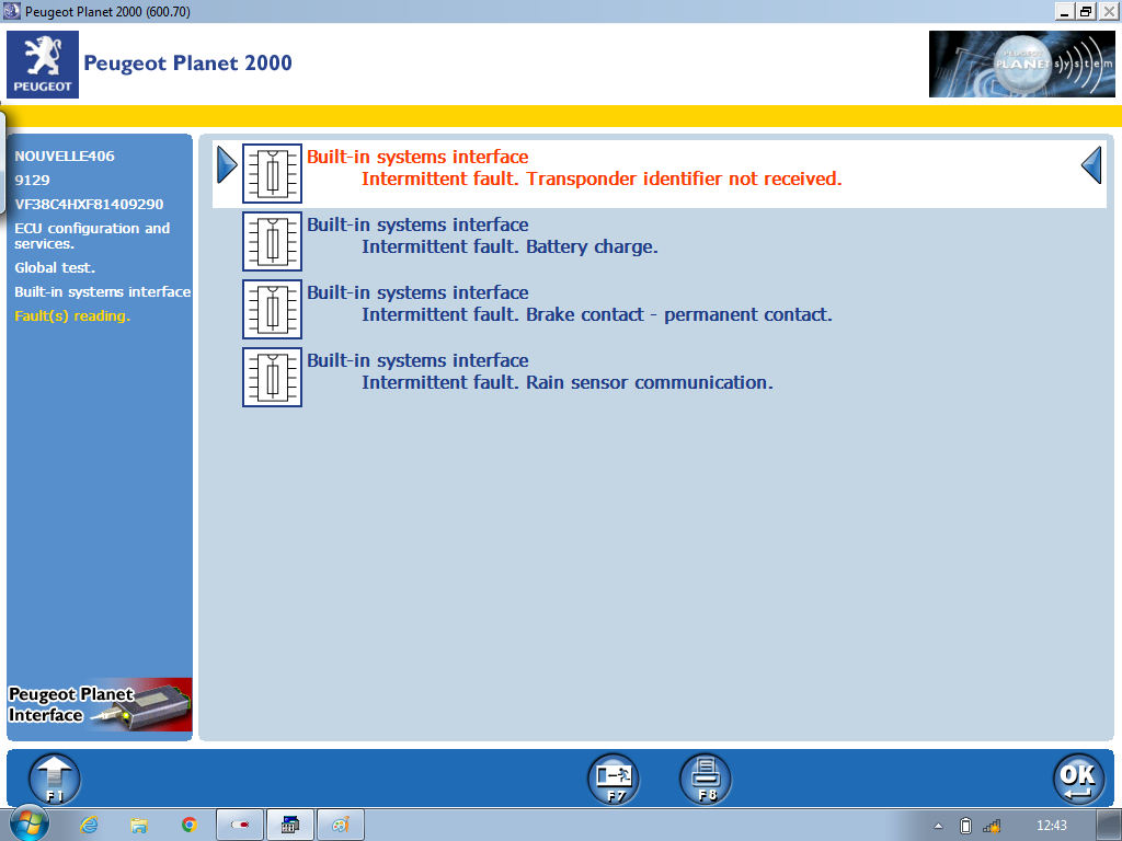

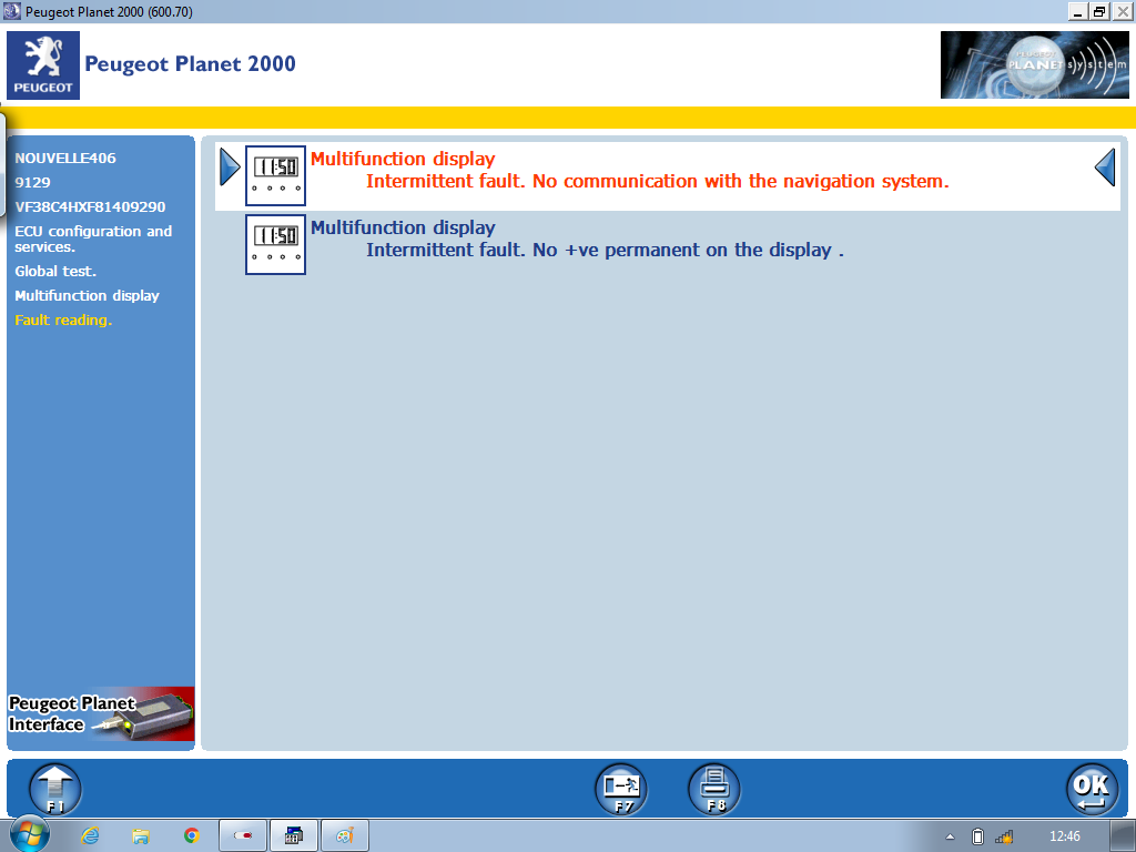

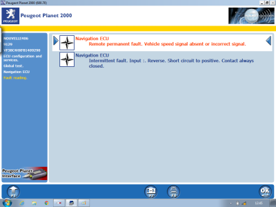

2003 HDi Coupe fault codes read 12/11/2023
BSI faults
BSI faults
Navigation faults
Navigation faults

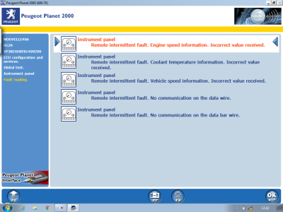

Instrument panel faults
Engine ECU faults
Engine ECU faults
MFD faults
MFD faults

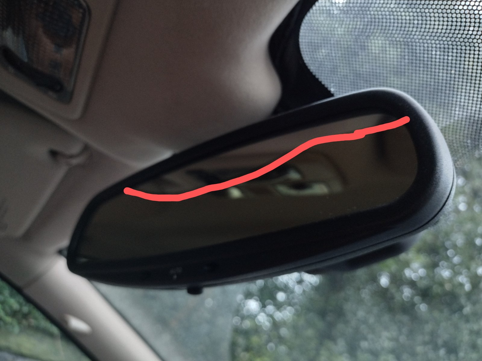

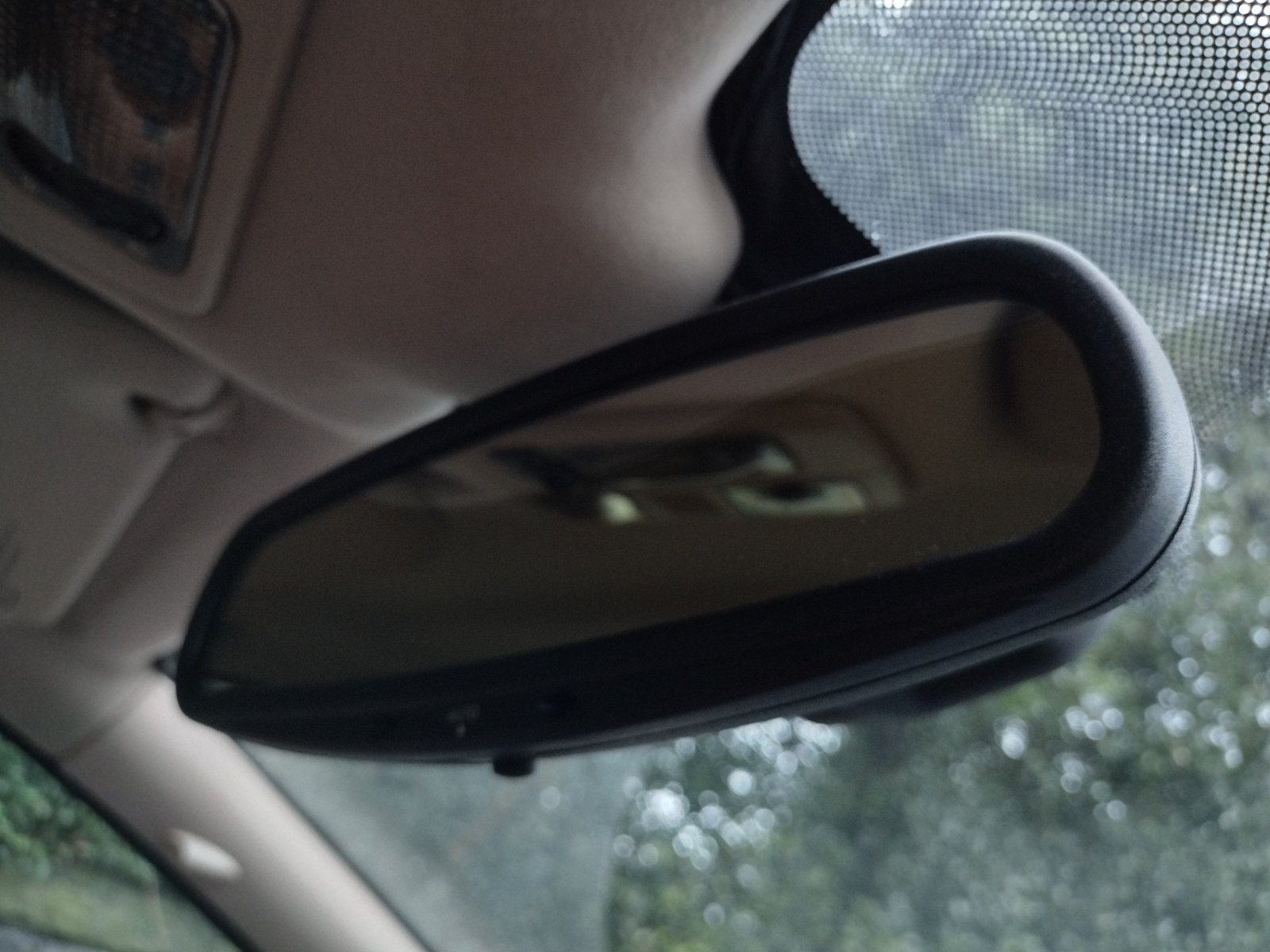

Coupe seems fine at present, though the mirror has suddenly handed it's notice in :(
The magic juice is escaping!
Spoiler: show
marked up version for clarity, a tide mark as per red line

Is that one of those like mine in the Picasso that automatically dim when it sees bright headlights through the rear window?
I love mine for doing that :)

CitroJim wrote: 15 Nov 2023, 08:16 Is that one of those like mine in the Picasso that automatically dim when it sees bright headlights through the rear window?
Yes, it's that type. "Photochromatic" for some reason is in my head.

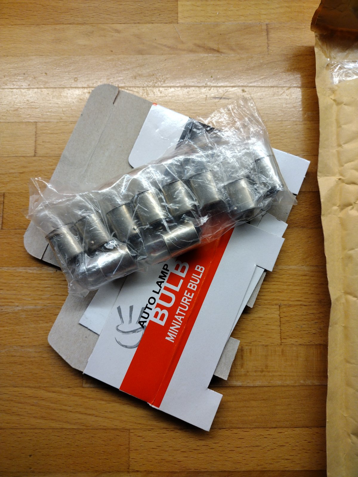

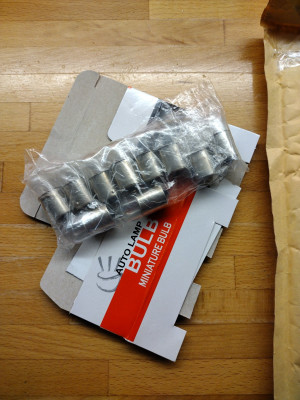

The (5W) bulbs have arrived today. I do not understand why they have been packed like this:
In a jiffy bag, but removed from the box in a clear plastic bag (flattened box was included, perhaps incase I have a desire to actually store them in a more logical way than how they came through the post!!)
Amazingly they are intact (glass and filament looks ok) but think down to good luck more than anything!

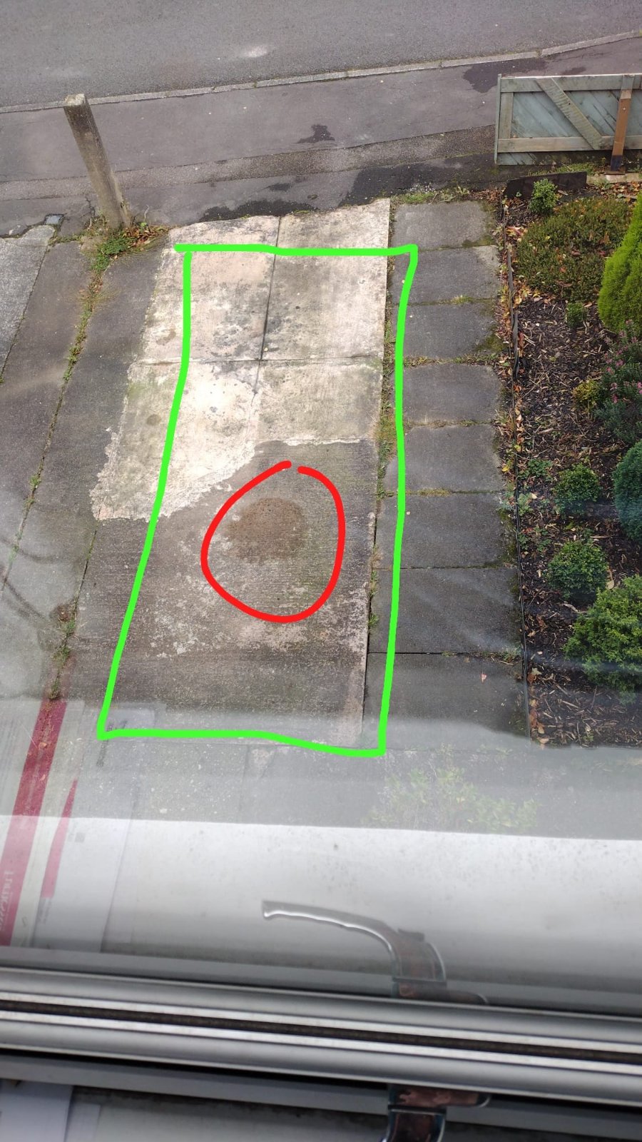

Appreciate just looks like a grubby driveway, but
Green square is roughly where the C5 normally parked and pretty sure the splodge in the red circle is new. Always nose out and that's about rear suspension position.
Very quick squint with torch this morning, one pipe does look a little damp/oily from what I can view.
Job for tomorrow, up in the air and see what I need to do.

MattBLancs wrote: 17 Nov 2023, 07:52 Appreciate just looks like a grubby driveway, but Image
I'm very sad to see that.... these C5's are very naughty beasts!
