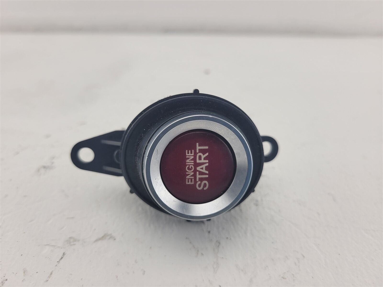

Plenty of options for a suitable button on ebay Neil for a fiver or so, you can even pick your colour!!NewcastleFalcon wrote: 26 Nov 2022, 16:37 ..........., but I would like to introduce a simpler push-button start option rather than relying on the dodgy ignition key barrel/switch.

Definitely think the push button starter is a necessity as part of the job but must say, is China the only nation in the entire world that produces push button starter buttons. The standard ones appear to be 12V 50A. Seeing as the ignition key/switch would appear to be the weakest link probably no need for a relay seeing as the signal will flow through the existing relays and other gubbins to the starter motor, and will be reliably extinguished by the push button switch.
The only small bit of cleverness about the key ignition switch is that in the "Start" position it shuts off the accessories, and the heater blower motor. The starter button will leave the key switch in the "On" position where all that stuff is activated.
Has the UK lost its ability to make push button starter switches
Never shopped for them before but wouldn't surprise me if they had
These are the most popular ones in town,
https://www.amazon.co.uk/Jtron%C2%AE-Ig ... 5636&psc=1

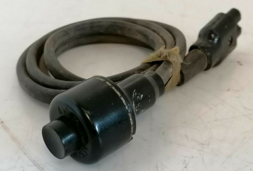

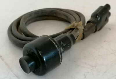

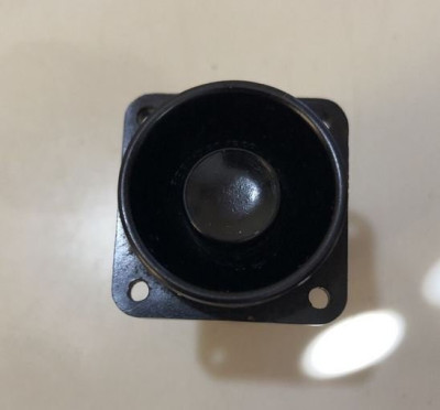

If it's British engineering you want, Neil, then I think you need to get creative.
How's about repurposing a bomb release button from a Lancaster.....
https://www.ebay.co.uk/itm/195488595864
Or maybe a "WWII Air Ministry Starter Button Stores Ref: 5c/898 Spitfire,Hurricane,Lancaster"
https://www.ebay.co.uk/itm/115602786403

Ebay, a tenner.
