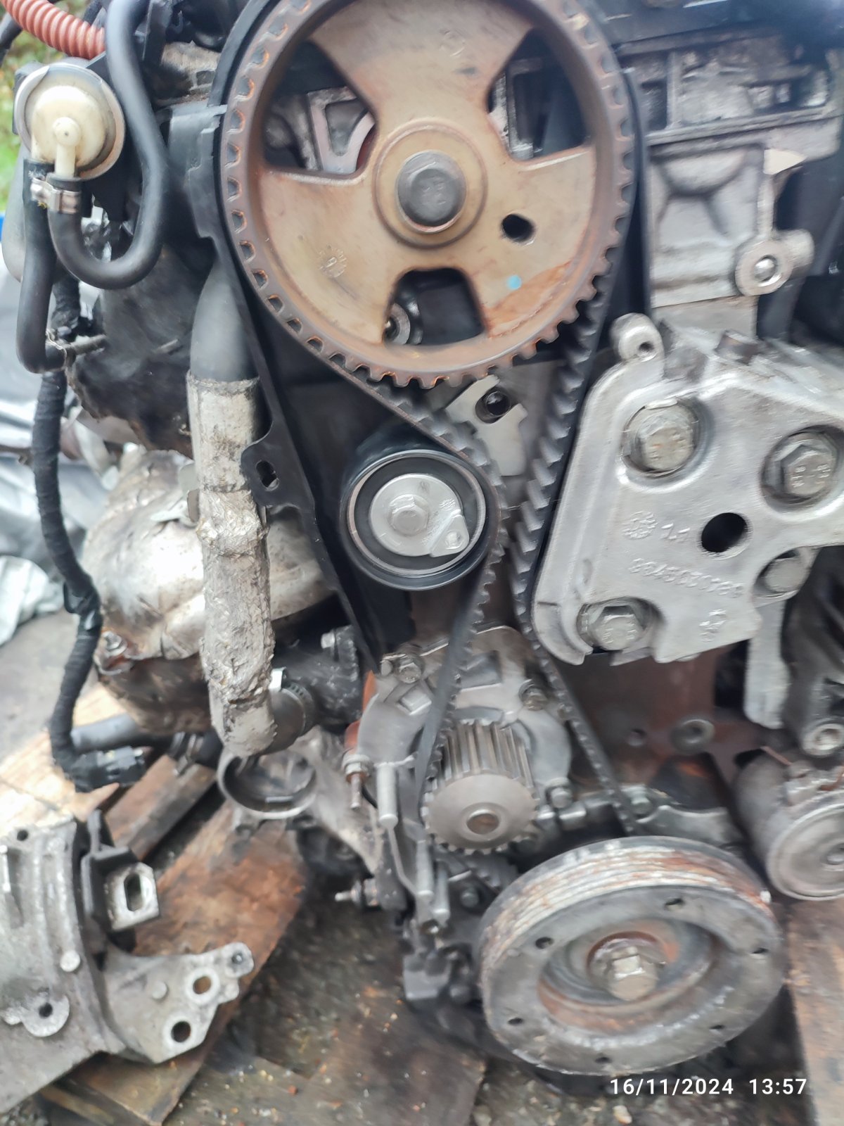

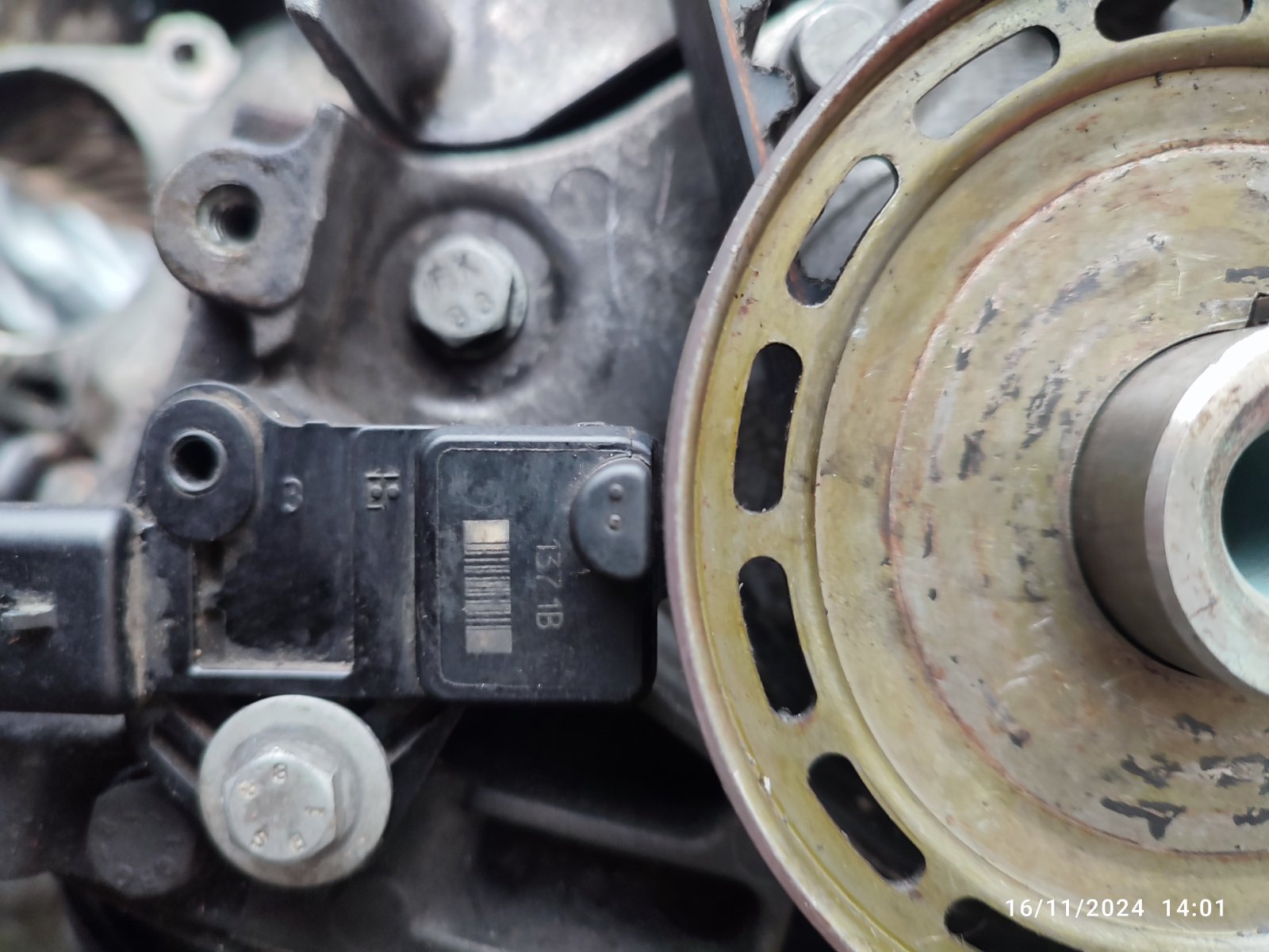

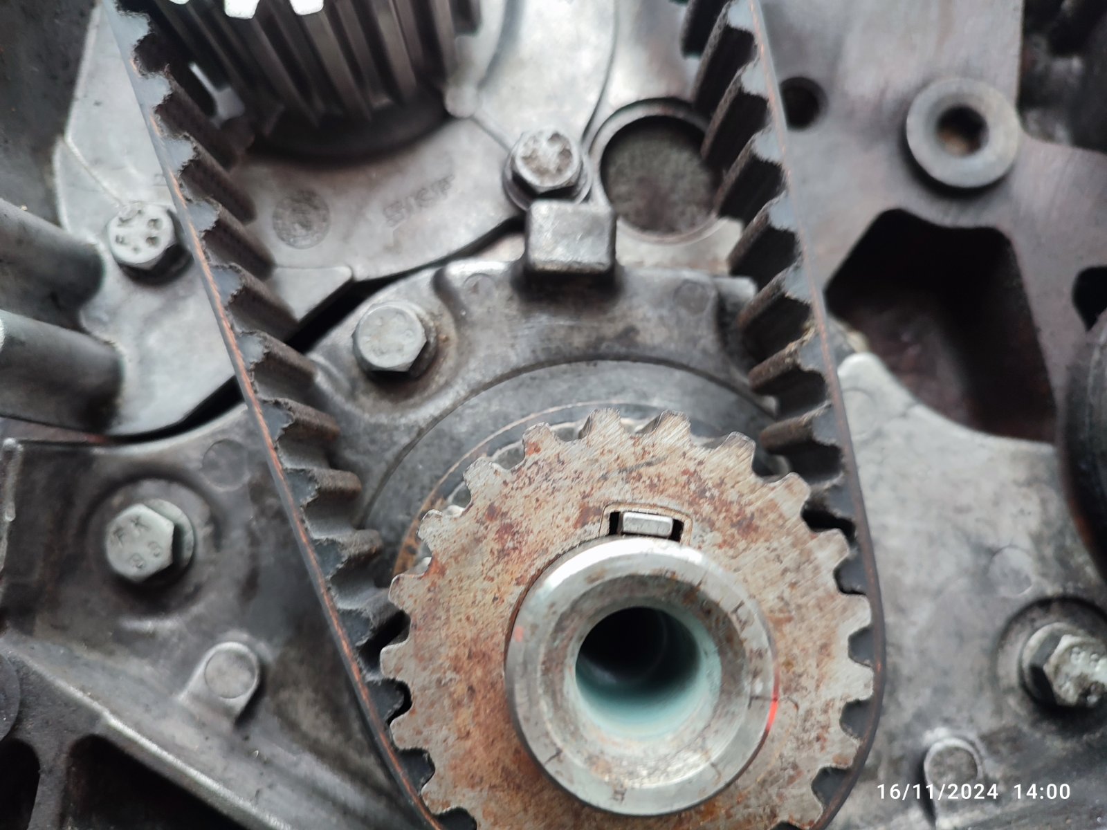

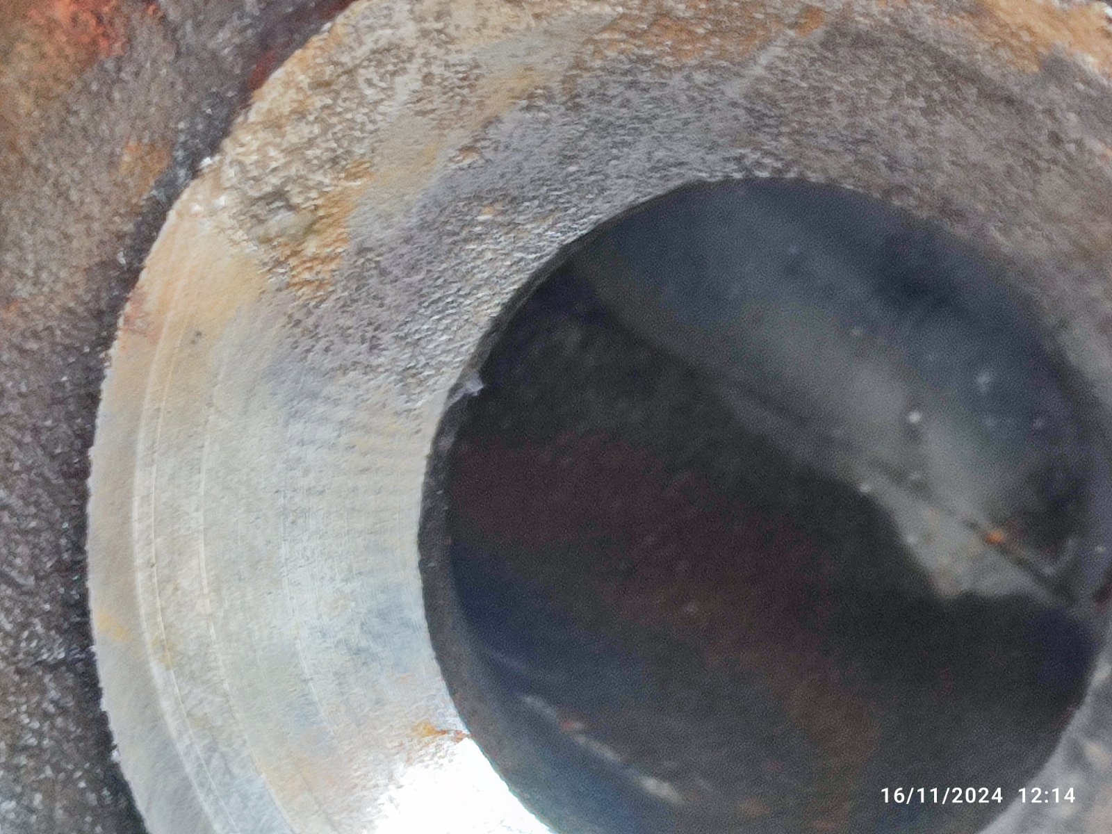

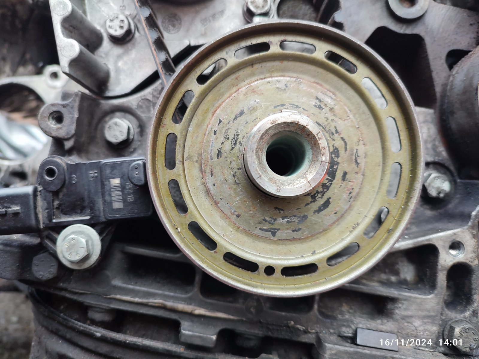

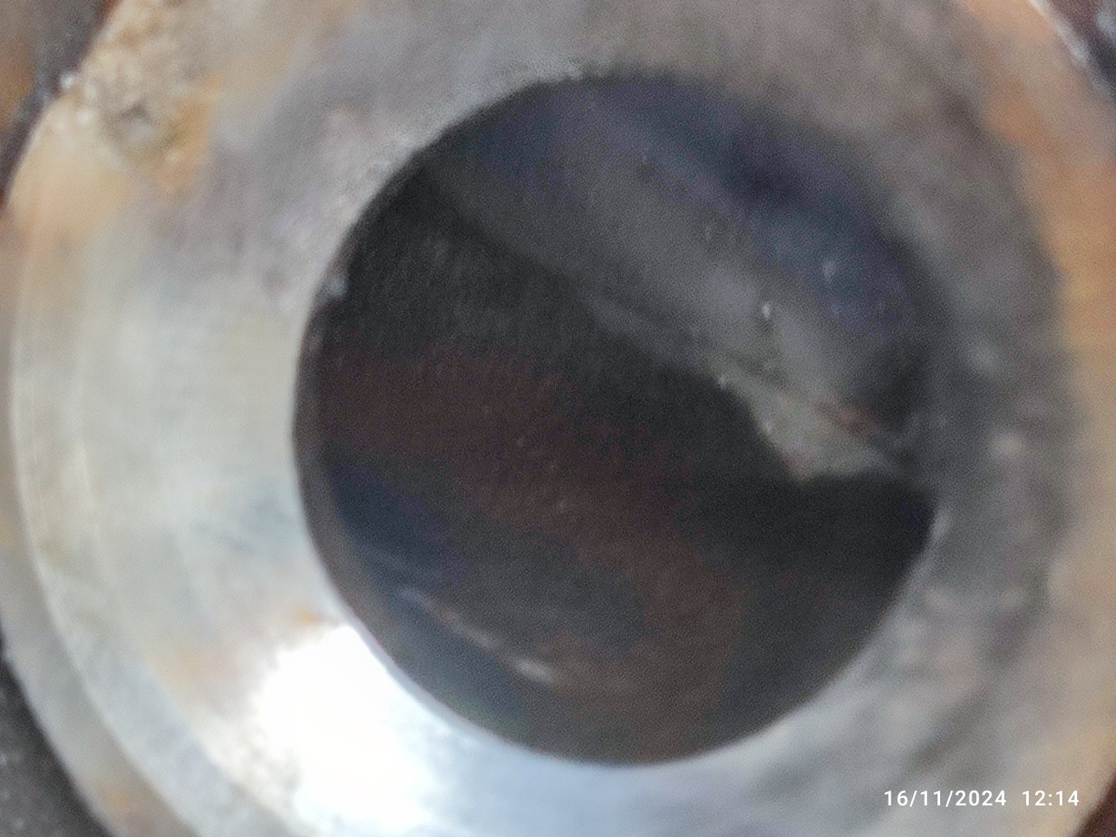

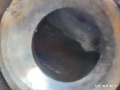

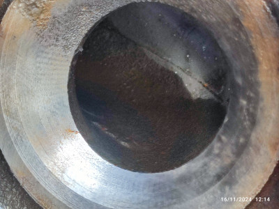

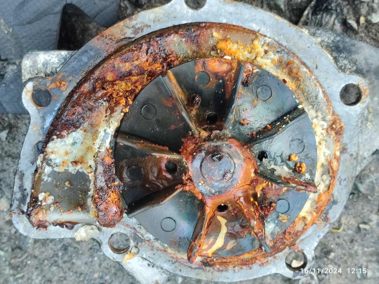

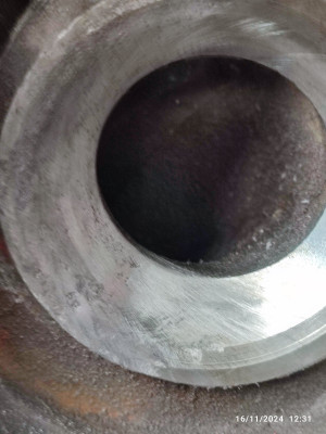

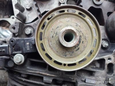

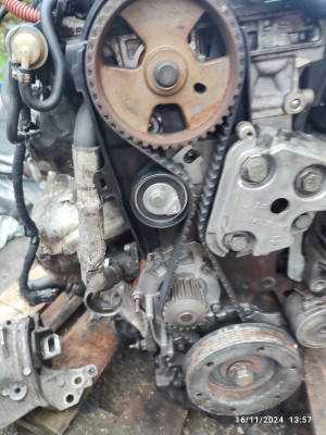

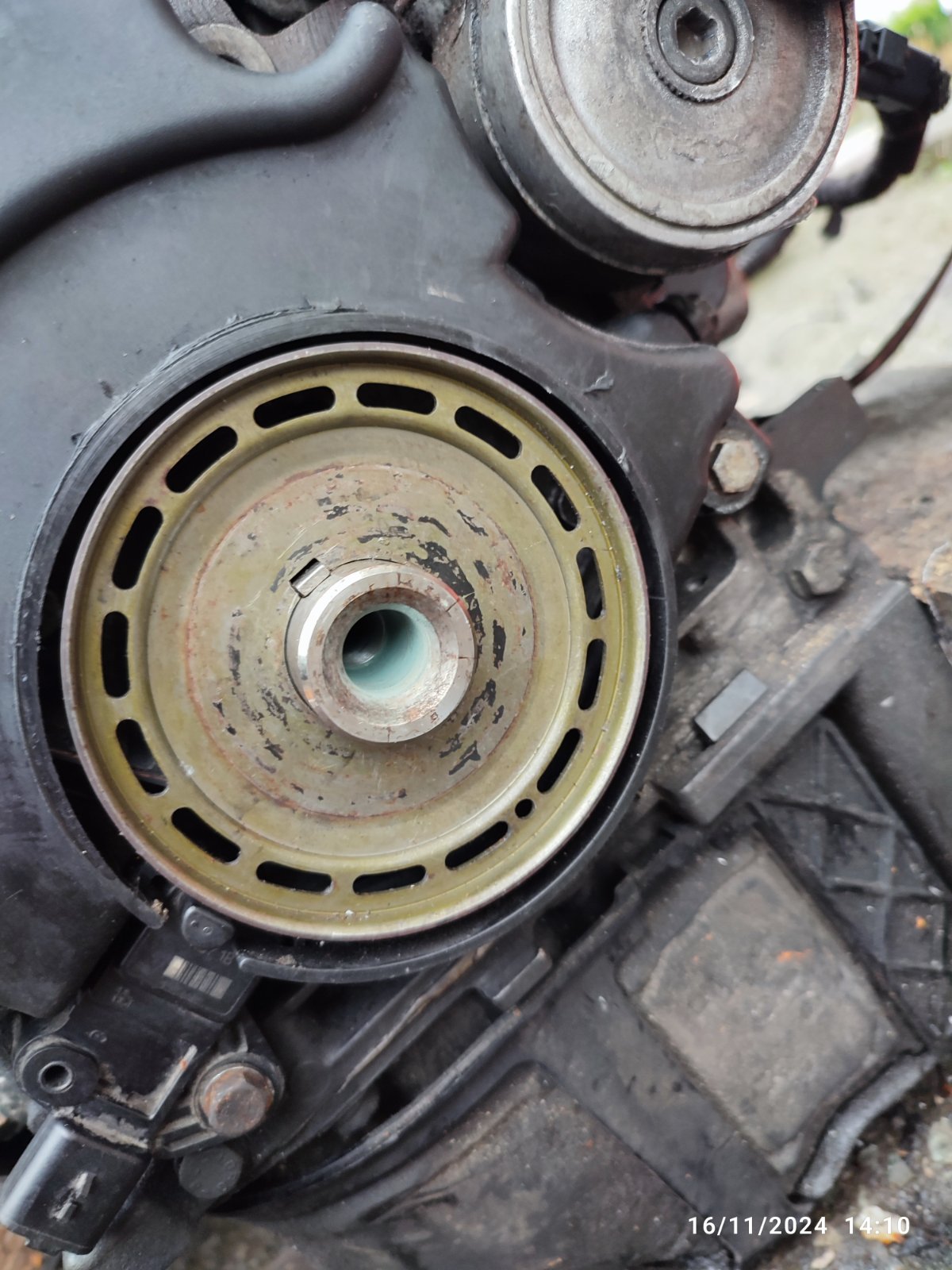

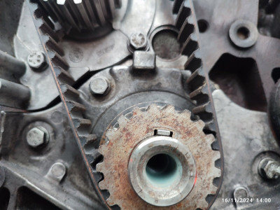

Hi all, timing belt done. Got the pulley off heat gun and breaker bar worked great on the bolt. Discovered another slight difference with the reluctance ring. It had a press fit bearing type reluctance ring on it and the floating pulley had seized and I damaged the pulley getting it off. I then discovered a lot of corrosion on the water pump and chamber. It's all back together now using the pulley off the original engine. I cleaned up the chamber as best as I can. I think it will cavitate over time but I hope not too much damage.i think it's salvageable but time will tell. I need to change the clutch flywheel and gearbox across it's raining now so have to stop.i have a bit of soldering to do as well. A couple of plugs I need to replace that got damaged removing the engine can't win em all. Slow but steady progress.
Darren
Rhothgar
- (Donor 2026)
- Posts: 2432
- Joined: 22 Nov 2004, 00:21
- x 221
Re: Injectors misbehaving but trying to understand the numbers
Bloody hell. Looks like some numpty has used Loctite 260 or 290 (off top of my head) and way too much. If that came out of the factory like that it’s worrying.
It needs about 300 degC to break the adhesion down. Standard low strength would surely have been enough. No wonder you could not shift it.

Yeah I was thinking that myself Roger I decided to use both heat and leverage because I had a feeling it could be thread lock.and was afraid of shearing the bolt.

Sorry I got a bit lost, are you getting a replacement water pump (or swapping in from the other engine?) - rather than putting the one pictured back?

Hi Matt , no it started raining so wrapped up everything. We are expecting bad weather so went out earlier to beat it and for once was successful in doing so I hope that puts your mind at ease. I'm trying to avoid getting wet had enough of it over the years. Refuse to work in it now.
I wasn't using that water pump straight in the bin with it. I swapped the water pump off my original engine as it has no mileage on it but with a fresh corteco steel gasket. So I hope that prevents the heart attack Matt
.I am a bit concerned with what I am finding but I have to take a punt on it at this stage. The parts list is small and cheap as I can transfer most of my old engine. I should be able to make a good one out of the two if necessary. Hoping it will run ok with the new seals in and a couple of oil changes and good coolant.

To me your 'new ' engine has been sitting for a while and a tiny amount of coolant has been left behind. Water is brilliant finding its way into things.
At least you have a spare engine, plus those seals and gaskets always need to be replaced with new.
