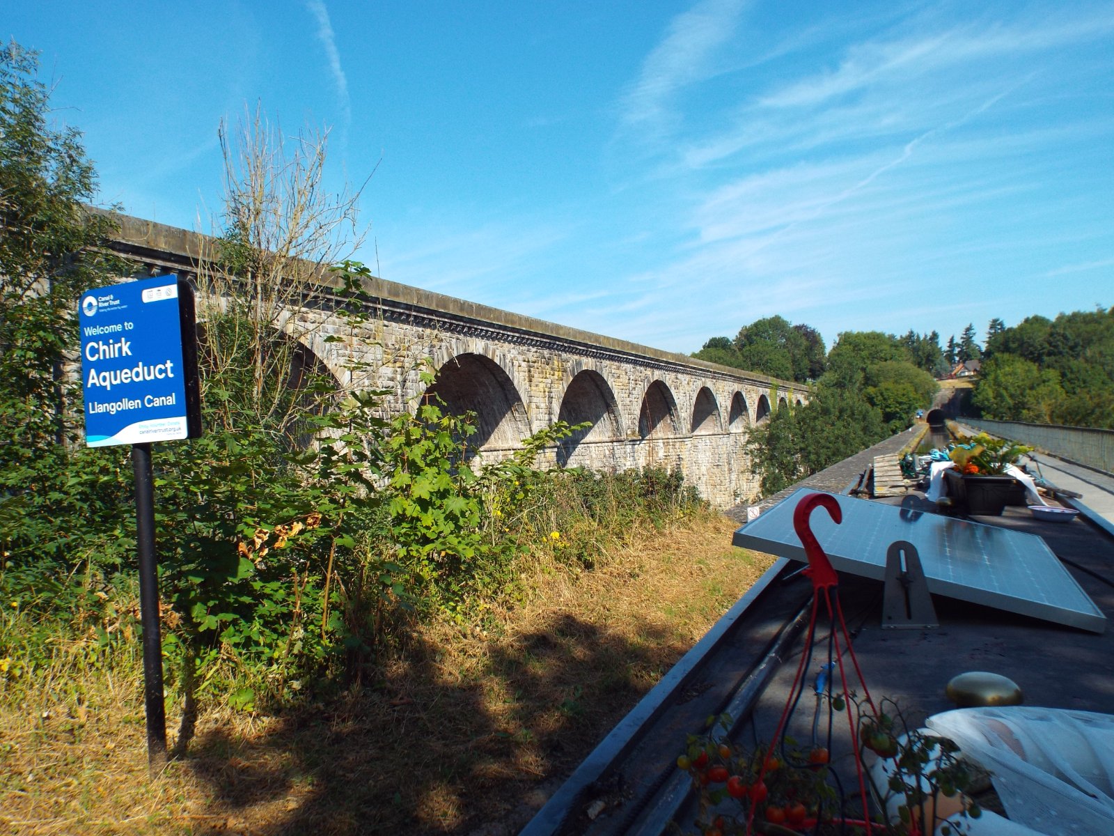

Next day we set off, and the Llangollen Aqueduct is magnificent. The view is spectacular, and it seems a bit strange to be looking down on the trees from the canal. For those with vertigo make sure you remain within the cabin of the boat, as there are no rails on the side opposite the towpath (it is also HIGHLY recommended that children remain in the cabin during the crossing). I was really chuffed to make a perfect 90 left turn at the Trevor basin into the canal ("The Black Cat" does not have bow thrusters, so all of the steering is happening at the stern). We pootled on into Llangollen, and moored up at the marina for the evening (£6 per night per boat, but you can only moor in Llangollen for two nights). When we wandered into town it was heaving with tourists, and quite a few were throwing themselves off the bridge into the cooling River Dee below (the Police did warn people of the danger, but we all know what teenagers can be like). Unfortunately Mum then found that her engine would not start, so we had to twiddle her boat around so that she was stern into the bank, allowing us to unbox the engine. I found one of the two long bolts (that secures the end caps) had not only come loose; it had knackered threads. This bolt was obstructing the motor. I had to remove it to allow the engine to start, but it also meant that only one bolt was holding the motor together. We did not try starting her at that time, as I did not know how long the motor would last (provided we could get back to Ellesmere Mum would be able to get the motor replaced).

Before I fell unwell me and Sarah walked across the aqueduct... and along the bridge next to the live railway in your last picture. Really amazing feates of engineering around there
