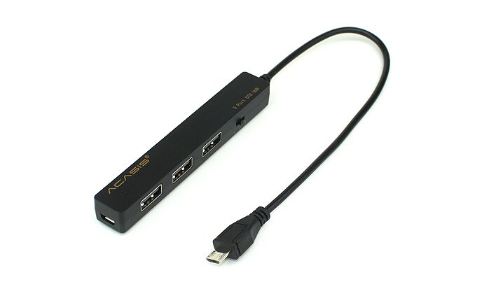

Still no progress on the android phone-car screen capability ... today I've received a 3-port OTG micro USB HUB ... the phone can get charged, and any other devices connected to the hub will get charged, but no connection to the phone, probably the phone (eve though it has Cyanogen Mod Android) doesn't have OTG drivers ... and so far I haven't managed to find them online (some links are dead, since this was interesting a few years ago) ... the hub looks like this:

Well, I've found the missing drivers thanks to a helpful member on xda ... but, still no cigar ...vborovic wrote:the phone can get charged, and any other devices connected to the hub will get charged, but no connection to the phone, probably the phone (eve though it has Cyanogen Mod Android) doesn't have OTG drivers ... and so far I haven't managed to find them online (some links are dead, since this was interesting a few years ago)
