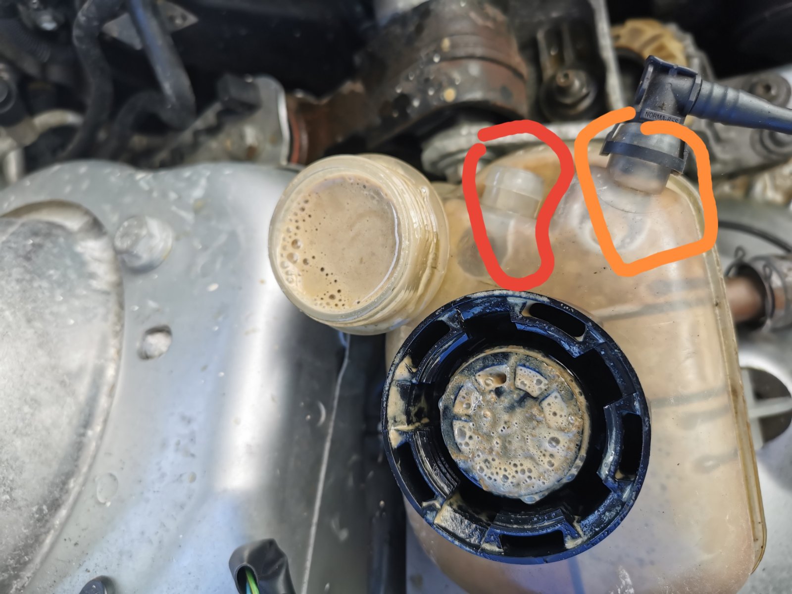

Left the car for 3 days without running and when e removed the cap (slowly) the coolant came out bursting again....wondering if this if the pressure release hose should be connected to the highlighted red part instead of the orange

Re: Oil in Coolant?
That is not happy coolant, deffo oil in there. I did a test on a friends car with a suspect HG failure using a swimming pool PH tester. At the very least it's another drain, flush and refill before the place of contamination can be found. I wouldn't bother using antifreeze, just water as it's for testing purposes.

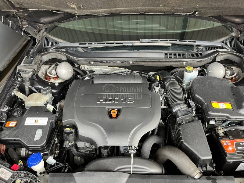

As you can see on the other engine, the connection is the same as yours.

Re: Oil in Coolant?
Thanks for confirming, FYI the coolant in that picture was before I changed the oil cooler, now it has shown any signed of contamination
