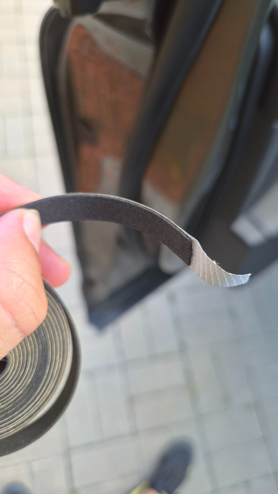

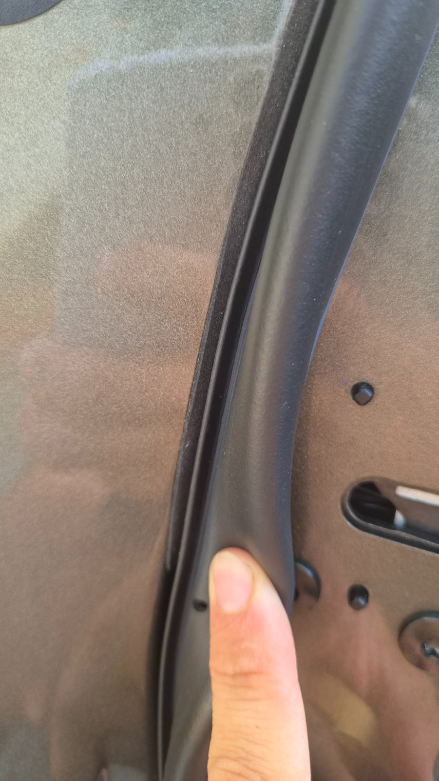

Today I tested with some foam tape, I think 1mm thickness sticked under the door frame seal and that sound almost disappeared.
I'm thinking instead buying new seal to stick tape all around.

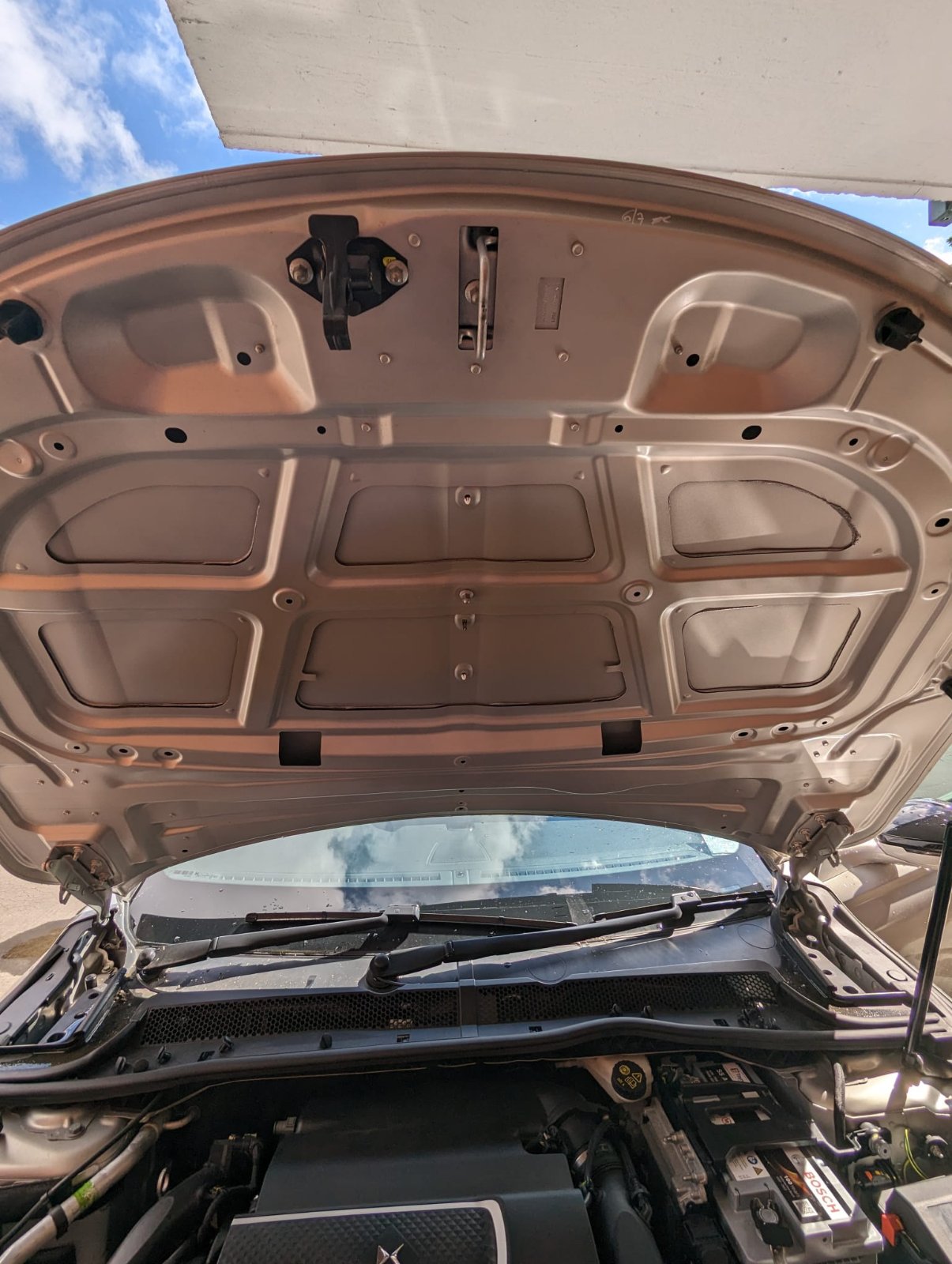

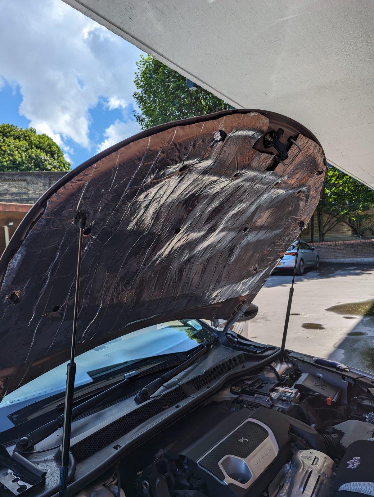

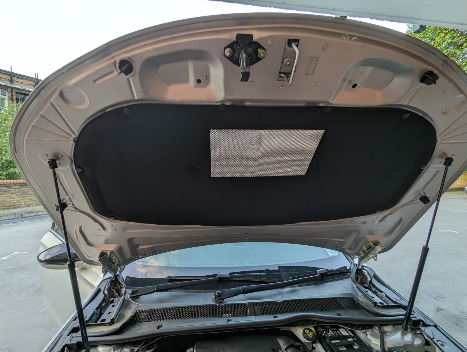

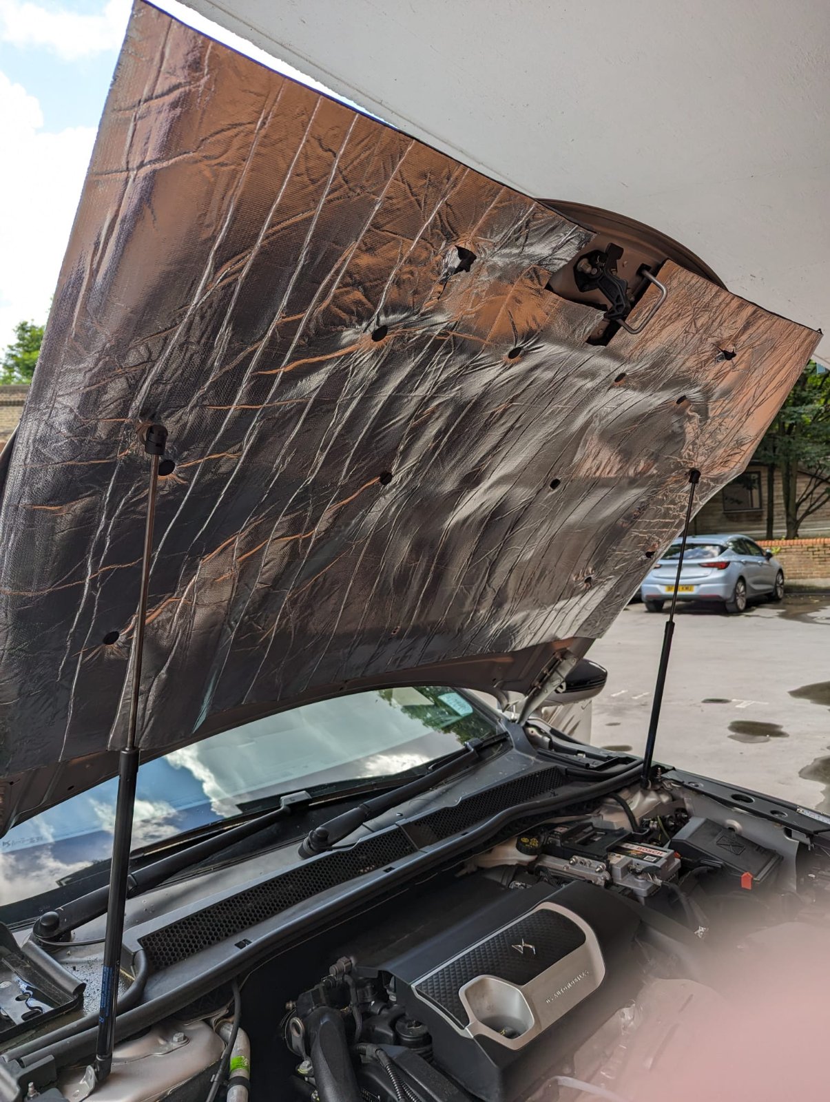

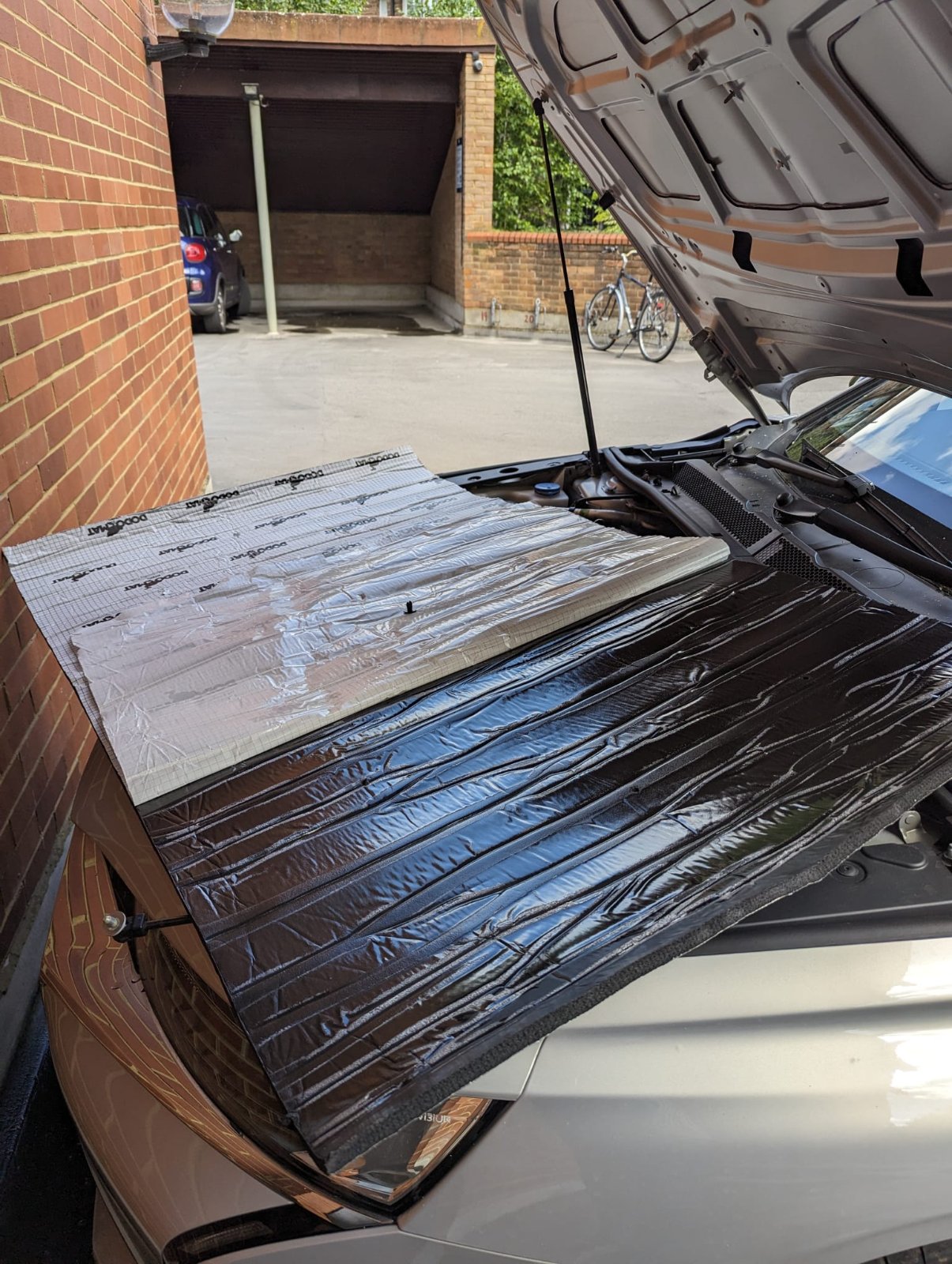

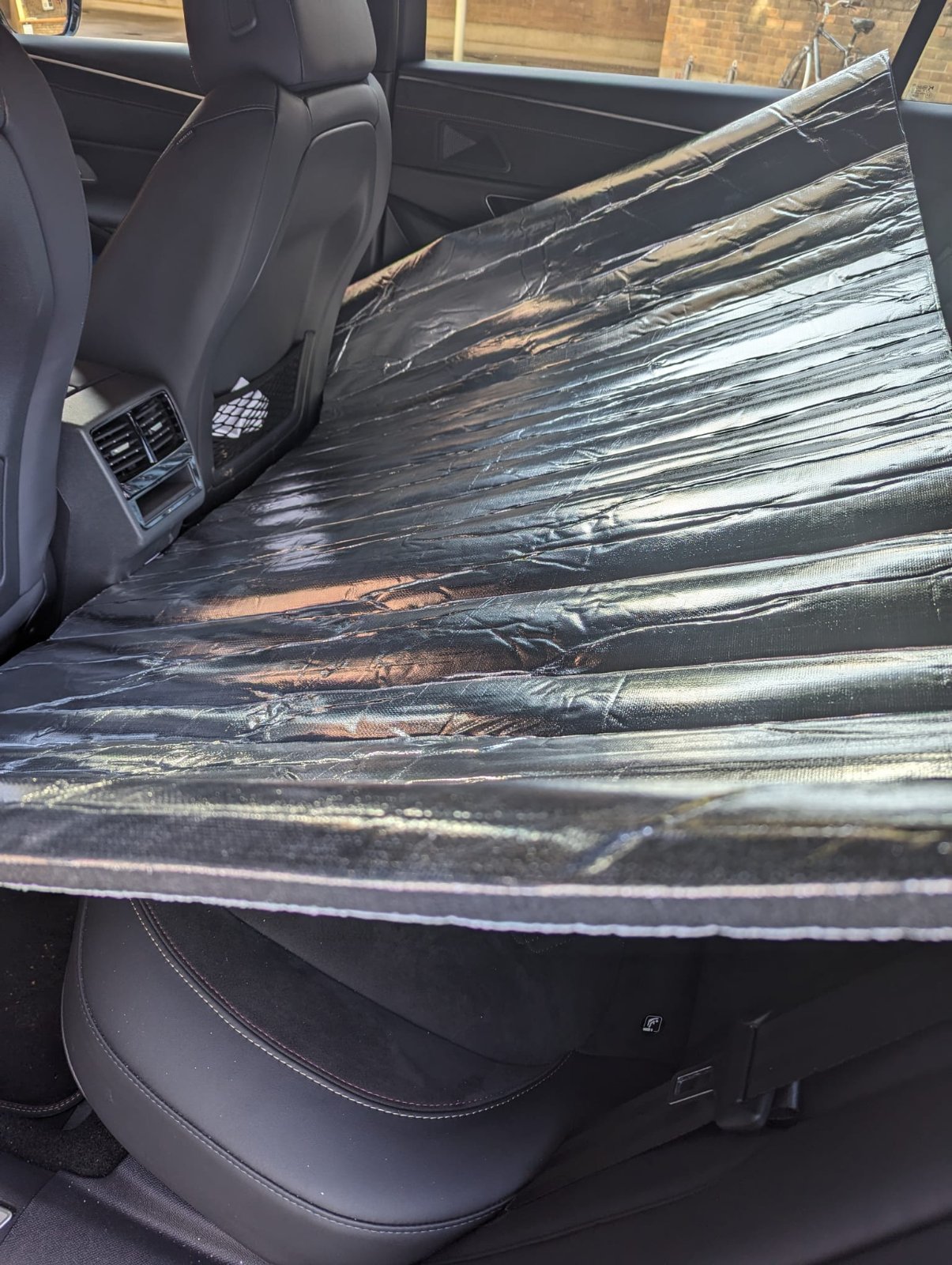

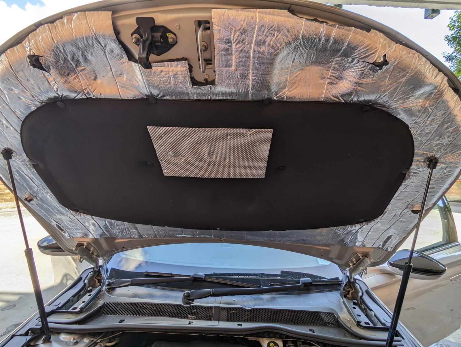

Hope this comes out ok with all the pics in a haphazard order. These were on the DS9.
1) Get the mat which comes as a roll, unroll and leave on the back seat of the car for a few days flat just to straighten it out.
2) Take off the clips for the felt and clean the area.
3) Peel the back off the mat and then affix to the car as a rectangle and get a roller or similar to push down and make it stick to all the parts including recesses.
4) Trim to size around the edges (as you can see I did this badly)
5) Fish for the felt clip holes with a ferrule or similar, and then affix the felt back over the liner.
Maybe took me an hour or so, but it's not a job I rushed.
Like I say this is probably far better than just going behind the felt with denser stuff like I have on the C5X. In fact I need to swap mine out for this solution.

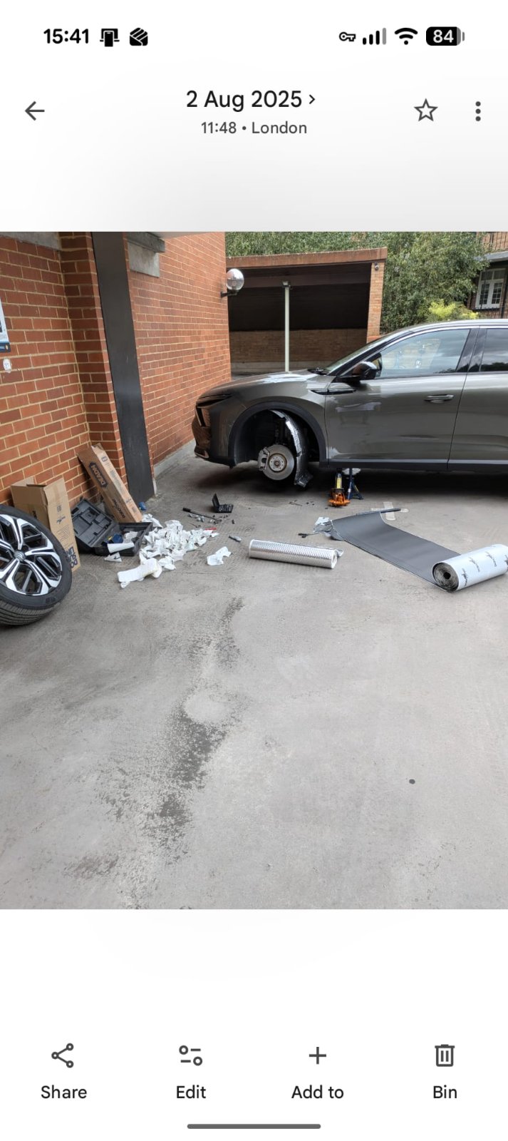

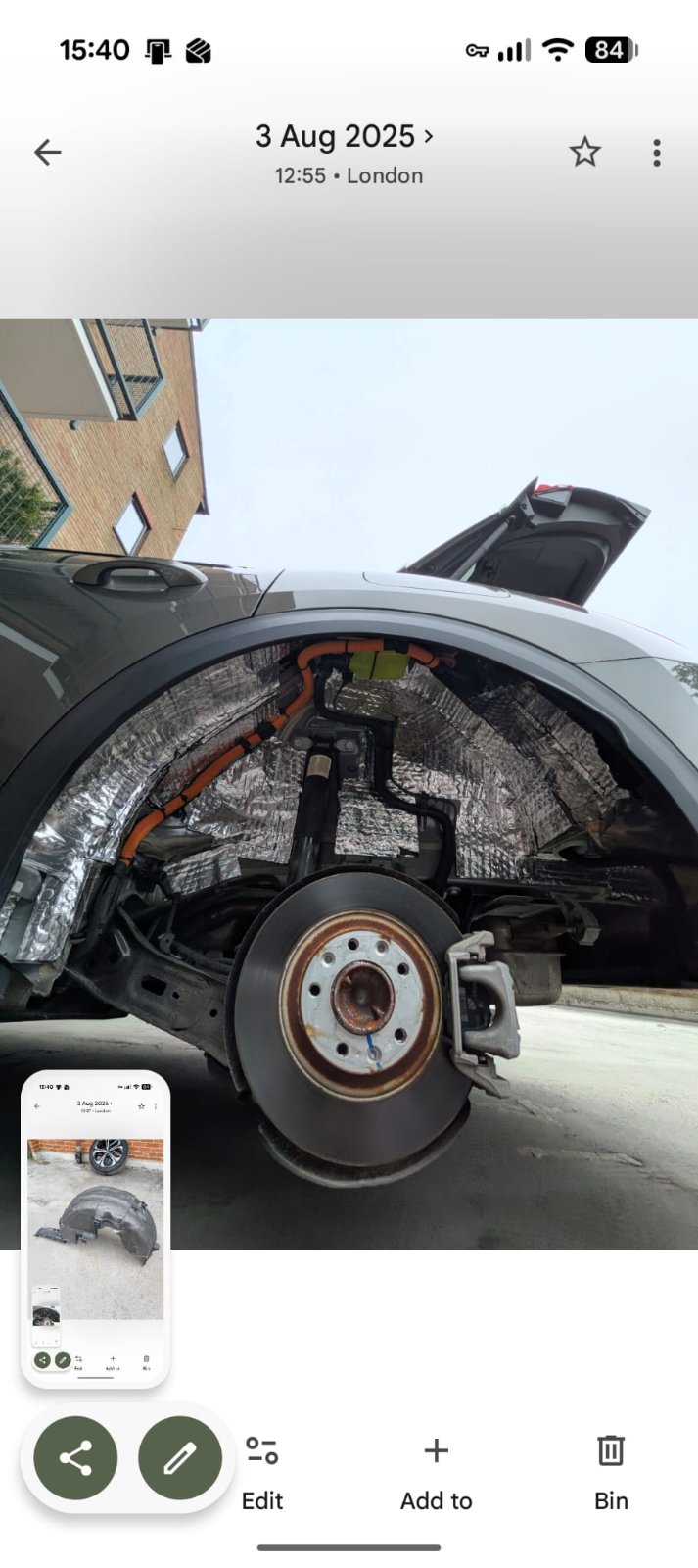

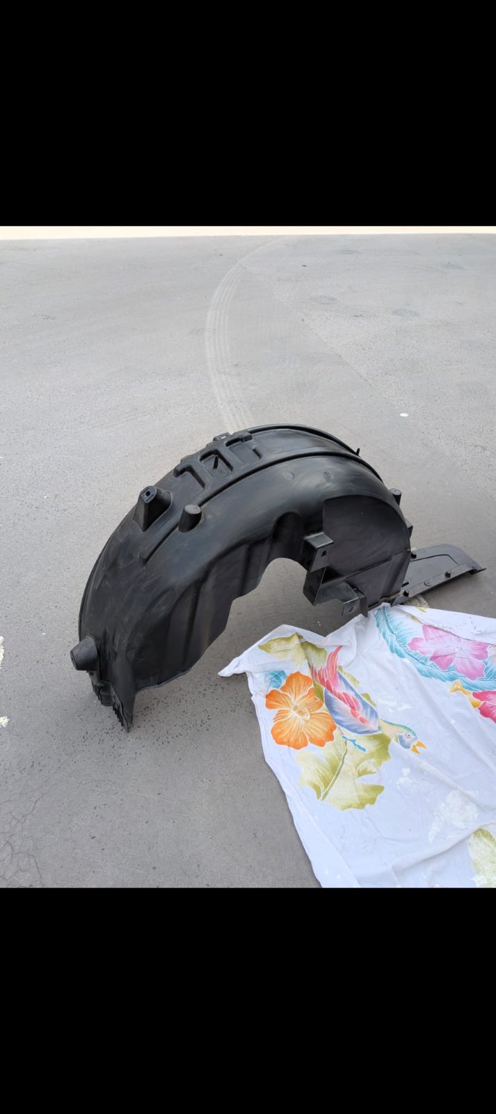

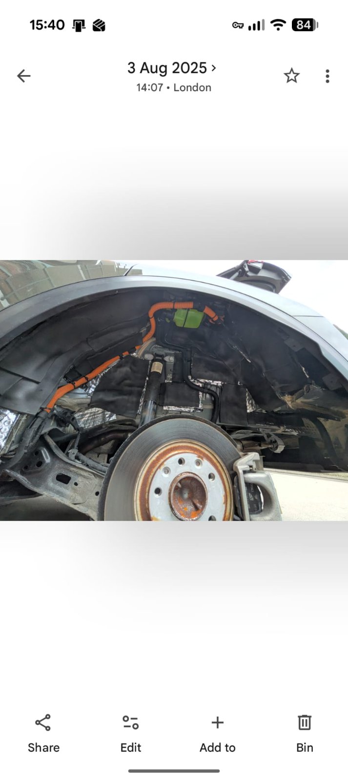

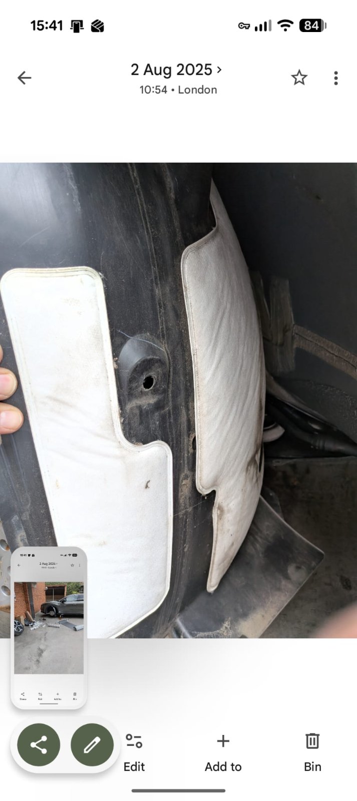

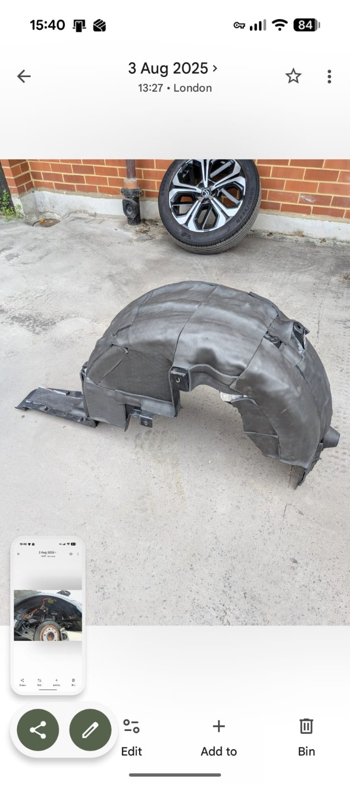

Stu - the wheel wells i did on the c5x and also on the ds9 before it, think it makes some difference but i still think a lot is just coming up from the floorplan. I think the gauge of body steel in the C5X is a bit thinner than the DS9, well it feels that way. I've posted some pics while I was doing it. essentially I get a butyl layer (or 2) first and then overlay with black closed cell foam.....not only on the wheelarch but up in the wing too as you can see. Doesn't have to be neat by any means. The only thing i will say is the front is snugger than the back so if you put too much on you cant get the liner back on.
Like i said a few days ago I've got the new bonnet liner and will fit sometime soon, and will report back. I don't think it'll be as silent as the DS( was at tickover but we'll see. I've also got more door deal stuff coming today and I'll fit that soon and report back.

Cheers, I see you added to the arch cowling as well as the inner wing.........note understood about thicknesses.

Stu - the front and backs are different as you'd expect, seems to be a lot of clearance all around on the rears and you can pack the stuff in layers thick but the front's you have to be a lot more careful. I actually packed too much in on the fronts at first, couldnt get the fixings back on so had to take some out and then I strained my arm trying to force it back. I had to laugh at what was in there factory fitted which is one of the pics, its like 2 very thin tampons, I can't see them making any difference.
Like i say there are other quick wins tho, the boot floor under the platic polystyrene where the charging cable is takes no time, slip the surround out and you can cover half the boot floor in 15 mins. I didn't do the battery half in case there's any issues with the battery down the line and they claim it's because it's too hot or something. Here i just put some unaffixed stuff over the top and a thick rug around the sides.
