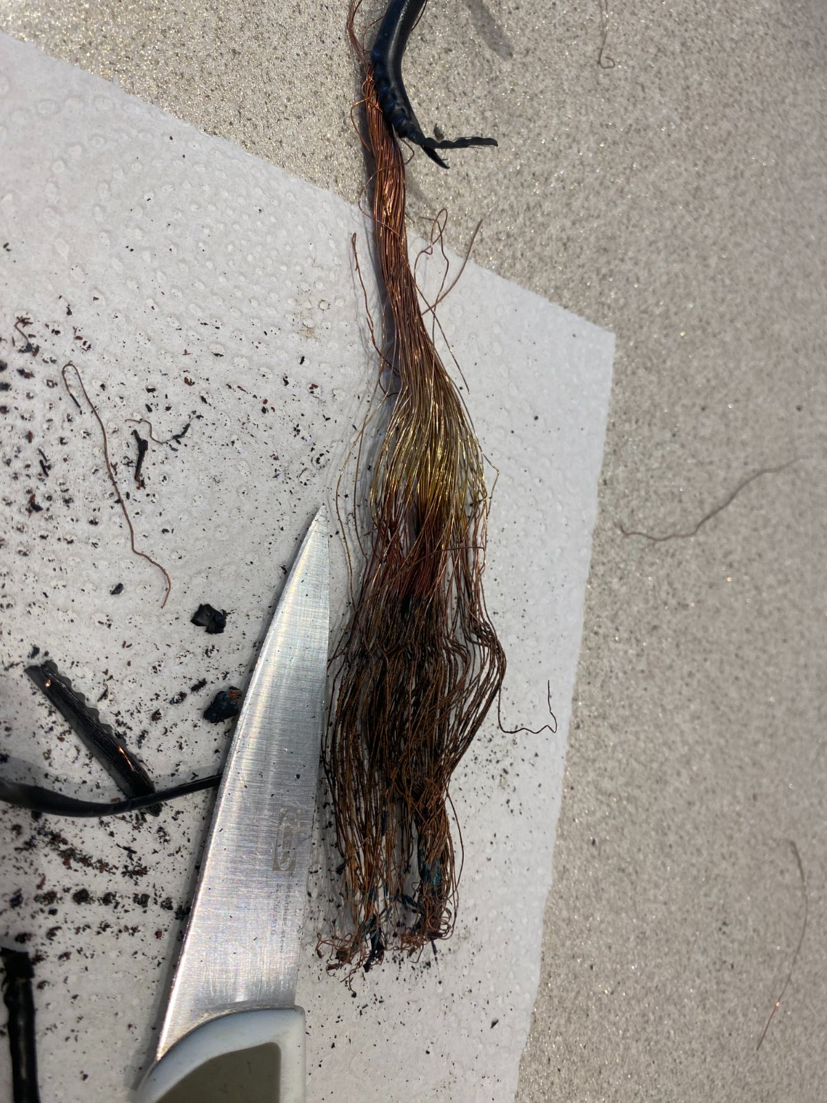

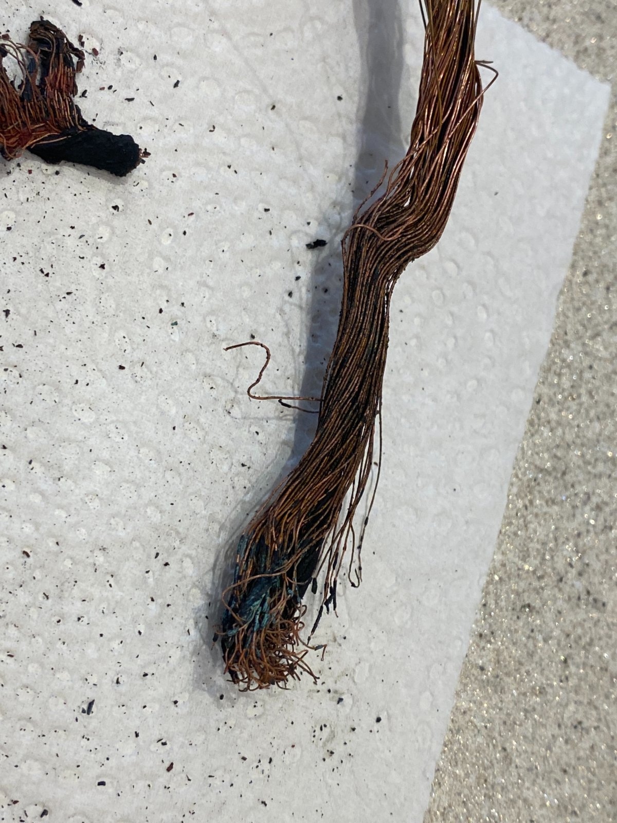

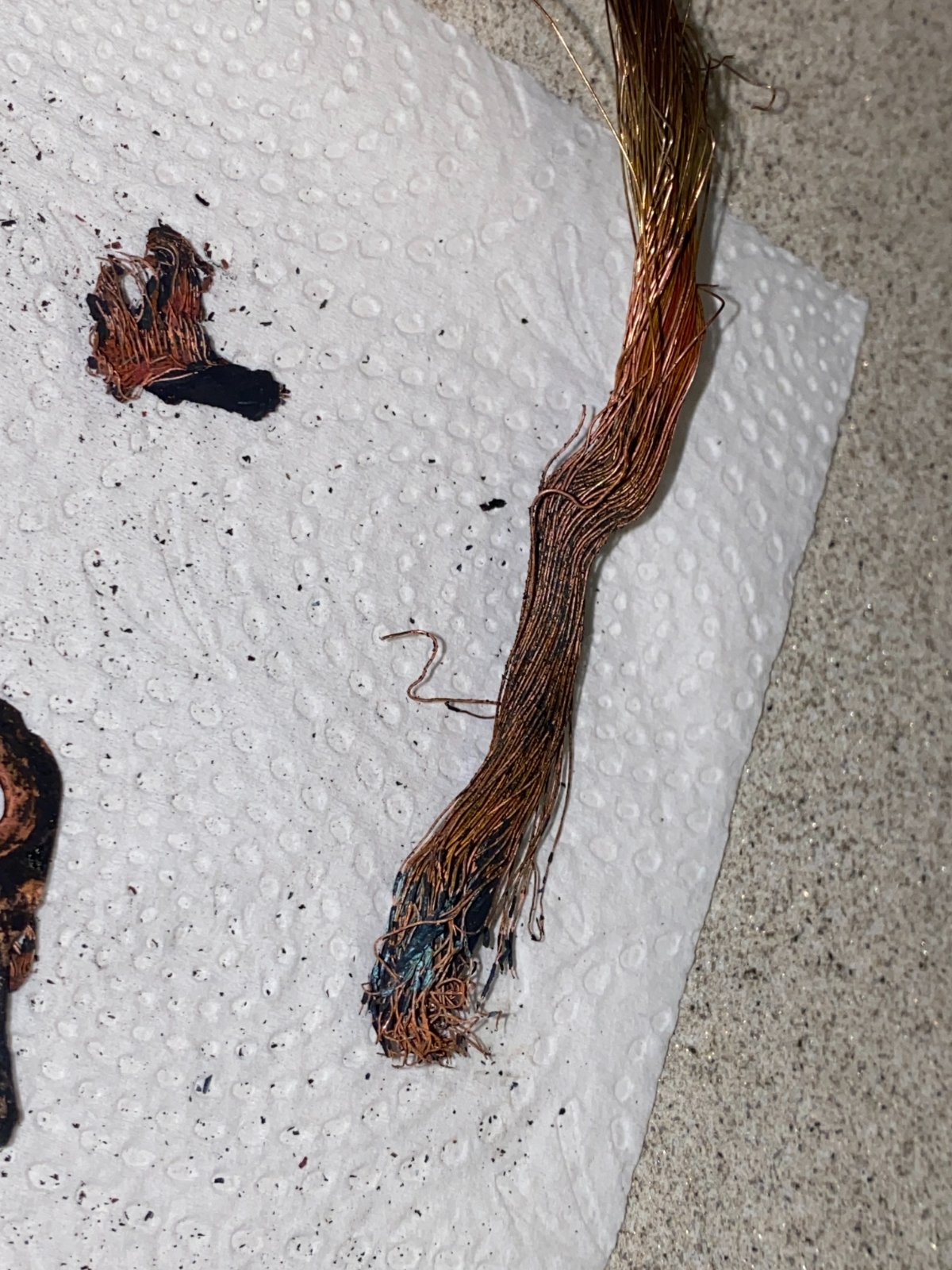

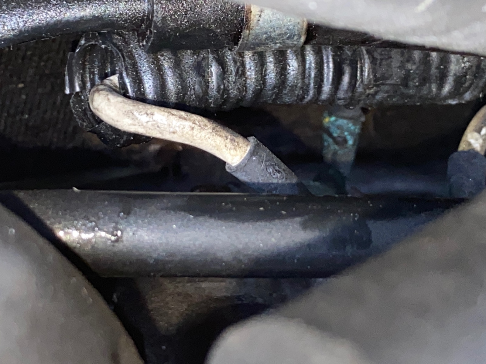

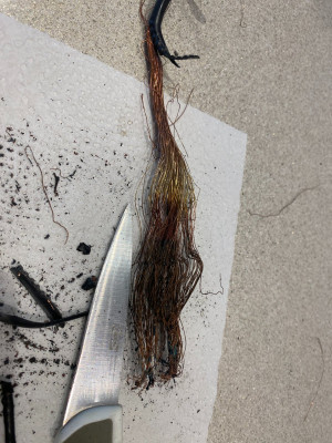

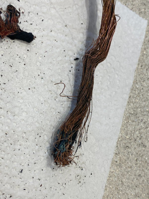

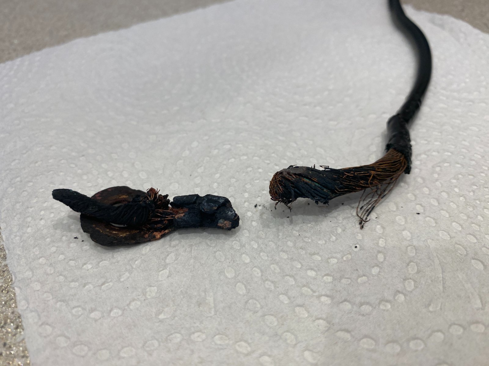

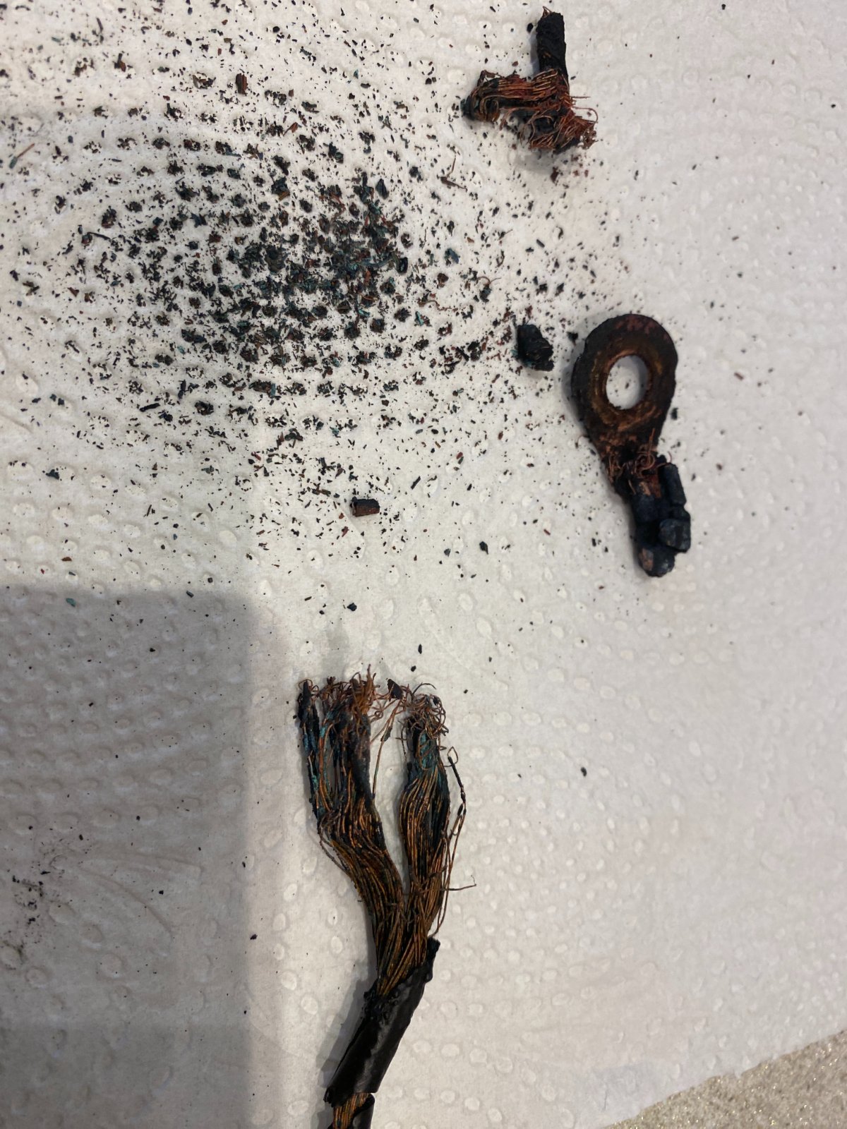

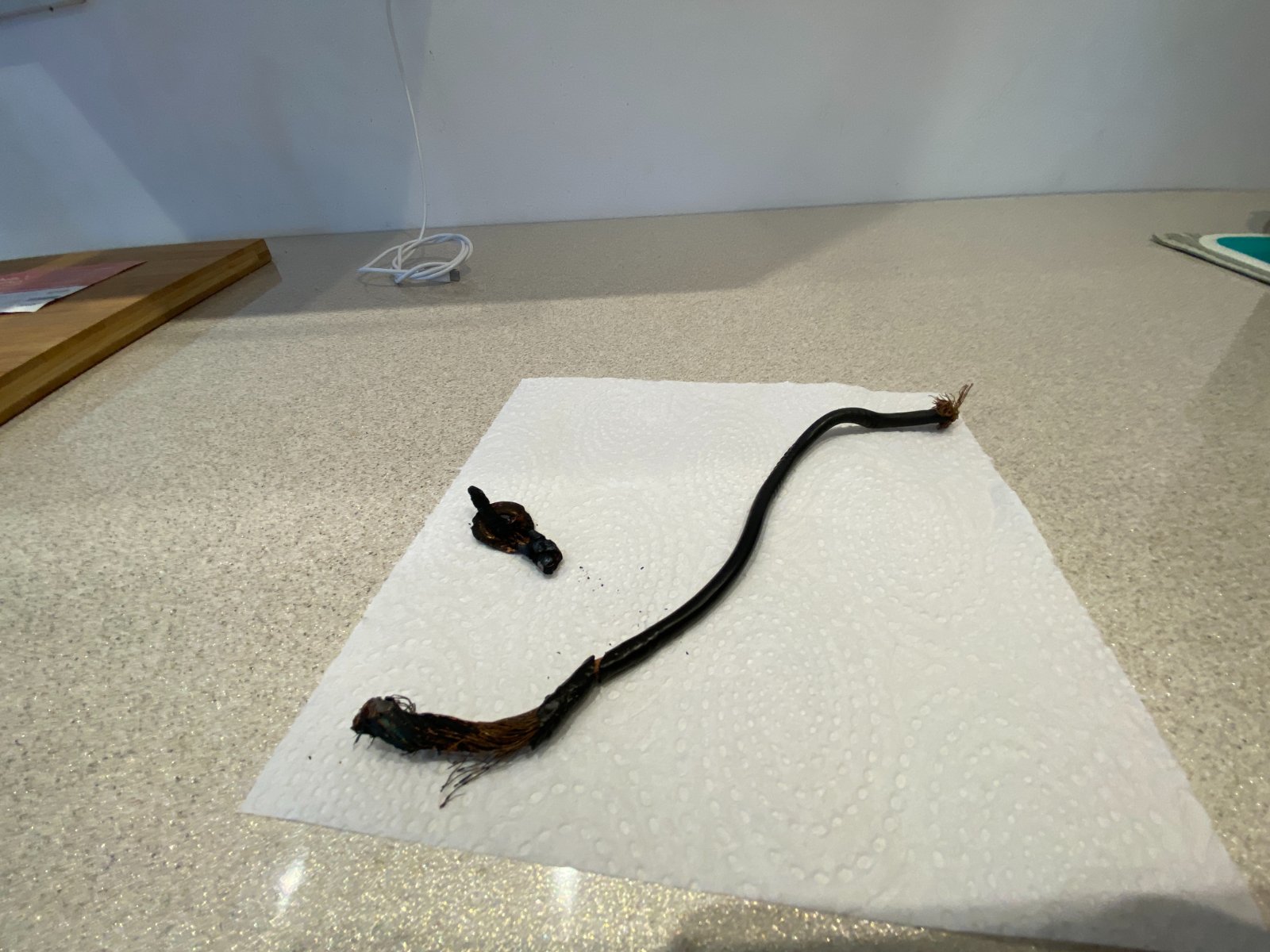

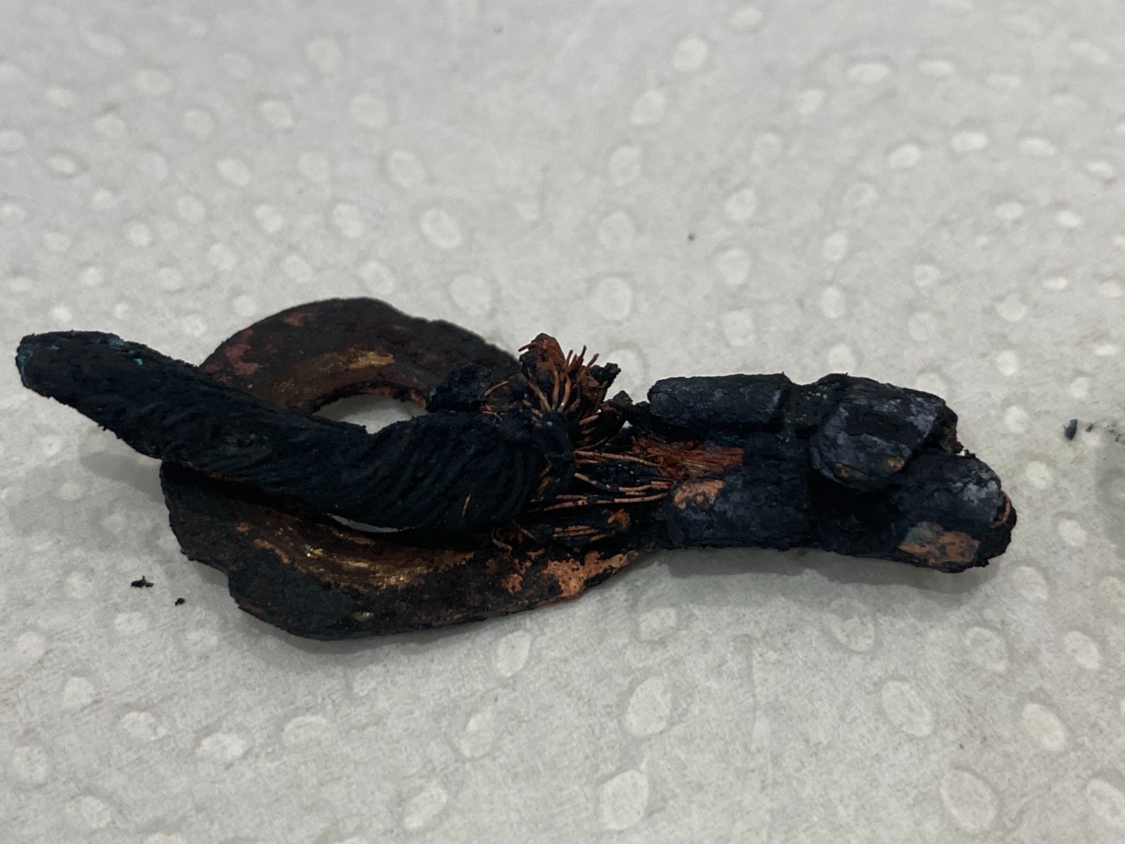

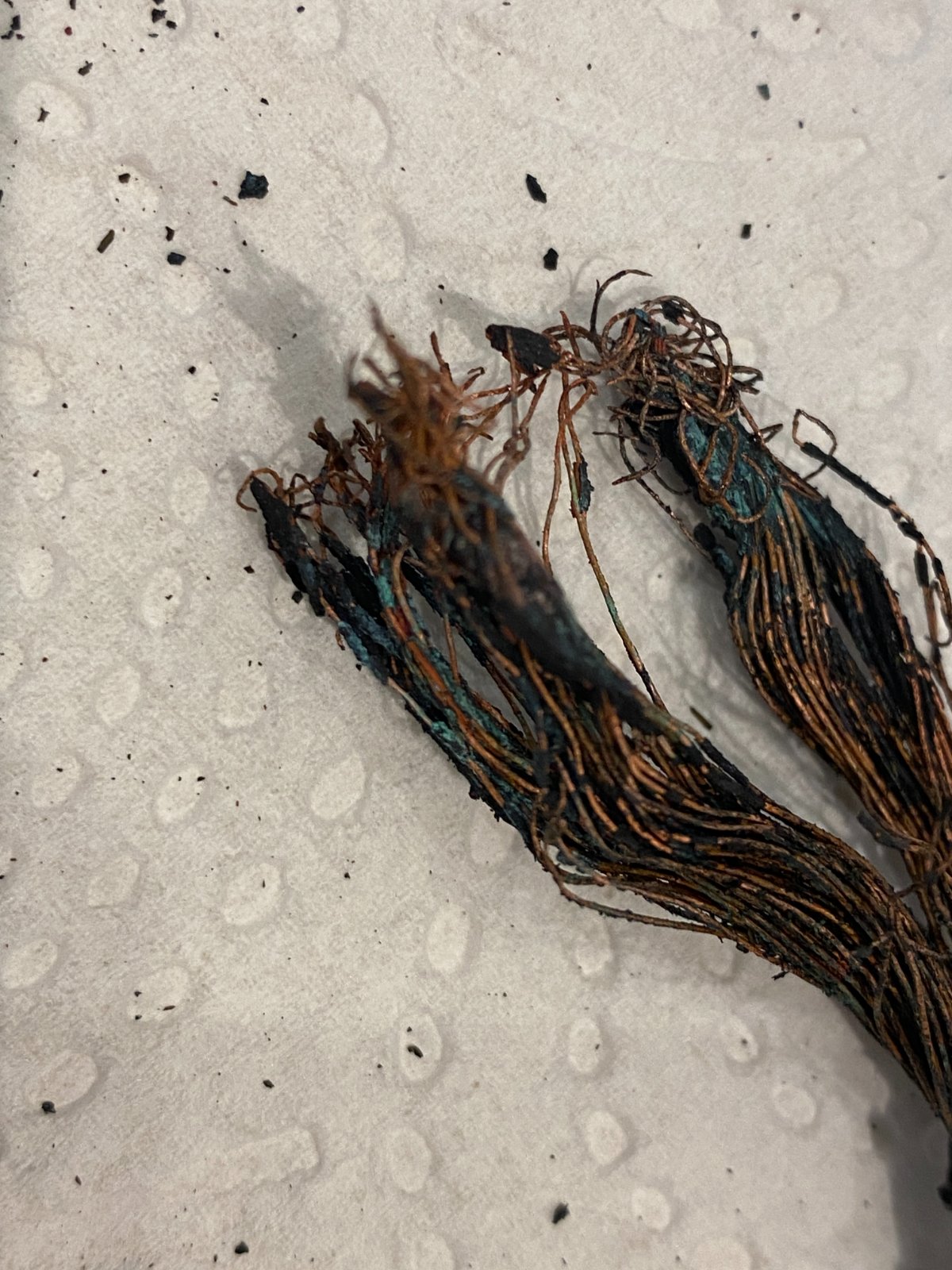

mickthemaverick wrote: 25 Nov 2024, 10:09 I'd agree with you there Roger, swap out the cable to be safe. :-D
OK Captain!
Job finally done when car drove 100 miles back from East Anglia on battery power alone.
That cable is Norfolk'n Good, is it?
Ooooo CRUSTY!
You can see in the last couple of photos where the copper is very oxidised for a good few inches and the resistance would have been pretty resistance and eventually it has caused the cable to overheat and fail. It must have got pretty damned hot.
Posts: 21119
x 8111
Re: Official blog of 'War Horse' (My Xantia HDi). It lives to fight another day!
Pretty much what we expected last year!! :-D

mickthemaverick wrote: 03 Dec 2025, 20:47 Pretty much what we expected last year!! :-D
£2.37 for the shortest cable from Halfords. It was a bit of a stretch but I made it work rather than spend an extra £1.
No-one can say I don't spoil WarHorse...

That was well crusty Roger! Pleased it's all good again :D

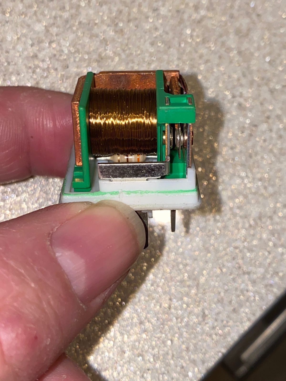

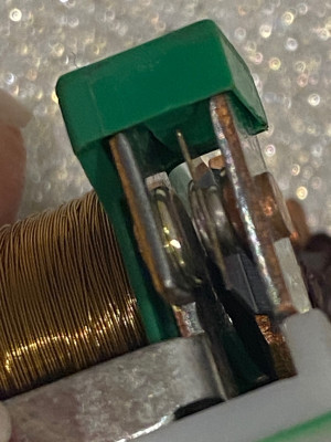

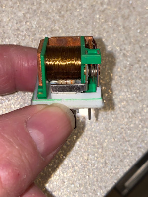

So I've been reading up on the 5 pin Cartier relays.
Allegedly, they are supposed to have a suppression diode across Pins 85 and 86 ie the coil. Does anyone know if this is correct? I bet someone curios has dissected one before now.
Mine has a resistor not a diode and it measure 0.053V on diode setting. It should be seeing 0.5V - 0.7V if it has a diode.

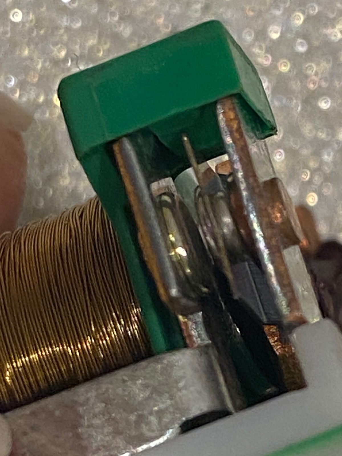

Rhothgar wrote: 05 Dec 2025, 20:18 So I've been reading up on the 5 pin Cartier relays.
Allegedly, they are supposed to have a suppression diode across Pins 85 and 86 ie the coil. Does anyone know if this is correct? I bet someone curious has dissected one before now.
Very tempted to put 3 no. H4 bulbs in serious to test it at 3/4 load for 10 minutes.
Does anyone know how long the coolant heater on the HDi is supposed to be live for. The glow plugs ECU earth switched at the relays.
Points look fine on this one but I am tempted to break into the other one and check the ones out in that too.
You are referring to a back-emf protection diode I assume Roger.
Some do and some don't - the colour of the relay often denotes it. I can't recall now. Purple ones I think but maybe wrong. If you need the diode protection, it's easy to strap one across the coil outboard of the relay... A 1N4004 will do nicely...

CitroJim wrote: 06 Dec 2025, 04:54
Cheers Jim. Yes I am.
I don't need one. I think you might be right though. Never opened a purple one.
Going to have a look at why the coolant heater is making the rubber hoses glow hot. Perhaps I should leave it disconnected but it would just be nice to not to have to wait 20 minutes for your screen to be clear when it's cold.
The rubber became quite crusty from the heat. I think I'm in the "if it ain't broke, don't fix it" springs to mind or in this case, "it's broke, but you're gonna end up in a whole load more s**t so don't fix it" camp. :roll:
