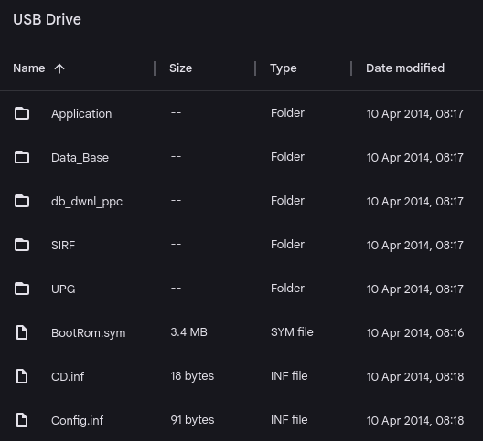

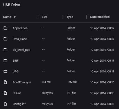

One last thing to check. What file(s) did you put on to the USB drive? A screenshot of this would help.

It's just bizarre that this is the 2nd unit that has gone into this state in my car. Have you heard of the car itself causing this issue or similar?
