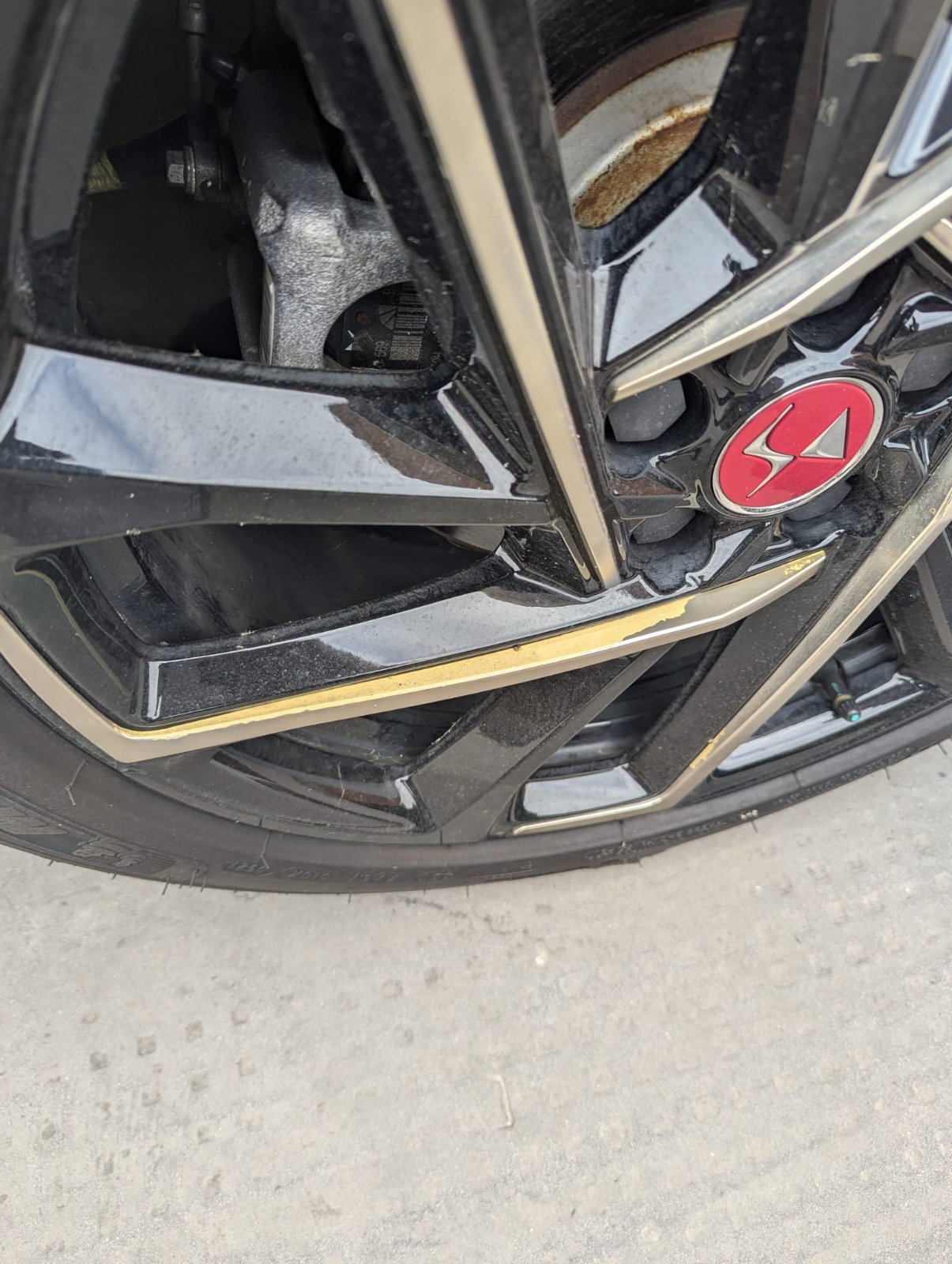

Then a problem i discovered a few months ago. My wheels I thought were black with shiny alloy, but they arent, instead black with chrome plated plastic inserts. First of all I noticed the paint was peeling off them, I emailed the dealer and mentioned it, pic attached. Now two of the "spokes" have fallen off.

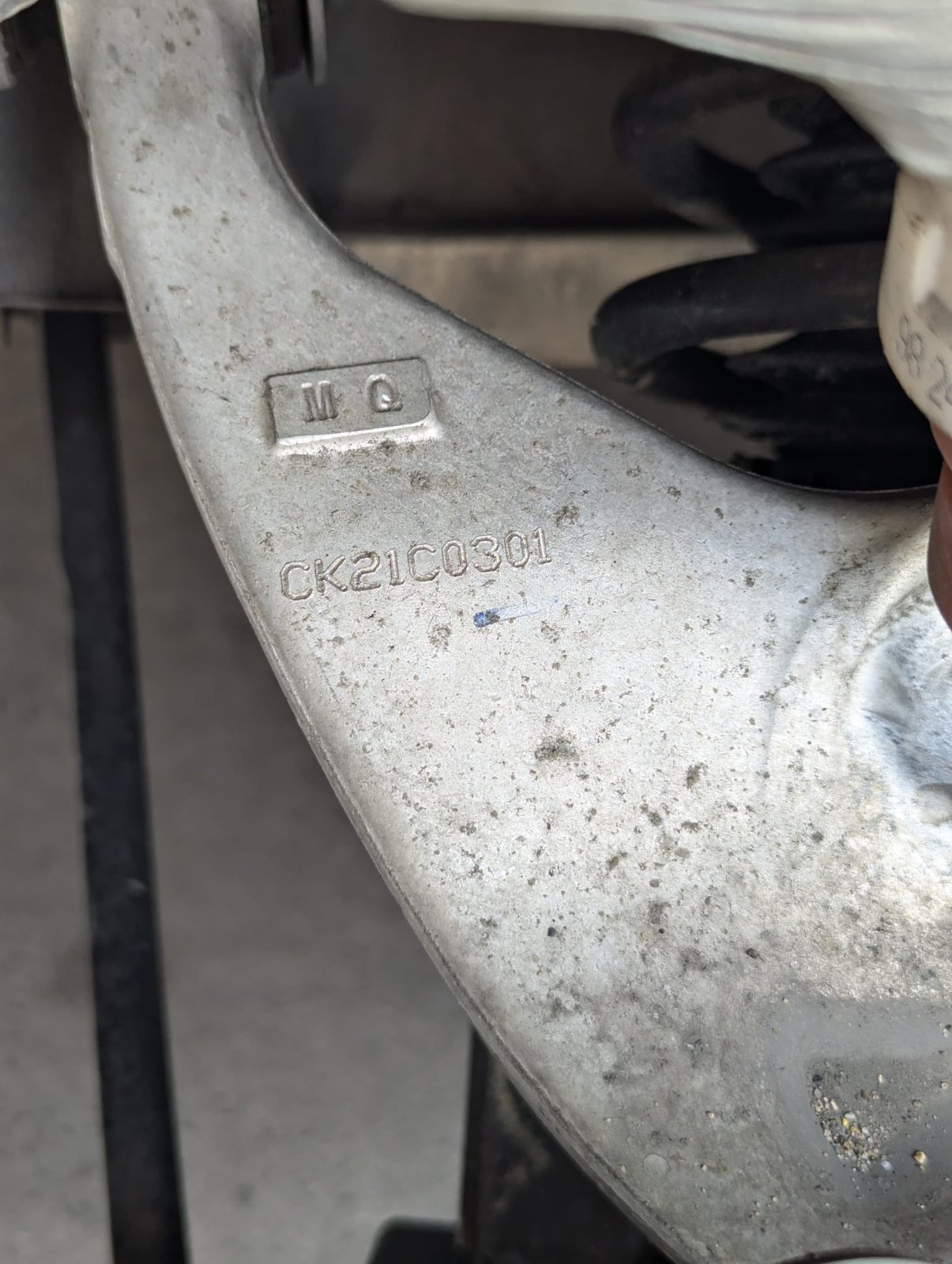

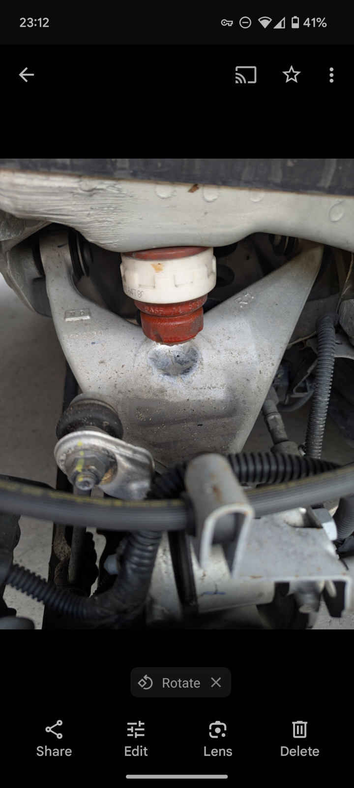

Just got one more thing to ask if you'd be so kind, when I took the drivers side wheel off the part under the bump stop had a part number printed on it "CK21C0301", see attached. Could you pls work your magic and tell me if this part is kosher?

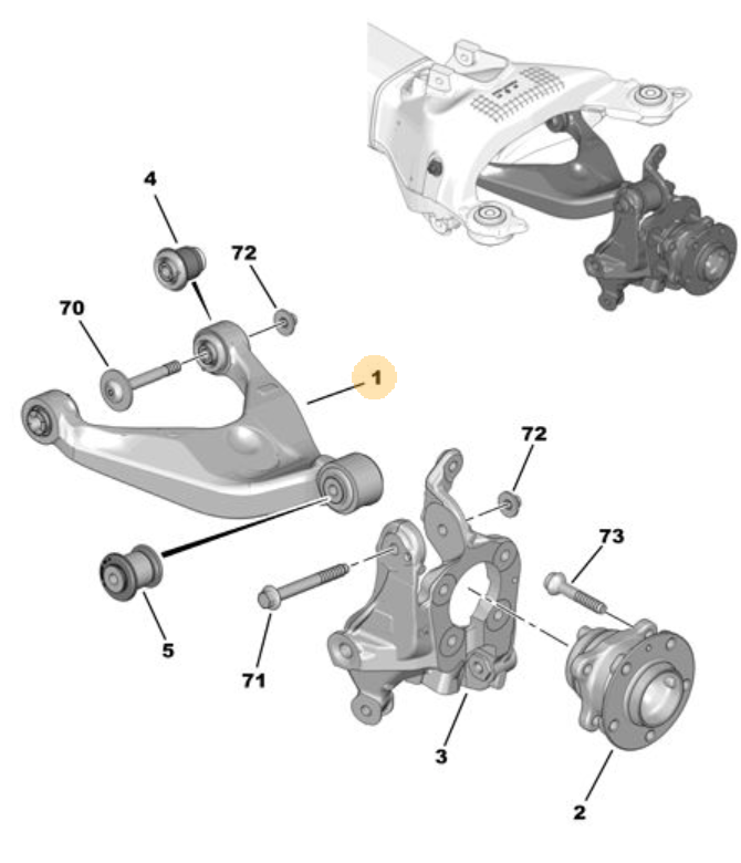

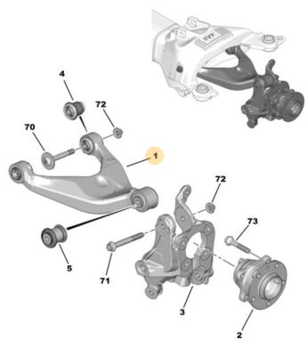

Hi, unfortunately 'CK21C0301' isn't an official part number so I can't help there and the picture is too close so I can't even see what that part is! There's nothing obvious from the suspension components to indicate what that is - can you try and take the picture a bit farther out so I can see it in context with the surroundings?
If I'm honest this looks like the trailing arm....

Sorry for not posting a pic a bit further back. I have one but then went closer to get the number clearer.
I don't know if it's called the trailing arm but it's the part designated no1 in your diagram. If you look to the right of the pic you can just about see the numbers on the bump stop which I queried with you in the past.

Yes, that's the trailing arm.
