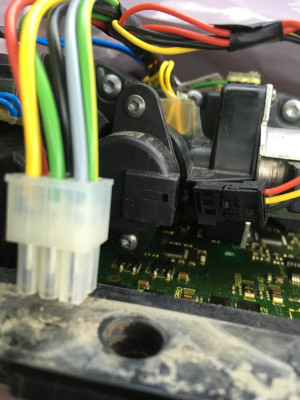

So for the second solution just do the usual...........which would be;
1-Drain tank
2-Drop tank
3-Disconnect Adblue supply pipe
4-Disconnect wiring harness
then
5-Remove pump module from tank unit
At this point there are 2x cable connections to undo and 2x screws. NOTE (these are pentalobe 5 point screws and I didn't have one so I carefully used a suitable sized small flathead screwdriver, easy as they are not very tight) and then you can swap out the pressure sensor for a replacement. Then reassemble and refit the tank to car, refill with adblue etc. It would be a good idea to use Diagbox to reinitialise the adblue system as it runs a test at the same time though in most cases this would not be required if all adblue related codes have been cleared from the system.
The photo shows the multicore white cable connector disconnected from the pcb and the sensor black 3 core connector, both disconnected, and with the 2x pentalobe screws as fitted.
1-Drain tank
2-Drop tank
then
