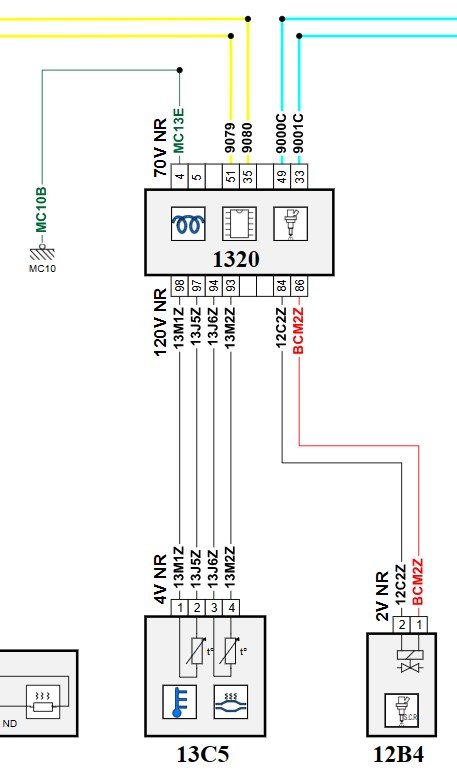

I've now replaced the injector, but the open circuit fault remains. So now I thinking it may be the wiring or the control unit/driver fault. The wiring & connecter by the injector looks ok, but then the wires dissapear into the engine wiring harness. So does anyone know where these are connected? I suspect that this is controlled by the engine ecu (not the Adblue tank). So has anyone got access to a wiring diagram? is there a dosing controller or fuse for this?

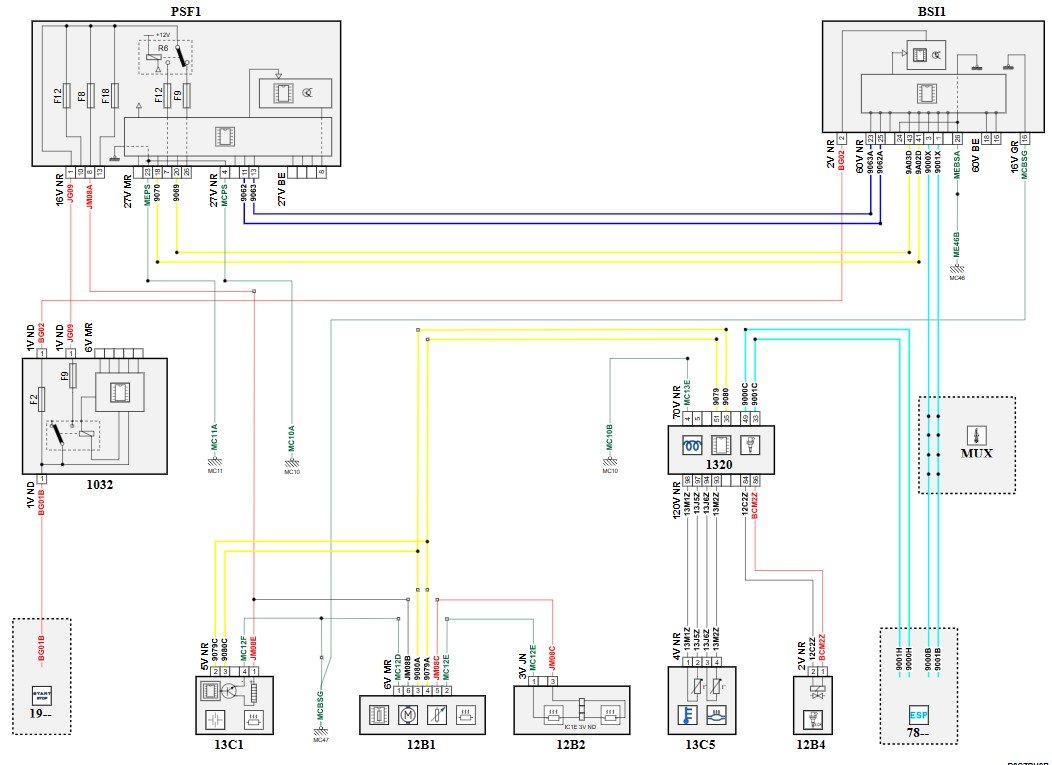

Re: 2015 1.6 Blue HDi 120 308 Adblue problem
Here you go, the urea injector is component 12B4 & is controlled directly by the injection ECU.
Hi Marc & Wheeler, thanks for the fast replies!
I'm just looking at the diagram now, but for info, it was a normal regen on dual carrige way mostly at 60 to 70mph (I use a mobile phone app to see when a regen starts to try and drive at the best regen conditions). I can't see any wiring near the exhaust/SCR except to the injector. That wiring is a bit away and seems ok from a visual check, hence I thought that it must be the injector.
