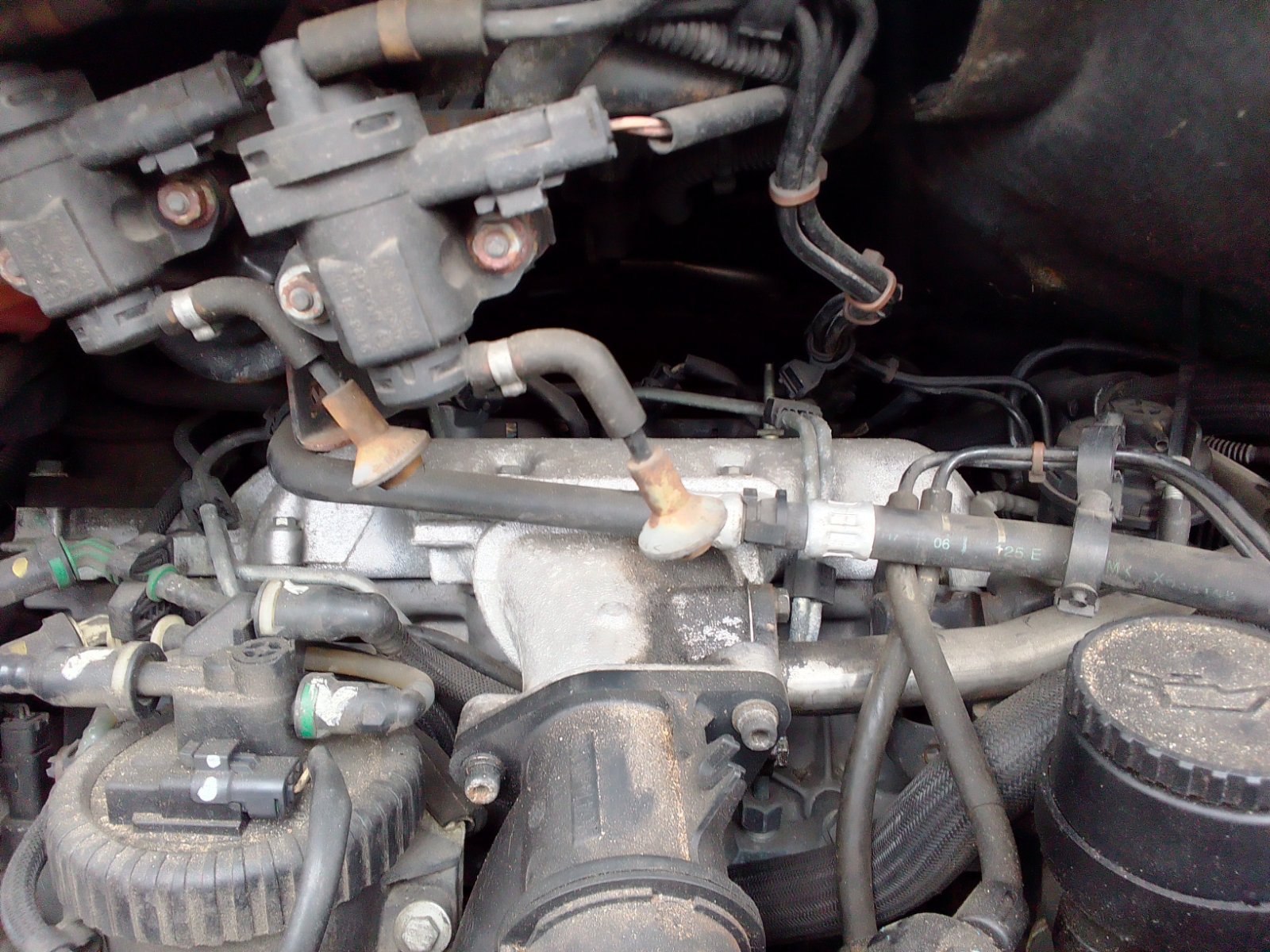

I checked my swirl valve ball connecting thing and dang it has a powerful spring so that's working, took her out for a drive, she detests hills, it's embarrassing. It was 25c outside and started raining, temp dropped to 18c and she seemed to perk up abit. Just got home and looked under the bonnet. Hidden right at the back after the air intake reader there it was, a disconnected air pipe. Back to fault finding tomorrow.

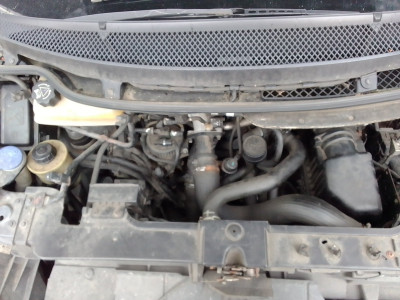

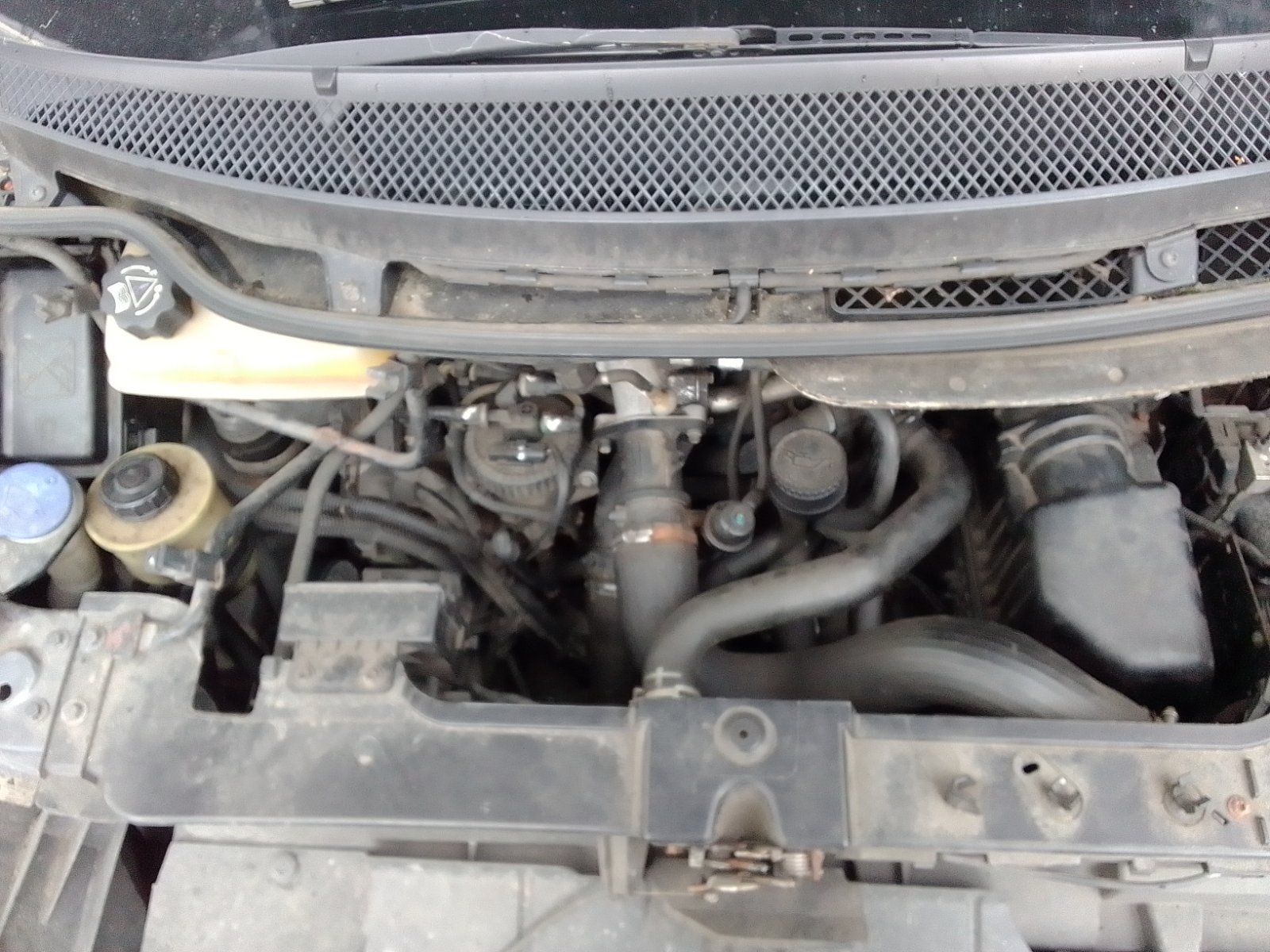

For those that have a 2.2 engine in the C5, this is a C8 2.2 engine, difficult to reach anything. so that will give a idea of what we are up against, can get to the diesel fuel filter and starter motor, after that....good luck!!

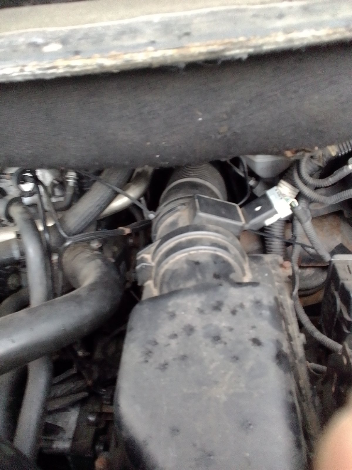

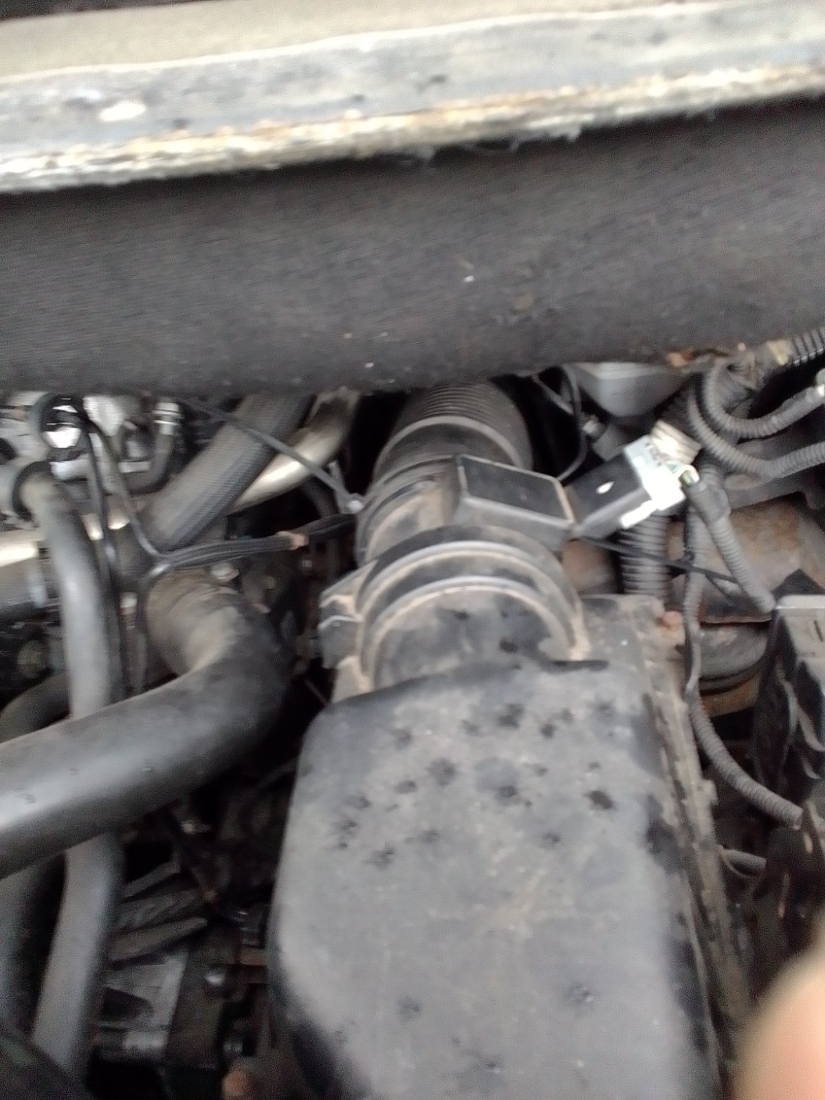

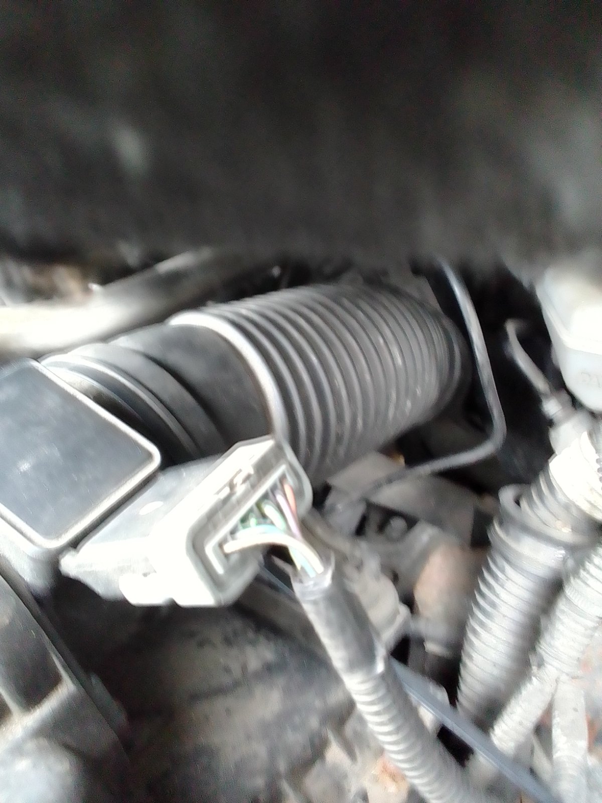

That 4th photo was my air pipe issue not being connected at the rear

Have to agree that looks no fun at all really. Think you've sadly two options for an in-depth jobs in that:
- become adept at key hole surgery

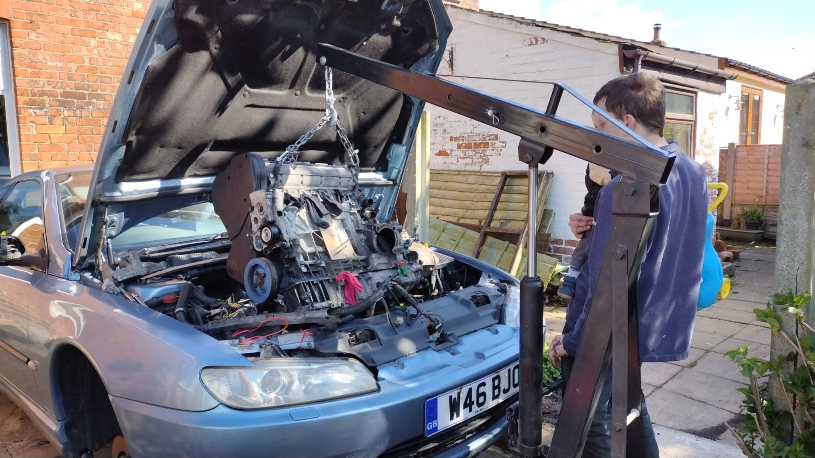

Oh dear. It looks like any significant work on the back of the cylinder head would require the engine to be dropped - even access to the glow plugs?!!

That looks like a nightmare to work on. They really know how to squeeze the man hours into service work on them.yeah engine out to change the bloody glow plugs. The design is awful.
