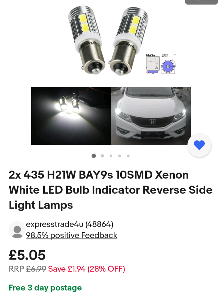

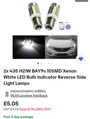

LED H21W equivalents bought:

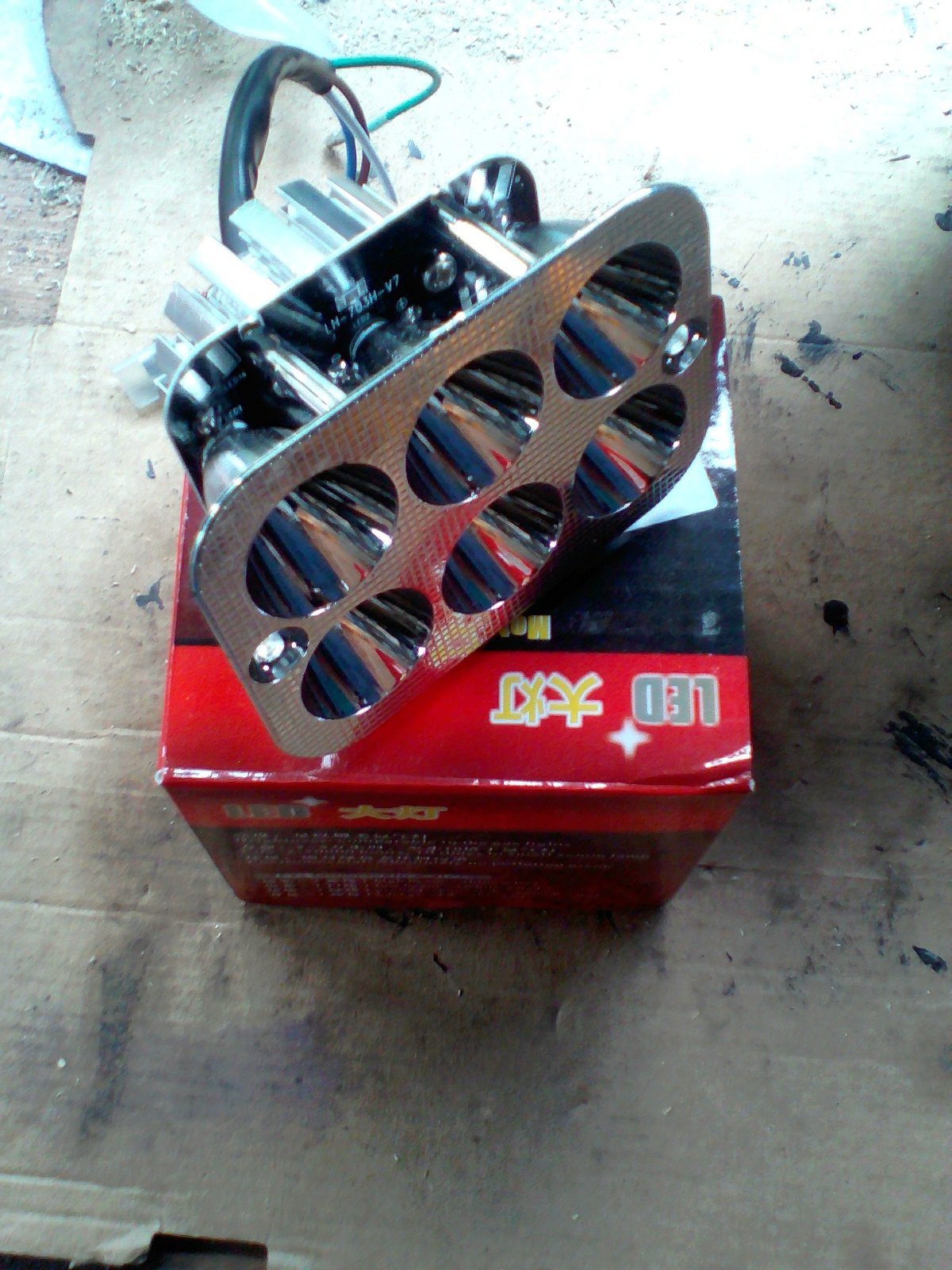

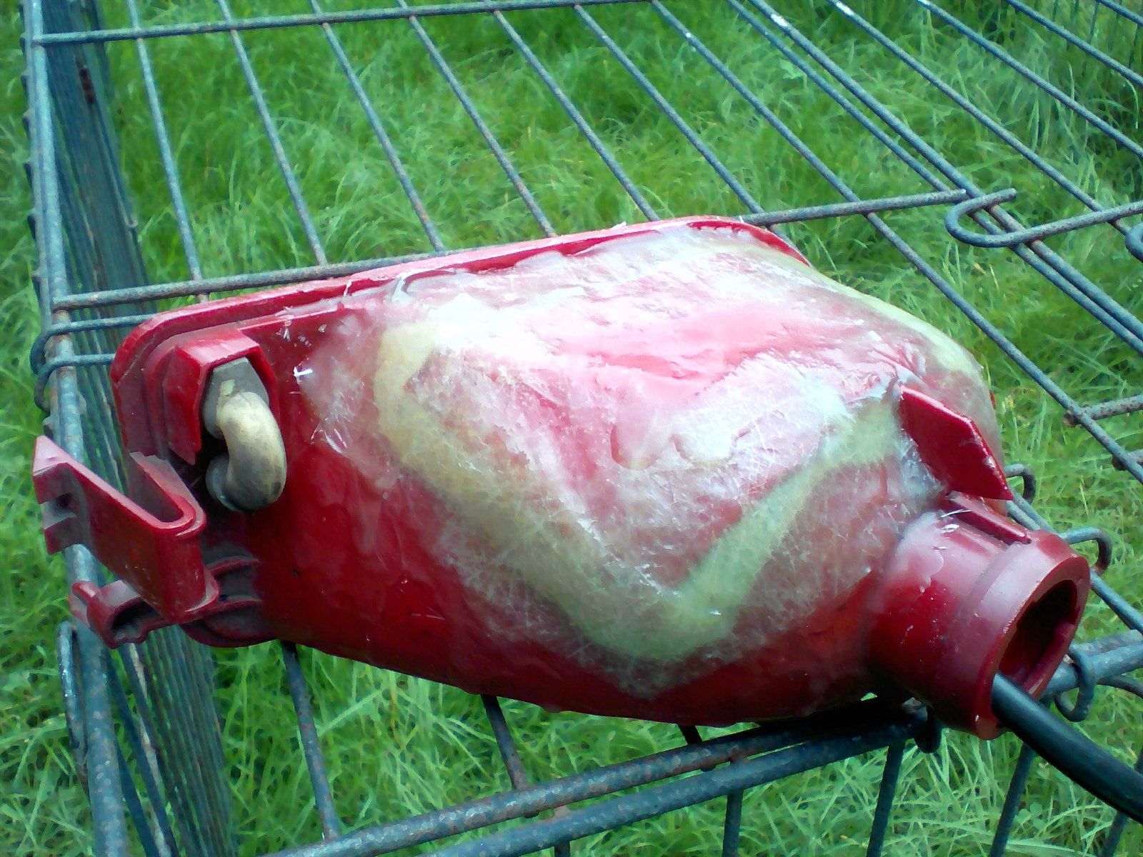

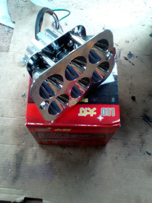

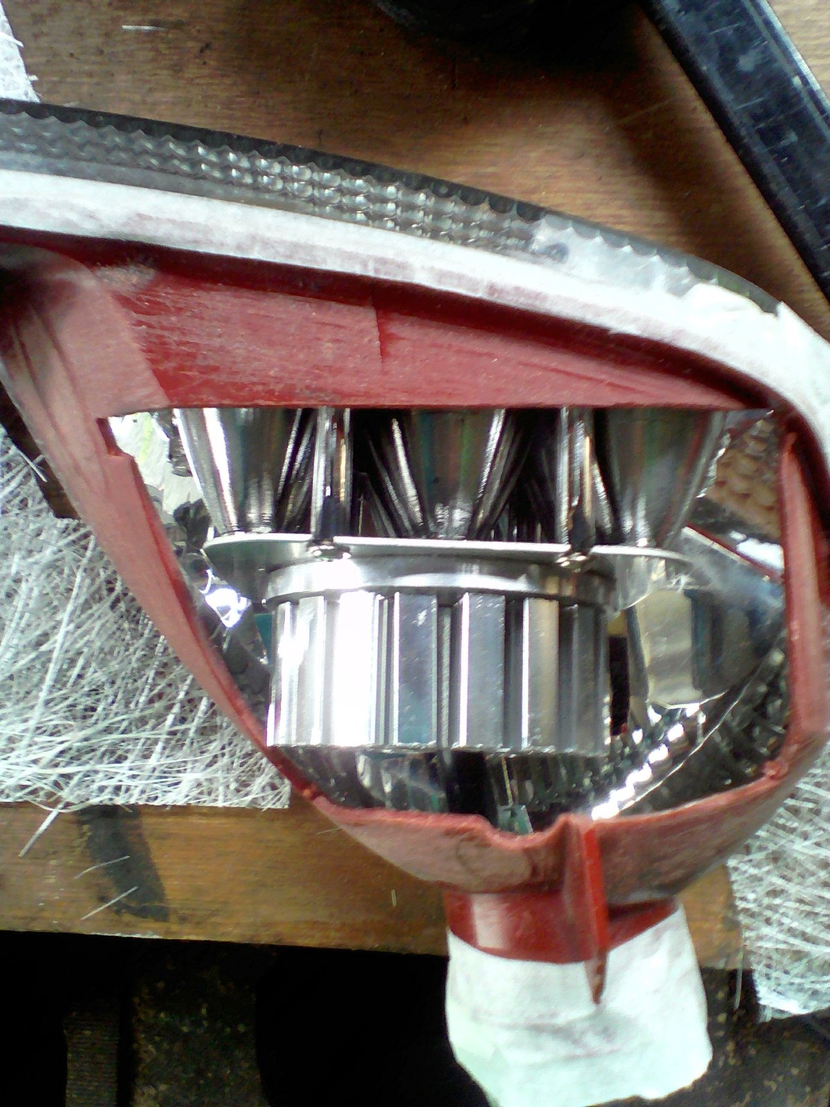

I did get a touch more involved improving my previous C4 rubbish reversing light output:
Fair to say that was a good improvement!
