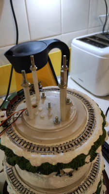

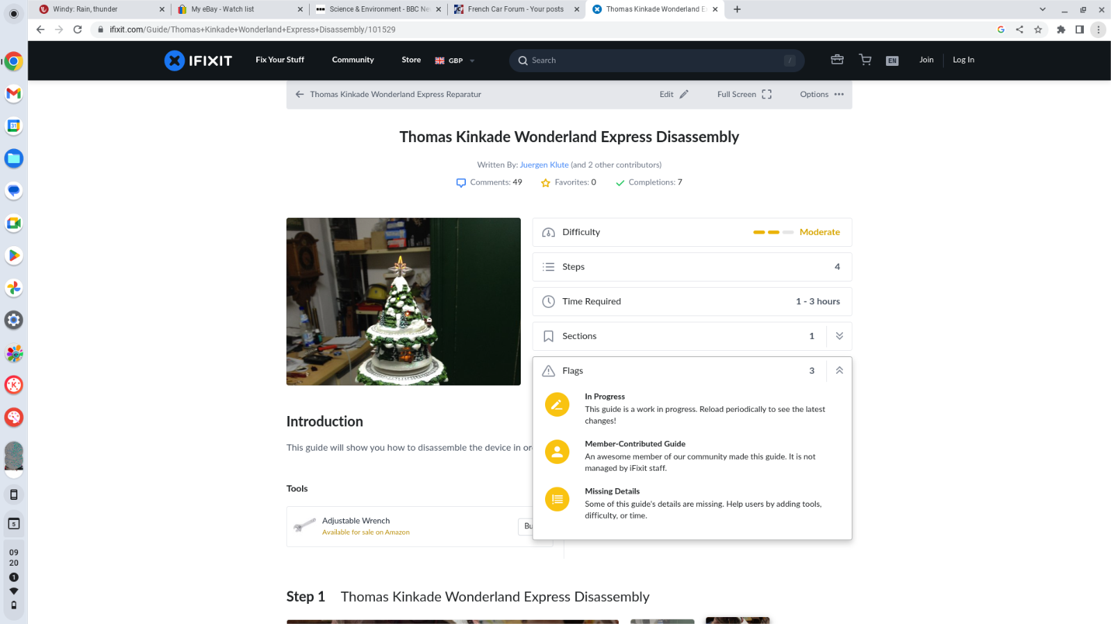

This is the online version for the dismantling of the KinKade Mountain Railway tower.
I am going to draw all the threads together here as I progress.
Dormouse
Posts: 2145
Joined: 15 Apr 2021, 14:32
x 696
Re: Just when you thought it was safe to relax
Unread post by Dormouse »

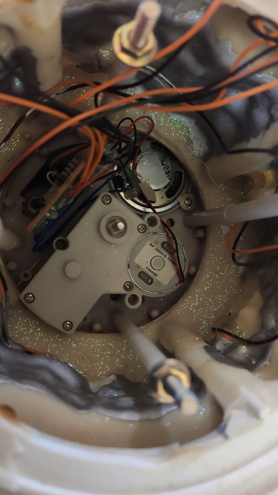

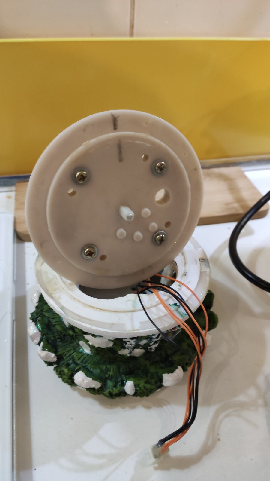

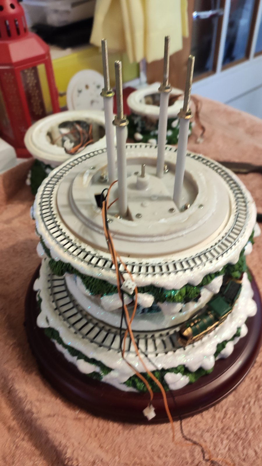

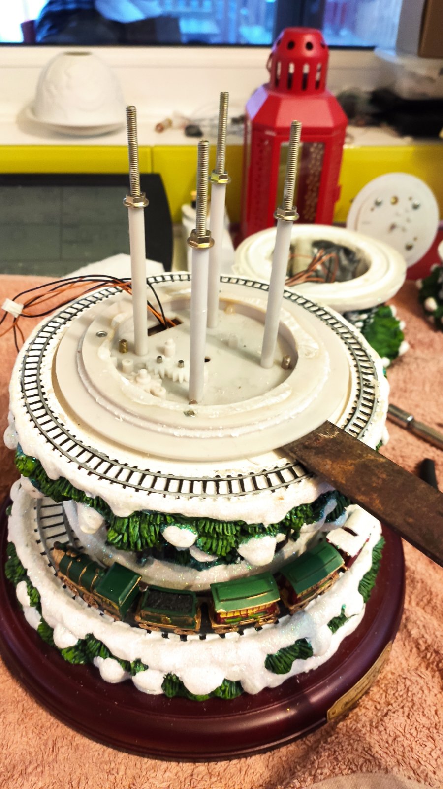

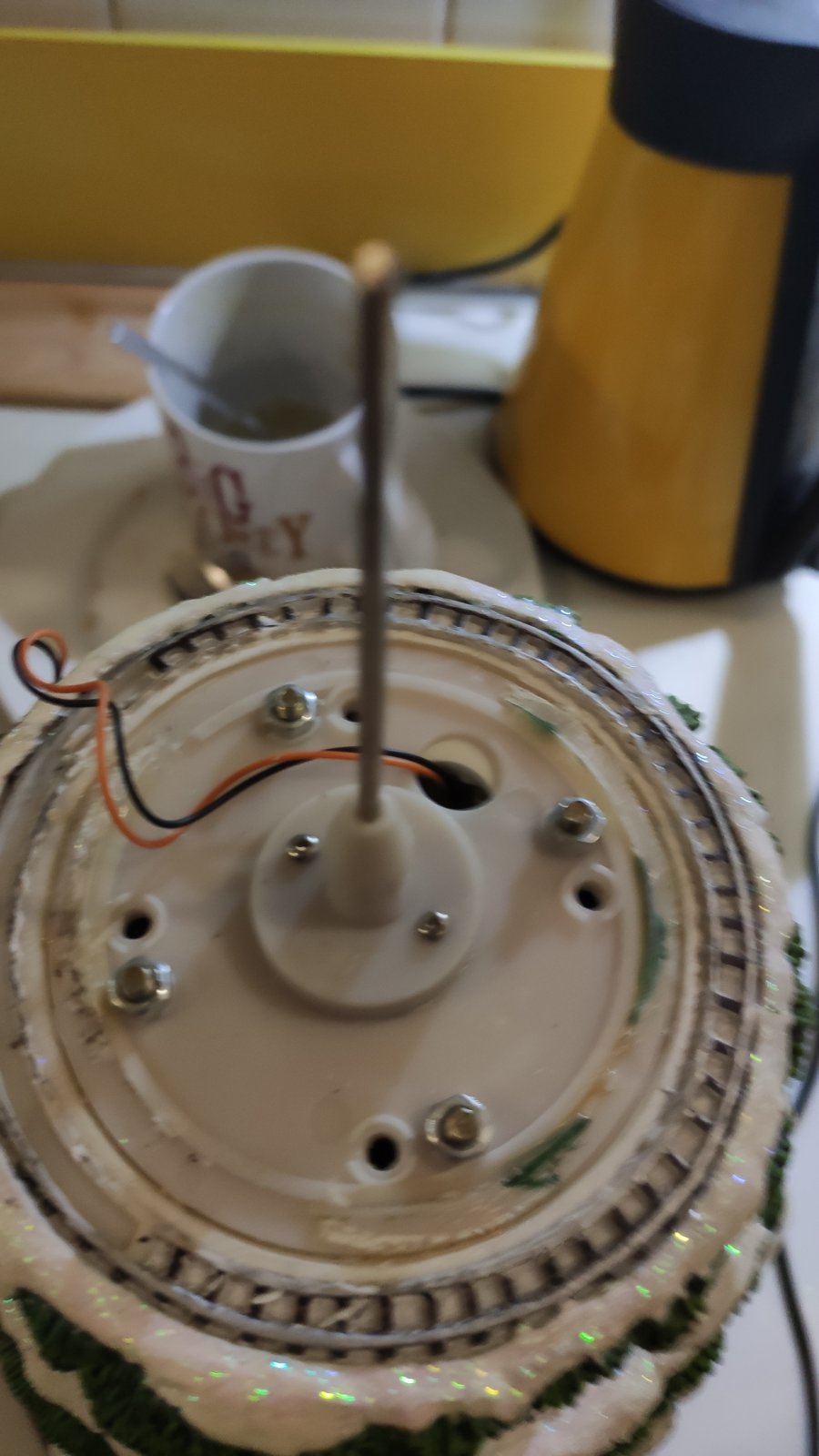

The Wonderland Express is proving to be a bit of a pain. I got the cone at the top off with heat and a strong blade. The next level just would not respond to huge amounts of heat and gentle persuasion so I decided to just get it apart come what may. I removed everything I could then used a 1" chisel to work round the joint and used my spare hand to twist the piece back and forth. Eventually the joint started to give and I just kept working round and round the joint and eventually I got it to part company but it was not easy.
I finally got it to where I had access to the gearbox and the printed circuit.
I was able to probe the motor and the board.
Power was coming from the switch but not reaching the motor. I have yet to test the lights.
I dismantled the gearbox cover and could find no issues with the gears.
Each train is attached to the annulus outer ring/flange of an epicyclic train inside a flat plastic housing at each level.
Look carefully at the marks on the case and the outer ring. The shaft that goes through the centre drives the epicyclic gears for all the moving trains. The cases are also glued into place despite being clamped by each level adding to the difficulty in dismantling the model.
Enough for now.

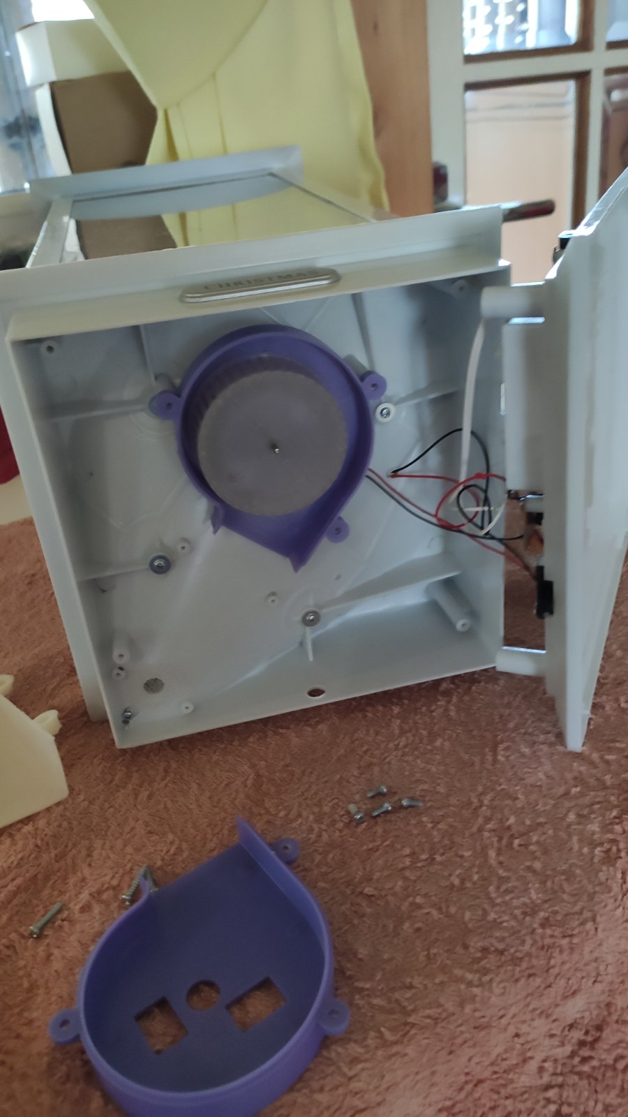

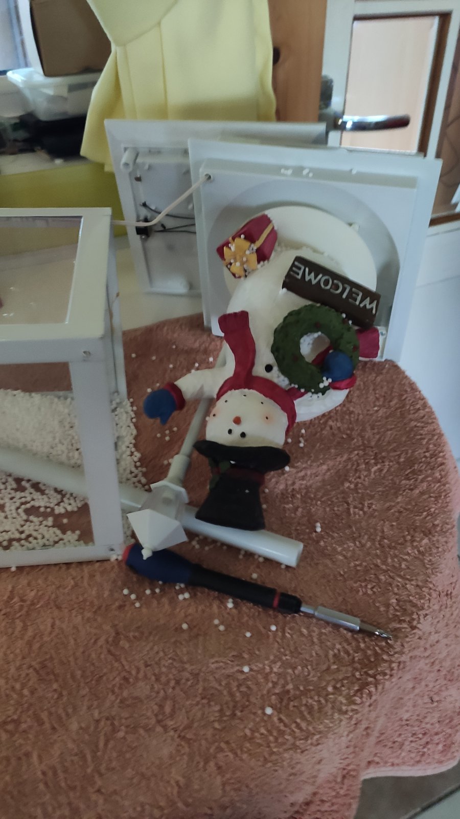

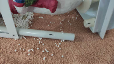

Glutton for punishment that I am, I have repaired two other Xmas models I acquired. Both are fairly expensive items given how simple they appear but I guess that is the price of Christmas.
Anyway this one had issues with the moving Snowman on the top of the train and the see saw as well as a dicky switch for the carols sound effects. Took a whole ten minutes. Result.
The second one took an hour to sort including 20 mins to let the glue set on the dislodged lantern cowl.
I just don't like things that don't work or last as they should.
