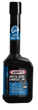

So it really needs getting on a ramp so the UREA circuit can be checked.
Look for crystallisation around the Adblue Injector or anywhere else going back. I strongly advise you to start adding in some Wynne's Adblue Anti-Crystallisation when you fill the tank. Personally, when I buy a container of Adblue, I measure out and dose the refill tank with Wynne's, so that whenever I top my Adblue up, it is ready-dosed.

Recently i cleaned the adblue injector on my 508 (engine code DW10FC) after using the Wynn"s adblue additive as preventative maintenance as i believe is the key for these cars not to get damaged. Then i checked the injector and i confirm that the product works.Only with the use of brake cleaner the crystallization of the injector wiped off as light ash.
