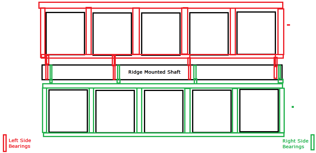

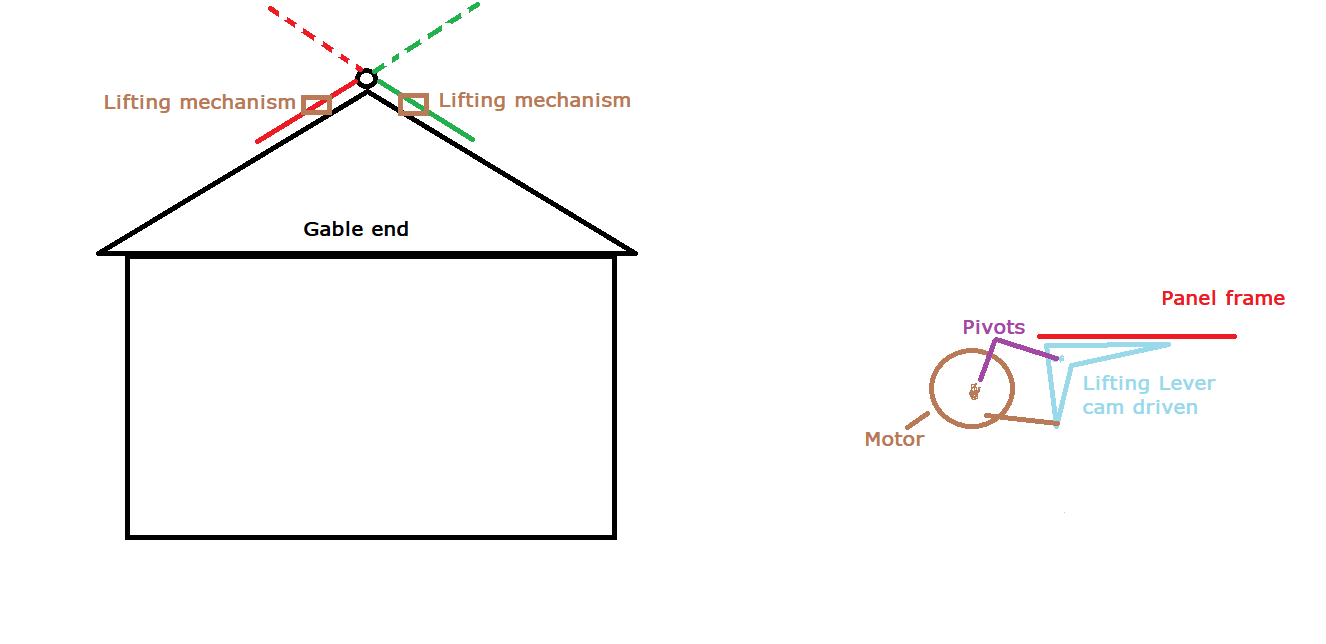

Thanks Gibbo, taking that point on board I had a rethink and came up with the idea of splitting the panel frames about a central axis so they could each be stowed flat if the wind speed gets above a pre-determined level. Again a couple of pictures illustrate my initial thinking:Gibbo2286 wrote: 14 Aug 2022, 17:23 Just make sure it's secure enough not to end up in the next street in a gale.

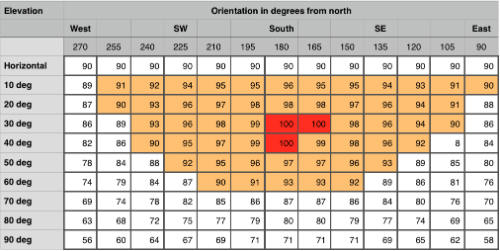

I have been looking a bit at the size/output of panels. They tend to be around 1.7m x 1.1m for a panel of around 400W. and an array of at least 10 panels and preferably 12 would be necessary for a 4kW to 4.8 kW system.
https://www.deegesolar.co.uk/wp-content ... _Panel.pdf
Cost for the panels alone about £4,000 to £5,000.
With quite an awkward roof albeit facing SSE , with two velux, each 1mx1m, and a dormer, the roof surface is rapidly consumed, and in its current form would struggle to fit the requisite number of panels. An additional less productive side roof facing ENE could be used but way from ideal.
The roof slope is about 45° on the folded square of paper held against the internal slope.

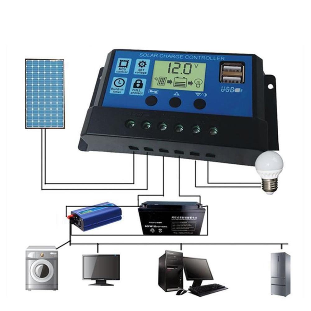

Another potential piece of kit for my system, I may consider two inverters like this to power my two seperate consumer units, garage and house - still at the ideas stage.
https://www.ebay.co.uk/itm/112496420845 ... SwoQ1TmxVg
fed by an array of this type:
https://www.ebay.co.uk/itm/233627677124
via a controller to bridge panel/battery/inverter like this sort of thing:
https://www.ebay.co.uk/itm/144570603491 ... SwE71ijftc
