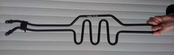

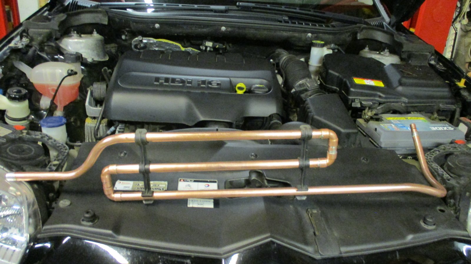

here is one I am in the process of making for my C5, No longer available from Citroen. PS Cooler/Return. Waiting for a brass bar to be delivered to make a couple of hose connectors

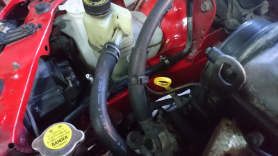

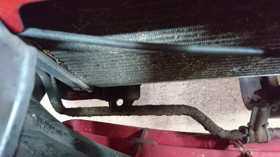

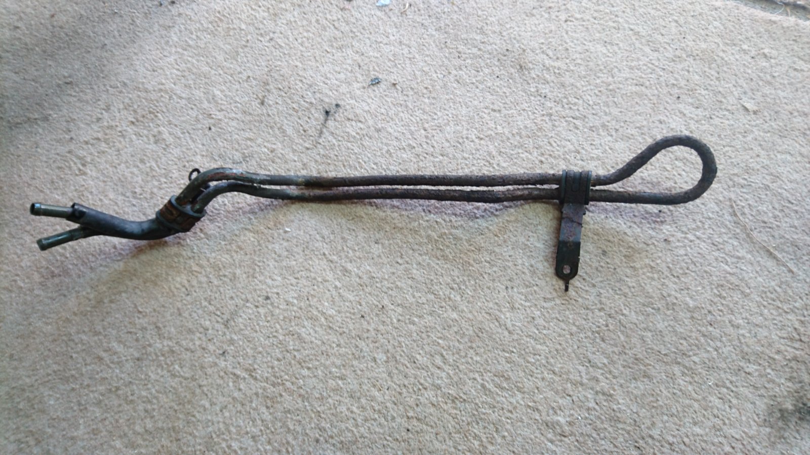

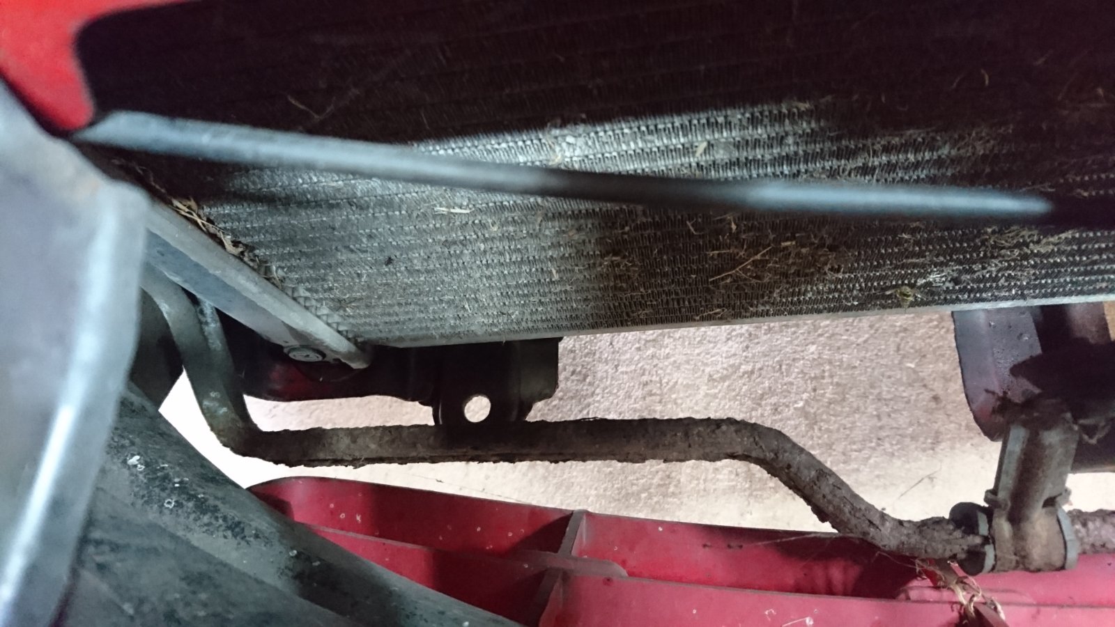

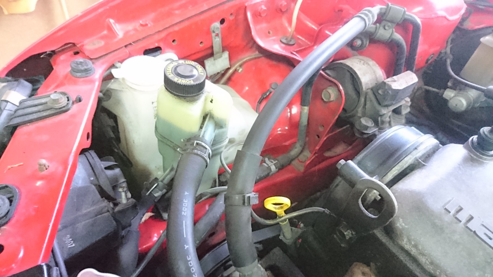

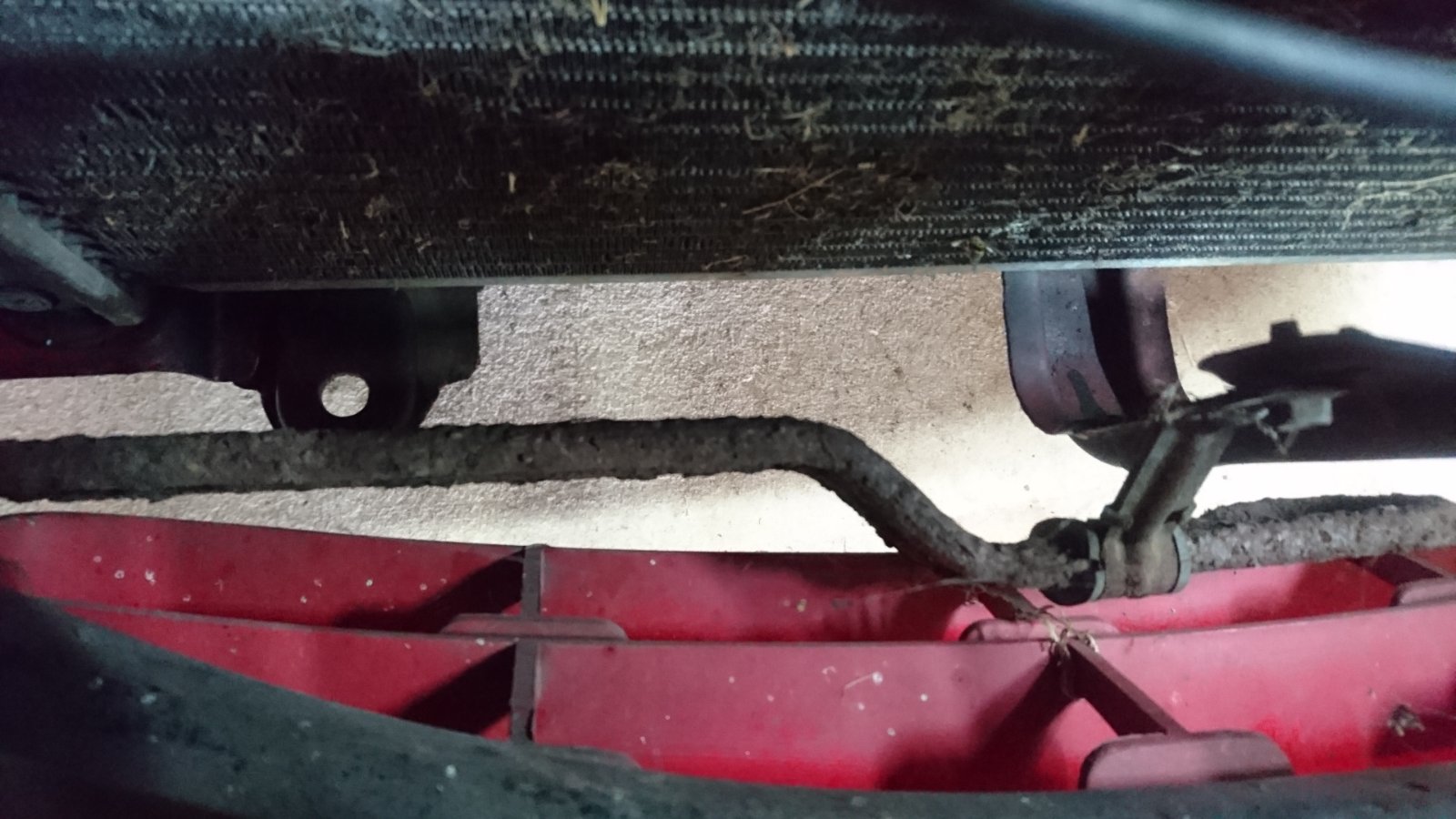

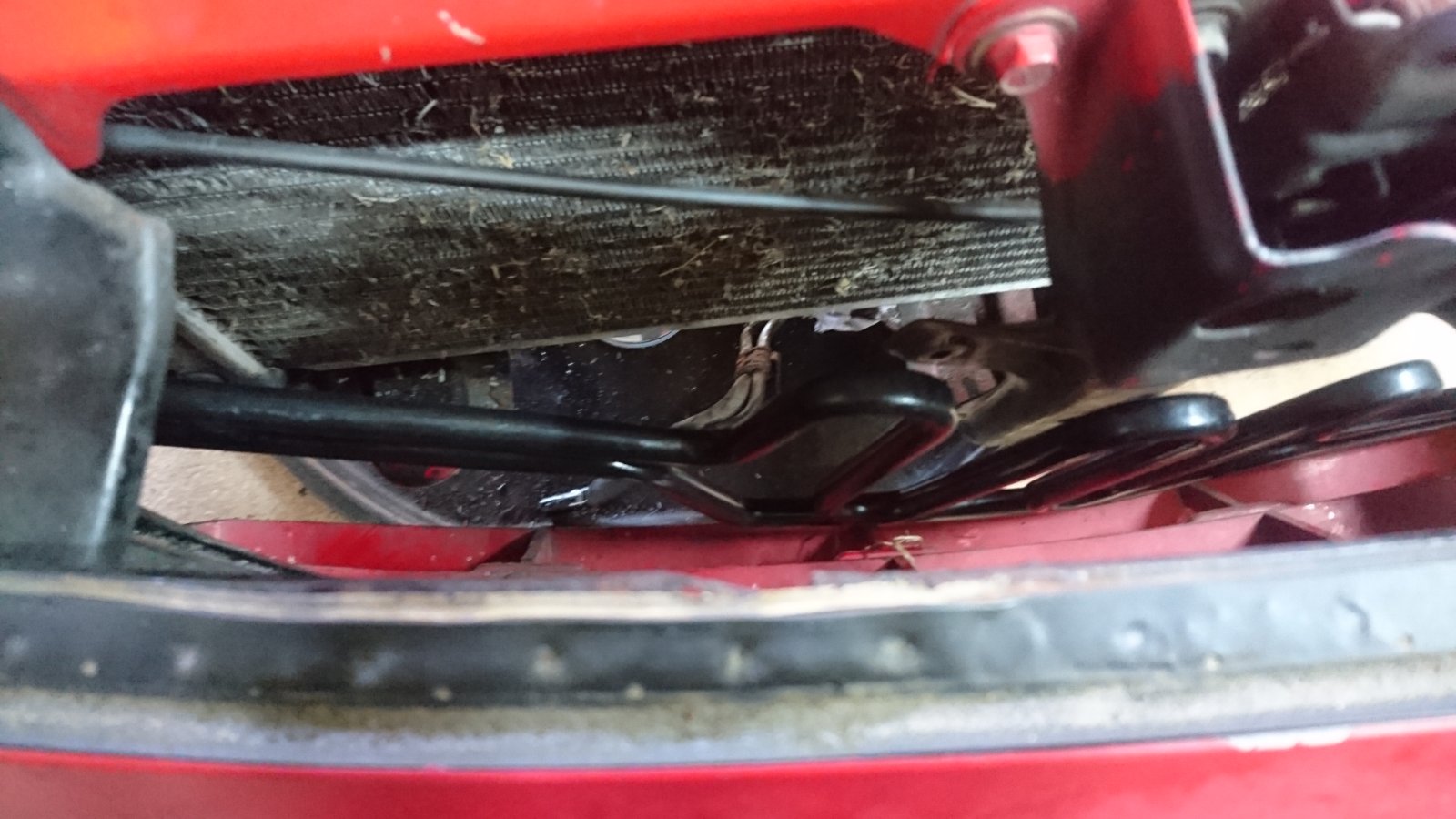

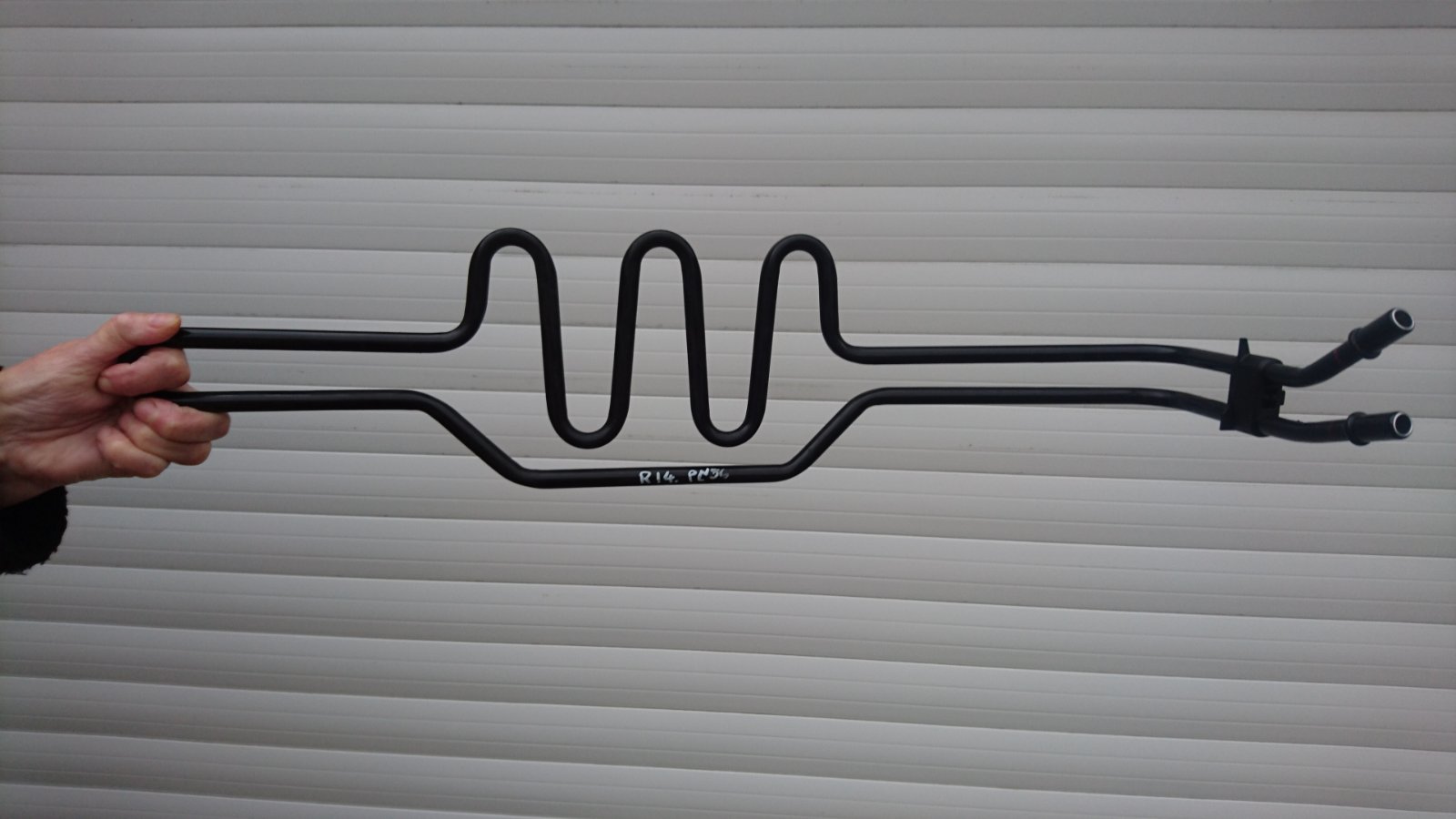

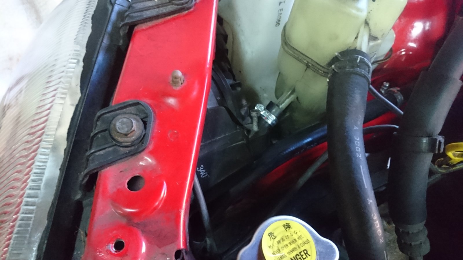

The clips I needed arrived today so it was time to sort the power steering fluid cooler on the MX3. The story is easier told in pictures: :-D
You will remember the new BMW 3 Series cooler
Before I started
Before I started
Before I started
Before I started
Before I started
Before I started

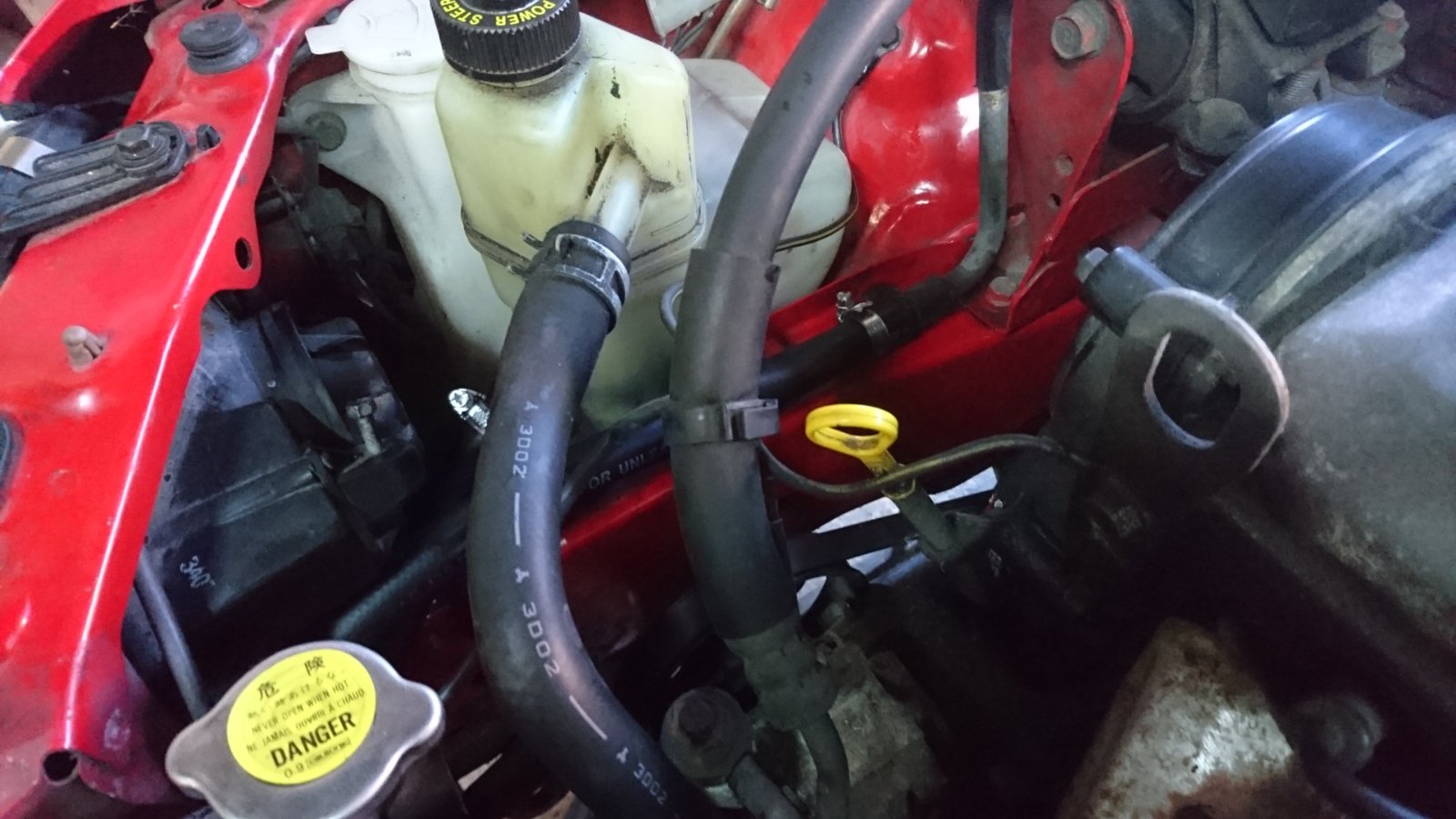

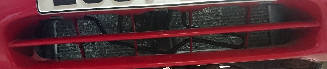

Getting that one out proved to be a bit of a pig but getting the replacement in was even more so!! I had to modify it slightly and then wrangle it into place and the final result is definitely function without finesse!! :-D
After completion
After completion
After completion
After completion
After completion
After completion
After completion
After completion

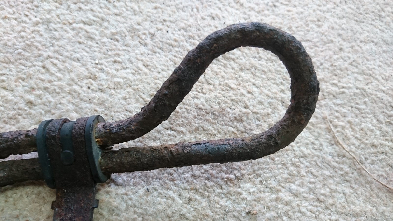

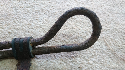

Once I was able to inspect the old one I was even happier that I had set about replacing it:
It really was on its last legs:
Nevertheless another job sorted and the satisfaction of doing the main stealer out of another £735.00 + VAT
Total cost to me was £18.26 and I have half a bottle of Devron 2 in stock for topping up!! Result!! :-D :-D
