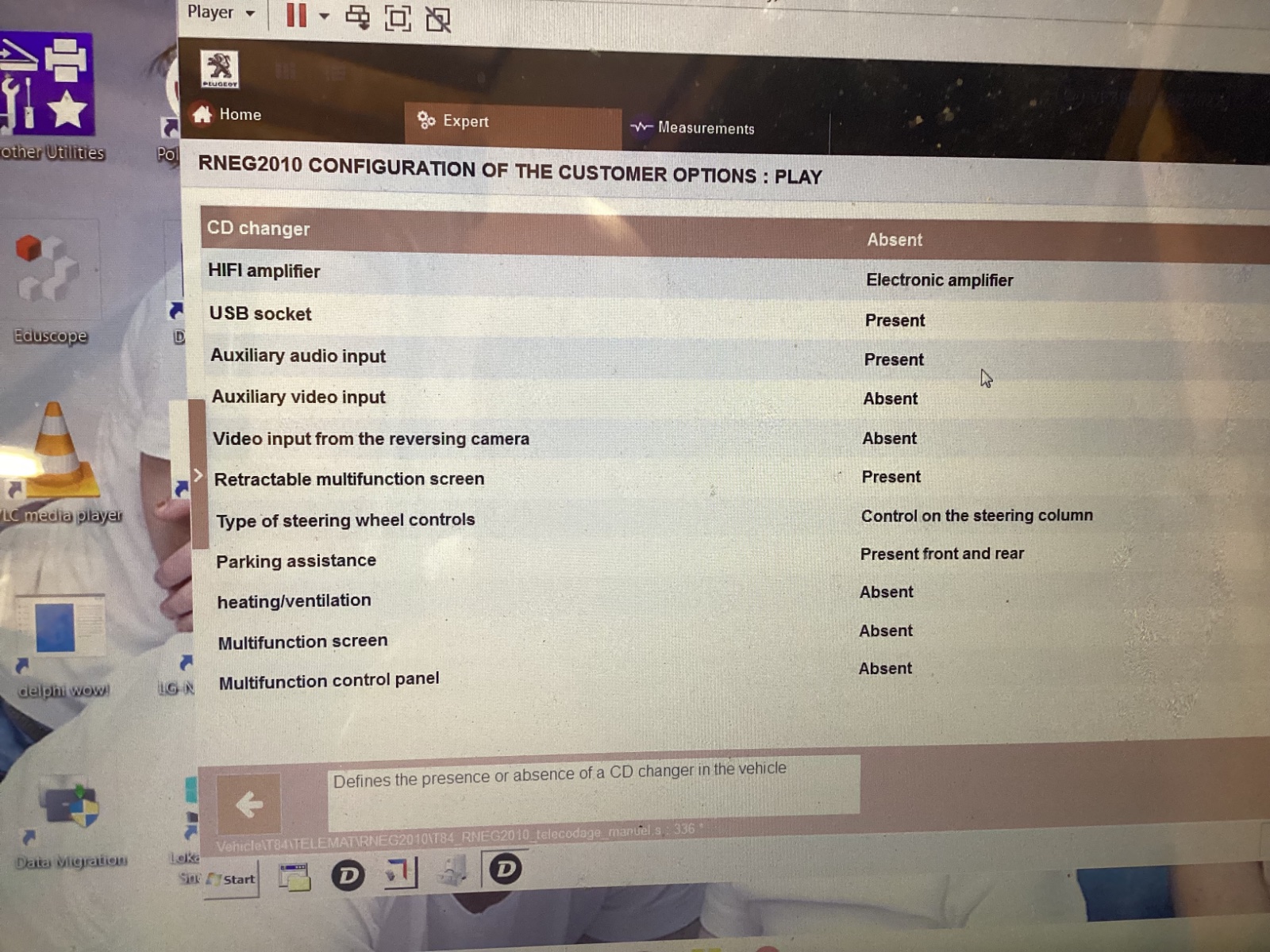

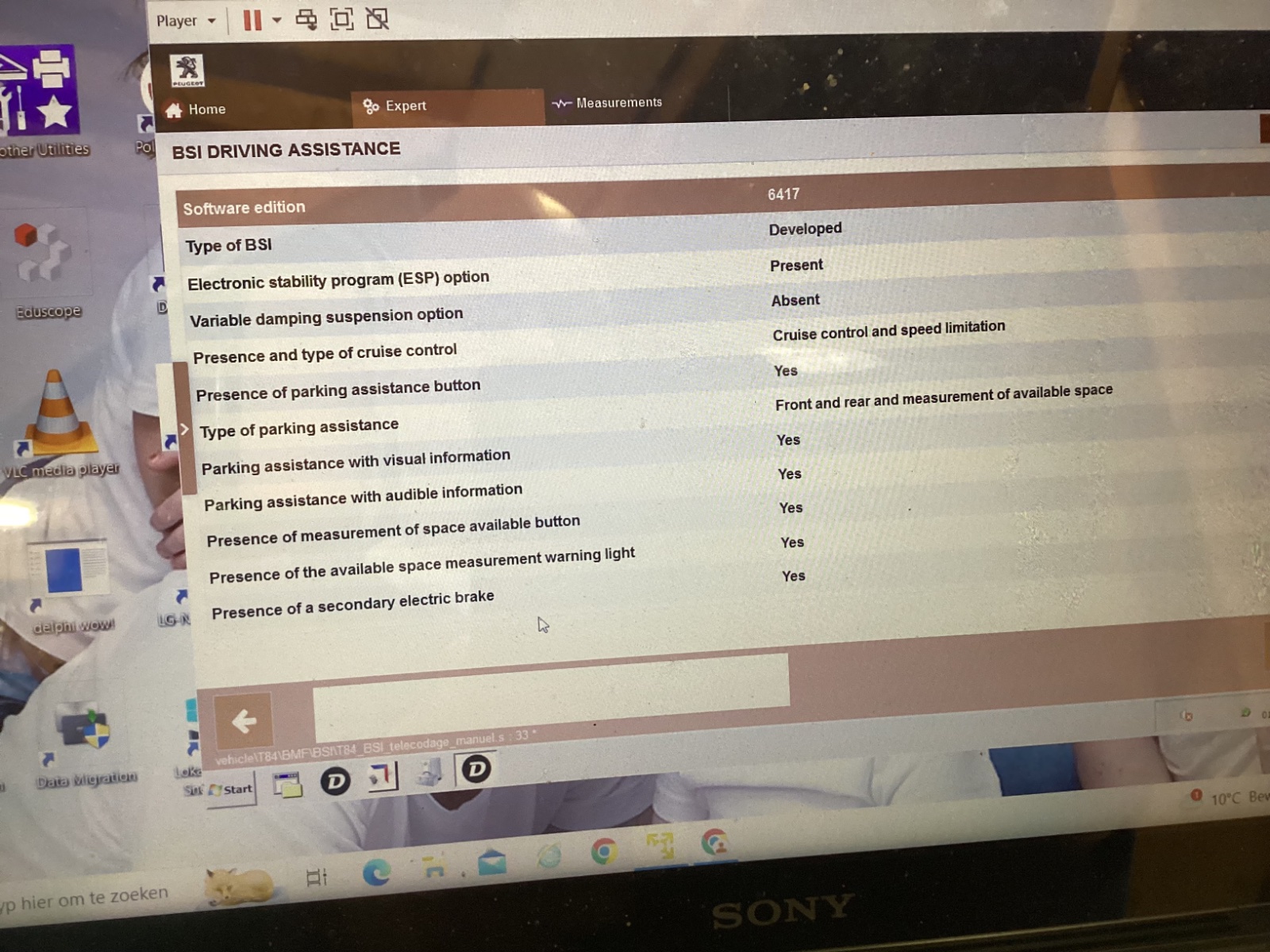

Re: Diagbox question

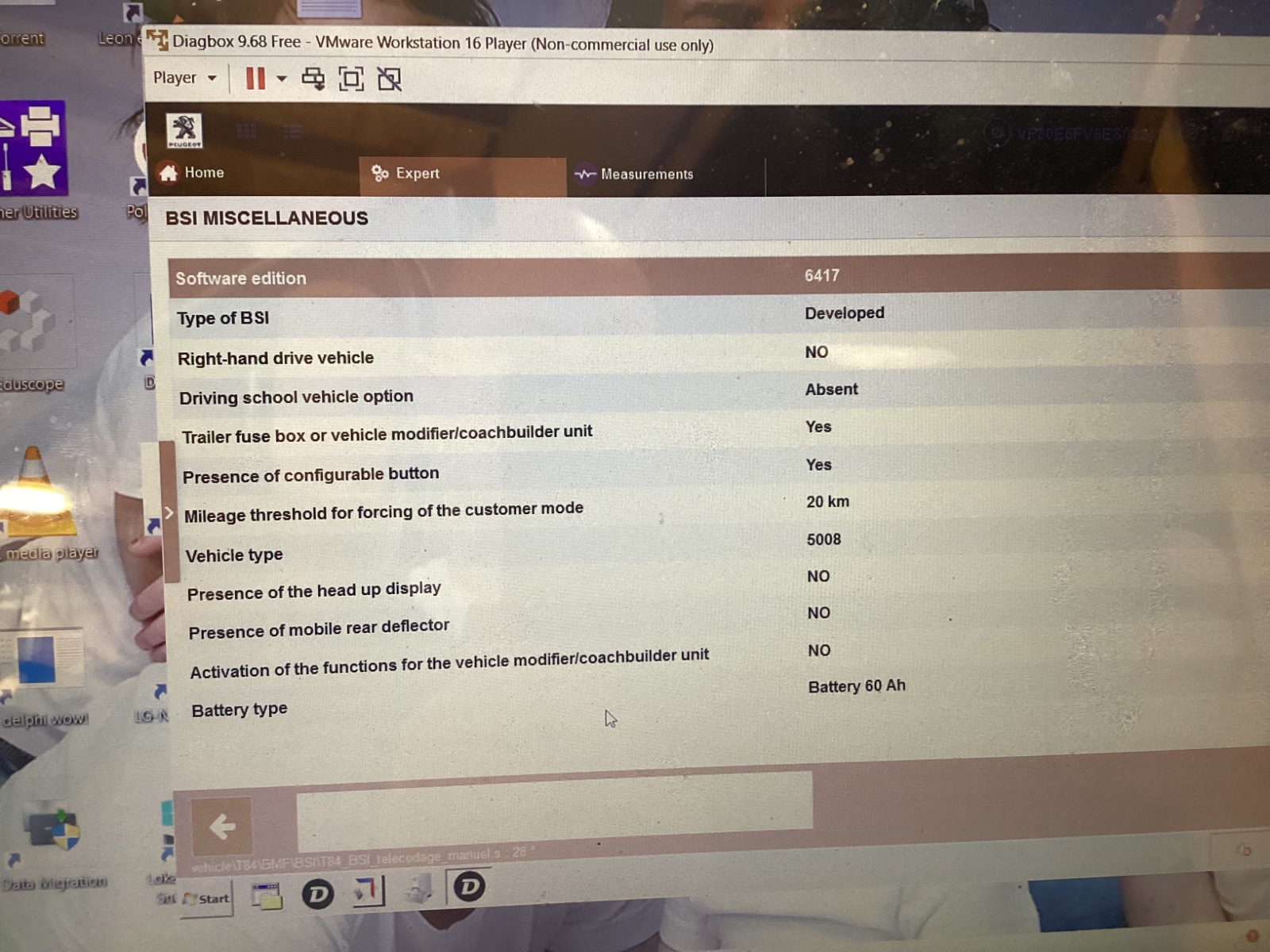

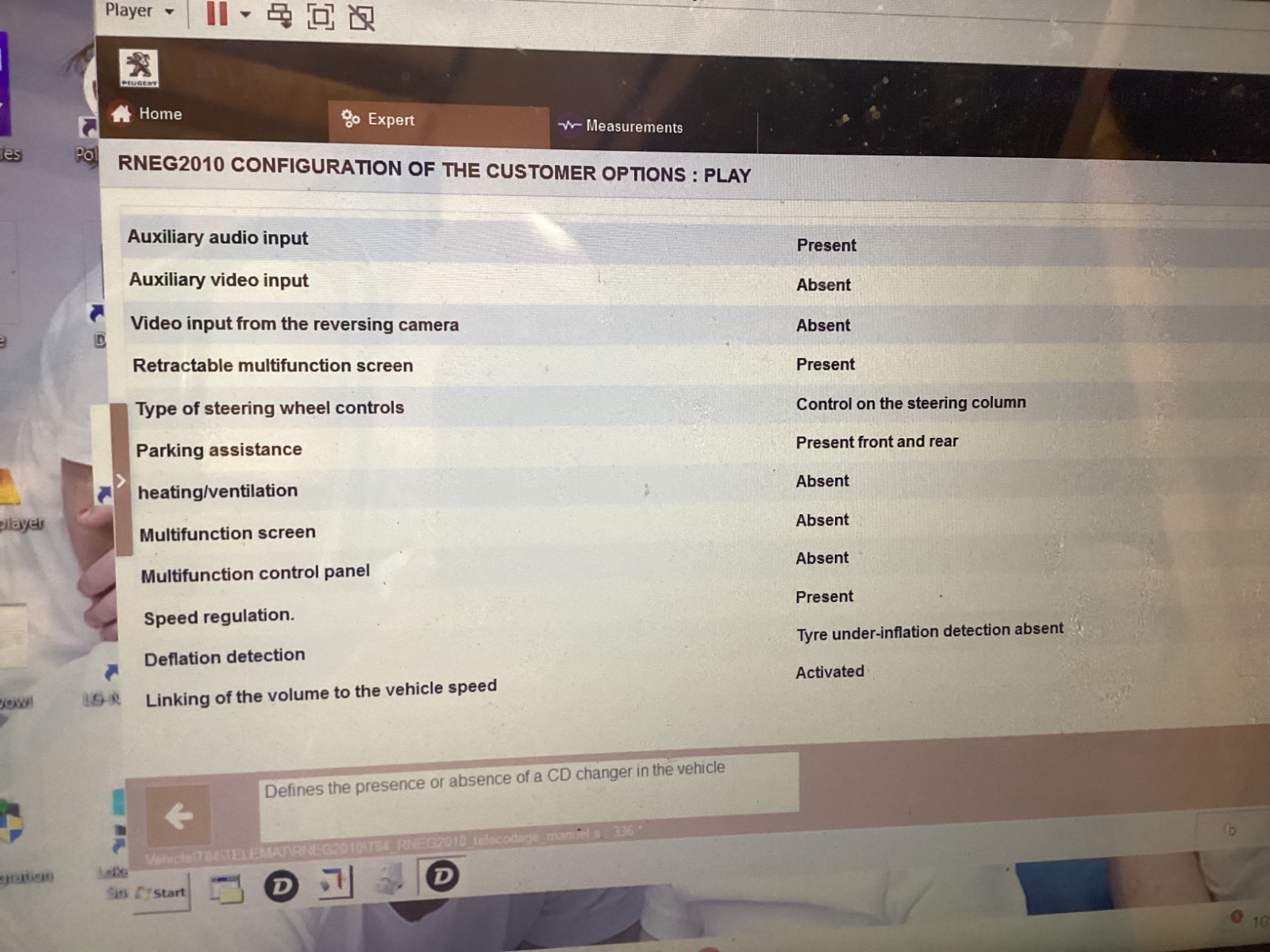

I have all the parameters in a excel sheet, if you tell me how to send those files, maybe is it easier to correct the settings
Very much, thank you in advance!

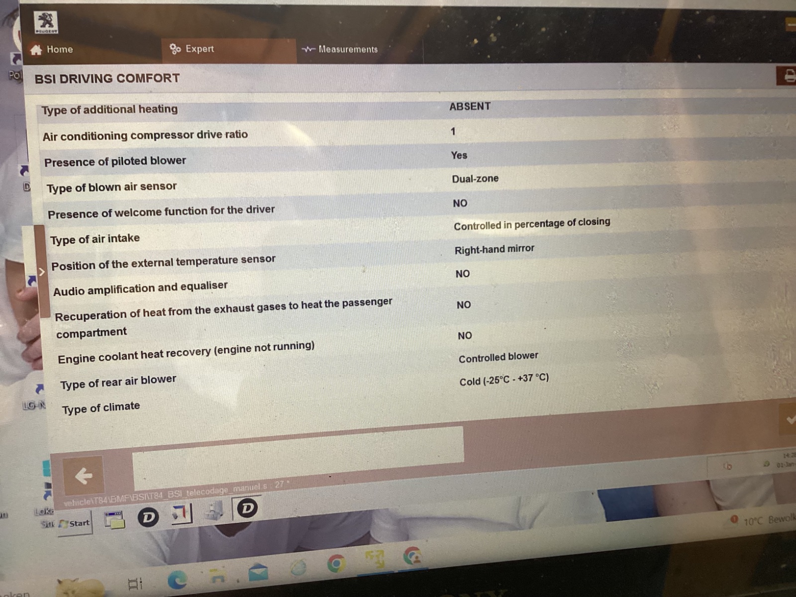

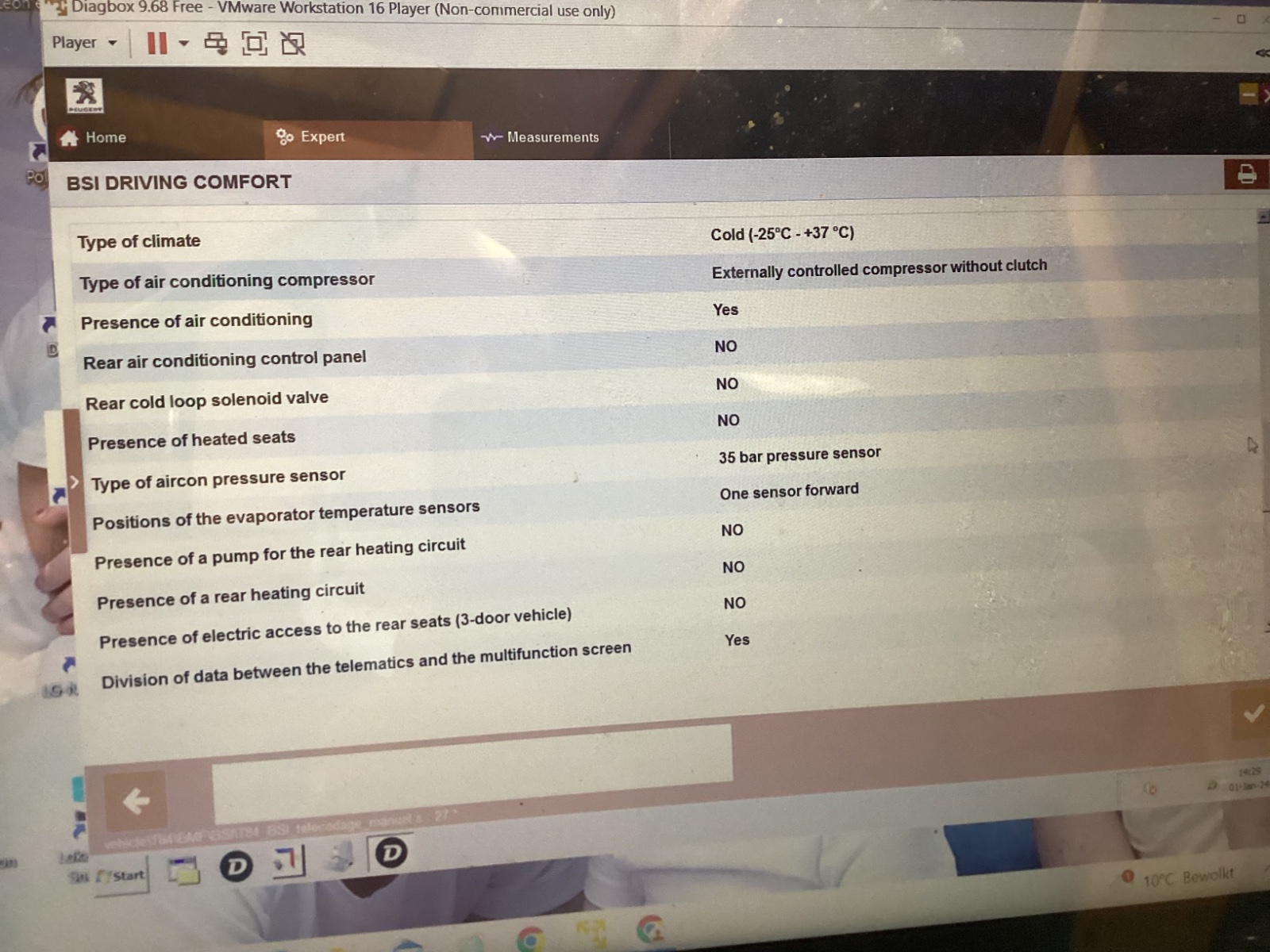

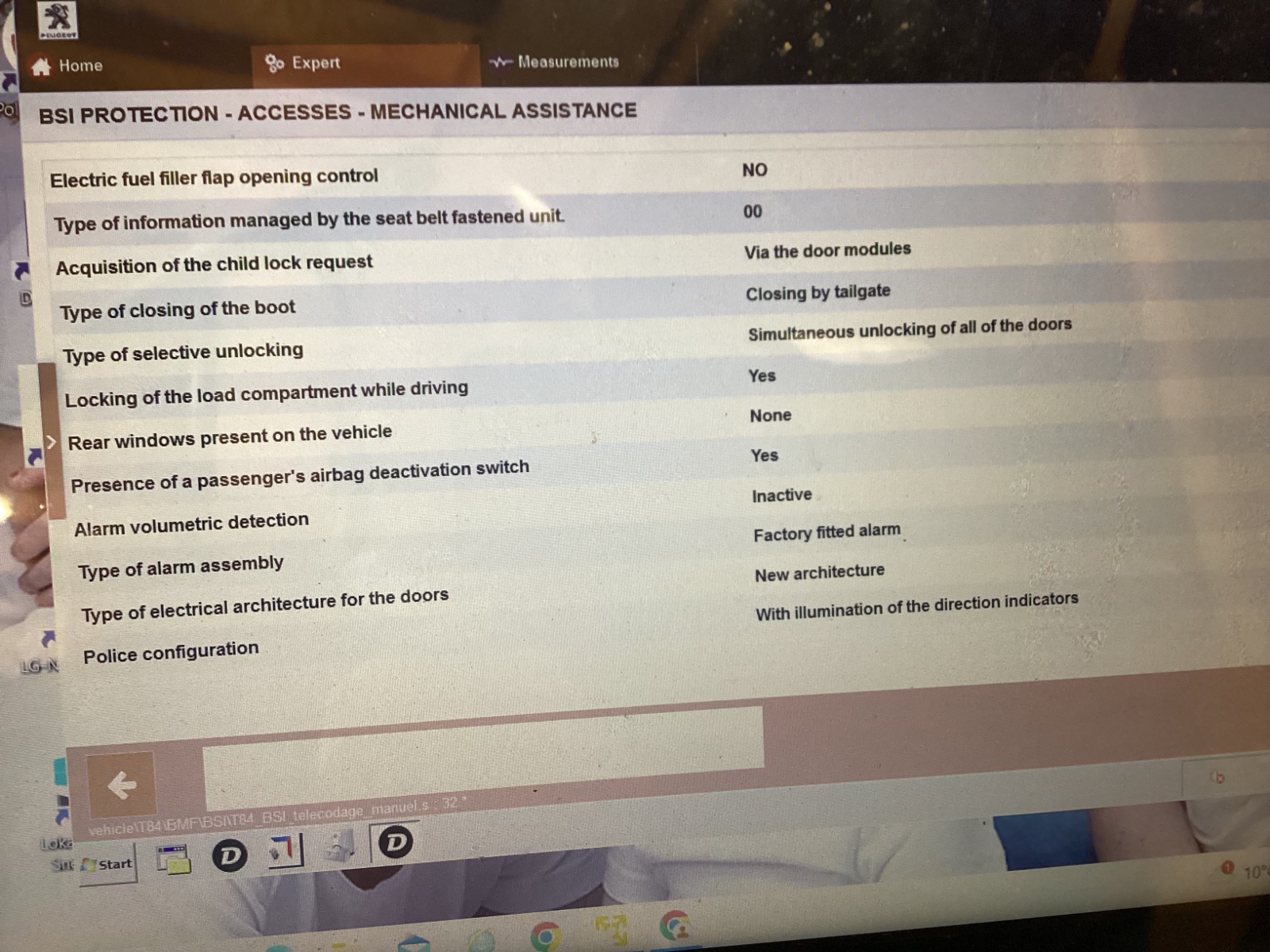

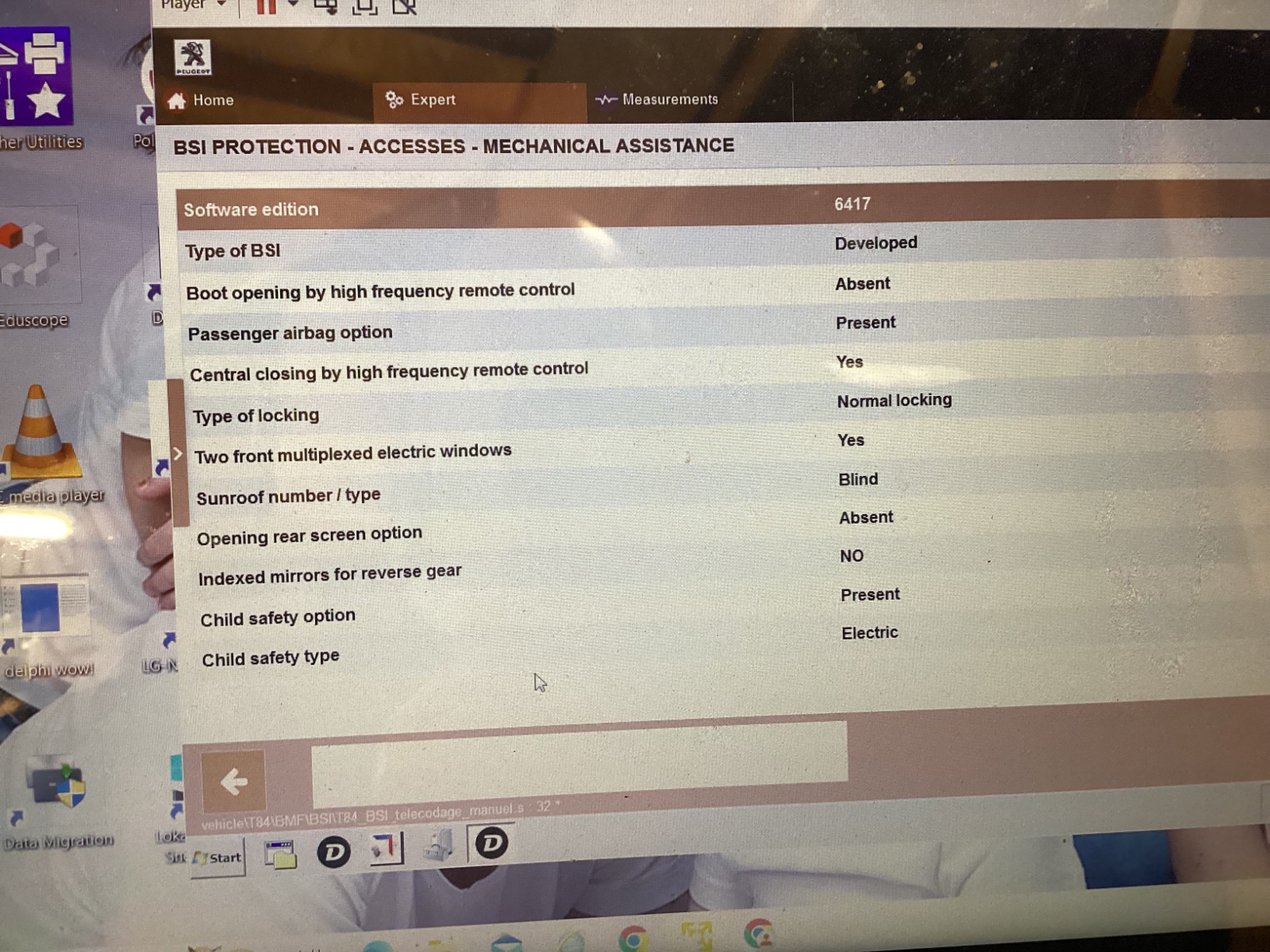

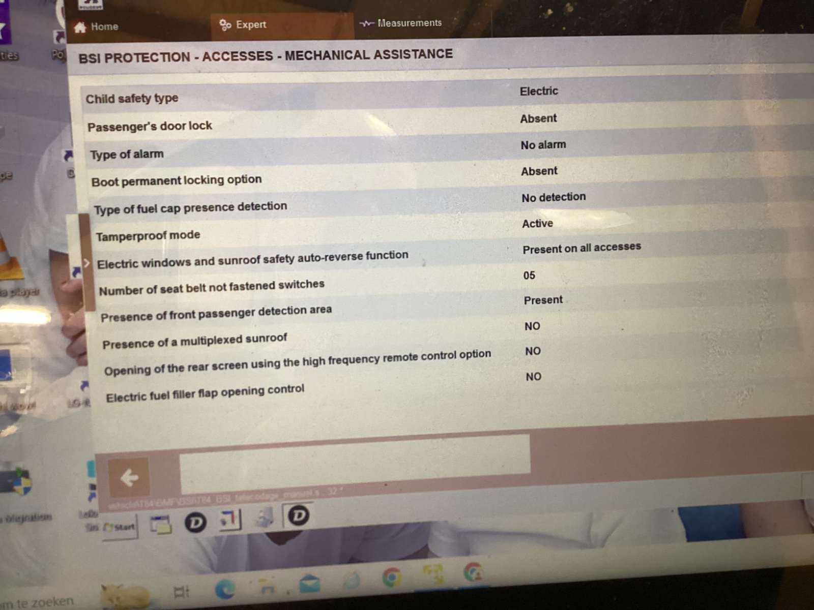

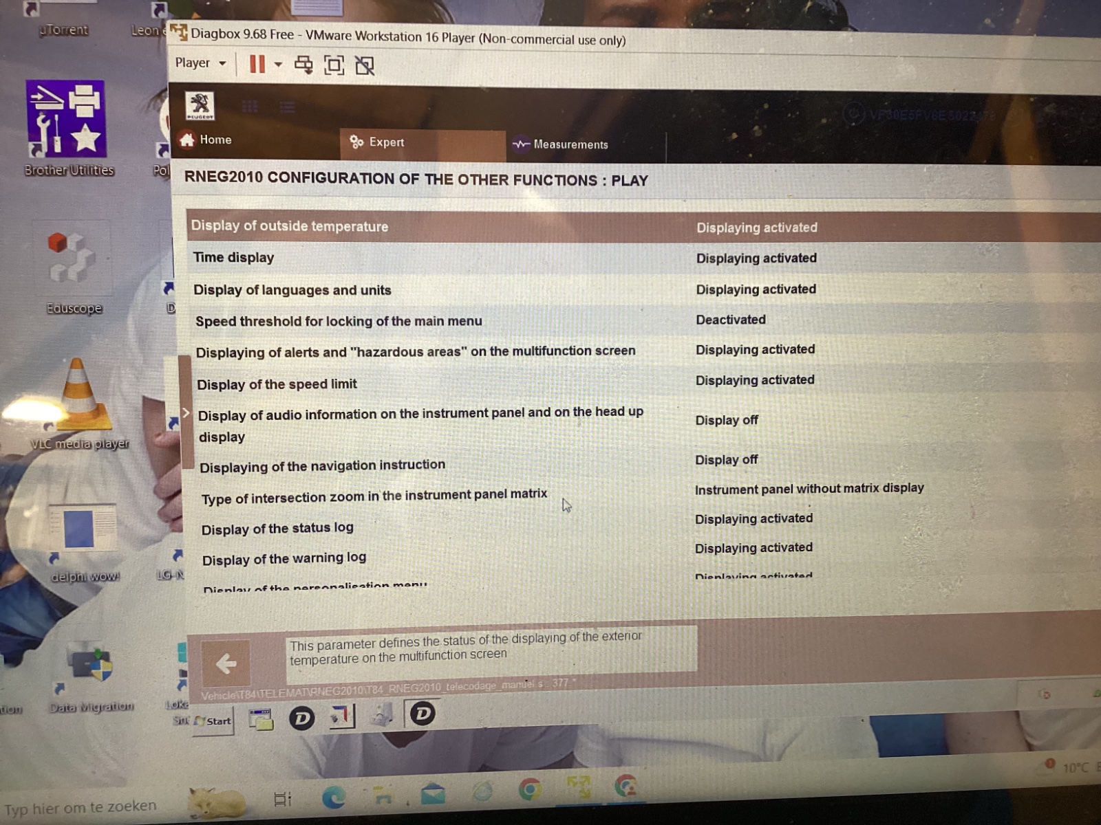

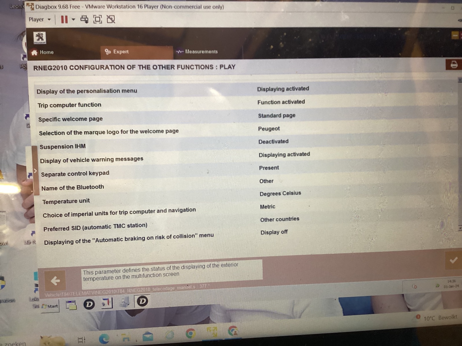

This is going to take some time, so leave it with me and I'll look at it when I can to see what is not right.
- x 6956

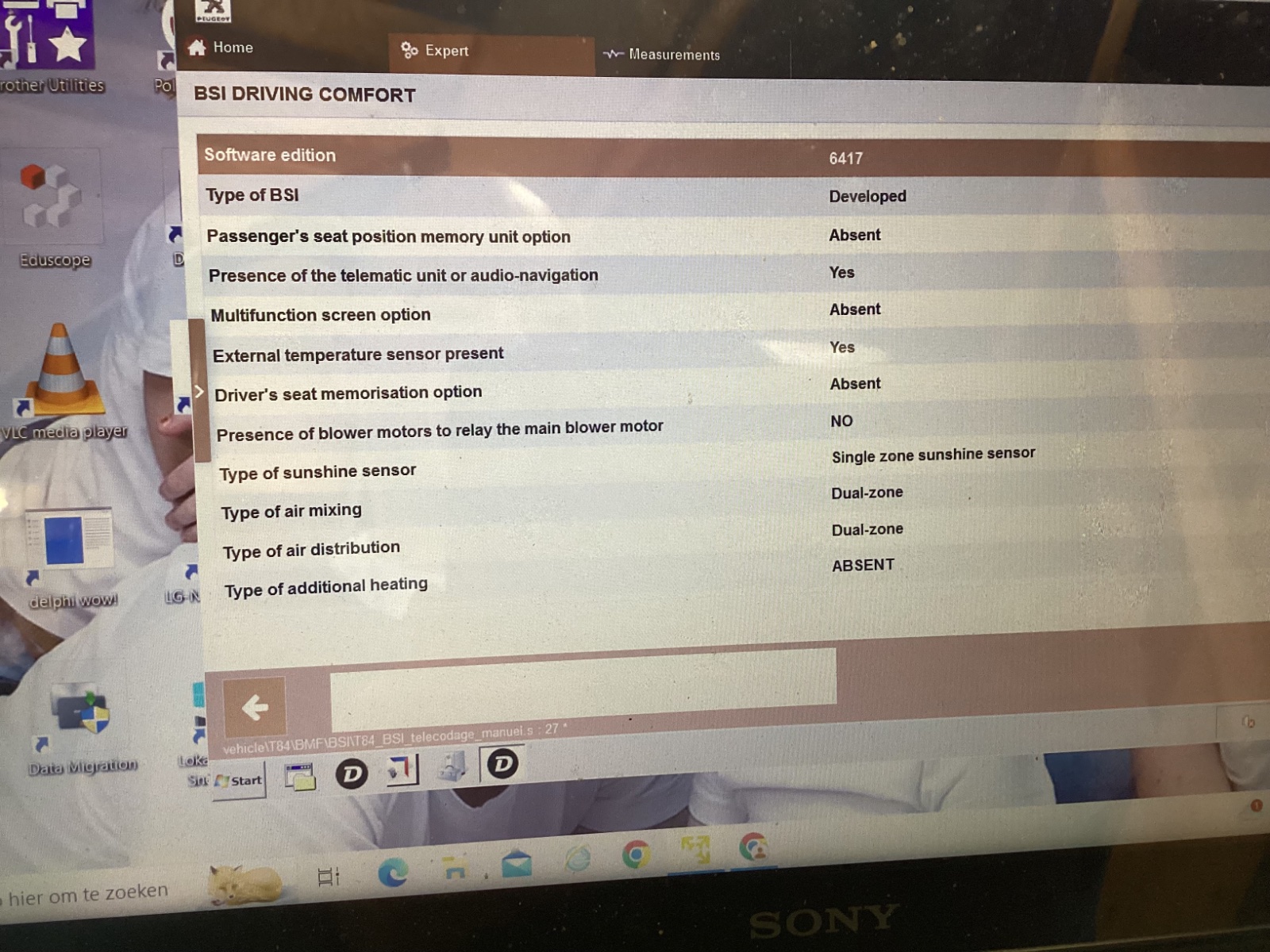

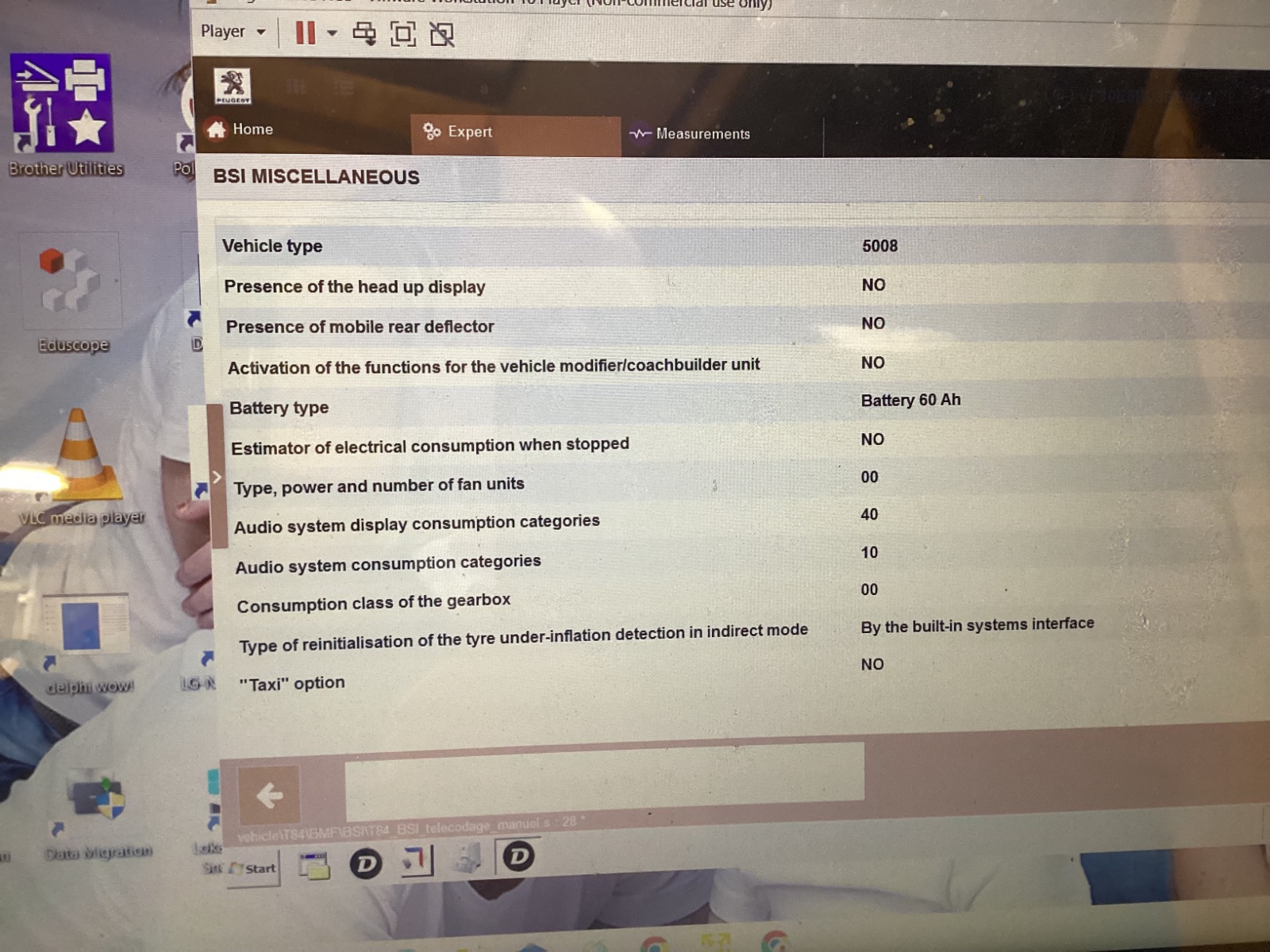

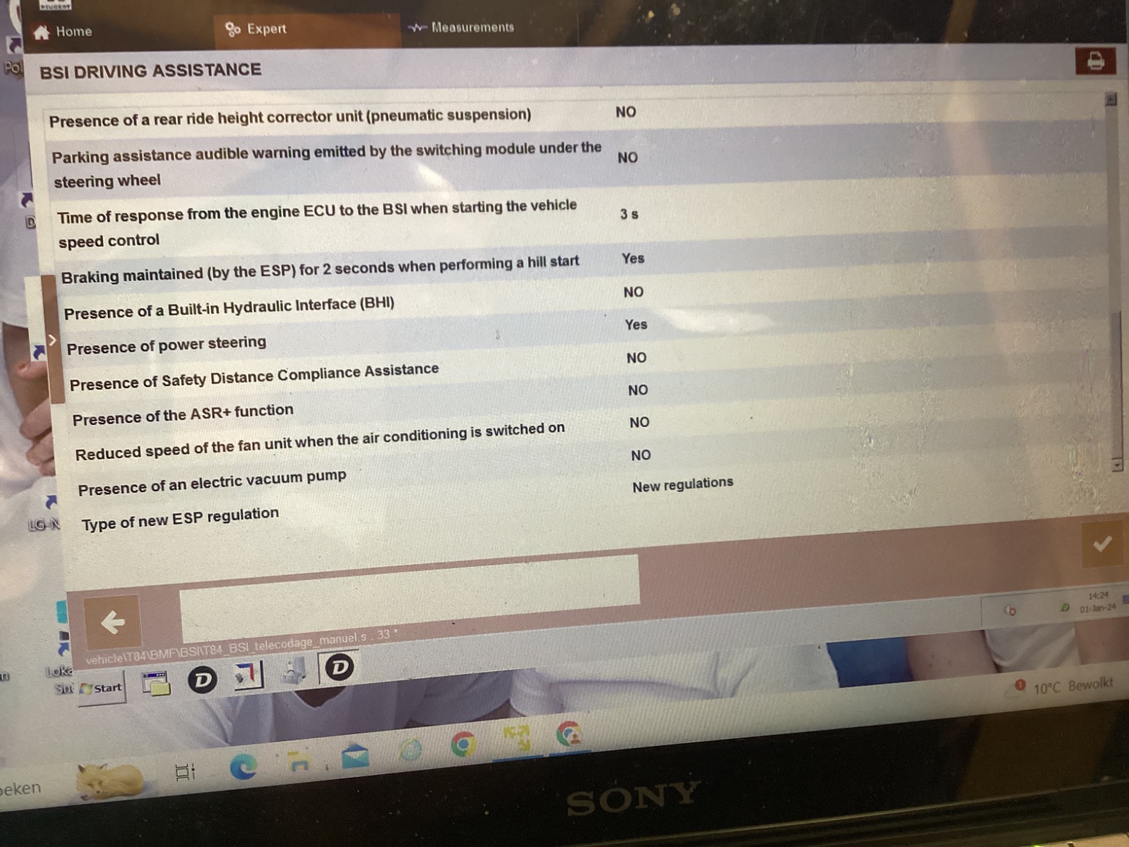

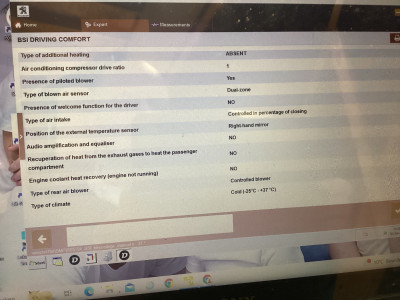

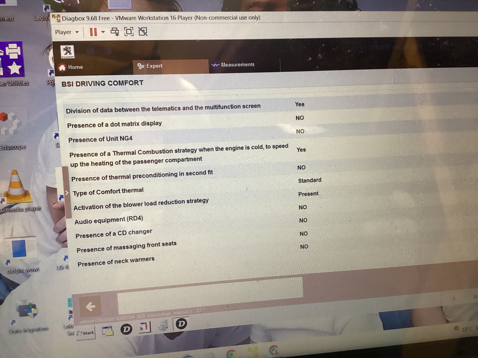

Ok, the following are all incorrect and need changing to the values I specify:
BSI ECUs Present
Navigation I can't determine this, so if you have the following:
Vehicle having an instrument panel displaying a maximum speed of 230 km/h or 150 M/h on a white background and with a large display matrix Leave it as present, otherwise change to absent.
Power Unit
Oil temperature sensor option Change to Absent
Supplies Protection & Management Unit (BGPA) This should be YES
Authorisation of a surge of power at the terminals of the fuel supply pump ( reservoir) This must be YES.
Lighting
Presence of a right reversing lamp: Should be set to NO
Presence of parking lights: Set to NO
Driver Information:
Presence of a red LED for Power Steering warning: Must be set to YES
Display of the rear seat belt reminder warning when a rear door is opened or when the ignition is switched on: Must change this to NO
Use of the vehicle movement information to detect fuel filling operations: Change to YES
BSI Driving Assistance

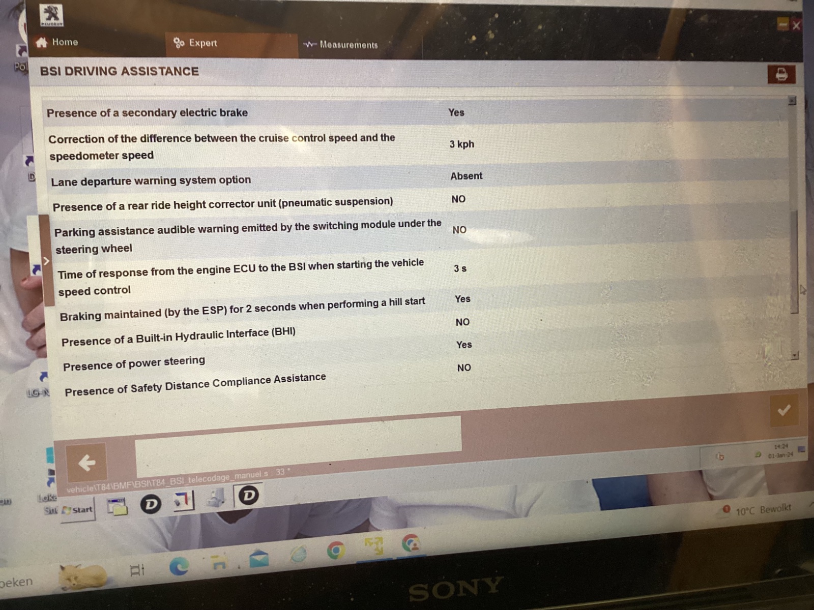

Time of response from the engine ECU to the BSI when starting the vehicle speed control: Change to 00,6 seconds.

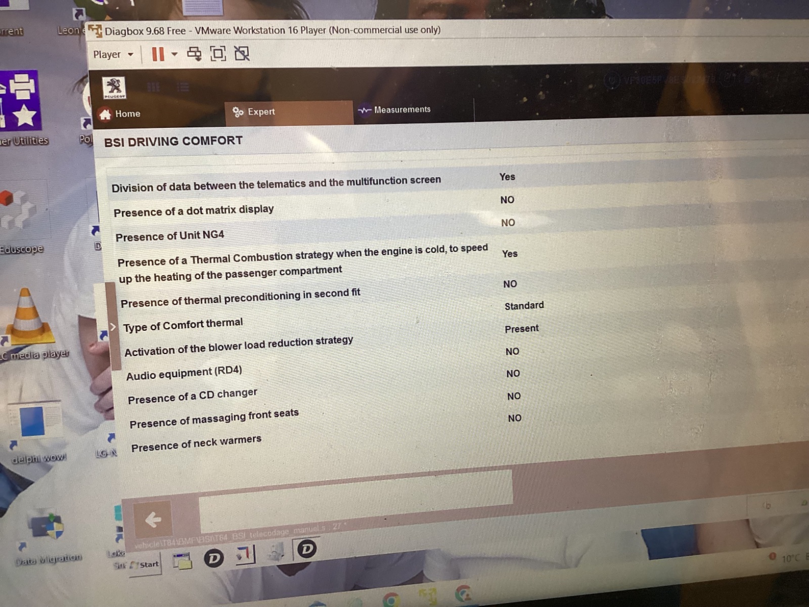

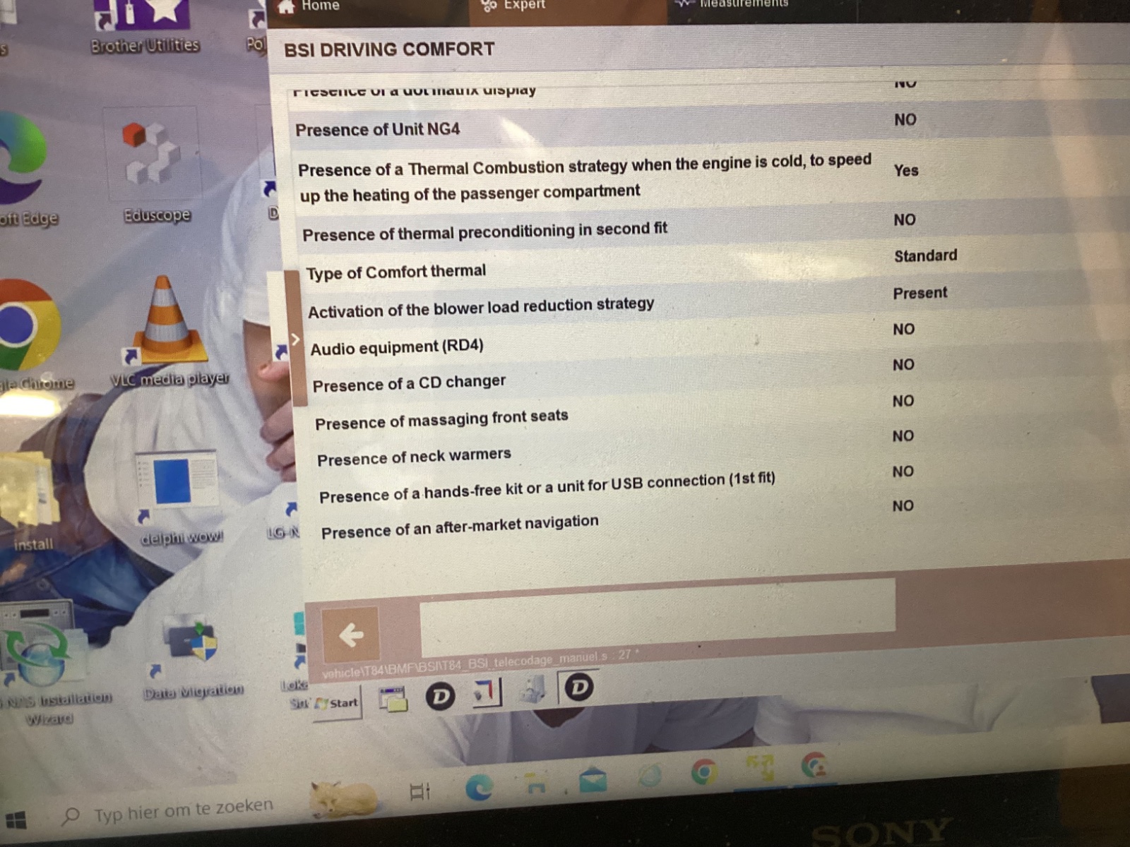

BSI Driving Comfort
Activation of the blower load reduction strategy: Change to ABSENT
Miscellaneous
Presence of configurable button: Change to NO
Presence of an estimation of the electrical consumption when stationary: Change to YES
Type of climate: Change to 'Temperate (-17°C to +37°C)', which includes Netherlands.
Sharing of data between the telematic unit and the multifunction screen: Change to NO
BSI Driving Comfort

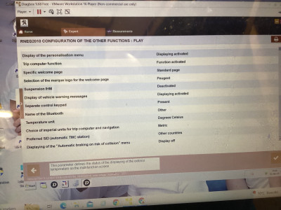

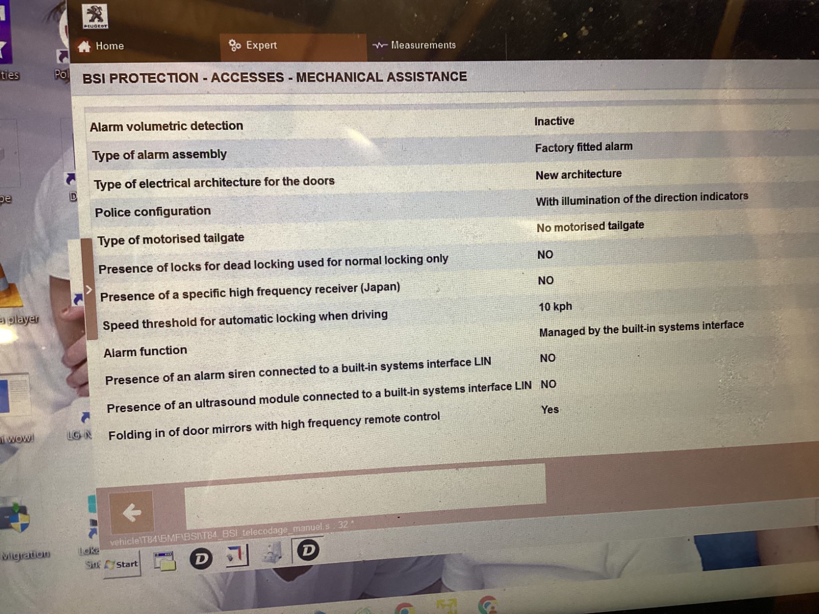

Leike
- Posts: 22
- Joined: 16 Oct 2023, 20:50
It is incredible!
I changed the settings like you suggested marc, and with screenshots from Phil.
No warning lights on, the red licht from the parkingbrake has come on, daylight lights working again, cornerlightning is ok, etcetera
I am so thankful too you both, for helping me out.

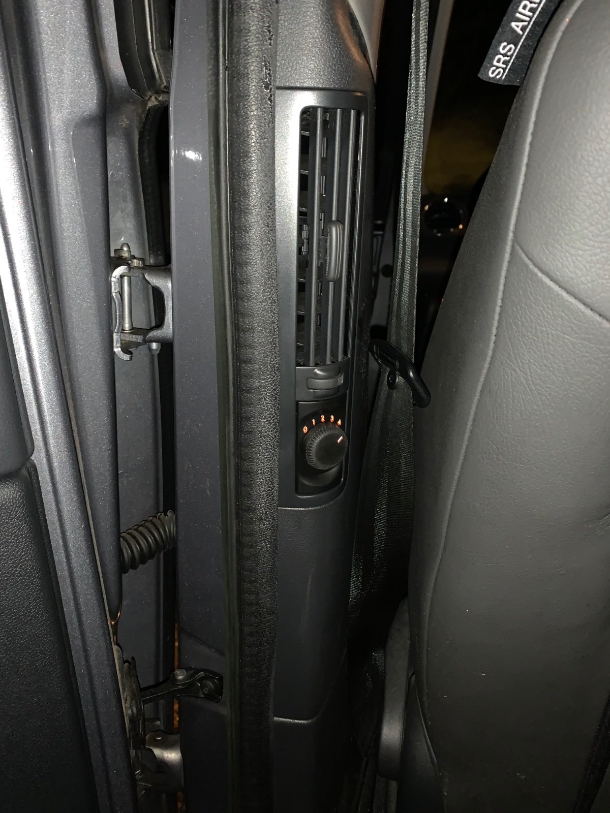

There are just 2 things I wonder.
My oil level blinks with 2 stripes in the display. Maybe I have to wait several starts?
I already changed the level sensor, and there is enough oil in.

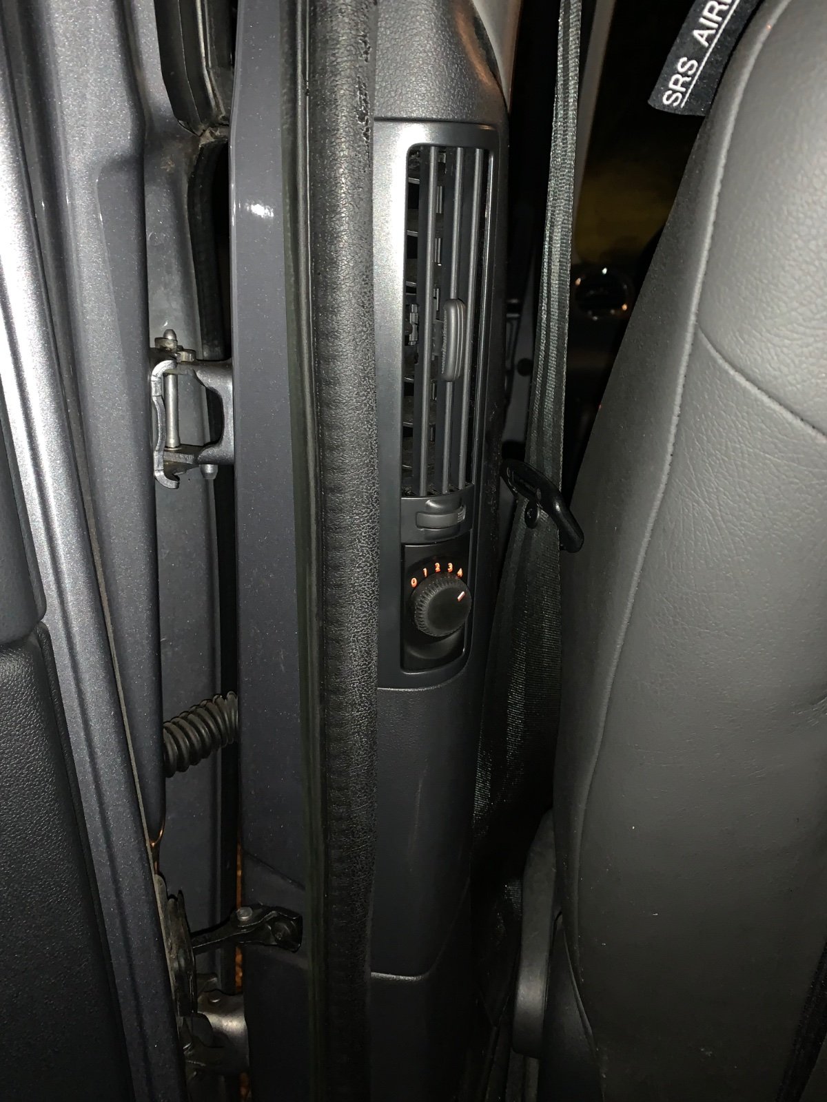

And the ventilation blower on the second row of seats, does not work. In the climate control, the rear ventilation is on.
Is this also a setting?
I'll take a look Sunday and check the Climate settings for you.
