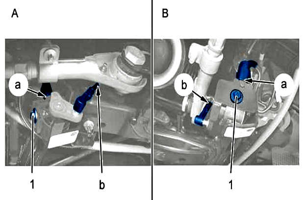

can anyone point me in the direction of the headlight height rear body sensors, not neccessarily the sensor but the rod or Arm with sockets either end as I have one with a small split DS5 Hybrid4 2012
- x 6950
Re: DS5 2013 headlight woes
There are 2 rear height correctors on the Hybrid Traction models. The rear nearside one is attached to the suspension cross member (the one in line / slightly forward of the wheel. The other rear sensor is on the axle.
A: On the left-hand side.
B: On the right-hand side.
