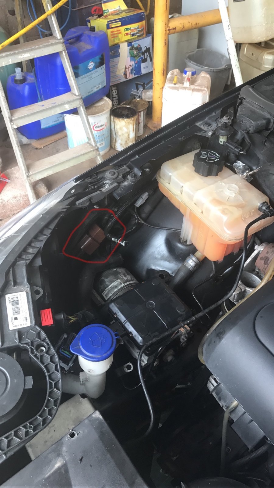

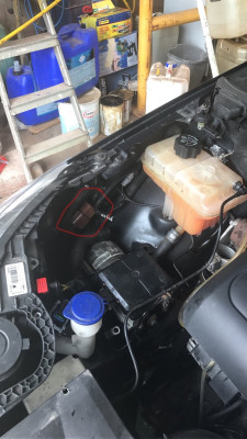

Thanks Marc once again,
I believe I have found the position of all the components but access is restricted. I don't know why the F01 within BPCB has blown, but in order to access these and test the relay which I believe sits on the inner wing covered by the LDS tank, this is also where the earth MC21 is located.
Genuine PSA fuse found and arriving later this week. Hydraulic strut to be ordered.
Will keep updating with info.
Kenny
Thanks to EDC5 for the use of his photo as I believe this is the relay circled in red.
Kenny

The relay for the Hydraulic pump no is 6545N3.
Kenny
Kenny
C3 1.4 petrol (SWMBO)
- x 6947
Re: Burst suspension pipe at rear
Thanks for that Kenny - they don't list that relay on the suspension parts at all - but it is listed as one of the 50 Amp relays for the engine fan assembly! So useful to know it is the same one as these.
