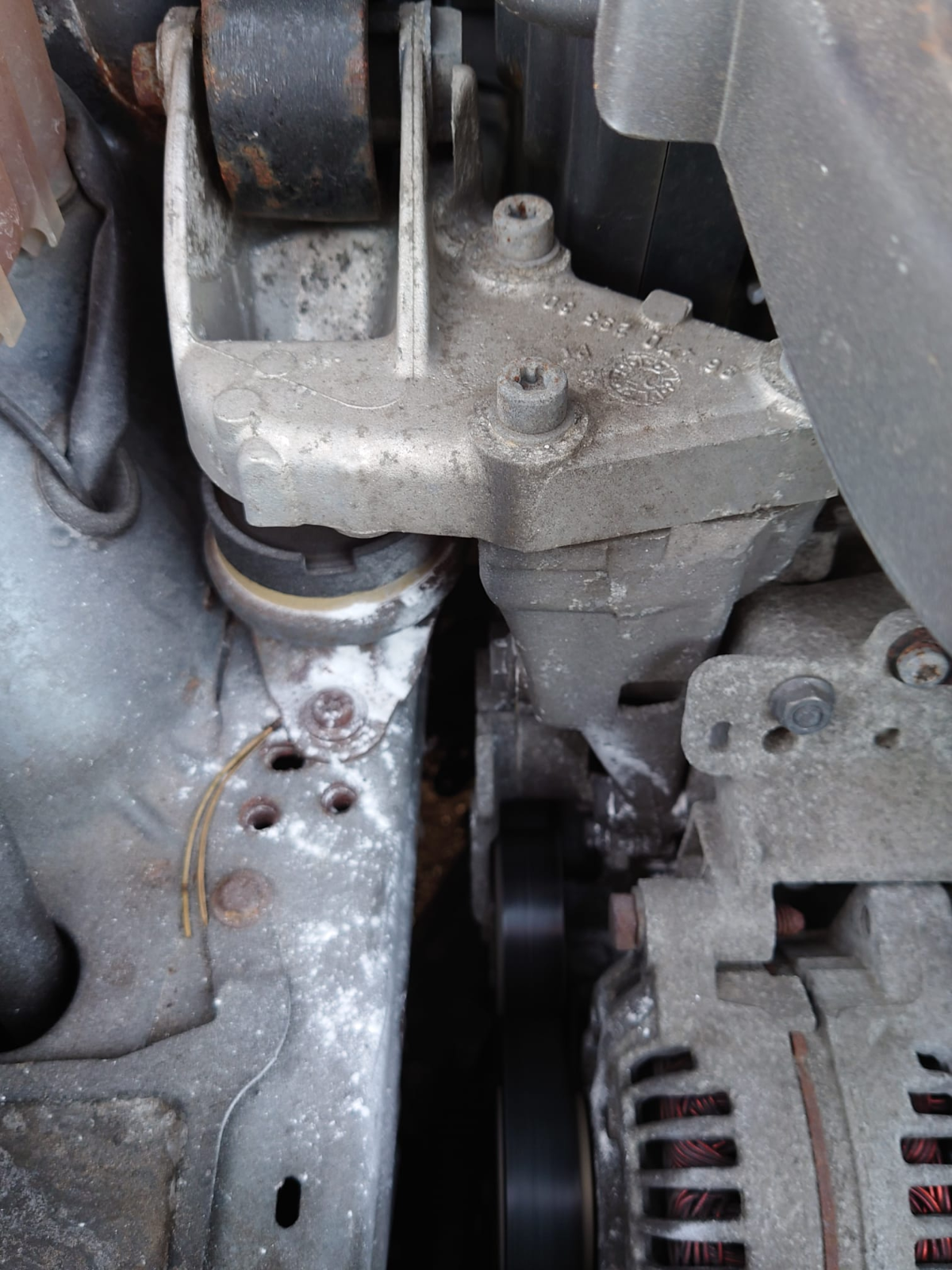

Car was running fine till the other night. very cold and car was sluggish to pull away. Next morning same issue. no EML lit yet.
However.......
Though I heard a noise under the bonnet on start up after work on Saturday.
Opened the bonnet and found white powder (very fine talc like) around the cam belt side of the engine.
Im assuming this is indicative of something on its death throes in the cam belt set up and rubbing/disintegrating?
Garage suggested 'supermarket ' fuel as the issue. cleared codes and ran an additive
Wasnt fully convinced but car ran and got it through MOT (with £400 in work
Held of replying here to see how it ran. Been using non supermarket fuel and every 2nd fuel using the posh V power type fuel
However.......

- x 6960
Re: 2009 C5. New owner,some issues
Check the accessory belt hasn't started to fray
Dont know if that image link is working. Belt I could see didn't look frayed and the powder seems to be coming from the upper area of the head.
Its super fine which made me think of a tensioner type plastic wearing down. The noise I heard on Saturday was a rotational thump from the cam belt cover area but it went away.
My shot knees are horrendous right now so no chance of me doing work on the car.
With Christmas near Im trying to keep going at work as it is.
Think ill take the hit and put it in the garage tomorrow for a check. The water pump (i assume) can be a bit noisy/shooshy at times
Eg at a drive through the acoustics can make it noticeable.
- x 6960
Ok, so that white powder looks like harmless surface oxidation of the aluminium (aluminium oxide), so nothing to worry about.
The best thing you can do is to have a vehicle diagnostic done with Diagbox and see if there are any stored or recurring fault codes. I don't think that has anything to do with poor performance of the vehicle. If it was the head gasket you should get some prior indication of over heating and would see staining around the head.
If you get any fault codes pop them up here along with the VIN of the C5.
Incidentally, you can use the full post editor and attach your images directly on the Forum (preferable) so nobody has to go to a third part site to see them and can maintain focus within the post. I'll convert your image now to make it easier.
