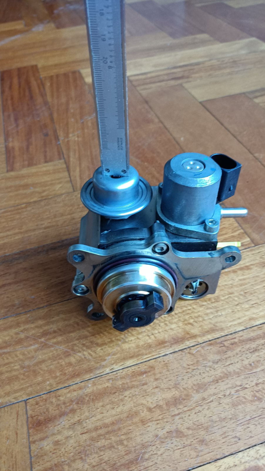

xantia_v6 wrote: 16 Jan 2021, 08:03
There is however another twist to this. The pressure accumulator for the lubrication oil has an external hole which allows the position of the diaphragm to be measured, giving an indication of whether the oil chamber has been breached. I have measured this on my faulty pump, and the measurement is 18 mm, which is apparently exactly where it should be. This seems to be a strange coincidence.
How do you measure the diaphragm? I have removed the pump from my DS3 Racing in anticipation of the new pump.
Edit: Mine's at 23mm.. probably a good thing I'm replacing it.

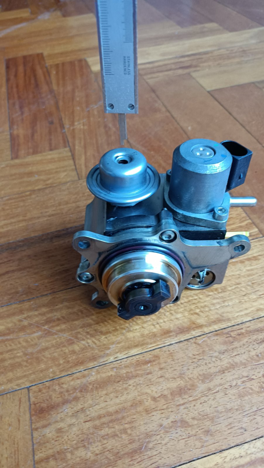

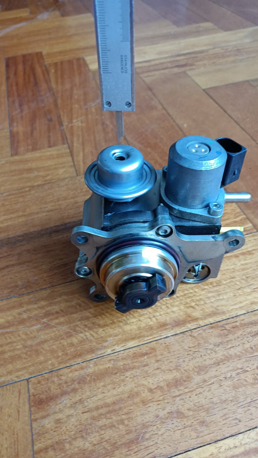

I assume that you have worked it out, but here are some pictures anyway...
notrix
Posts: 22
Joined: 25 Jul 2019, 09:41
Re: Petrol fumes from THP engine
Unread post by notrix »
Yeah, that's what i figured :)
Where did you find the spec for it? Do you have any URL's?

Unread post by xantia_v6 »
I saw a youtube video where a new pump was measured, but I don't have a link. I did not know about this until after I had installed my new pump, so did not measure that. I believe that my old pump is OK, and it now measures 19mm, I think the difference from last time I measured it is probably due to the temperature of the oil (it is only about 3° in my garage this morning).
