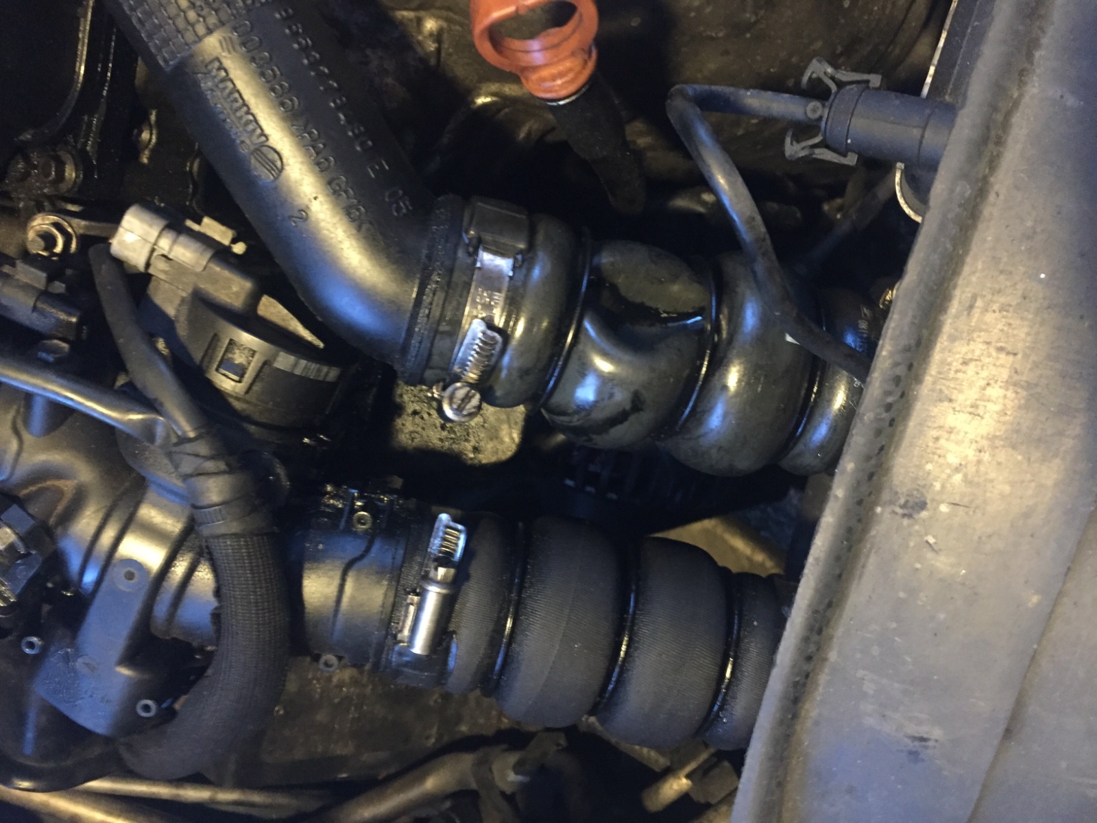

Just noticed that this pipe is sucked in , should it be like that or does that indicate something is amiss ?
x 6945
Re: EGR valve v new turbo
That's your distribution chamber side air union hose, part number: 0382LW. (£69.78 form Citroen inc.). It does looked deformed somewhat....
Some parts here:
https://spareto.co.uk/oe/0382lw
x 1746
Why not try just whipping off that hose clip, and pushing the dent out?
Might have been given a push/clout. Unusual for intake hoses to collapse...

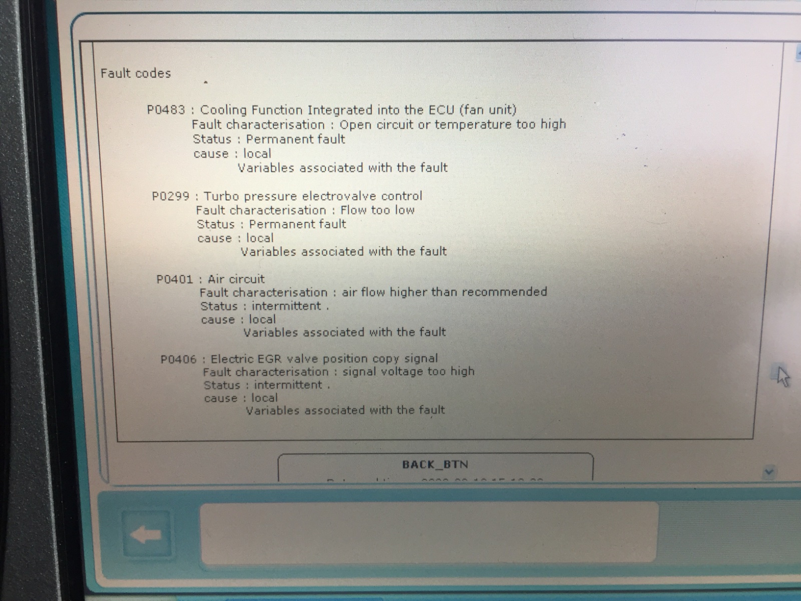

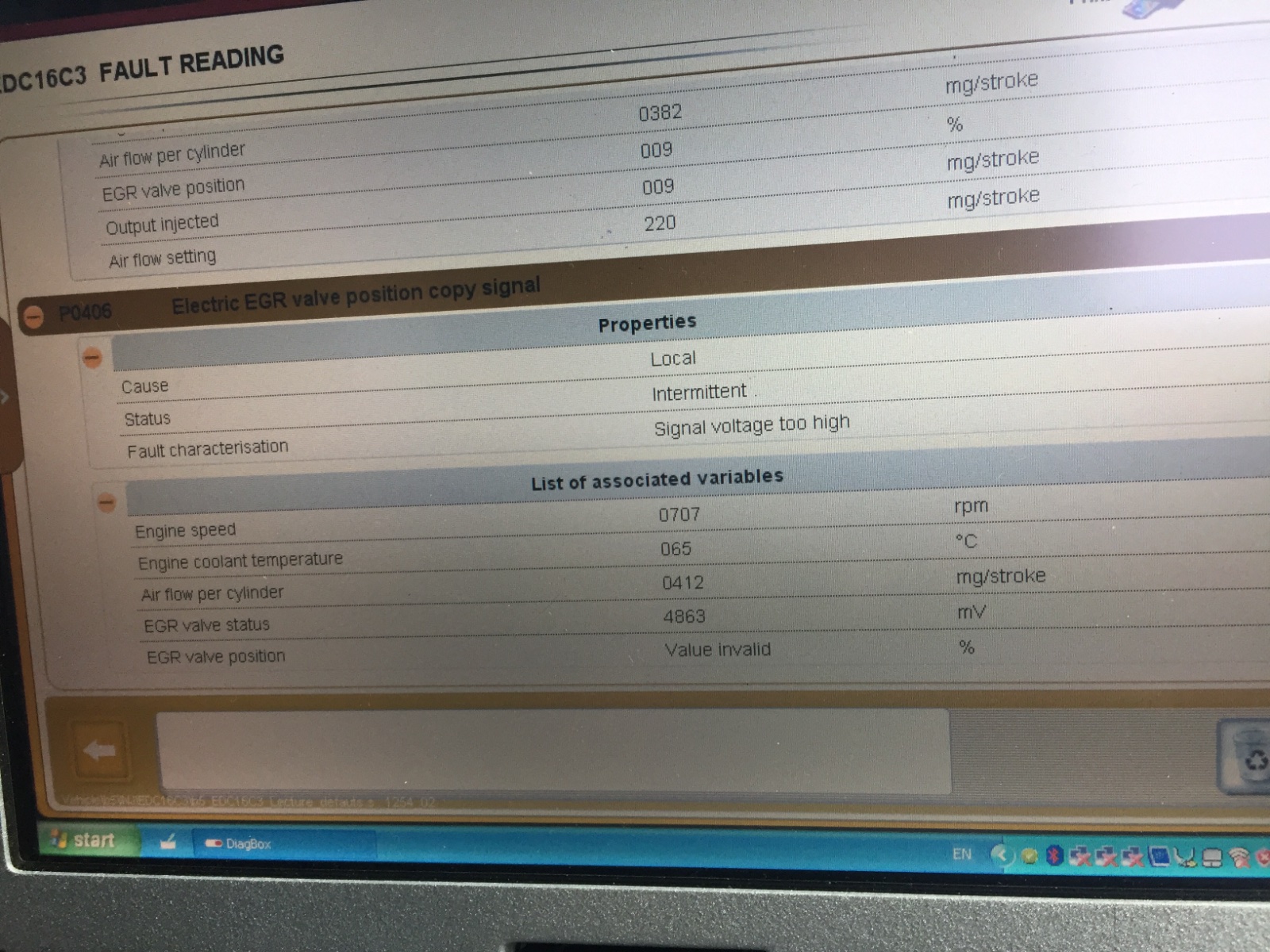

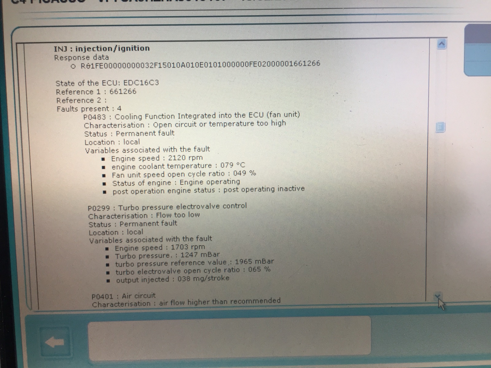

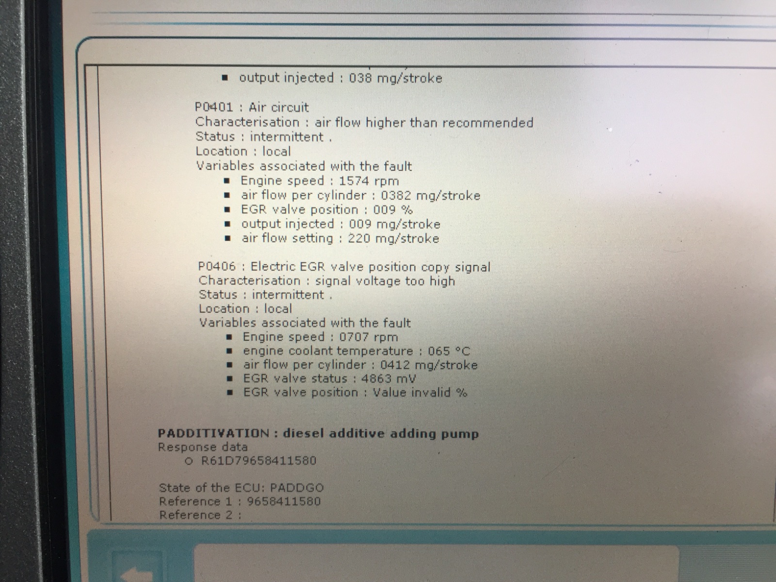

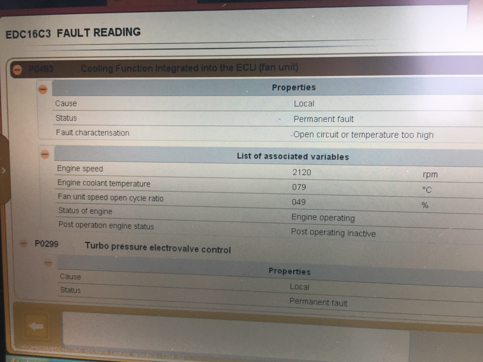

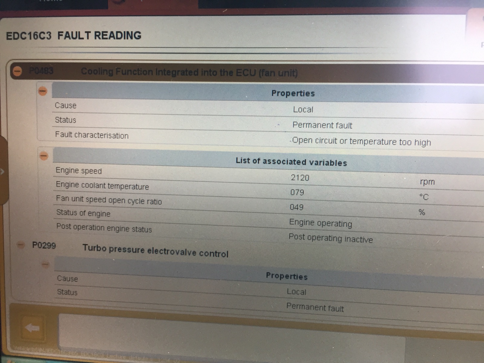

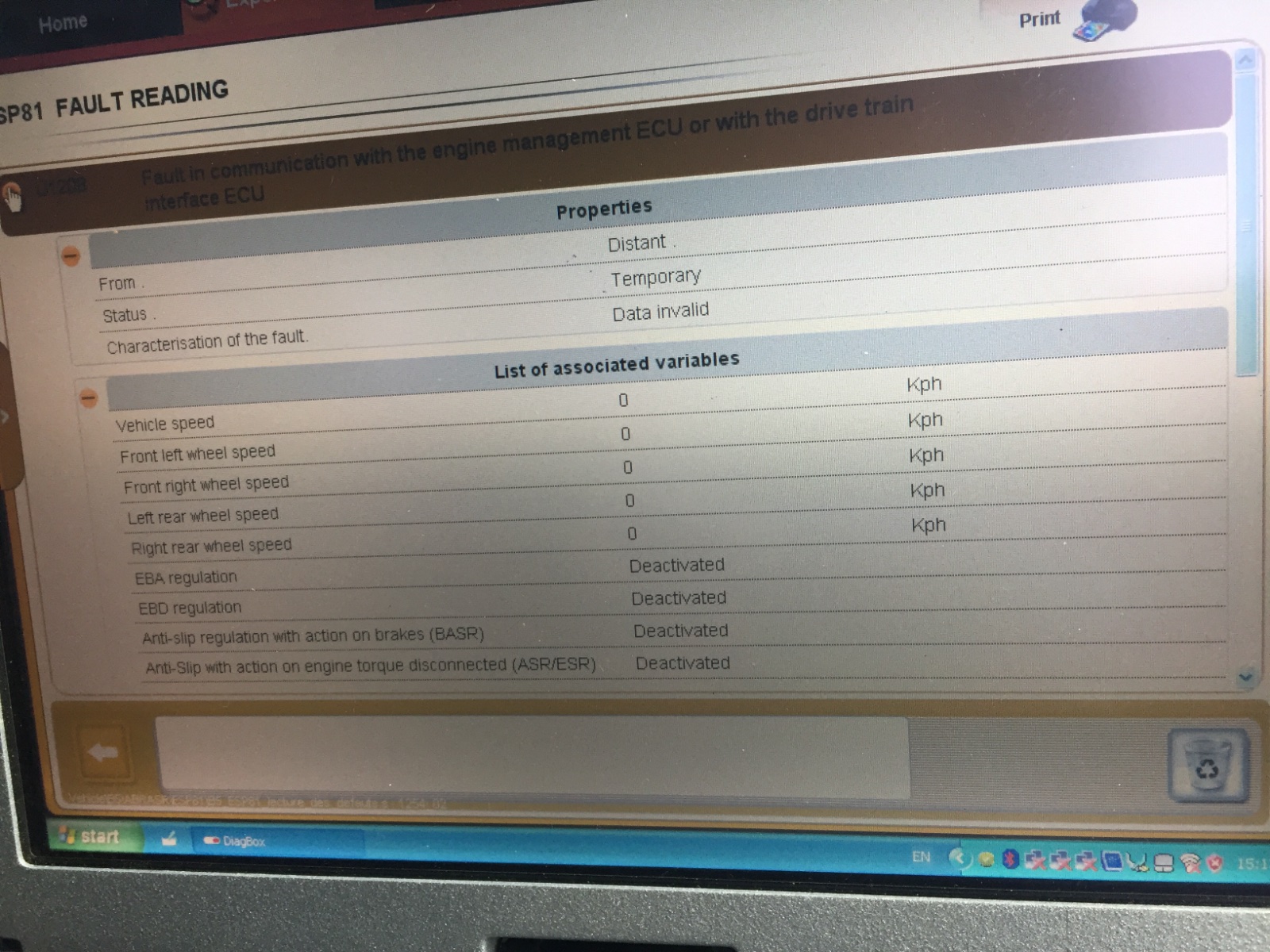

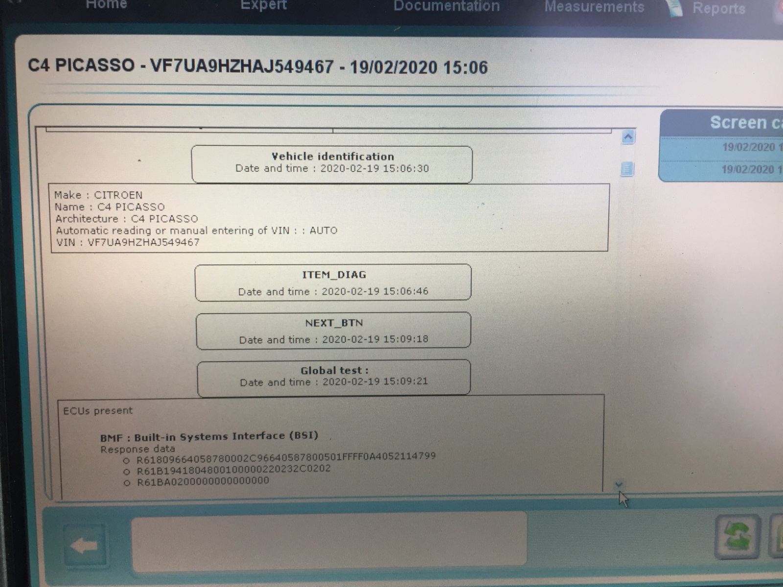

Anyone got any idea what all this means in terms of my EGR insufficient flow and turbo underboost problems please ?
