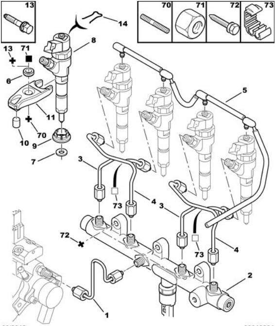

wheeler wrote: 04 Nov 2019, 13:04
As far as 2.0 HDi Xsaras go I believe only the Siemens system fuel rail pressure sensor comes complete with the rail (even though it can be unscrewed from it), On the Bosch system the sensor is a separately available part.
PSA only list the rail for this Bosch engine and no separate sensor.
I appreciate they can be bought separately on the aftermarket, but the point was the issues these can result in if separated.

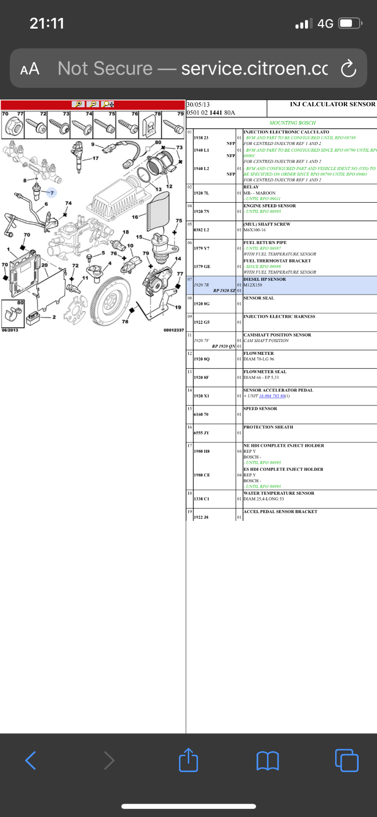

If you go to the sensors page on citroen service its listed separately part no 1920SZ but only for the Bosch system, the siemens system it comes complete with the rail.
