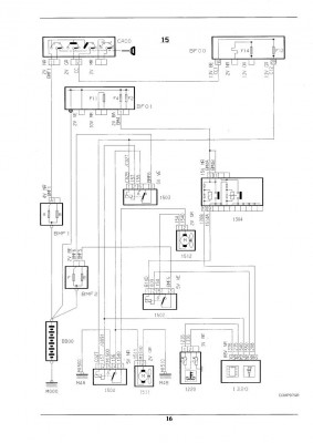

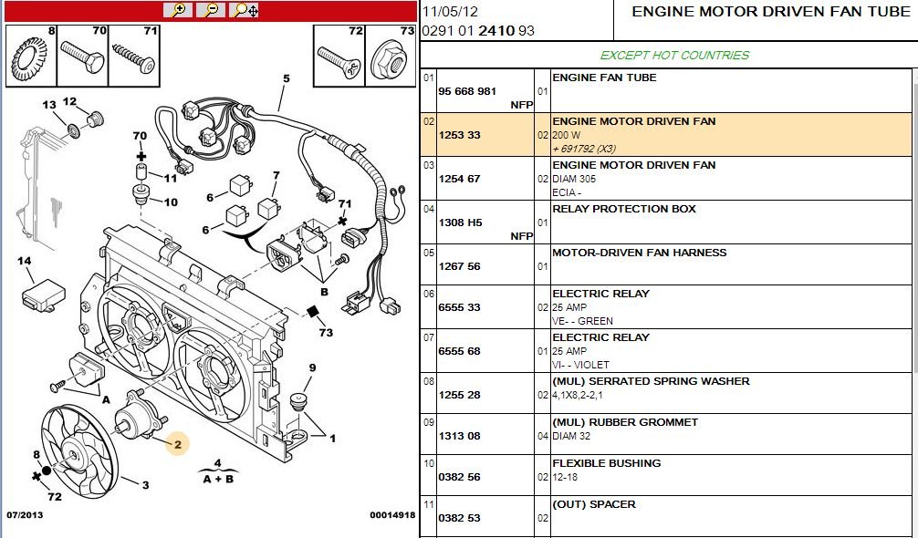

Hi Colin,
Parts diagram for your fans...
Motors are shown as 200W each.
The three relays (6, 6 & 7) also on the diagram.
[7 is the 5-pin changeover one; ok to have all three of this type, as already noted]

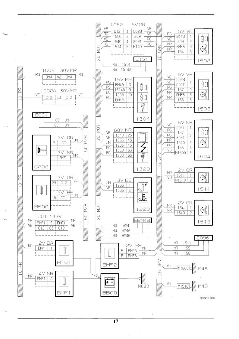

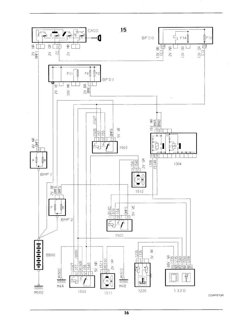

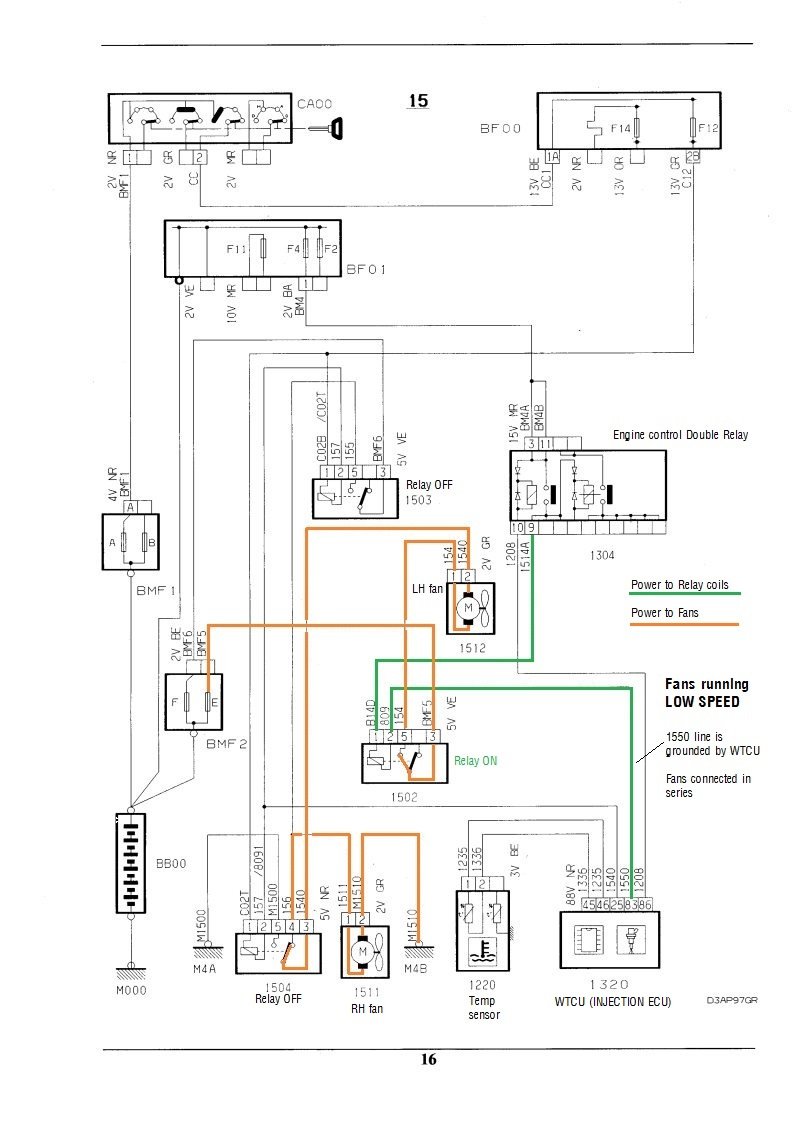

Have spent a little while looking in detail at that Xantia cooling fan circuit above, and it seems to contain something interesting.
Traditionally, twin fans, with their associated three relays, have received one of two +12v (or Gnd) commands to operate the fans:
- Go Slow . . . fans in series
- Go Fast . . . fans in parallel
This was done by a +12v (or Gnd) signal from either a thermo-switch (early cars) or a Water Temperature Control Unit (WTCU) (later cars). In both cases, only one control line operated (+12v or Gnd) at a time.
The Xantia circuit above, it seems, is subtly different.
Twin fans, three relays and a WTCU still, but . . .
Slow speed is achieved by line 1550 on the WTCU (#1320) going to Gnd. This switches on relays #1503 and #1504, putting the fans in series.
Fast speed is achieved by both lines 1540 & 1550 going to Gnd together, putting the fans in parallel. So, two command lines in operation together.
Interestingly, if line 1540 were Gnd'd on its own, the LH fan (#1512) would remain Off, but the RH fan (#1511) would operate a Full speed. In practice, this might well never be an operational condition, but could, I suppose, occur as a fault.
We've been used to understanding that twin fans will always operate simultaneously and indentically, either Fast or Slow. This last (maybe oddball) condition throws up something else.
____________
I'll post some annotated versions of the above circuit in the next day or so, to illustrate current flow for the Slow and Fast conditions, and the Oddball one too.
Perhaps others might look at the circuit too, if in lockdown at home
____________

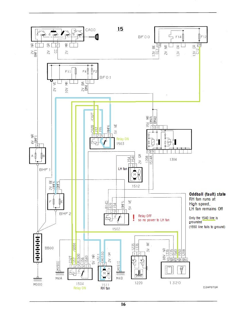

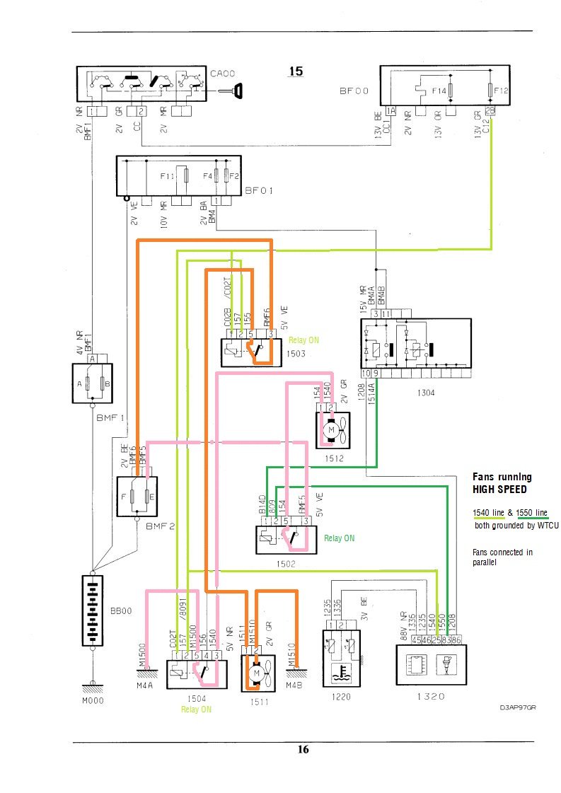

- x 1751
Re: Xantia A/C
This is the same circuit, annotated to show how the two fan speeds operate . . .
And, just out of interest, the oddball case where one of the control lines (1550) fails to go to Ground...

Having re read the wiring diagrams Chris has posted, particularly the OddBall one this may have got lost, although i think you both had an input into the thread at the time.
The link is back on page 3 of this thread just after they got merged, but i will copy and paste this from it as DickieG had both fans running at slow but only RH on full unless he pulled the Blue stat plug
"Post by DickieG » Sun Jul 04, 2010 5:28 pm
The mystery is now solved
thorter wrote:
Thanks for your reply, the way I've been testing the fans speed is by using an actuator test with my Lexia, if its confirmed that both fans on a HDi should run at high speed together I'm tempted to work around the "problem" by way of using a fourth relay
Perhaps the Lexia only sets or clears the discrete output for each relay separately. That would make sense for diagnostics. So the fans may well work in tandem in the real situation that the water temperature is over 107C or whatever.
Fred
You were right there Fred, well done
instead of using my Lexia to trigger the fans at high speed I removed the blue connector form the sensor on the thermostat housing and both fans operated at high speed together
so after a weekend of dismantling the car and head scratching it was working correctly all the time
Doh!
Thanks for your help and suggestions chaps, I've now learned something extra about Lexia actuations
Maybe the OddBall is not so OddBall just owners do not realise it
Just to keep things together as the link to the above quote was a link within a link so it can be found Here starts half way down page 2 and continues onto page 3
Fred
- x 1751
Re: Xantia A/C
Well done in digging out that previous report - and from 10 years ago!
As well as Lexia actuator tests on the relays/speeds, there is the possibility of testing fan operation by good old-fashioned means:
1: Make a ground connection* to line 1550, which should bring on Low speed (both fans)
2: Add a ground connection to line 1540, which should then bring on High speed (both fans)
3: And, for good measure, try grounding just 1540, which should run RH fan only, at High speed
* Grounding could be achieved by piercing the insulation with a needle, and grounding that. Grounding should not damage the control unit.
IGN on (or engine running) needed for these tests.
