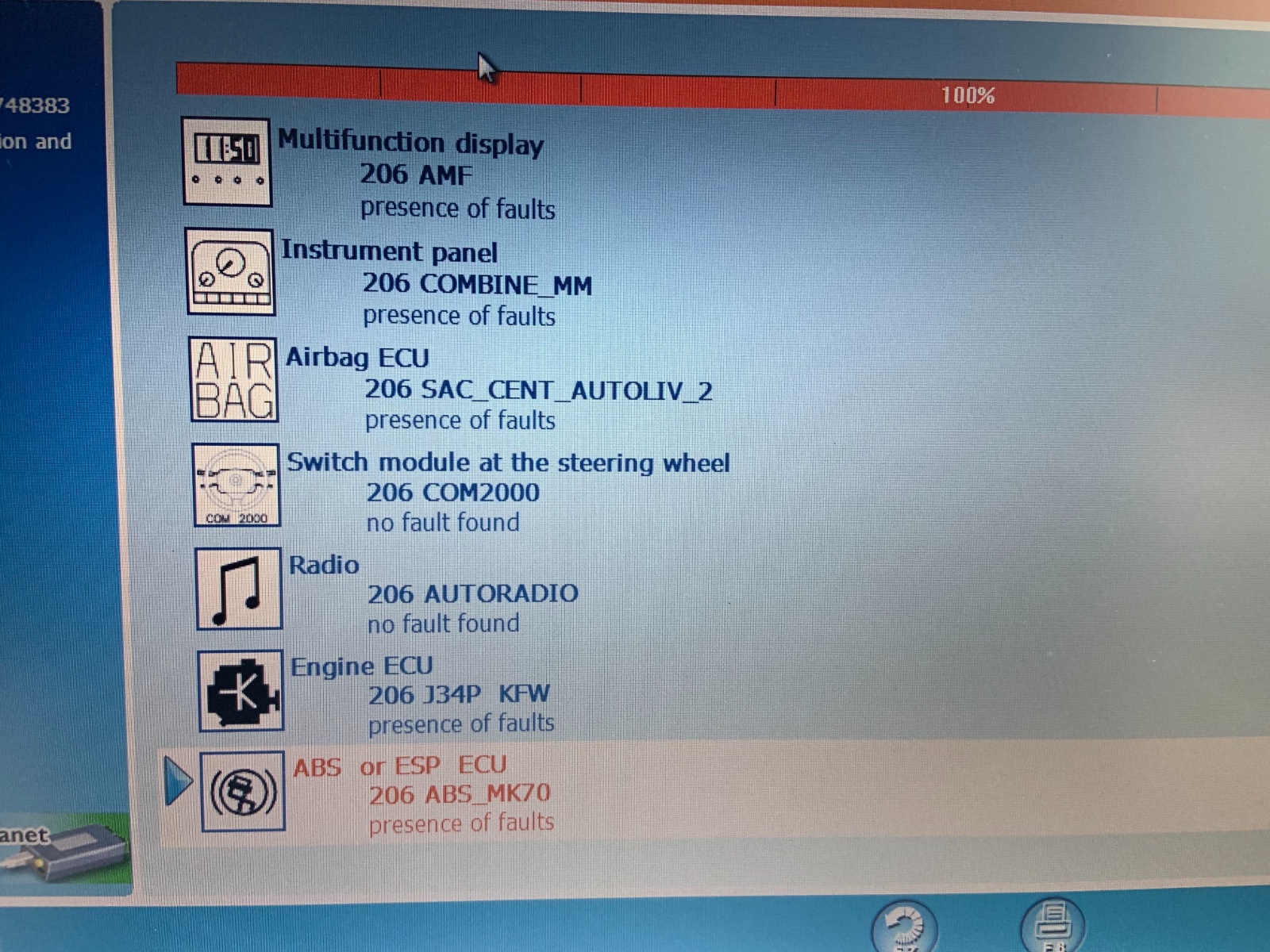

You should get fault codes on all these. Run a Global test as you have done, then on each ECU where there are faults detected, select the ECU and confirm, you will find a list of fault codes. Put up the actual codes here and do the same for the others.
Read and clear the fault codes, then run another Global test and see which ones remain. Some cold be historical.

Yeah i went through each section but didnt know if i should clear the codes.
I’ll do that tomorrow. Need to charge the battery again too!
So i better not go off half cocked and buy a new throttle body just yet

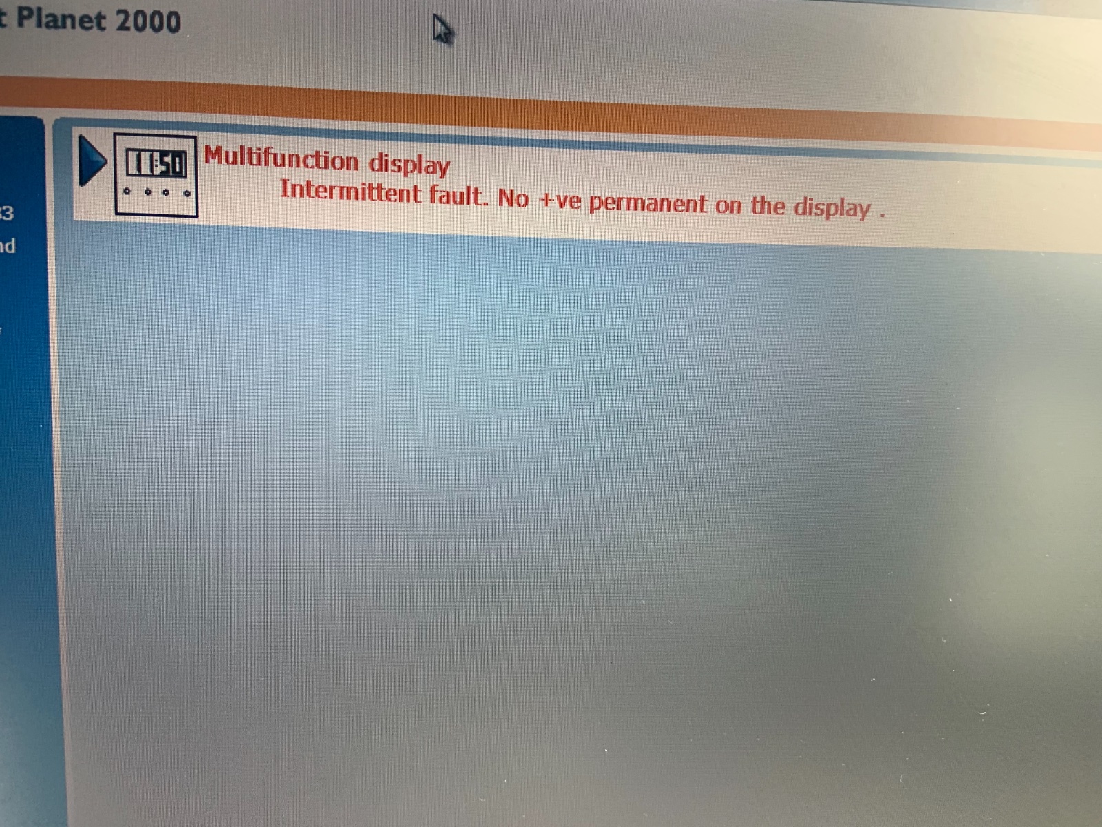

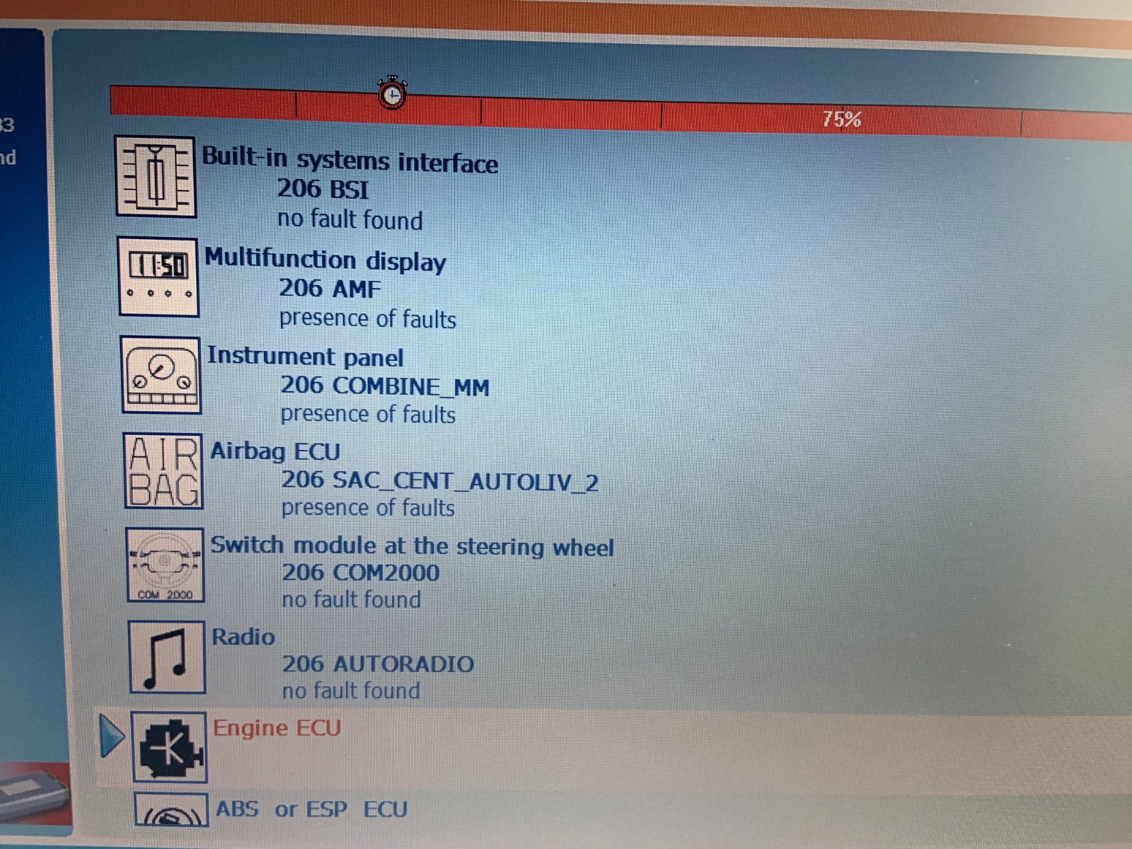

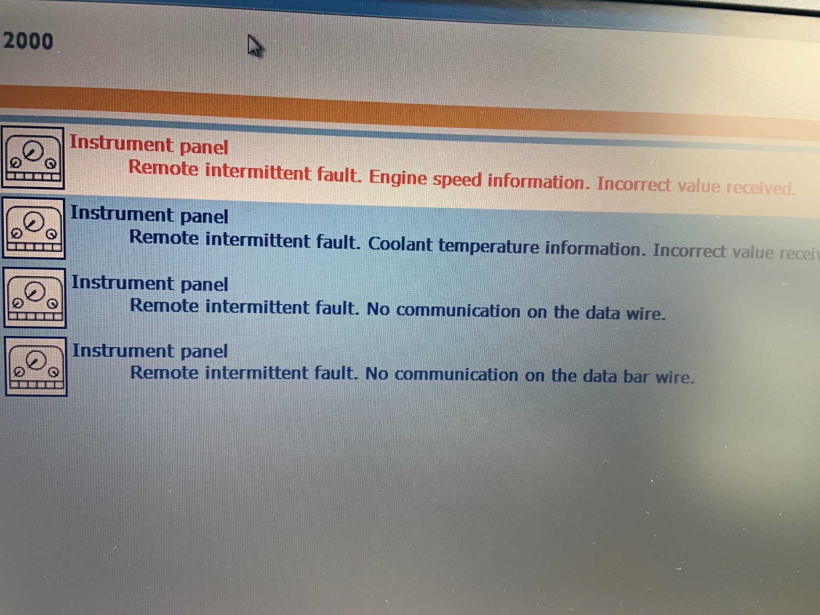

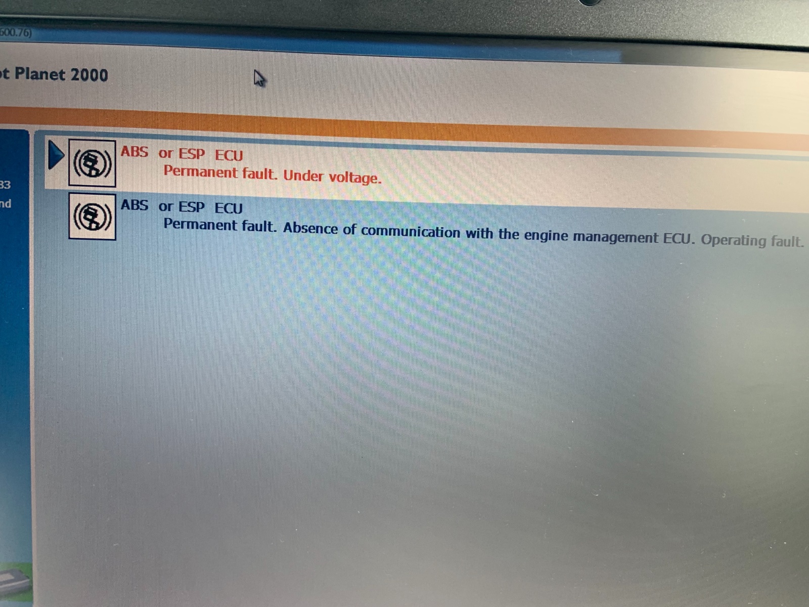

Re: Another 206 non starter!
Unread post by Markdas »

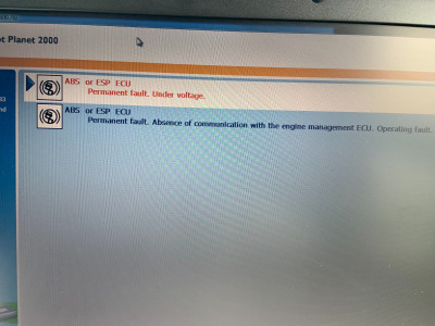

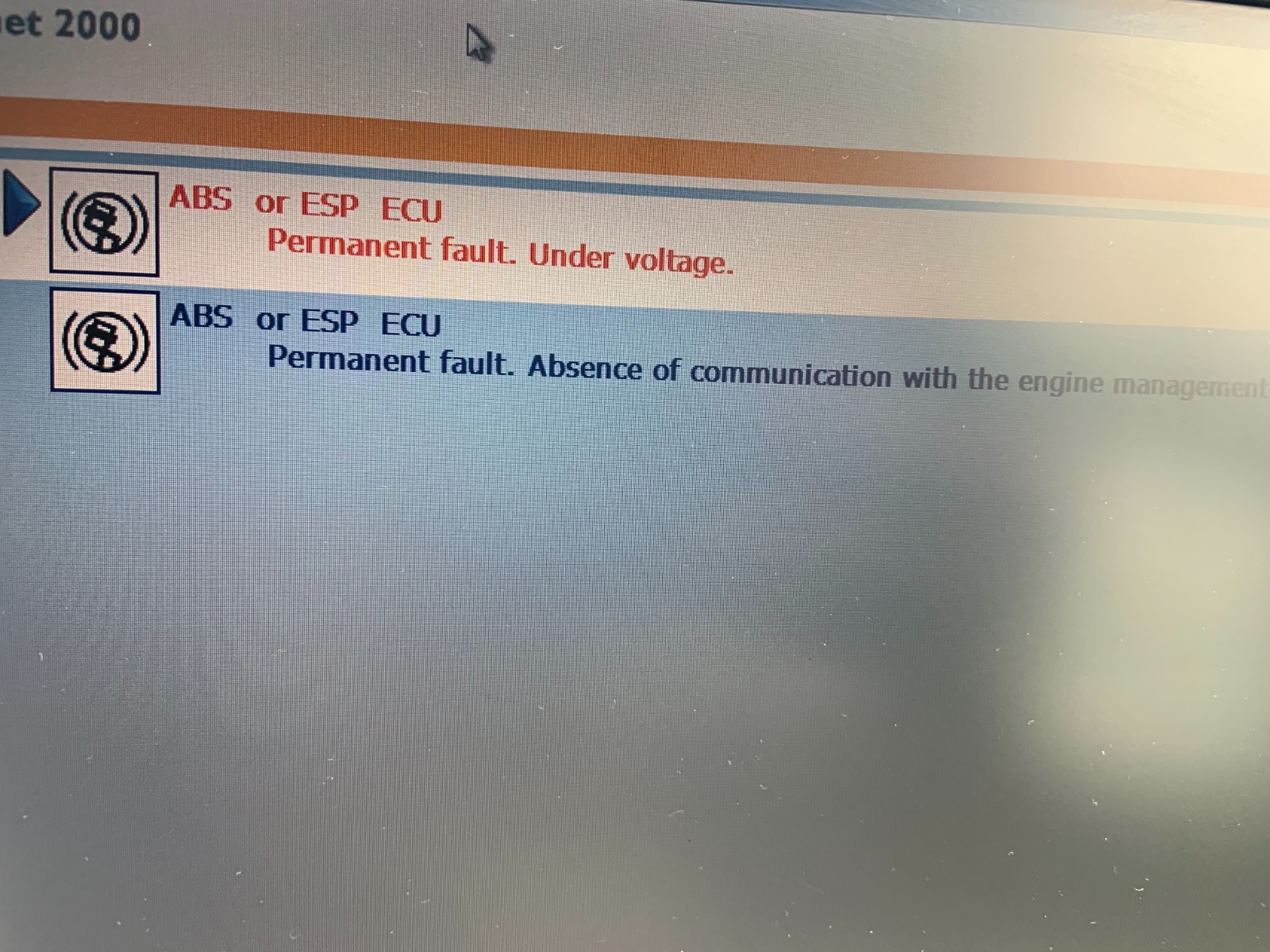

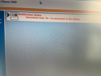

A few of the screen shots taken
x 6955
0145No don't go buying anything yet.
Incidentally - that is the main test PP2000 is running - don't do anything until it has finished. That is just running through all the ECUs and interrogating them. When it has finished, it will provide the list. Then each one with faults, you can select and confirm, it will then go into another screen where you can see the fault or select fault reading etc. The faults will have a letter and 4 digits usually like P0145 for example - and will give a description of the fault. I just need the fault codes against each of the ECUs.
The only fault code ive seen so far is the P0122
Morning guys,

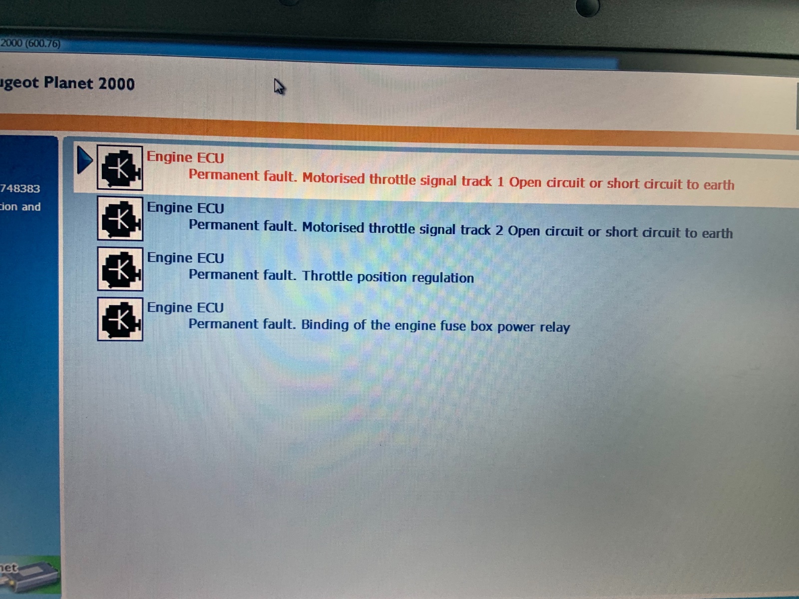

Ok, gathered all the faults, cleared them one by one and re did the global scan.
Only a fault remains on the Engine ECU but no start still
Fault is - Permanent Fault. Binding of the engine fuse bix power relay?
Hope that makes sense
x 6955
So there is something not right with the engine fusebox - some of the relays are built in and can't be replaced - so I would check your fuses and the wiring on the engine fusebox - but if it is faulty, then a replacement will probably be easier.
