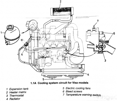

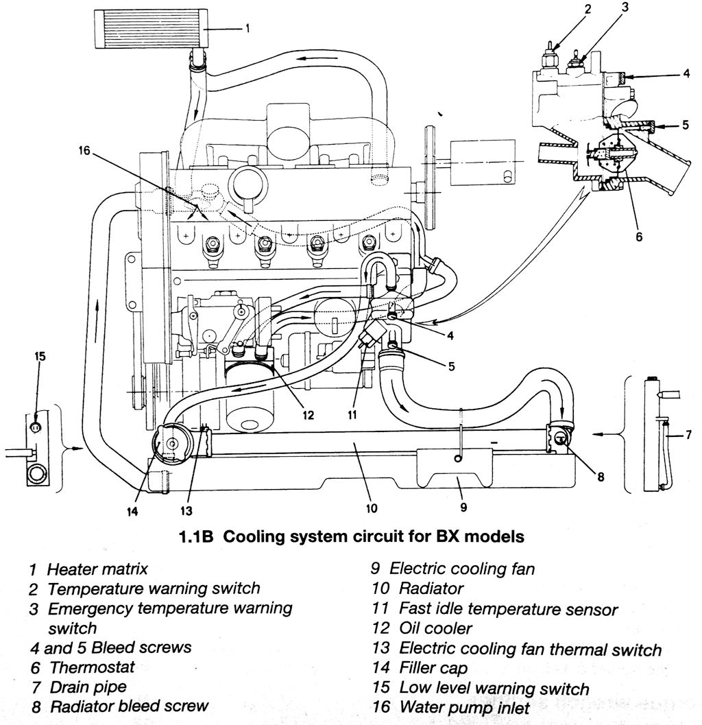

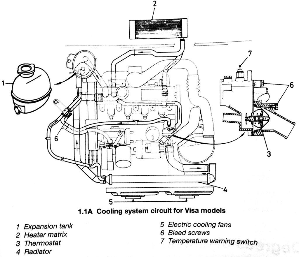

Mine looks most similar to the "Visa" version in the manual, with the extra inlet port at the pump for the return from the expansion tank. The only difference is mine has 2 heat sensor connections on the thermostat housing like the BX version shown, where the Visa has just one. But the BX is different to mine because it has an extra outlet on the thermostat housing for the oil cooler and no return pipe from the expansion tank because the radiator is a header tank.
So my question is, from someone who has a version with an oil cooler, where is the cooler feed outlet, before or after the thermostat? It is not clear from the diagrams whether the cooler is fed only when the thermostat is open or at all times, that's what I'm trying to establish.

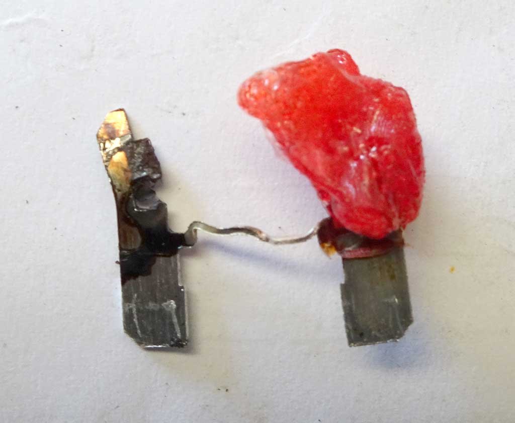

When I opened up one of the junction boxes I saw something odd in its fusebox which left me confused and concerned.
One of the fuses had melted away, but not blown. It looks like it got very hot and melted the plastic, but not enough amps to break it.
This was an 8 amp fuse that sat between the alternator and a split charge unit, so carried the charge from the alternator. I had one of those split charge units that caravaners use because I had 2 separate batteries for engine and everything else (lights, bilge, pump, radio, nav, etc) because I soon found with one battery on an open boat, the auto bilge pump soon knackers a battery during a the "rainy season".

One theory I have come up with, (but I'm not an expert on this, I'm just making this up) is that I used a good size cable from the alternator to the fusebox to comfortably carry the current, on the other side of the fuse box is the short and thinner wire into the charge unit. Does going from a thick with to a thinner one create a current bottle-neck that can create a hot-spot? I know undersized calbes and bad joints can become hot-spots with high current. The thinner wire is native to the charge unit, so you would think it was sufficient for the job.
Well, nothing caught on fire at least and everything appeared to be working perfectly. Opeing the box was the first I knew of this. It's just a concern because I was tinking of reusing the parts for a similar system.

My main query about that is exactly where the cooler is fed from on a system that already has a cooler. The Haynes manual shows 5 different cooling circuits from various vehicles, all of them differ from the one shown early in this thread and from mine, so there are a few variations.

Fuse melting: Not unknown where fuseholders age and oxidise, then overheat, without blowing the fuse. Some original fuseholders used by PSA were hopelessly under-spec'd for the current they had to handle. Just fit good quality new, and check the current being handled. Sealey do a couple of very handy little clip-on ammeters, which you can use on d.c. circuits without needing to cut the cable. Available 30-0-30 and 75-0-75amp. ('Sealey ammeter' on Amazon will bring them up)

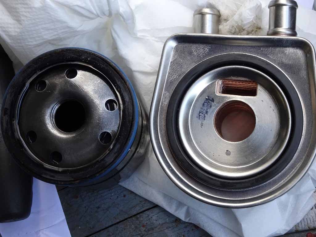

The oil cooler can be plumbed in "across the engine block", just like the (cabin) heater matrix. So it needs to be fed from the engine block side of the 'stat, and return to a similar point as the cabin heater. The water pump pushes water round the thermostatically shut-off small circuit of engine block/heater matrix/oil cooler.
When the 'stat opens, the main radiator is gradually brought into circuit. So even in very cold conditions, the engine temperature (oil, water, cabin heater) can be up to useful temperature quickly, even though the main radiator could be partially/completely shut out. On the two Haynes diagrams (Visa & BX) the smaller of the two hose outlets looks like the place to feed both oil cooler and heater matrix.

white exec wrote: 21 Jul 2019, 17:04 Fuse melting: Not unknown where fuseholders age and oxidise, then overheat, without blowing the fuse.
Everything inside the junction box, including the fuse box was spotless like new, no oxidisation or signs of aging. It was all in a sealed box to protect from the elements which has worked, but the other side to that is no ventilation to dissapate heat.

white exec wrote: 21 Jul 2019, 17:04 The oil cooler can be plumbed in "across the engine block", just like the (cabin) heater matrix. So it needs to be fed from the engine block side of the 'stat, and return to a similar point as the cabin heater.
This is just what I neded to know, I thought it would be "engine side" but when you say parallel with the radiator I took that as being the other side of the stat.
white exec wrote: 21 Jul 2019, 17:04 On the two Haynes diagrams (Visa & BX) the smaller of the two hose outlets looks like the place to feed both oil cooler and heater matrix.
Here is where the two diagrams differ, though the Visa one is just like mine pipe wise. From the stat housing, the big pipe to the rad, the tiny pipe to expansion tank and the back pipe returning straight to the pump, no oil cooler. The heater fed from the manifold side.
The only difference to mine, just one temp sensor connection.
In the BX we have the extra outlet on the stat housing for the oil cooler which I don't have. The cooler return joins the main return pipe, but for simplicity I could use the spare port at the pump.
So I see two options to feed the cooler, make a T split from the heater port on the manifold side to feed heater and cooler or butcher the stat housing by drilling out one of these holes to make it like the BX one. Like mine the BX has two temp sensor connections.
I don't quite get the "Temp warning switch" and the "Emergency temp warning switch", as in "It's fried" or "It's super fried", I would understand it if one were a warning light and the other a gauge. Or am I missing something?

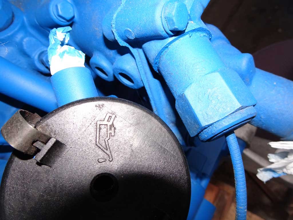

The two temp sensor switches are shown (#18, #19) on pp 149-150 of Haynes.
Some models had a very basic instrument panel, and there were two warning lights for high and extra-high coolant temperature (amber and red), and the circuit shows a flasher unit for one of them.
If you ever fitted a proper temp gauge later on, you would replace one of these switches (the lower temp one) with a sensor for the gauge. So you're right: one for gauge, plus one as a warning.
I guess as you say you can either drill out a spare port on the water outlet, or tee-off a heater feed hose, whichever is easiest - so long as you come off on the engine block side of the 'stat.

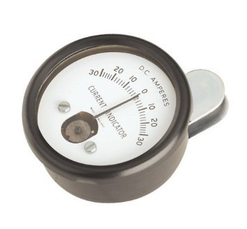

This is my day-to-day job and I wouldn't advise using the inductive pickup for the tacho.
Much more reliable and, therefore, more commonly used in the hostile marine environment, is the alternator driven tacho.
Many alternators have a "W" terminal as standard, but if yours hasn't, it's a simple thing to add one.
The tacho itself will cost the same as an inductive type, but the wiring is slightly simpler, needing only +,- and w connections.
If you buy a new tacho, it will come with instructions for calibrating it.

One thing occurs to me, regarding your oil cooler. In a land vehicle, the oil cooler is a supplementary cooler, with the air flow around the sump doing the majority of the cooling. On a boat, there is NO sump cooling, as the air down there is usually very hot, so boat oil coolers tend to be significantly larger than car ones.
Indeed, they are often cooled by the raw water circuit, after the heat exchanger, just before the exhaust injection point.
In this position, I feel your big one may well over cool it, but if you plumb it into the coolant circuit instead, I think you should be fine.
The marine version is also significantly more robust, so less likely to rupture, as discussed earlier...

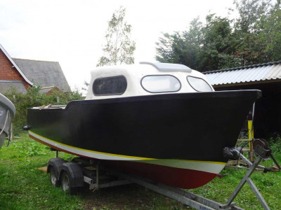

Out of interest what kind of boat do you have XUD marine ?

white exec wrote: 21 Jul 2019, 20:32 The two temp sensor switches are shown (#18, #19) on pp 149-150 of Haynes.
OK, so amber for "It's getting kind of hot, I think you should know about it" and red for "You seriously need to do something about this right now!"
sparksie wrote: 21 Jul 2019, 21:16 Hi
Interesting, something I will have to look at, at some point. Though my alternator has only 2 connections, a B+ and F which goes to the battery light.

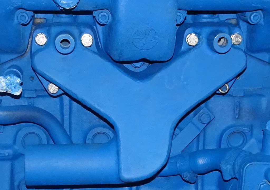

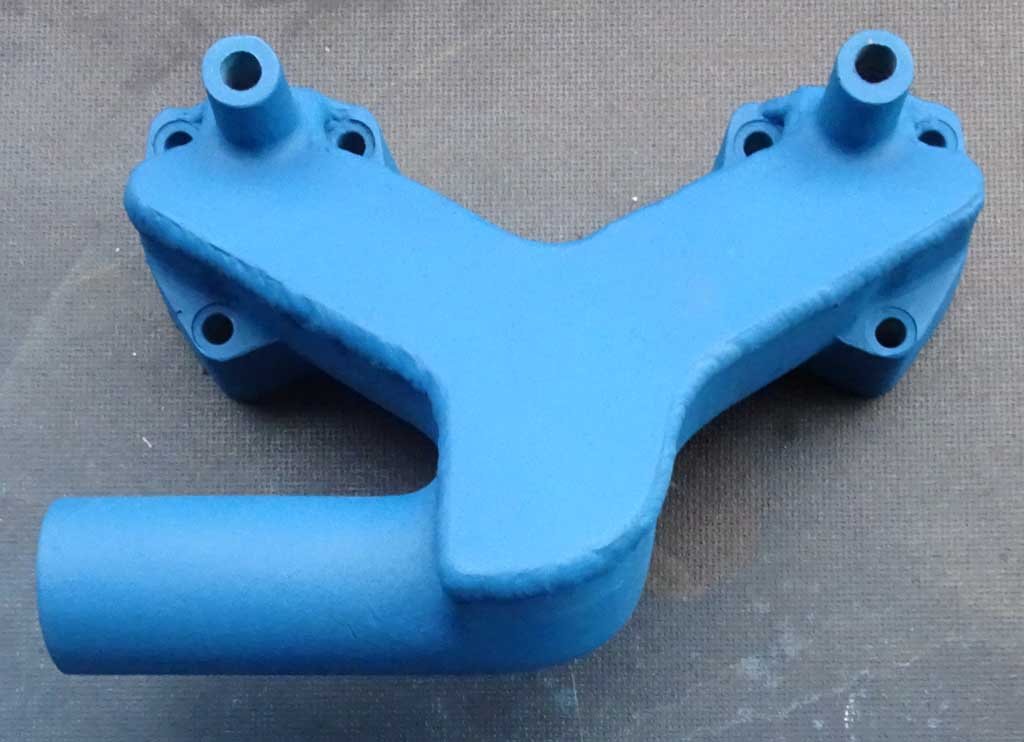

The manifold came from Lancing Marine and the heat exchanger(s) from Ebay, though Lancing can supply the whole kit. I got the manifold, bell housing, drive plates and front mounting brackets from them.
https://www.lancingmarine.com/pricebook ... age17.html
They have some experienced engineers who are happy to give advice on the phone and are very helpful.

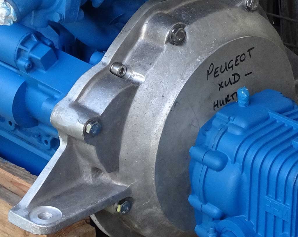

When you order drive plates and bell housing you need to tell them which gearbox you are pairing with so it can be machined to fit.
The manifold is aluminium with some nice welding on it and two inlet ports to feed the Y shape both sides, so you have to split your sea water at the end. If I have to criticise, it is awkward to bolt on with little space for a socket or spanner.
When I took the original off, it's held on with nuts on studs, for me all the studs came out, except the bottom right/front where the nut came off leaving the stud in the engine.
So I replace the studs with stainless bolts, but there is no room to get a socket on the heads, but I was just able to do it with a spanner, except for the upper inside ones. With the air manifold there it's impossible to get a spanner on. What I did was borrow 2 socket screws from the air manifold and swap them with the bolts. I had no socket screws at the time.
So with hind sight, you should get some socket screws in advance for this job. That will require removing the studs from the engine. Likewise, the same problem with the starter bolts in the bell housing, by this time I had aquired some stainless socket screws, no way you would get a bolt in that top one.
One more gripe, the holes in the rear mounting brackets (part of the bell housing) are half an inch further apart than the front ones, was it too difficult to put them in line?

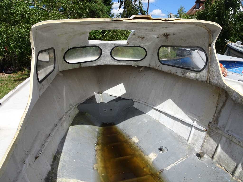

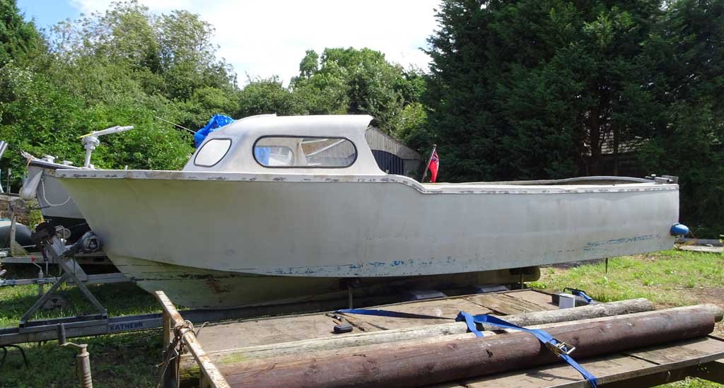

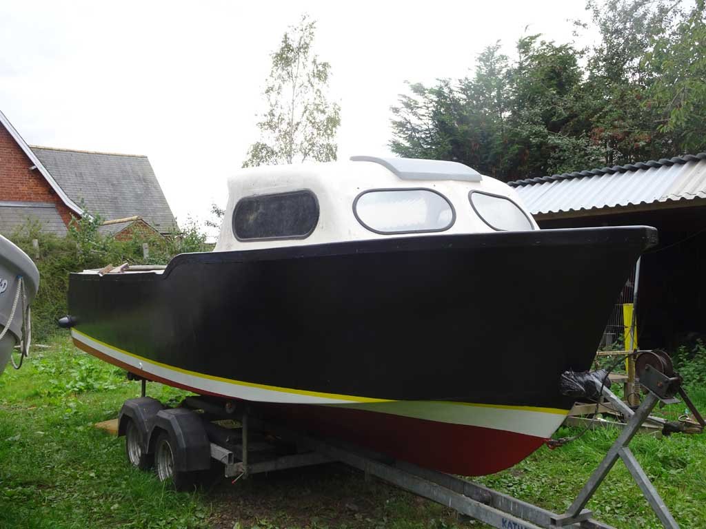

Ineresting one as it's not (going to be) the same boat that it was.
The hull is a Freemen 22, which would have been a cabin/river cruiser, the sort of thing that may chug around on the Norfolk Broads. They were nicely fitted out with accommodation in hard wood, the company apparently started out making and fitting out caravans before turning to doing similar with boats. This is the sort of thing it would originally be, more pics at the bottom of that page.
https://www.burtonwaters.co.uk/boat-for ... 32477.html
But what I aquired was completely stripped out to an empty shell of a hull and much of the superstructure removed. A blank canvas if you like.
So what I'm planning is a two thirds open boat, with the small cabin at the front, you can see from the link there is room there for two bench/bunks in V formation. Nothing too lavish, just somewhere to get shelter, sit and have a brew, or get your head donw in needs must. I'm fitting a bulkhead at the back of the cabin and steering with be outside behind the bulkhead. The engine will be central with a suitable fiberglass cover box.
It should be a lot lighter than the original with a bit more power, the hull shape looks like it would have no problem with a bit more speed. I will have to beef up the hull around the engine area, wooden beds to spread the engine weight, glassed over for more strength and protection and probably thicken up the floor there too. It won't break any records by a long way, but if I keep weight to a minimum and get the right prop, it sould be go quite nicely. Ideal for fishing trips and suchlike.

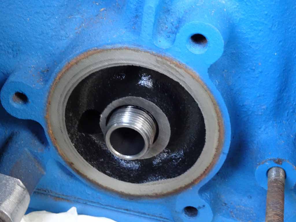

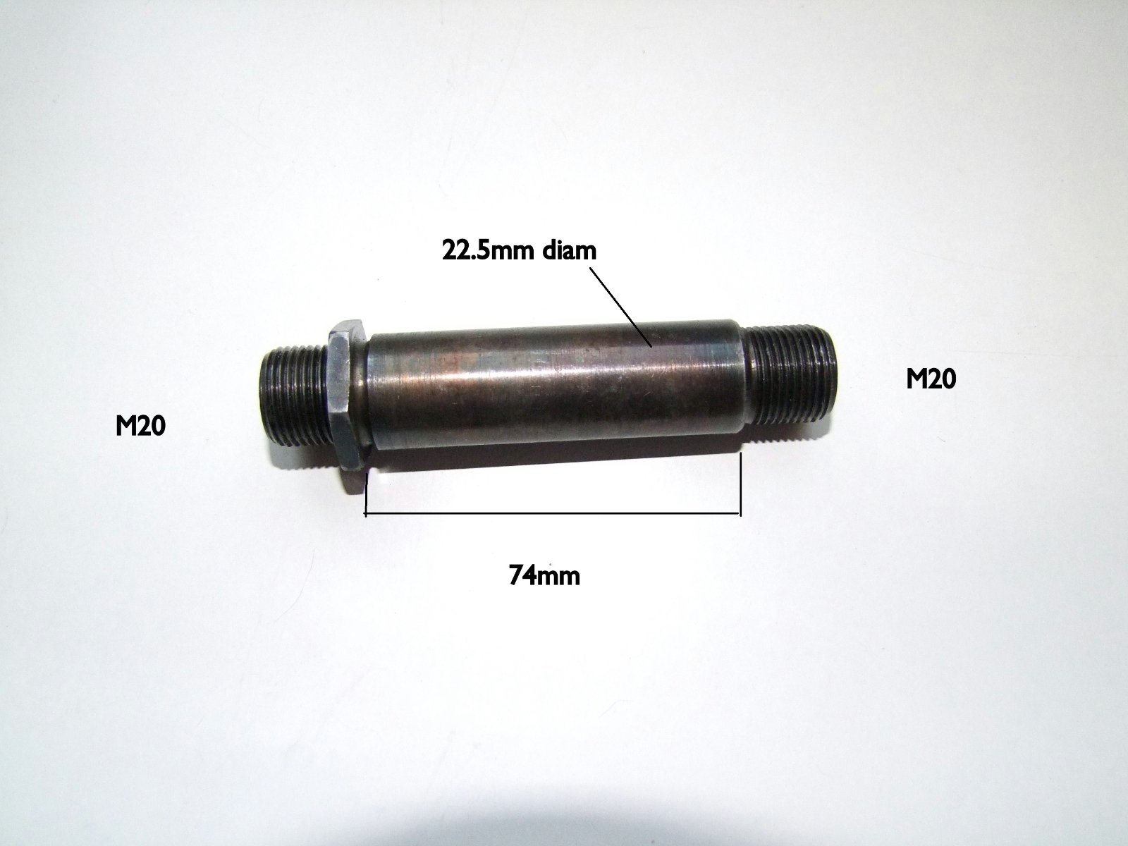

A little bit of progress. I got a load of silicone hose elbow reducers to start building the cooling system pipework.
Also got an oil cooler, the 1103A2 version which is quite thick. But I'm still short of the hollow bolt and not sure where to find the right one. The other option is to make one. By the pictures I have seen the bolt is male both ends, like it screws into the engine and the filter screws onto it.
But when I take my filter off there is the thread stuck out that attaches to. So that would need to come out leaving a threaded hole, as seen here when the cooler is off.
viewtopic.php?f=3&t=58040
It's just my mate seems to think the engine side of the bolt should be female and scew onto the existing thread that's stuck out. The thread I think is 20mm, the hole throught the cooler is 24mm, so would not leave much thickness with 20mm thread inside.
I think it should look something like the one in this picture (though different cooler and engine)
https://dispatchexpertscudo.org.uk/foru ... php?id=560
- x 1746
Re: My Engine
Parts diags for 1.7 & 1.9 (and 2.1) XUD show that the centre hollow bolt for the cooler is male thd at each end, so guess that threaded stub in your last photo will unscrew.
It looks like M20, designed to screw straight into a filter, with no cooler fitted.
The correct centre hollow bolt for your 1103A2 cooler is 1103C3, but NFP.
That cooler (1103A2) was standard fitting for the XUD11ATE/BTE engines (2.1 diesels), which you could find in a variety of XM, Xantia etc.
Paul (citroenxm on here) may be able to help with a used bolt.
This company sells a whole variety of oil coolers, and also some M20 hollow bolts (for their sandwich take-off plates)...
https://www.thinkauto.com/acatalog/Extension_Bolts.html
Don't know whether any of theirs are the right length for your cooler.
I have one surplus bolt here (XM 2.5), which is quite long, and could be cut and shut...or (better) have its r.h. end turned down and re-threaded (a plain 12mm drilling passes all the way through).
...if you get really stuck.

From the pictures I linked to, it's clear the engine end is male. I measured the hole through the cooler at 23.5 dia, if it were female with an M20 thread inside it would be a bit too thin. The depth of the hole is 53mm.
I have scribbbled down a drawing which has gone to my dad, who fortunately is a retired engineer, but he still has machines in his workshop and doesn't mind a little project now and then. So that is being made presently.
I did have a search around but wasn't able to find the right one anywhere, though I did not have the part number at the time.
A quick search for that number, I found it on a stock list for a place near Knottingley, but it says 0 quantity in stock.
I have some stainless hose clips on the way. Once the cooling system is piped up I can put in some fluids (oil, coolant, ATF for the gearbox) and see if she fires up OK.
