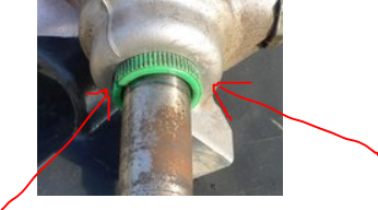

Citroen's £2000 (at the time I had mine replaced at the dealer) modified rack involves this amazing feat of engineering:
(Extract from Bobin's Picture

I actually saw that image in the posts . . . . it looks like a carved up bottle top!

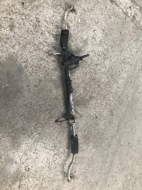

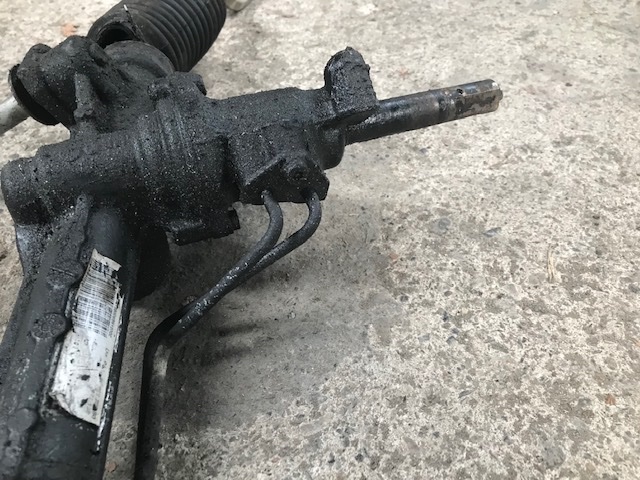

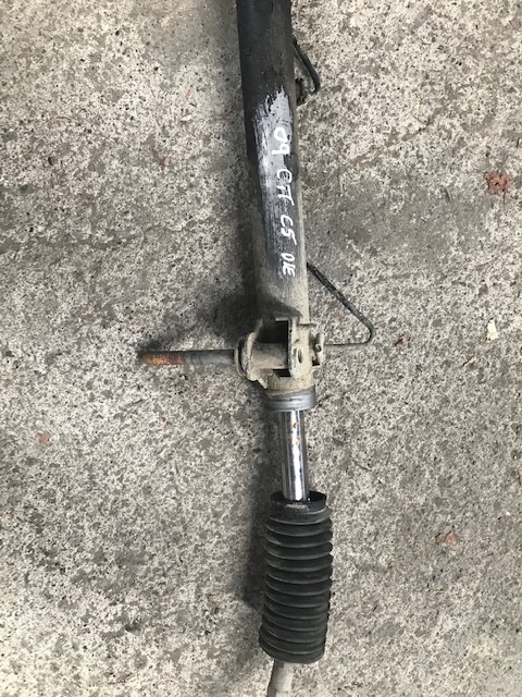

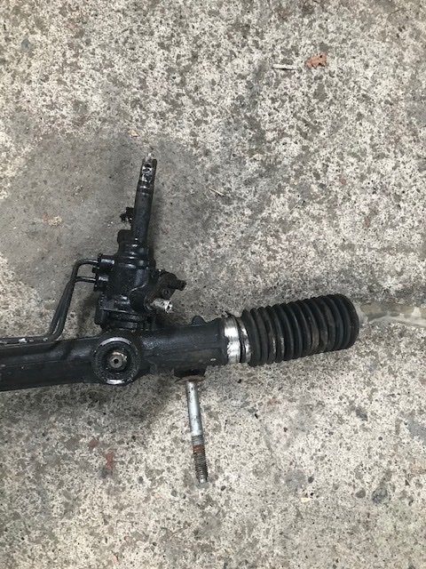

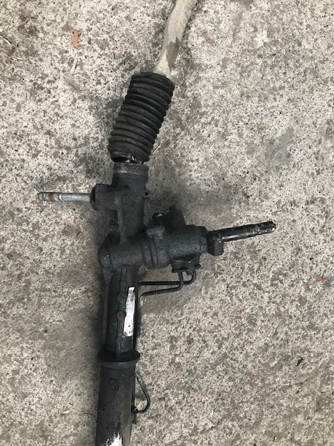

Re: C5 . . . . which model is this?
Hi Marc,

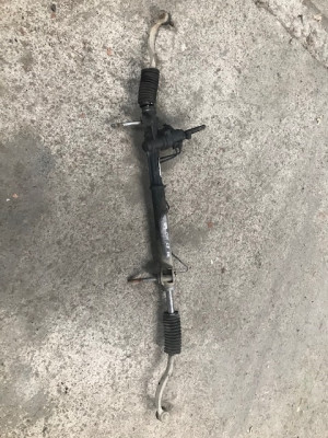

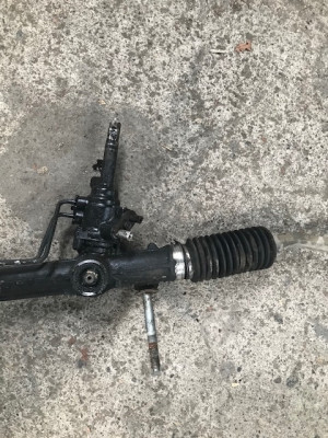

I’ve tracked down a steering rack, however, I’d like to be sure it’s the correct one before purchasing.
Markings on it suggest it’s from a 2009 C5 and I’ve attached a few images. I’d appreciate if anyone can tell me if it’s the correct rack for my car. (2011 C5 x7)
Many thanks,
Paul
Many thanks,
Paul
As far as I know they are pretty well all the same. You can get a recon one delivered for about 180 pounds, if you go for that one make absolutely certain that the pinion seal isn't leaking. I'm sure someone will be along to tell you if I'm wrong about the fitment.
- Posts: 9403
- x 1940
There is a difference between the steering racks on cars with 16" wheels compared to the ones withy 17", 18" or 19". I think the internal stops are set differently to give a different turning circle. Whether this can be ascertained by looking inside I don't know. Maybe if there's a part number on the label it might help identification?
Hi Paulpasalima wrote: 09 Jul 2020, 19:06 Hi Marc,
Many thanks,
Paul
I can't tell you without a part number number or other identification - perhaps check the label or a clearer photo of the label. It is essential you get the correct rack as they are not the same. There are multiple part numbers for not only the different angles, but also C5s with different engines had different part numbers for the racks and again they changed depending on the build date.
The racks have 2 different steering angles a 180° and a 184°
The replacement part number for the latest rack is: 9801415480 for your specific C5, or 4001W3 was the part number for the original rack.
Thanks Pete, Paul, I was hoping to get a replacement rack refurbed so that I could just swap out with my own,
but it looks like I might have to take my own out and get it done. I tried all the obvious sources but none have any in stock.
You're right Marc, I did quote the 9801415480 number & 180 deg (that you gave me) to findapart when searching and this was the only link that came back. I'll keep searching for another few weeks, but I might have to bite the bullet and get my own done.
