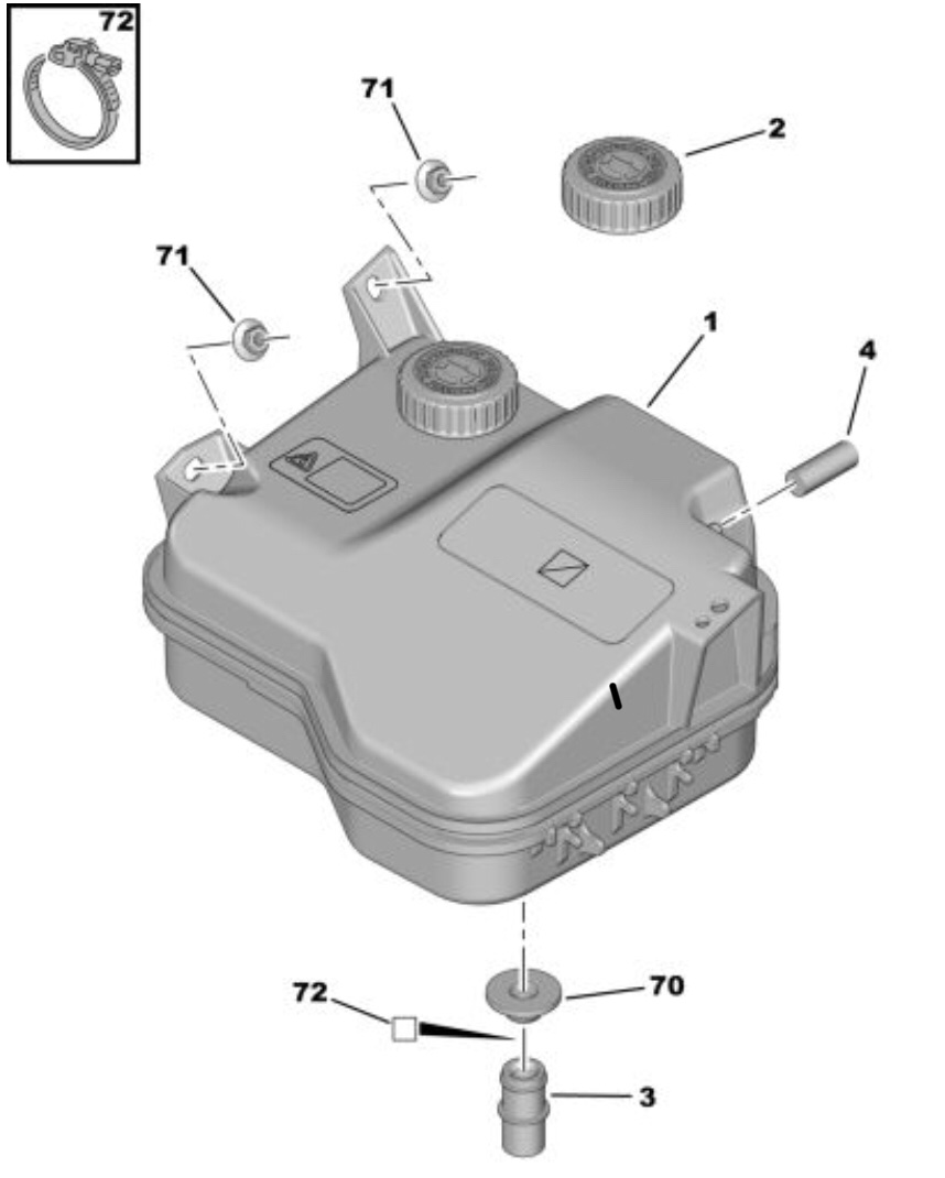

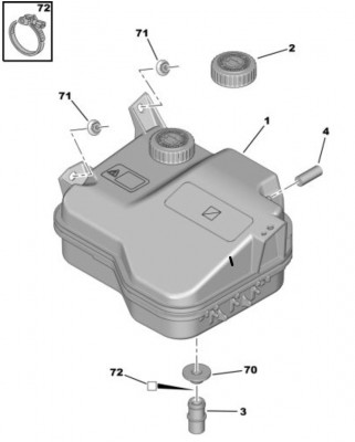

James, they are different systems and different tanks and caps for the MK I & II as compared to the X7. This thread started on an X7. You can’t just wade in and start stating things as facts that are not relevant to the model in question,
The X7 tank is materially different as is the suspension system, has a separate venting cap built into the tank, and has a venting pipe. I’m going to leave it there as I’m rapidly loosing the will to live.
The one on the left is from an X7 - note part 3 (tank cap) and & 4 (vent pipe), This changed again later,
